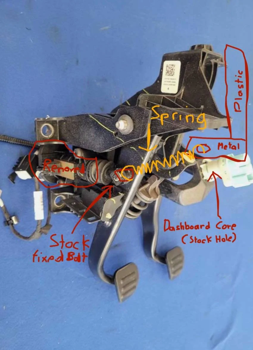

I’m was planing something similar. Found a old rusty spring and tried it out today and it works! Just need a higher force spring the one i currently tried is just 6 kgs.
First i removed the clutch master which is no longer needed. ( Now I need to print a backplate that seals the open hole)
For the spring mount itself i use the existing bolt that the clutch master cylinder uses and the other end the metal core that holds the dashboard that already had a convenient hole in place.
The only thing is i need to extend the stopper pin because otherwise the pedal retracts 2cm above the brake pedal.
The neutral safety is just a push button that stays in place and works as it should.
Later down the line when i wire in the linear position sensor i will probably also use the bolt for the master cylinder to the printed backplate.
I included a stock photo from ebay to illustrate the setup(Linear position sensor and backplate not in the drawing)

Regarding the springs you can find some info there: https://www.mustang6g.com/forums/threads/clutch-adjustment.192403/post-3862379
I can imagine, that installing a stronger spring than the one fitted from factorsy on the GT will overstress the entire mechanics of the pedal box.
The stock pedal spring stays in place. The other Spring should approximatly have the same force as the hydraulic pressure on the pedal. So i think mechanically it should be fine. -knock on wood

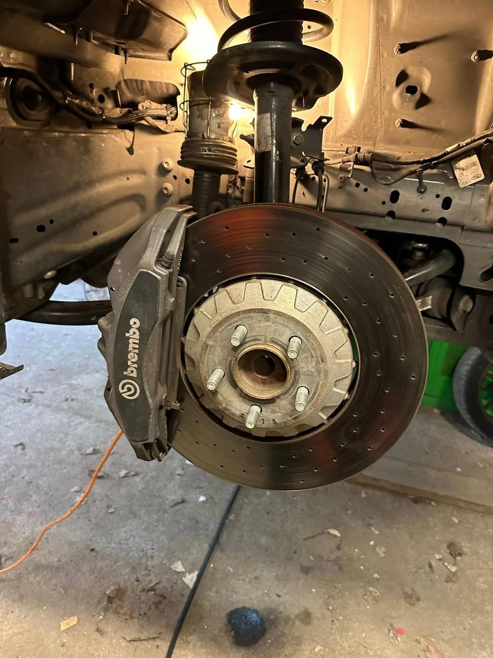

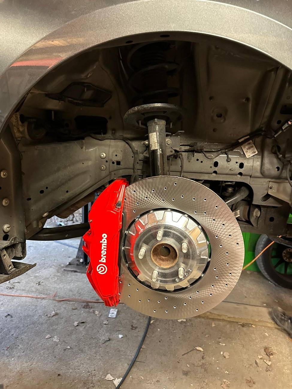

Finished the outside of the car. Everything works and no more errors on the dash. The shifts are smooth in program mode 1 and no more weird gearbox sounds.
The last things i do is the clutch pedal linear position sensor which i already have and the paddle shifters that arrive tomorrow.
I also changed brake rotors, pads and calipers.
When it its warmer i will do a proper test and i hope the car will pass the TĂśV technical inspection :D
