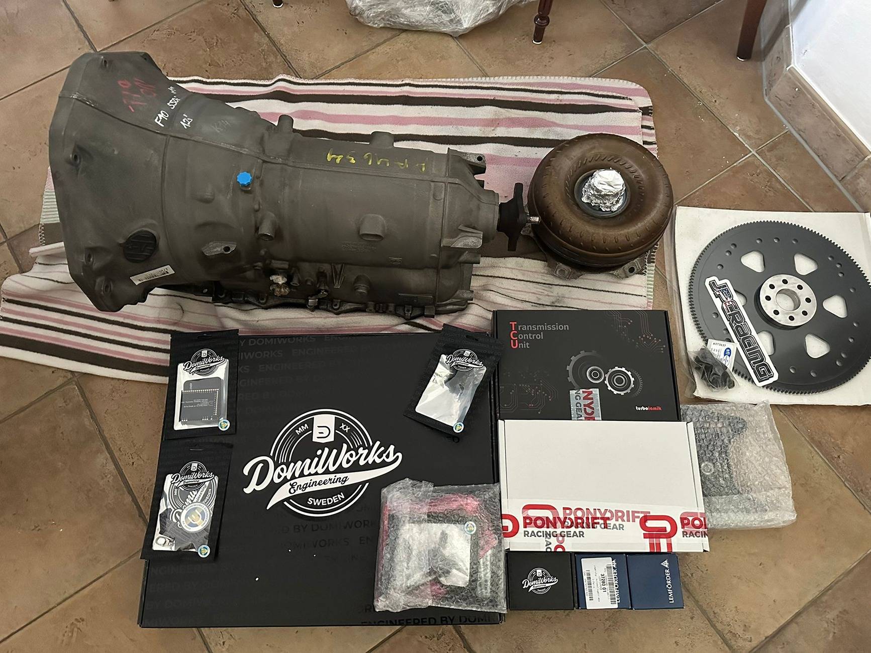

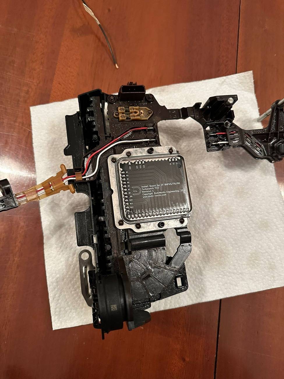

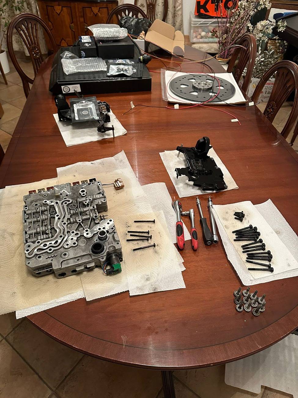

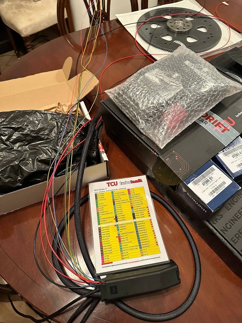

Most of the parts arrived last week. Made some pogress disassembling the mechatronics to get acces to the OEM TCU and replace it with the bypass pcb. Also figured out the wiring of the TCU itself. Removed the Can wires that where already on the connector but since Ford ECU's are not supported i need to wire it in manually. For that i wired in the 3 wires that are needed for that. TPS, MAP and RPM. I still need to figure out where to get the 3 signals from the car. I figure tps and map i can get from the respective sensor but rpm i would either need to get from the coil or the crank sensor i think? Anway next step is to put the heat sink on the bypass pcb with loctite 5980 which arrives tomorrow. After that i can reassemble the gearbox.

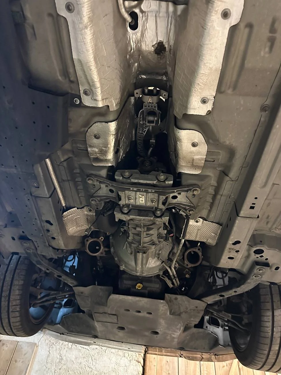

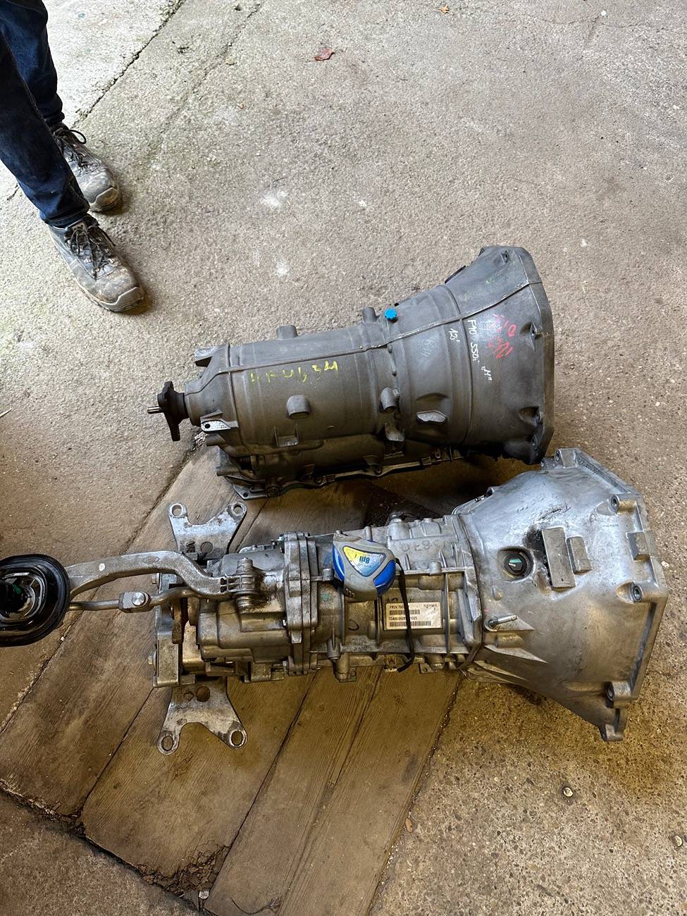

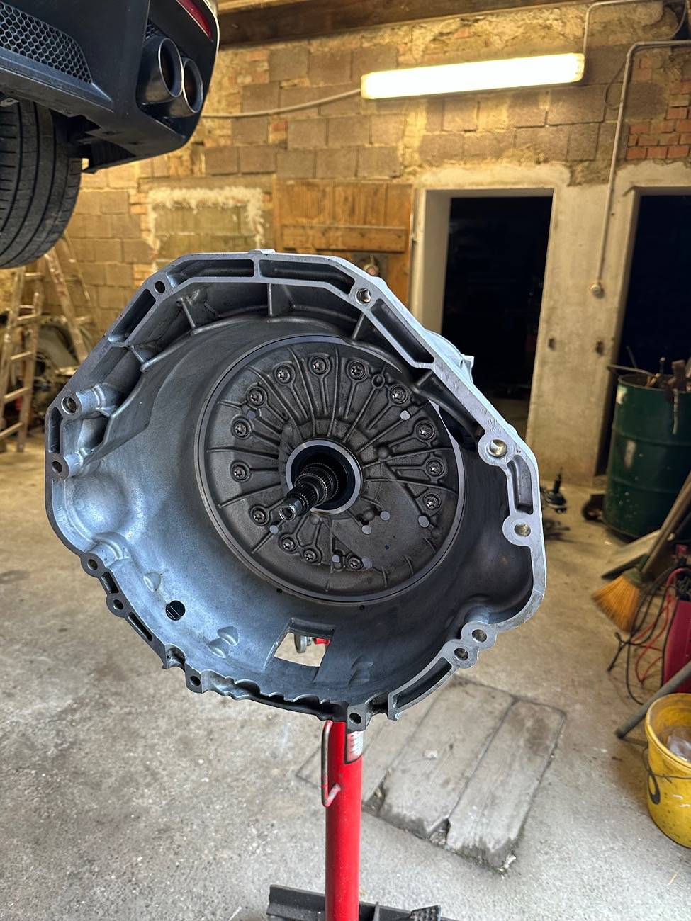

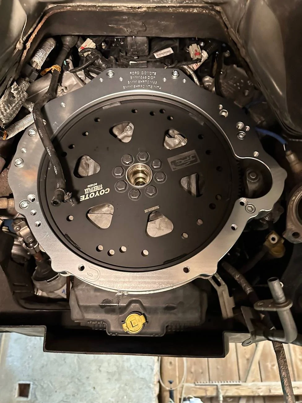

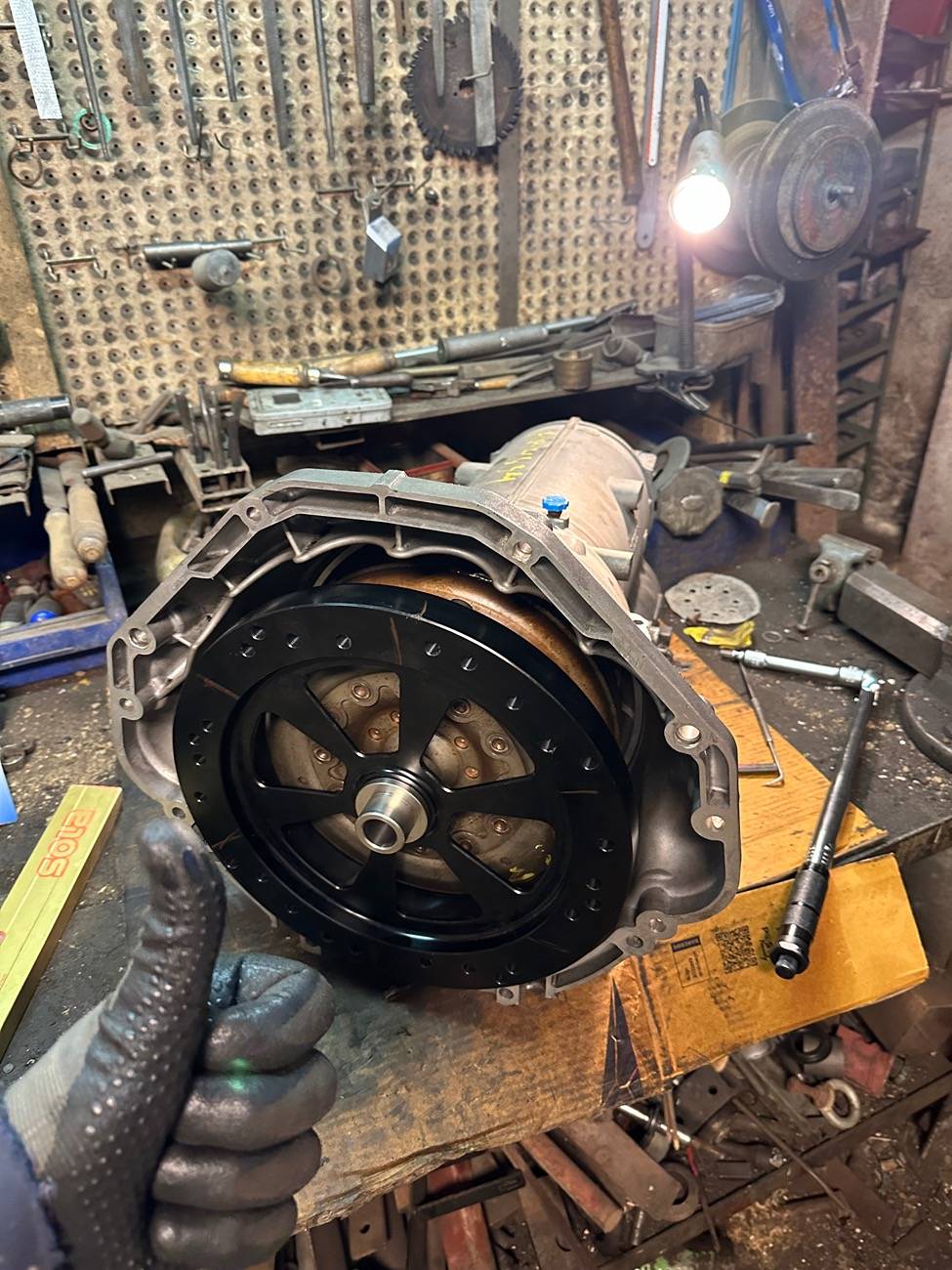

Some more progress. Removed the TR3160 and fitted the domiworks adapter plate + jp flexplate for the zf8hp. Fits perfectly to the engine. Probably tomorrow the zf8 will go in if everything works. Physically there are a couple of questions still open but i'm 95% confident that physically the transmission fits.
1)Im pretty sure i need a custom driveshaft not sure where to get one for my specifics for the moment. The zf8 with the adapter 1-2 longer and has a different flange.
2)Since now there is no more clutch slave cylinder and i don't wanna remove the clutch i need to figure out a contraption that makes the clutch work without a slave.
3)I need to fabricate a transmission cross brace.

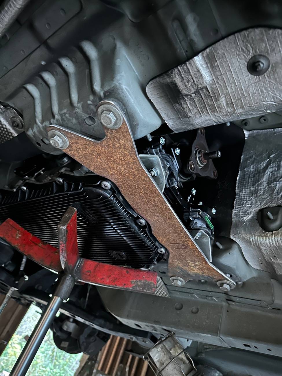

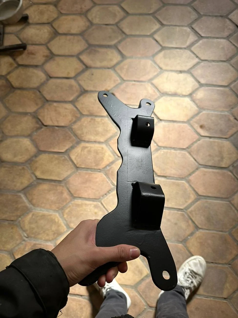

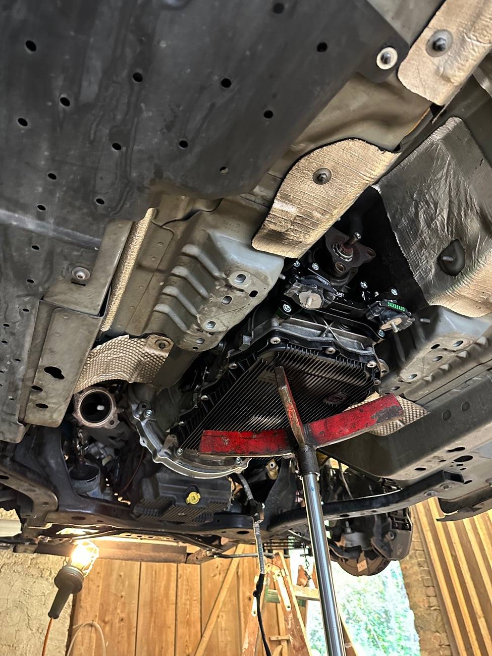

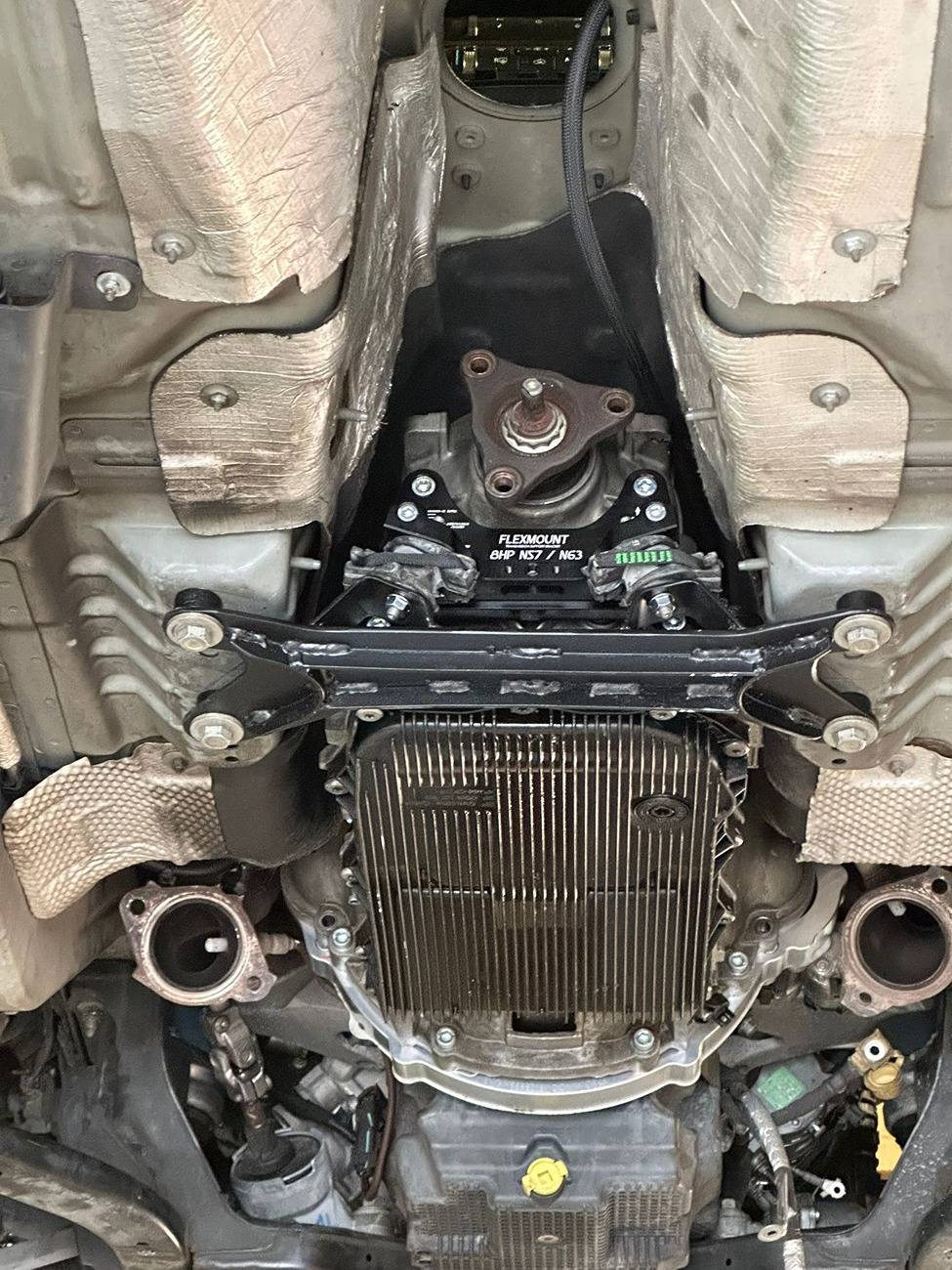

So if anyone asked themselves if a zf8hp70 (n63) fits a gt350/mustang it does! Thankfully the voodoo block has the same access/service hole to bolt the torque converter to the flex plate. Whole install went fairly smooth. Also first attempts to fabricate a trans cross brace. For the driveshaft i will probably buy a used BMW one for an F10 550i and a used Mustang GT one and weld my own. Oil cooler should also be fairly easy. I will use the existing one and use AN fittings with steel braided lines in place of the oem lines.

Solid work on the mount. I went with something similar and it's worked well so far!
re: driveshaft, given all the work, why not get a custom CF shaft? Driveshaft shop will make what you need

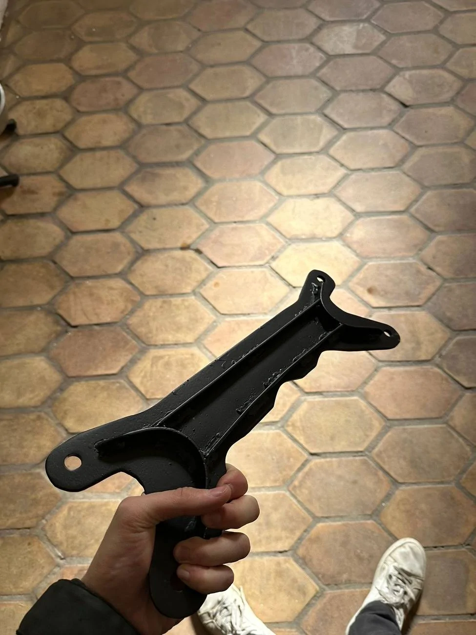

Transmission cross brace is done! Hopefully next week i receive the last parts for the oil cooler and driveshaft + driveshaft adapter.

I'm glad to see some rubber on that mount. My main concern with this swap is the vibrations from the engine and if the DCT is properly damped for it.
