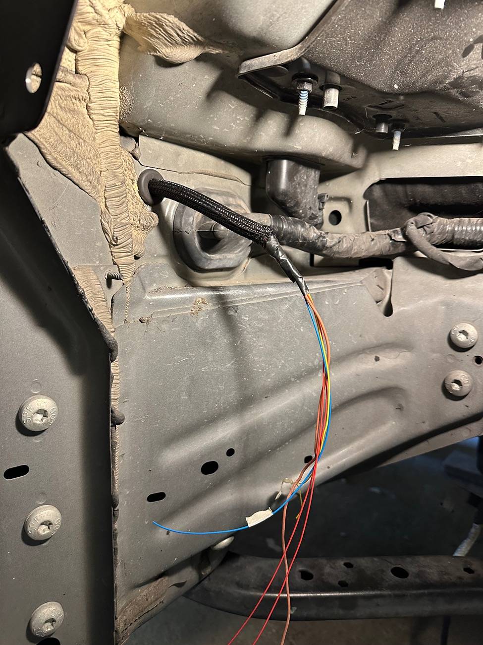

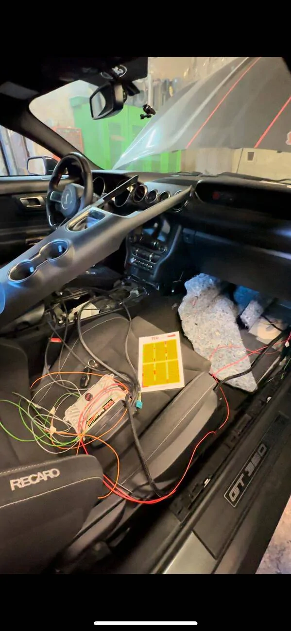

Excuse the bad picture i forgot to take decent ones at the end.

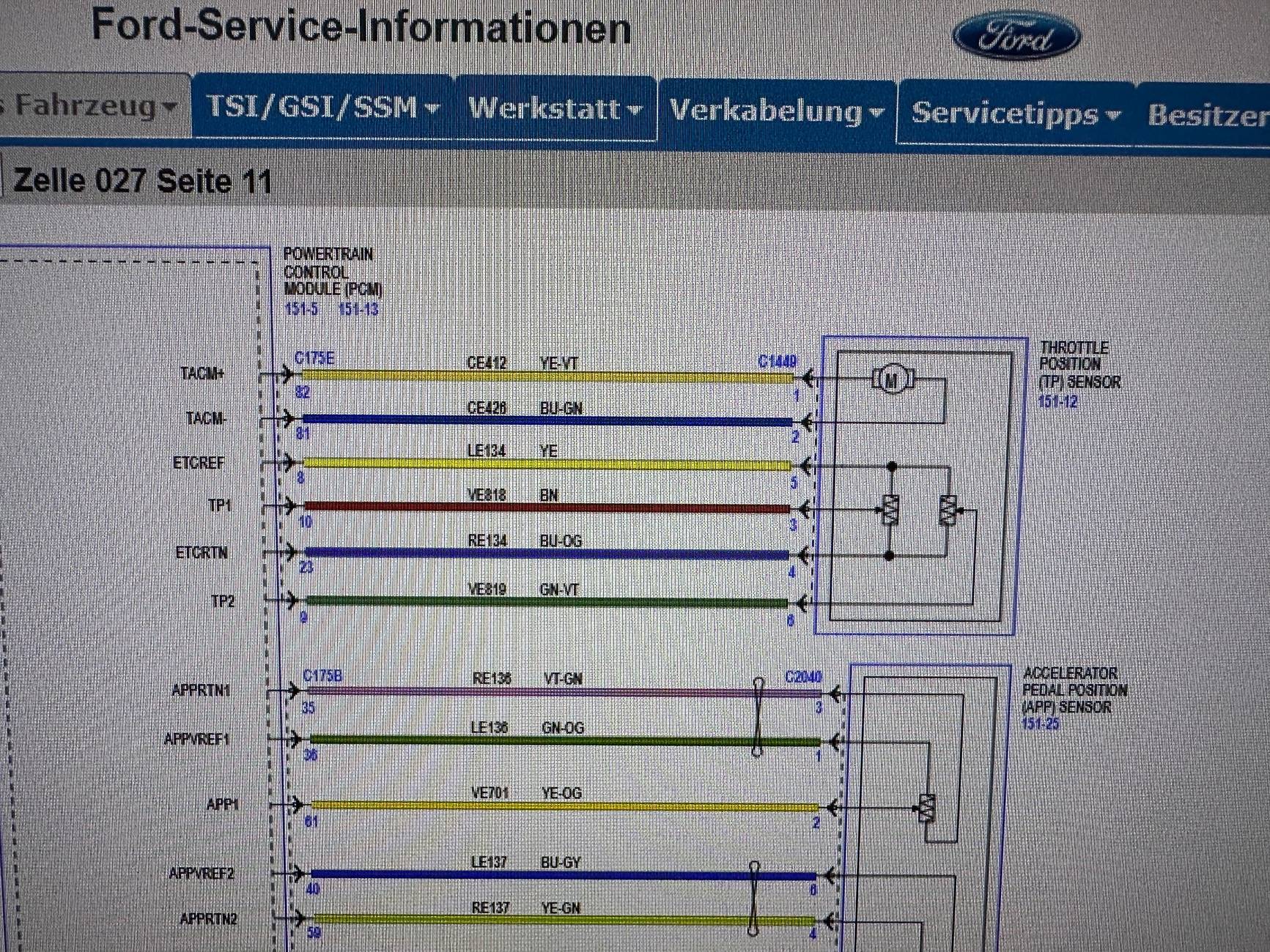

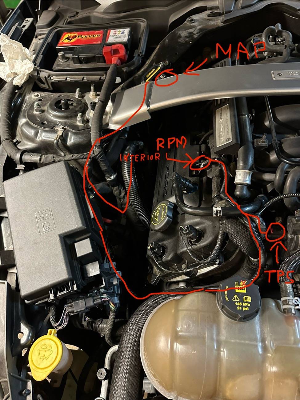

Started wiring in MAP, TPS and RPM + Constant 12V, Switched 12V and Ground.

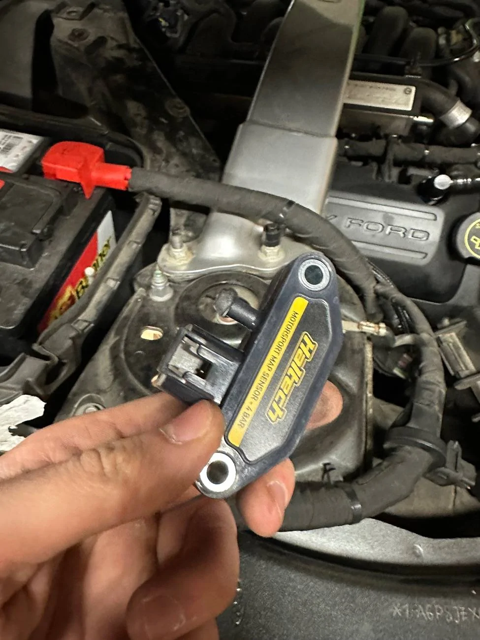

Controller is already getting power and MAP sensor is also done and reads pressure.

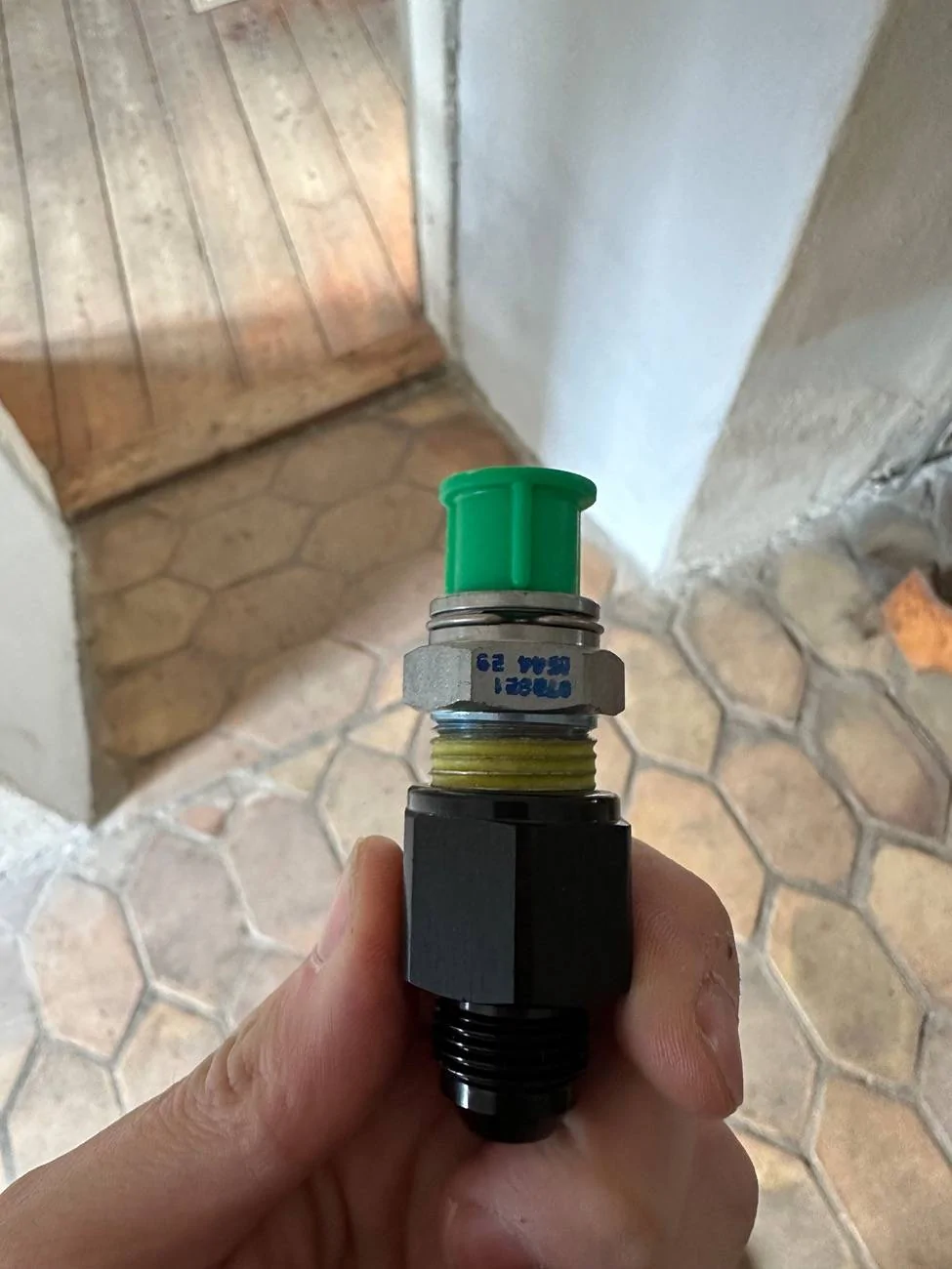

Tomorrow i will search for a source for the MAP. I probably just cut into the vaccum lines near the intake and put a T split in there.
TPS should also be fairly easy i think tp2 (positve slope) is the signal i need. Correct me if im wrong.

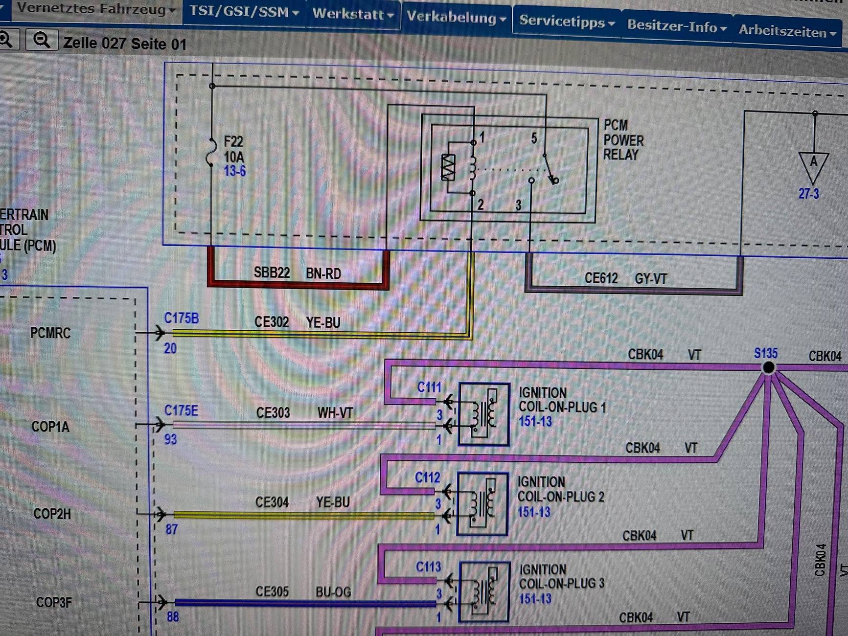

RPM i think i can get from coil number 1 negative?

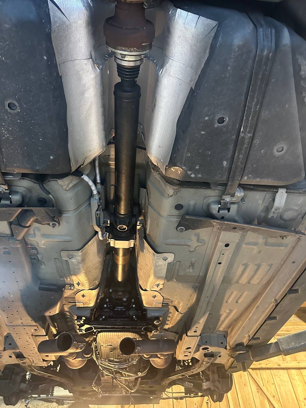

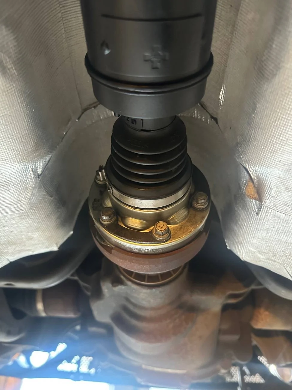

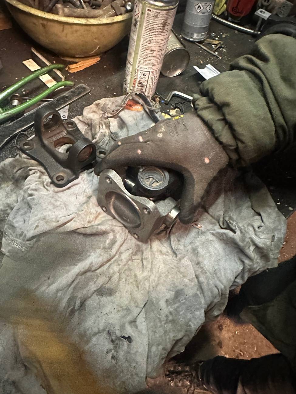

Back to the driveshaft issue the automatic 2019 Mustang uses the same flange as the 2016 gt350. Driveshaft would also theoretically fit but with the adapter its 2cm to long. So i brought it to upper Austria to get it cut. Should be done next week (:

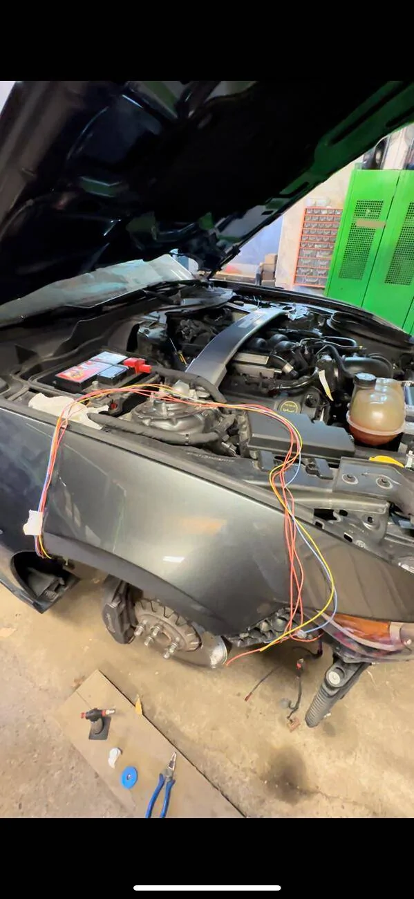

Engine Wiring done except the vaccum line.

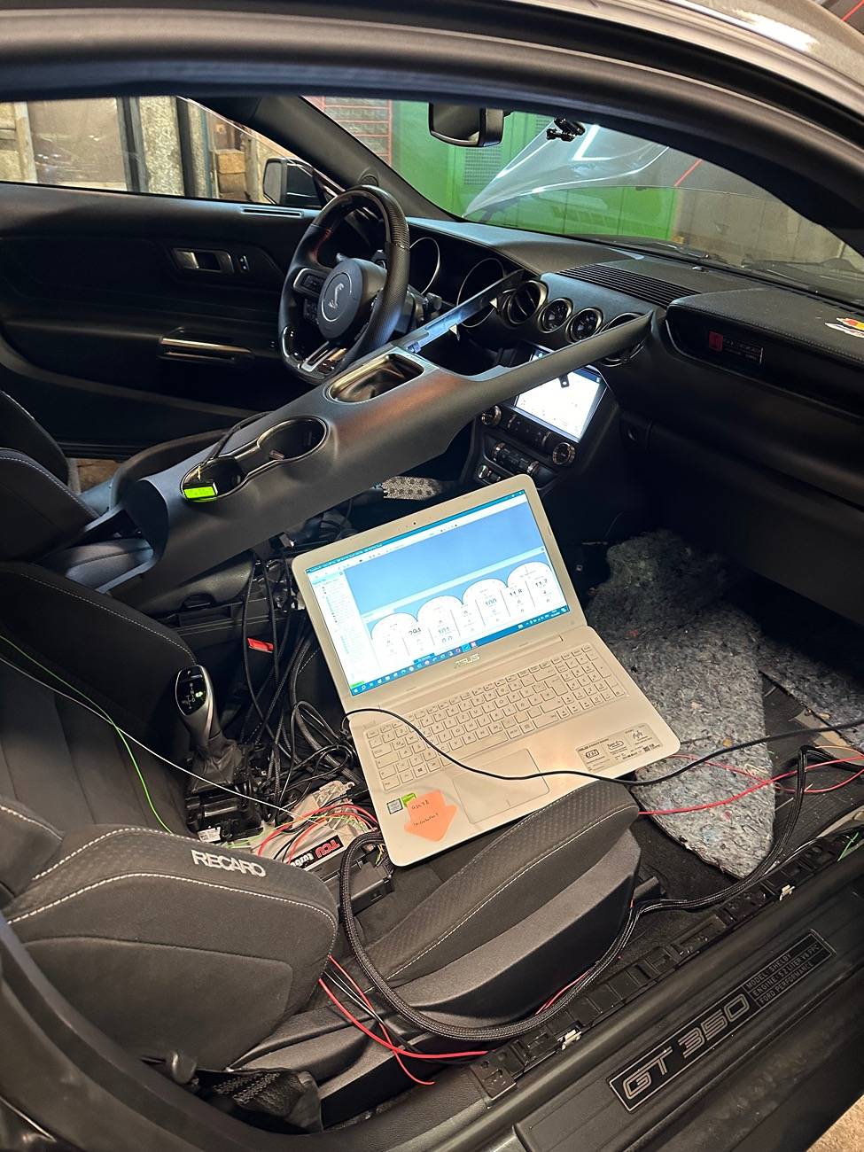

Remote Tuning from Sweden :D. Wiring is mostly done for driving. I can already engage neutral with the bmw shifter. No errors in the wiring so far. MAP and Throttle also read correct. Once the oil cooler lines are done. I can finally start the car for the first time.

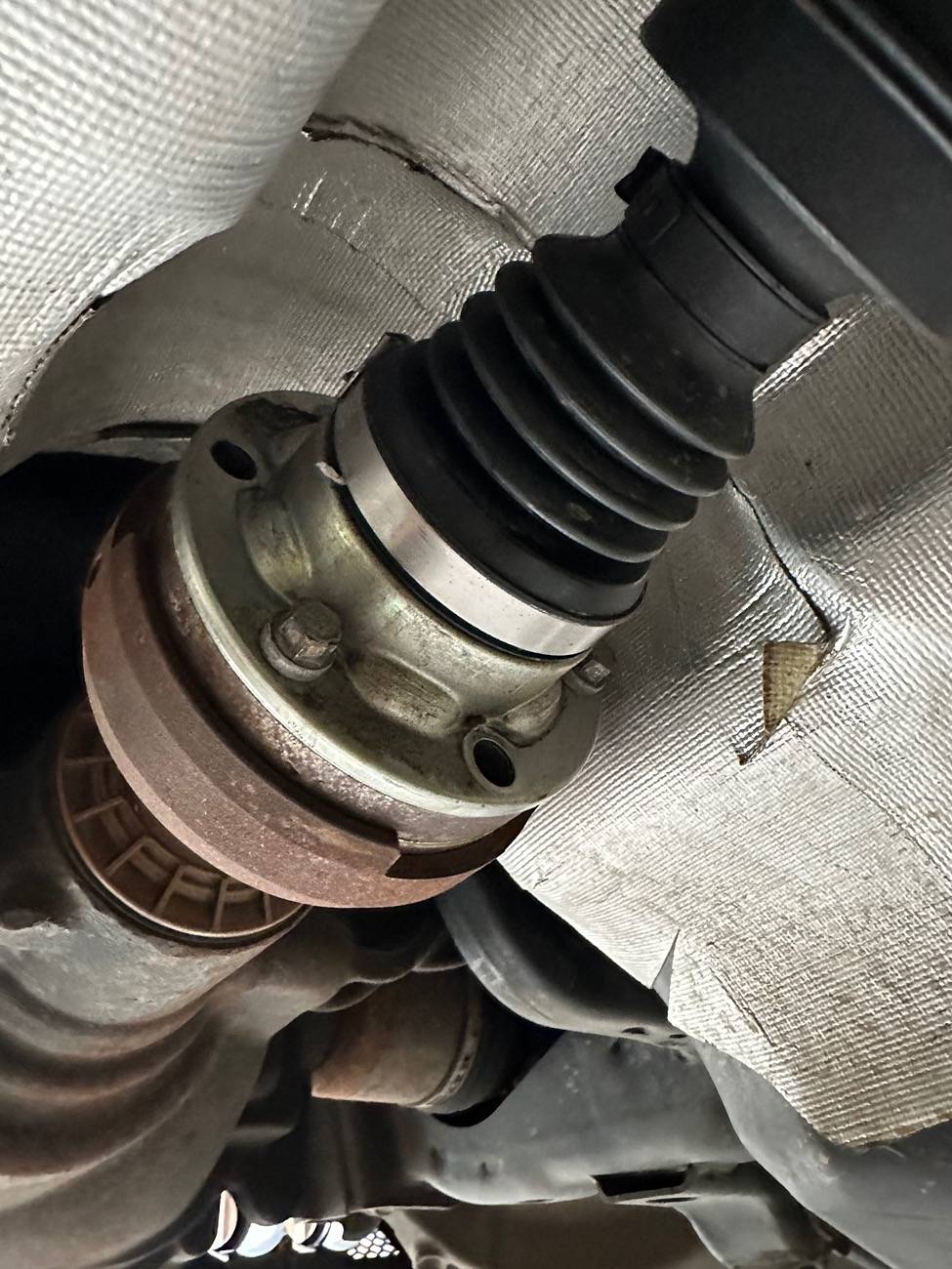

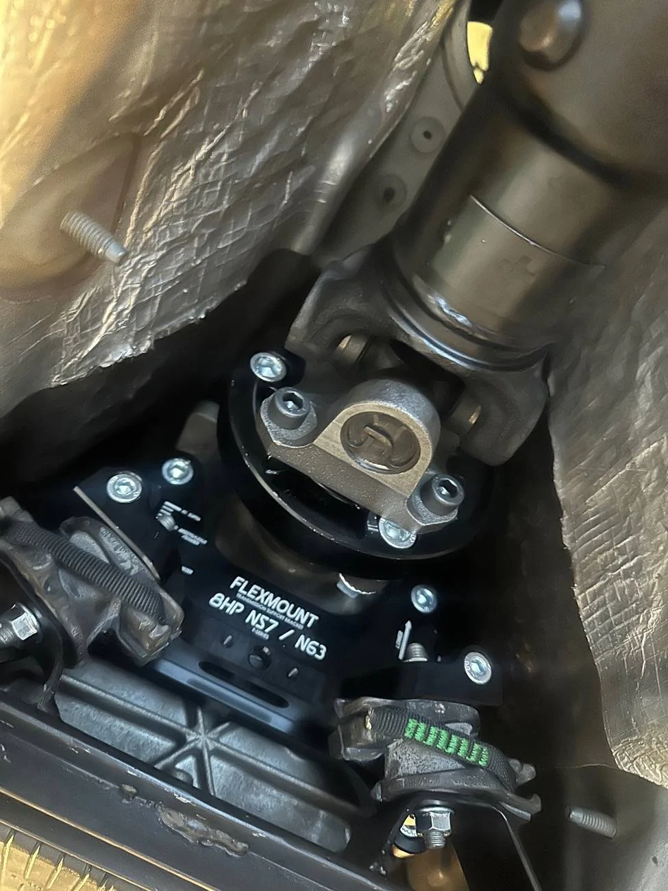

Working driveshaft and oil cooler lines.
Driveshaft is an 2019 automatic mustang shortend by 2cm + a different flange. Its a spicer 3-2-119.

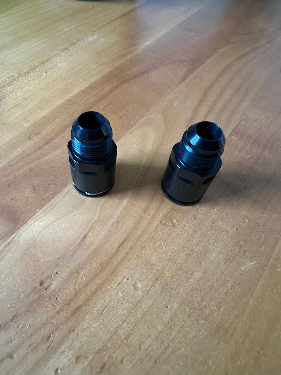

Oil cooler adapter was also quite something you need the mmr transmisison cooler adapter (Not the Engine oil cooler! Its a bigger diameter than the trans oil cooler.) + You need 2 ford oem adapters (MR3Z-6K741-A).
I already started the car and after many errors i already can engage drive and reverse. I still have a couple of software related issues which i get tuned out hopefully tomorrow or next week for a test drive video(:

Also does anyone know where to get a stable RPM Signal? I currently use the Coil Plug 1 Negative but on higher inputs it’s not really stable. Maybe the crank sensor?

For the RPM problem i think there is the Tach Adapter 9117. Was also thinking that it might be because i soldered the signal wire which is usually not good because of resistance. I think before diving deeper into that i'm trying my luck on the crank position sensor.
