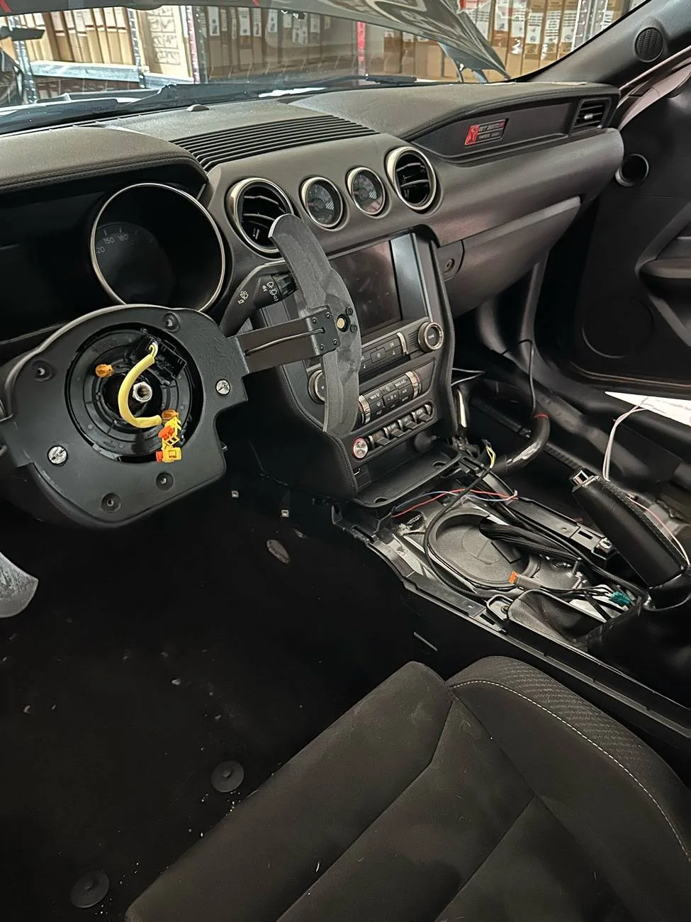

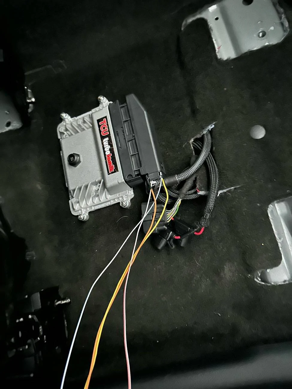

Paddle Shifters are mounted! The paddles themselfs are not the final design but i ran out of the right filament and they are good enough for now.
Paddles and clutch pedal sensors are wired in and are already functional.
The only things missing now is the mount for the clutch pedal sensor which i'm working while writing this (printer goes brrt)
