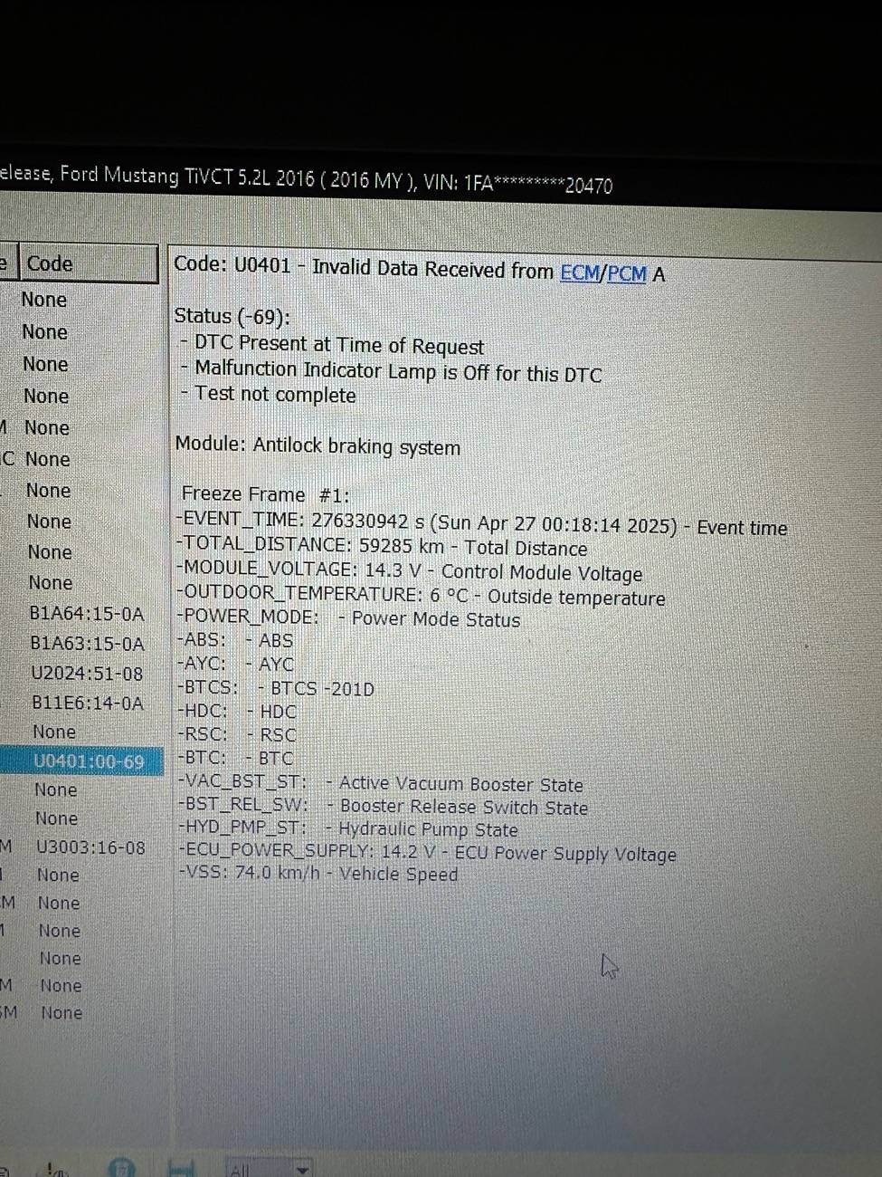

Issue is after sometimes 20 minutes or 1 or a hard pull i get a see manual error (DTC U0401)

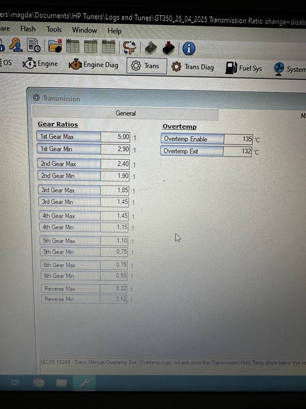

After that i flashed the pcm with Hptuners to somewhat match the 8 gear ratio in a 6gear table.

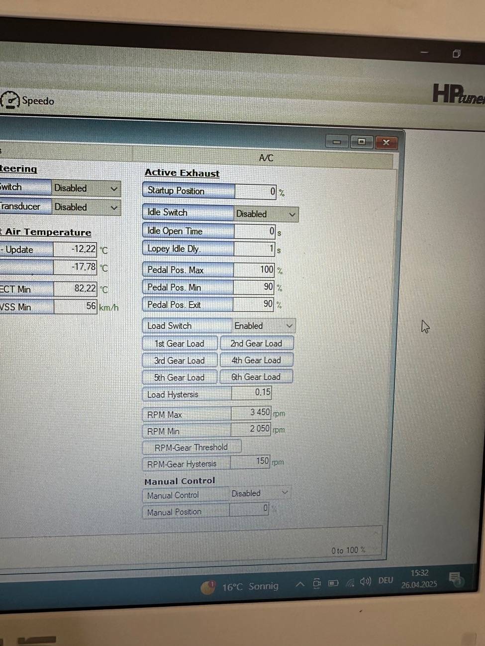

Which seems to have done something but not with the error(( The active exhaust close works again but this time in 8 gear instead of 6/wish it didn't work haha. But i found out in Hp tuners you can now make the active exhaust behave like you want.

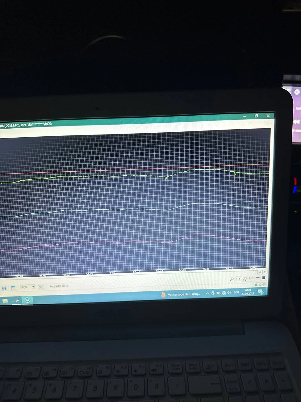

After playing a bit with forscan i looked at the signal from the oss sensor that the pcm receives (the green line)and it looks like the pcm misses a few pulses. So for now i try to lower the voltage sensitivity to get a better reading.
If that doesn't work, i'm kinda lost on the oss stuff 😭

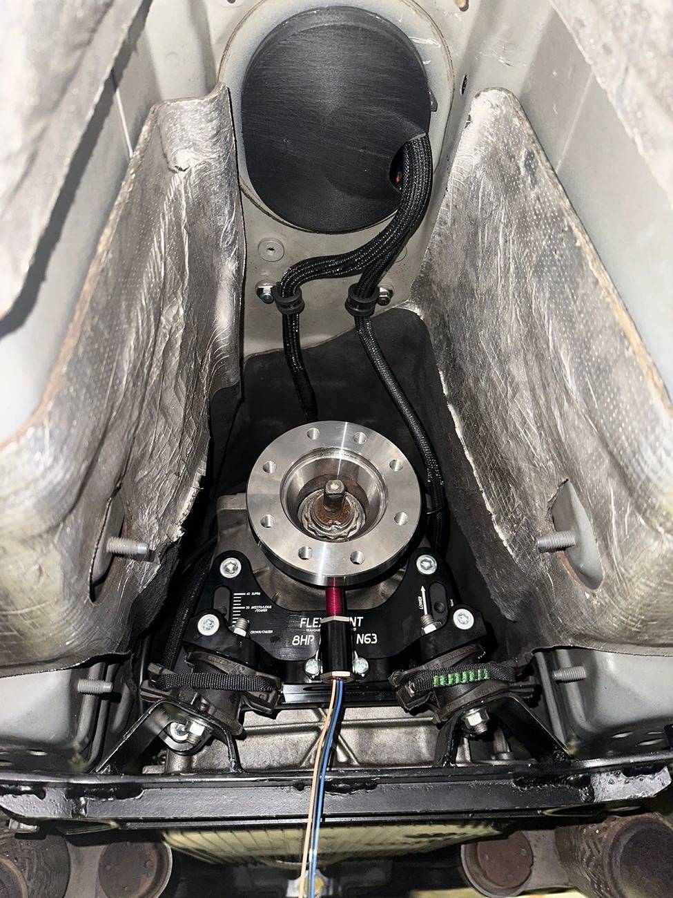

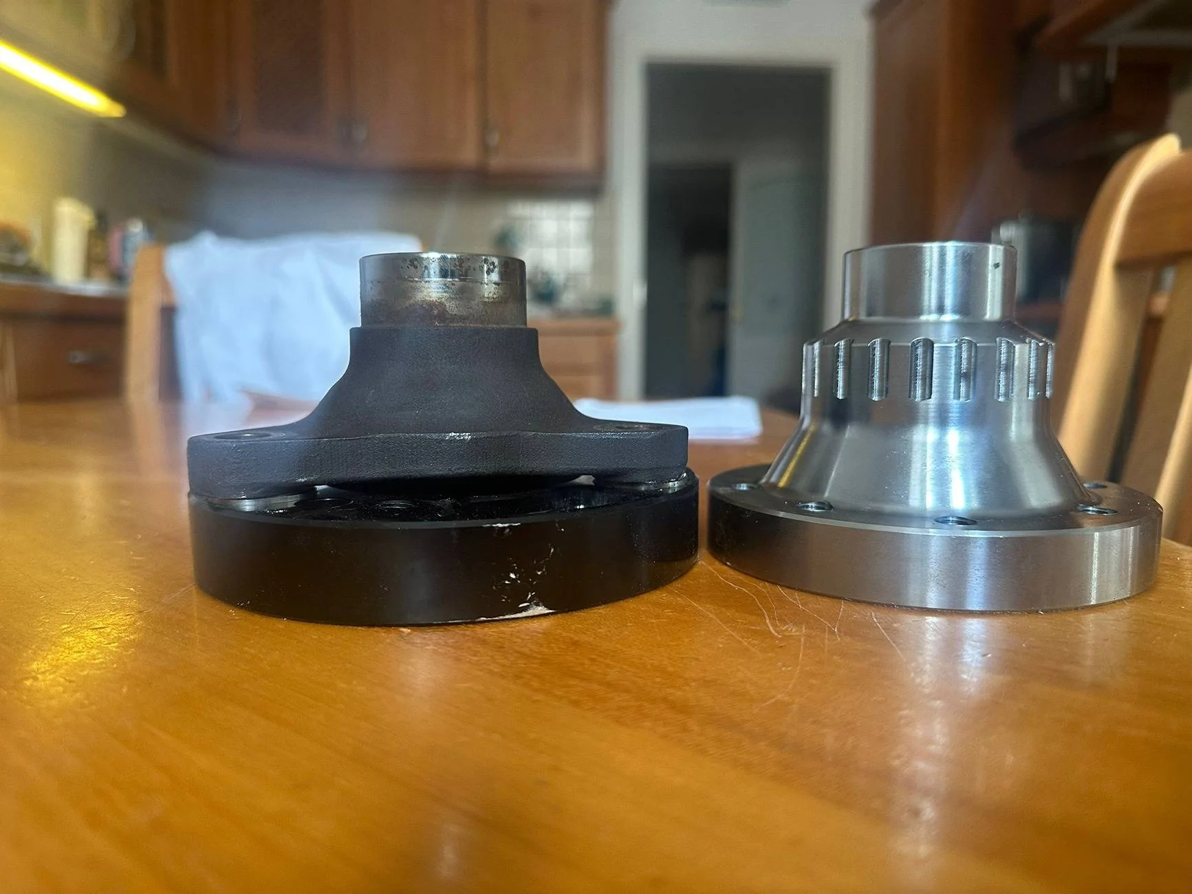

After wrist surgery, I’m back at it, still working on the frustrating VSS/OSS issue. At first, I tried using a Schmitt trigger to clean up the signal into a proper square wave, but I’m still getting the same random dropouts lasting about half a second. That makes me think it’s not a signal quality issue, but more likely the TCU introducing slight errors that are tolerable for the tachometer but not acceptable for the PCM i guess. So, I’ve decided to ditch the VSS output from the Turbolamik entirely and go with an external sensor instead.
For that, I needed a new output flange with an integrated tone ring. On the left is the old setup, on the right is the new single piece flange that also replaces the OEM output flange.
Red is the new OSS sensor just need to wire it in. Additionally I need something too divide the signal. I'm pretty sure the OEM teeth count is lower than I have.

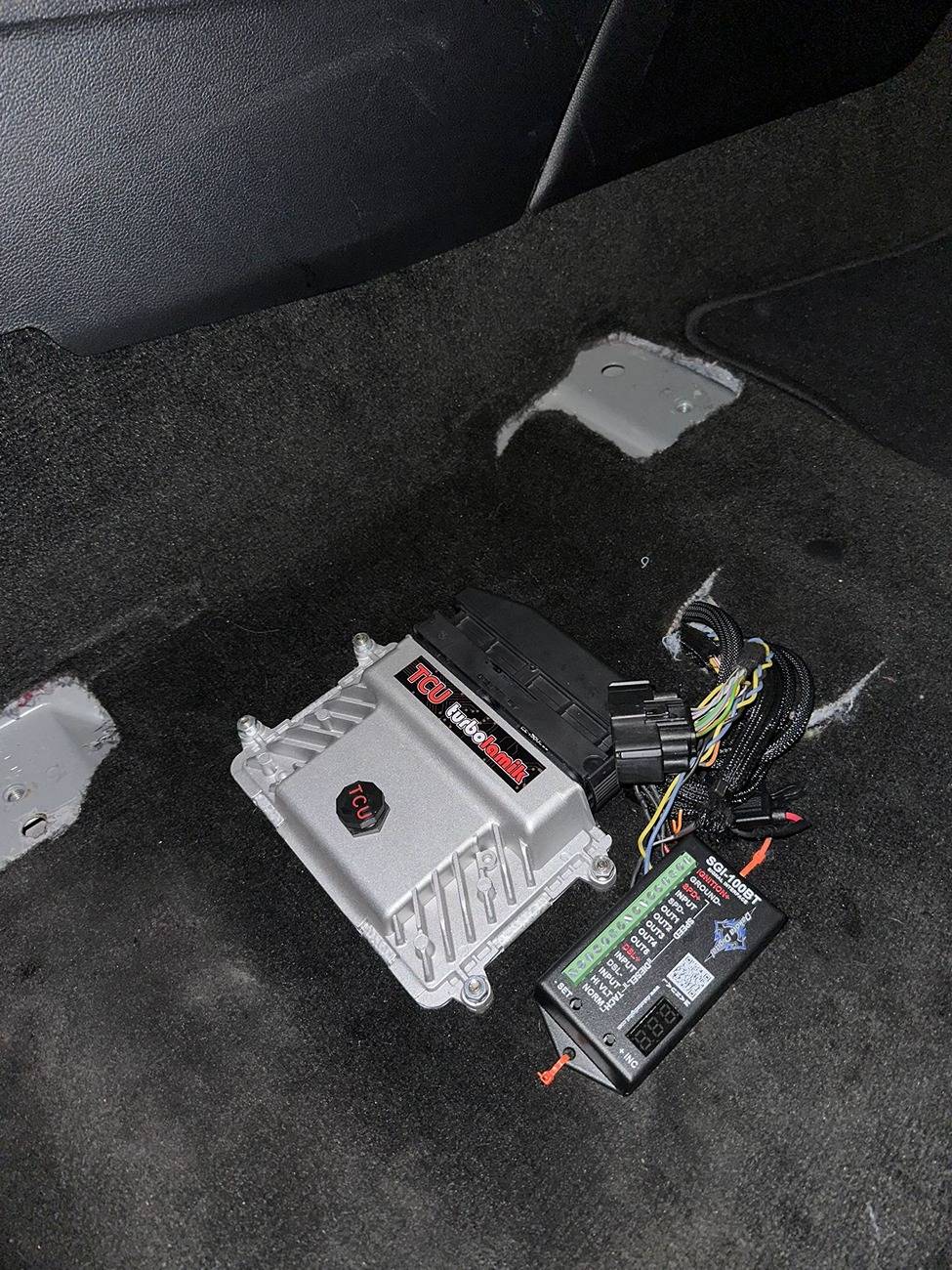

Okay, I've got the setup running. It reads the OSS speed from the new 20 tooth flange. I'm using a Dakota Digital SGI-100BT (which, to be clear, shouldn't be used for ABS/PCM sensor data, it specifically says not to, but I had no other option). I scale the signal down by 0.6 so the PCM still sees the 12 tooth pattern it expects.
The signal is much cleaner now, but I'm still getting the same error. This makes me suspect the issue isn't with the sensor itself, but possibly with the PCM's configurable gear ratio settings in HP Tuners.
That said, the car shifts much nicer now. I figure it's either stability control cutting torque or some other behind the scenes magic trickery, but it's clear the OSS signal is affecting shifting behavior somehow.

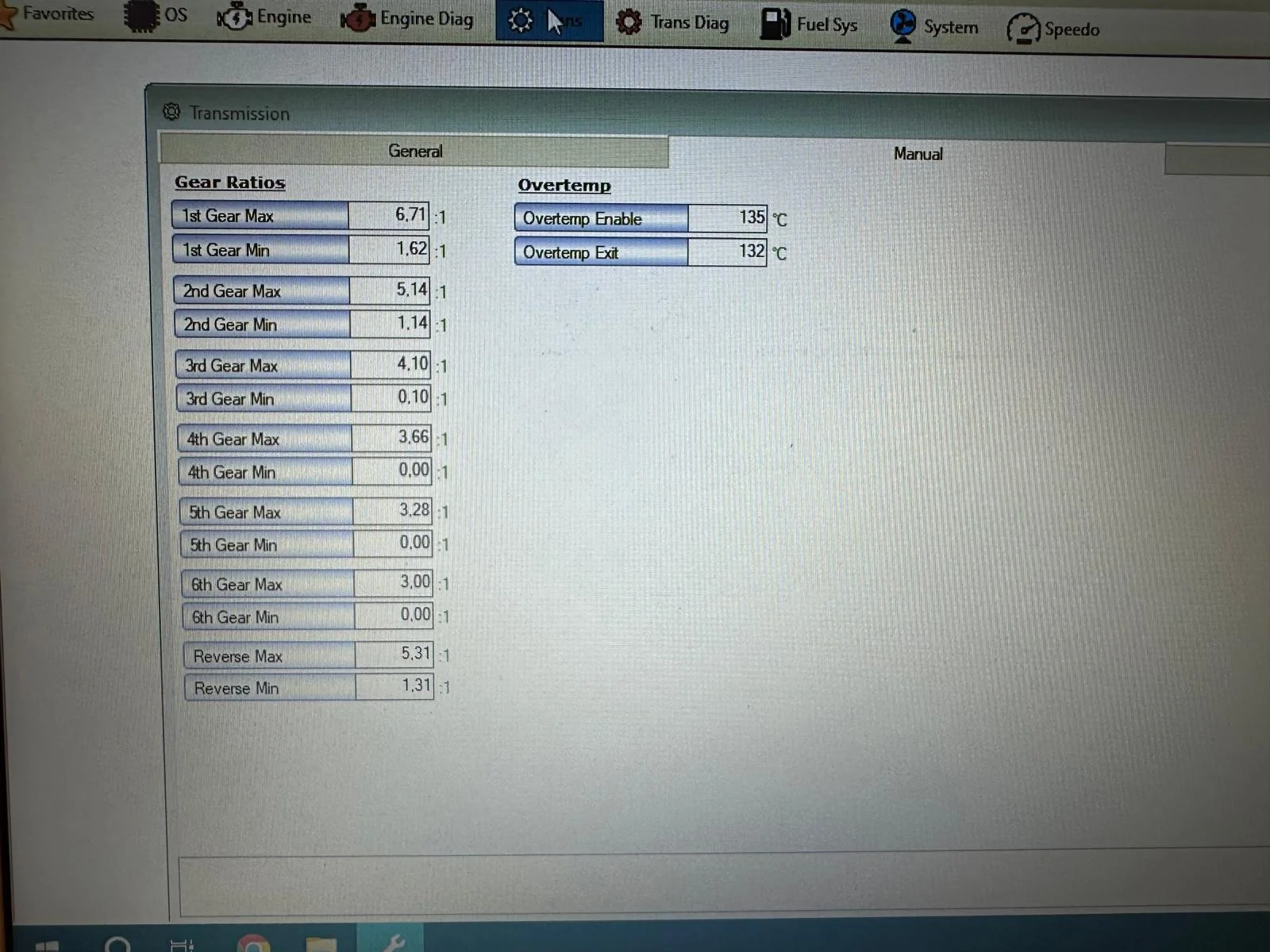

Figured it out! No more errors and everything works. Cruise control, stability control, abs, no more weird things going on(:
The culprit was actually this table:
I guess something is up with the error detection so i just increased the threshold significantly.
I bet the unstable OSS also played it's role, but that is also gone.

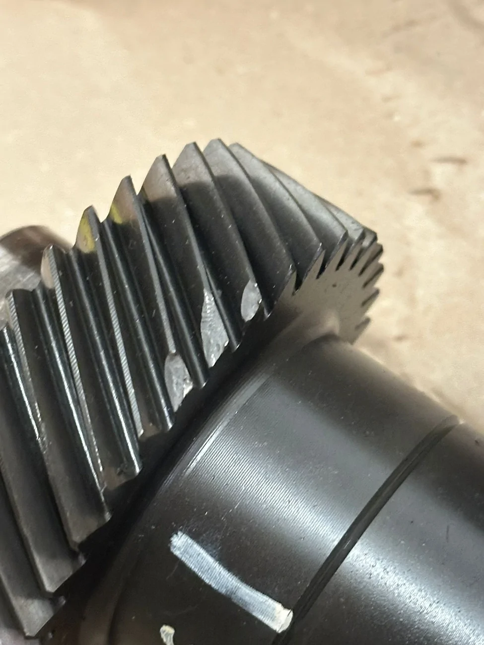

I’m currently reverting back to the Tremec. I’m pretty much finished, just need to reinstall the transmission after it was repaired for 6k€ and after a 4 month wait 😭
On my TR3160, not only did the synchros wear, but a gear on the input shaft was also missing a couple tooth edges.
