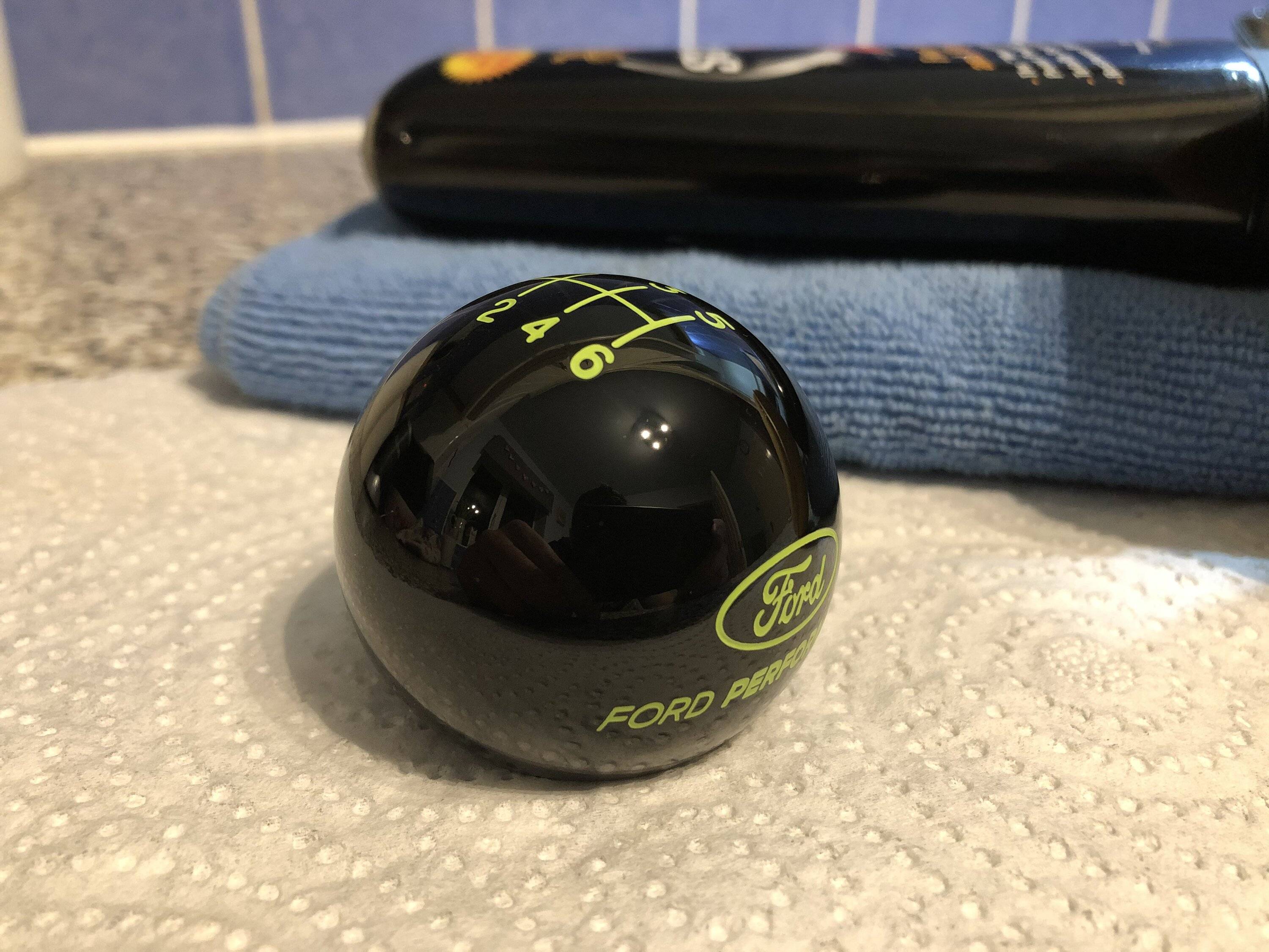

I’ve been knob polishing again ... :giggle:

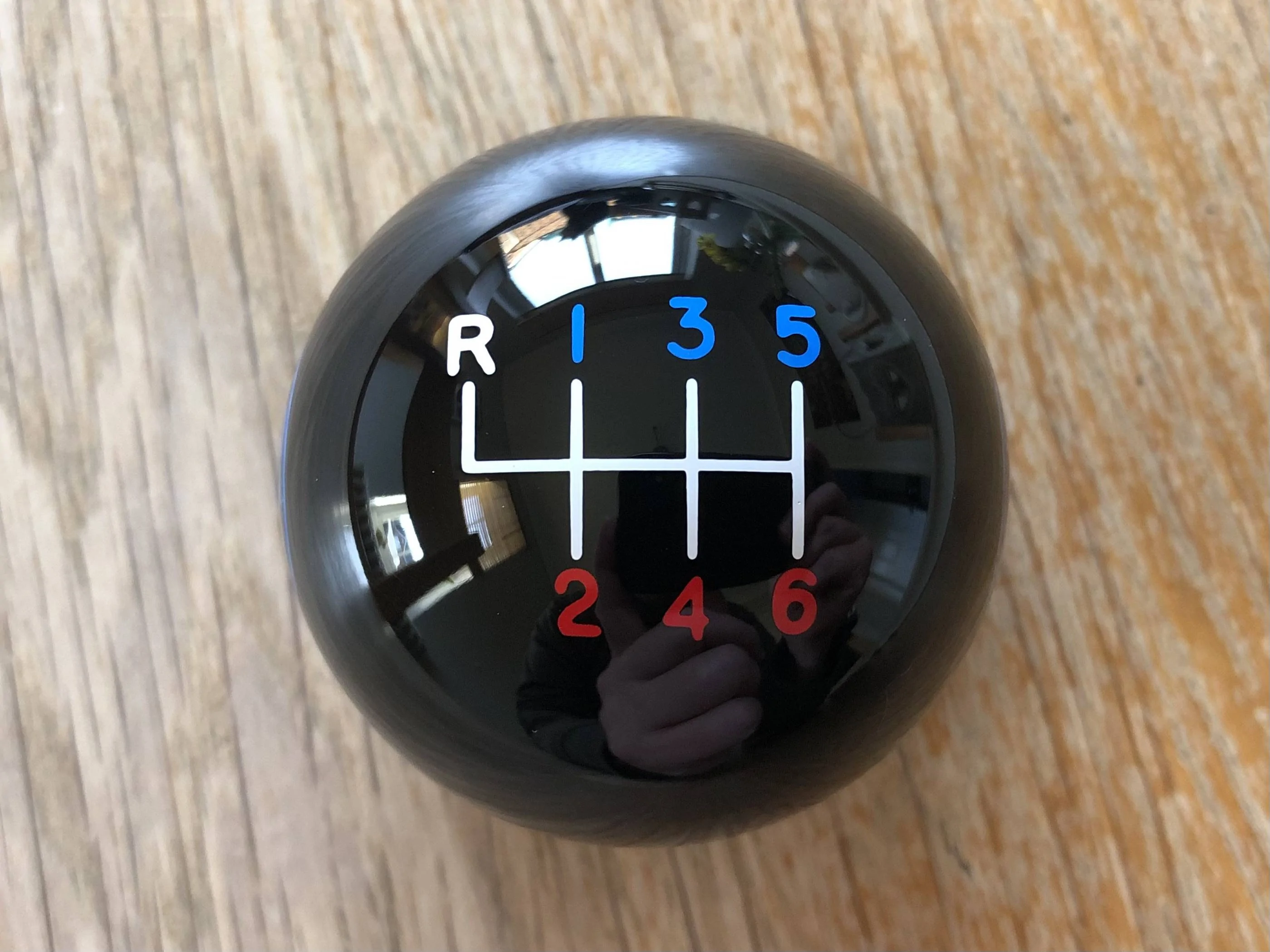

My original Grabber Lime :
Which made me think about doing a 'Patriot' ...

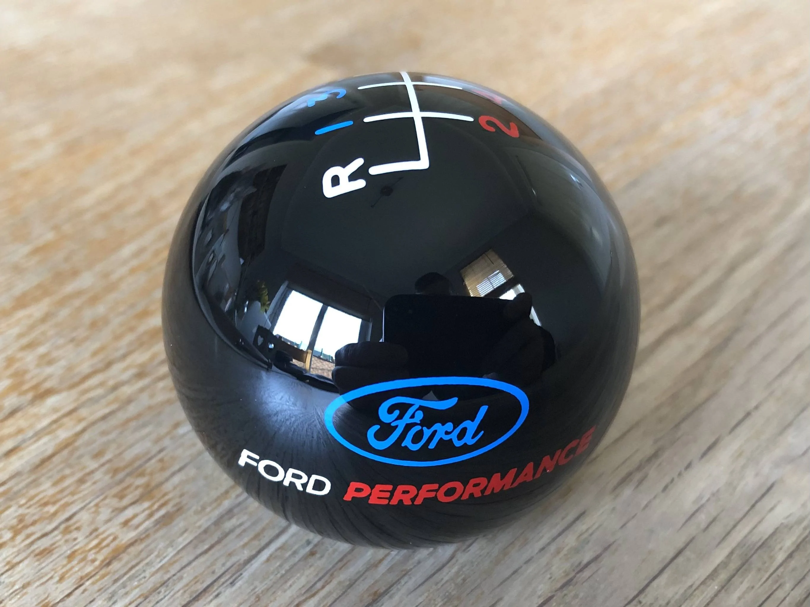

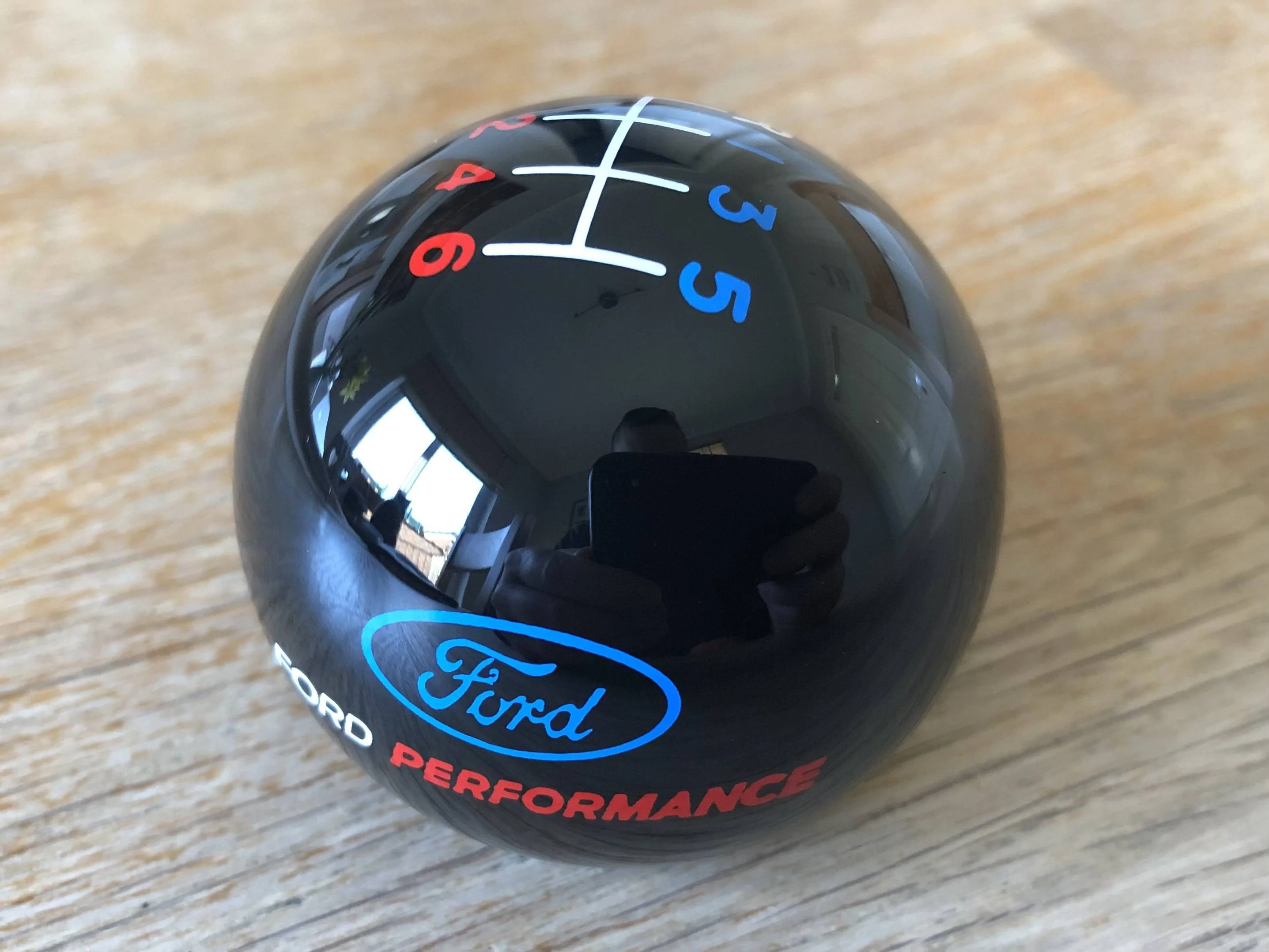

So I bought a second knob from @Alfa Male and after a bit of TLC, it cleaned up really well :sunglasses:
The new knob came with a chip :
And the typical poor finish around the base (although this one is better than I remember mine being) :
After a quick rub on some wet n dry :
I measured before and after and I had to take 0.95mm off to remove the chip - if it was just the rough finish, I guess about 0.25mm would have easily done it :like:
I’m aware that it could make hiding the top of the reverse collar a bit more tricky, but I think the knobs probably have larger tolerances that might affect that fit (like the depth of the relief and the start position of the thread on the insert compared to the one on the shaft etc).
My recollection of the first knob I did though is that it ended up with a bigger flat - but that one still fits my car / covers the reverse collar perfectly.
So here it is in Race Red, Oxford White and Grabber Blue :
Like everyone else at your next Mustang meet, I also bought a T Shirt (from Tesco) :
Is it naughty of me to wear it driving my GT … ? :shock:

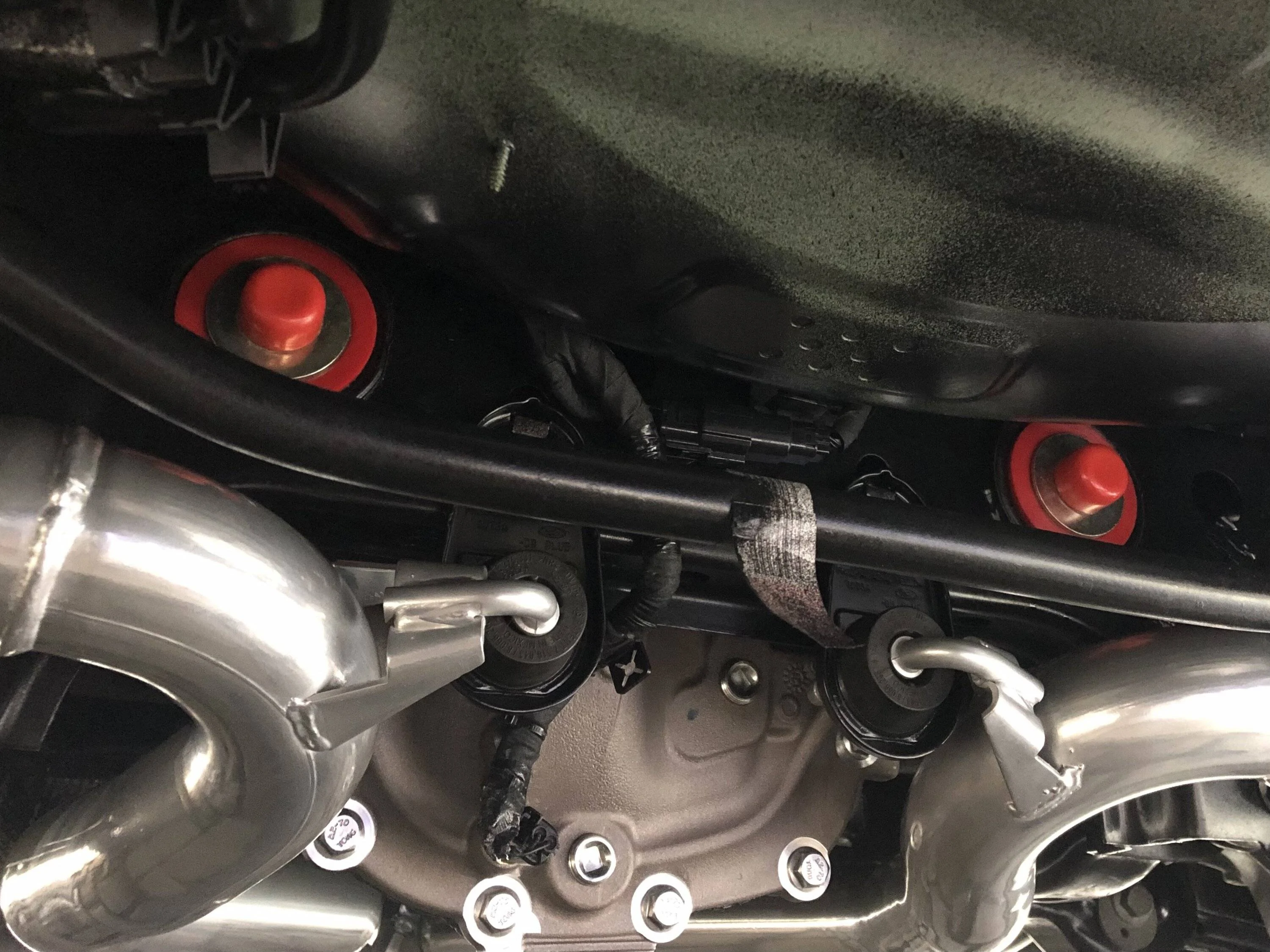

The black oxide 12.9 diff bolts didn't last long over here before I needed to clean, waxoyl and cover them :

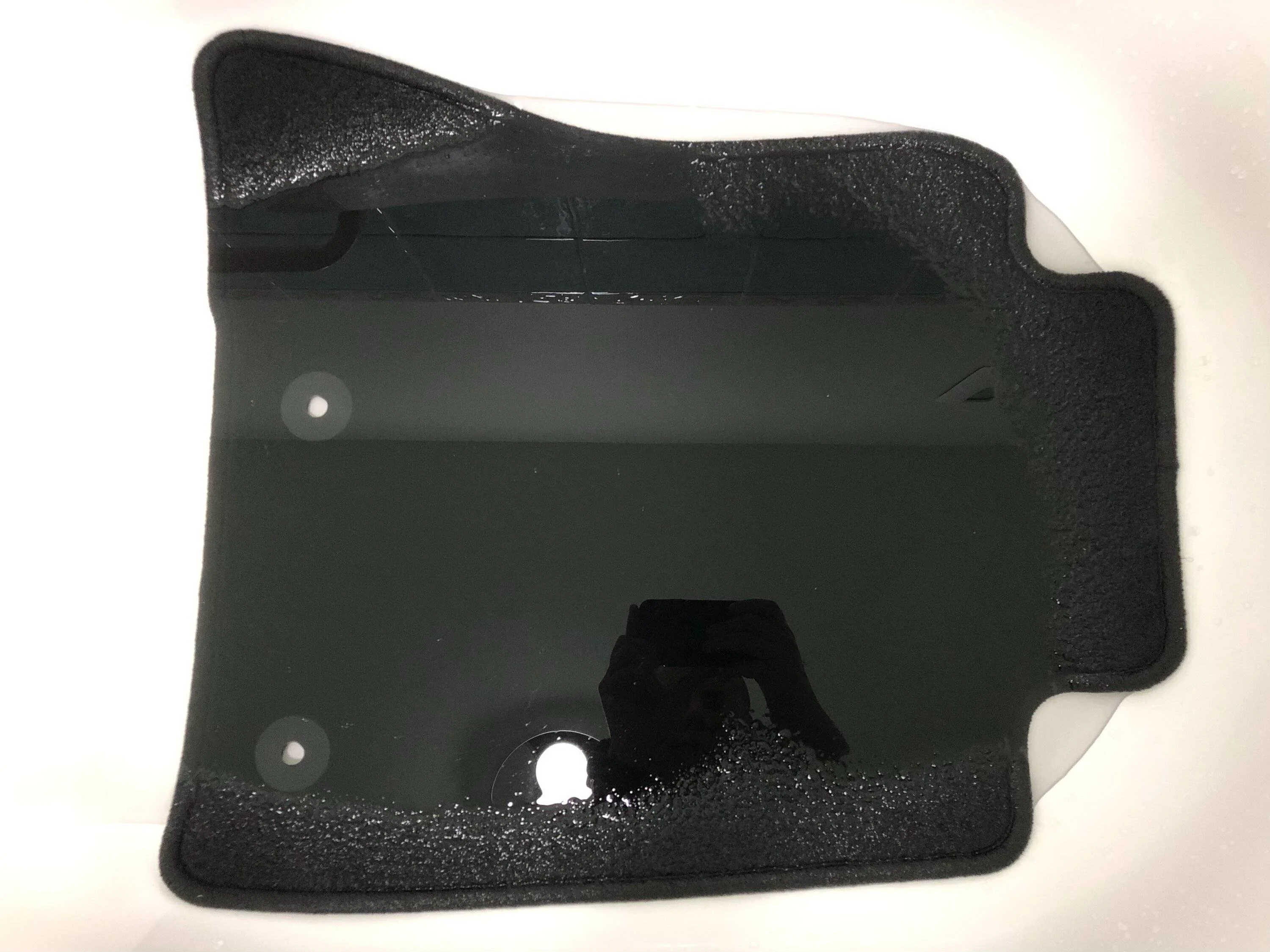

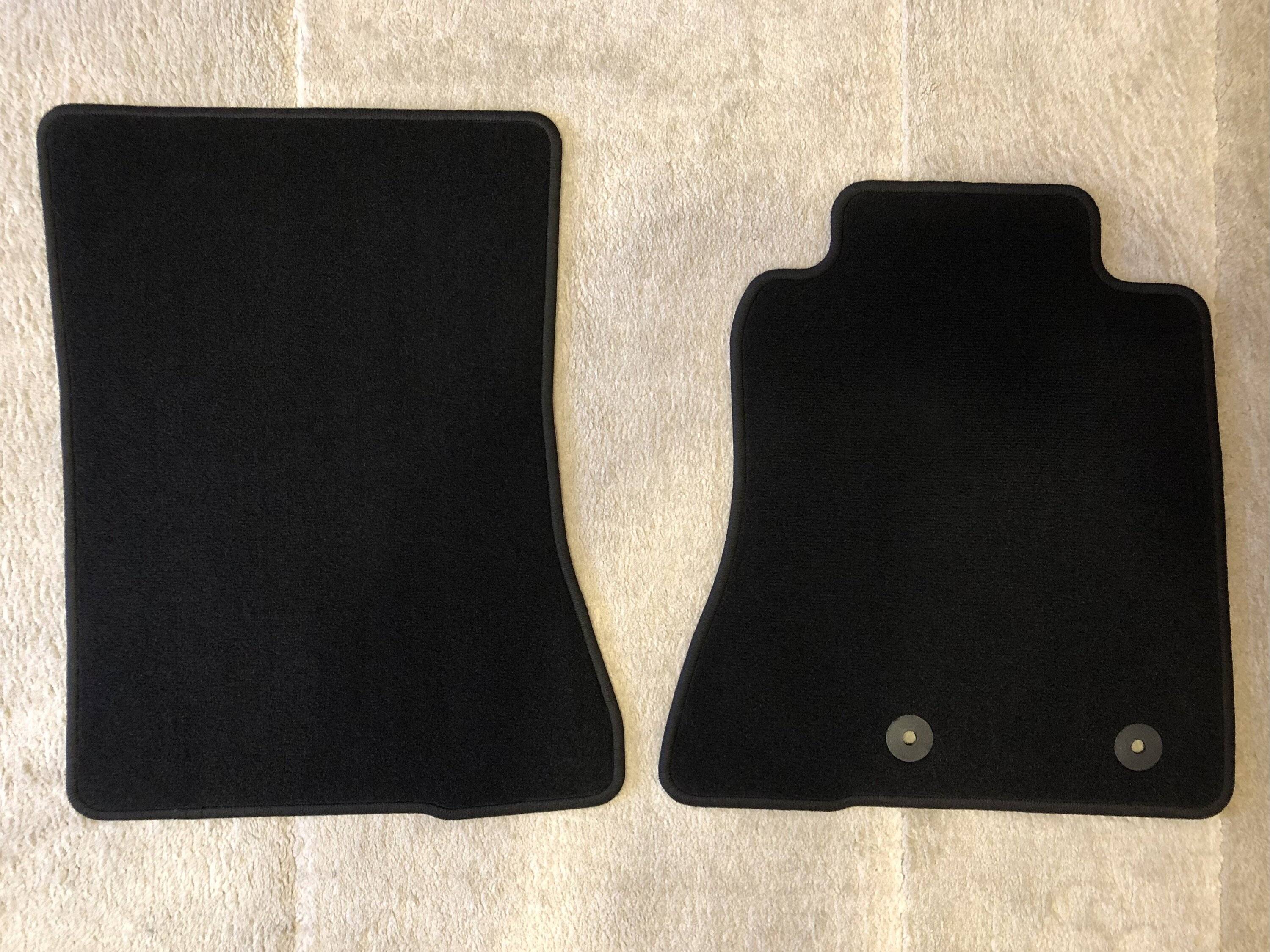

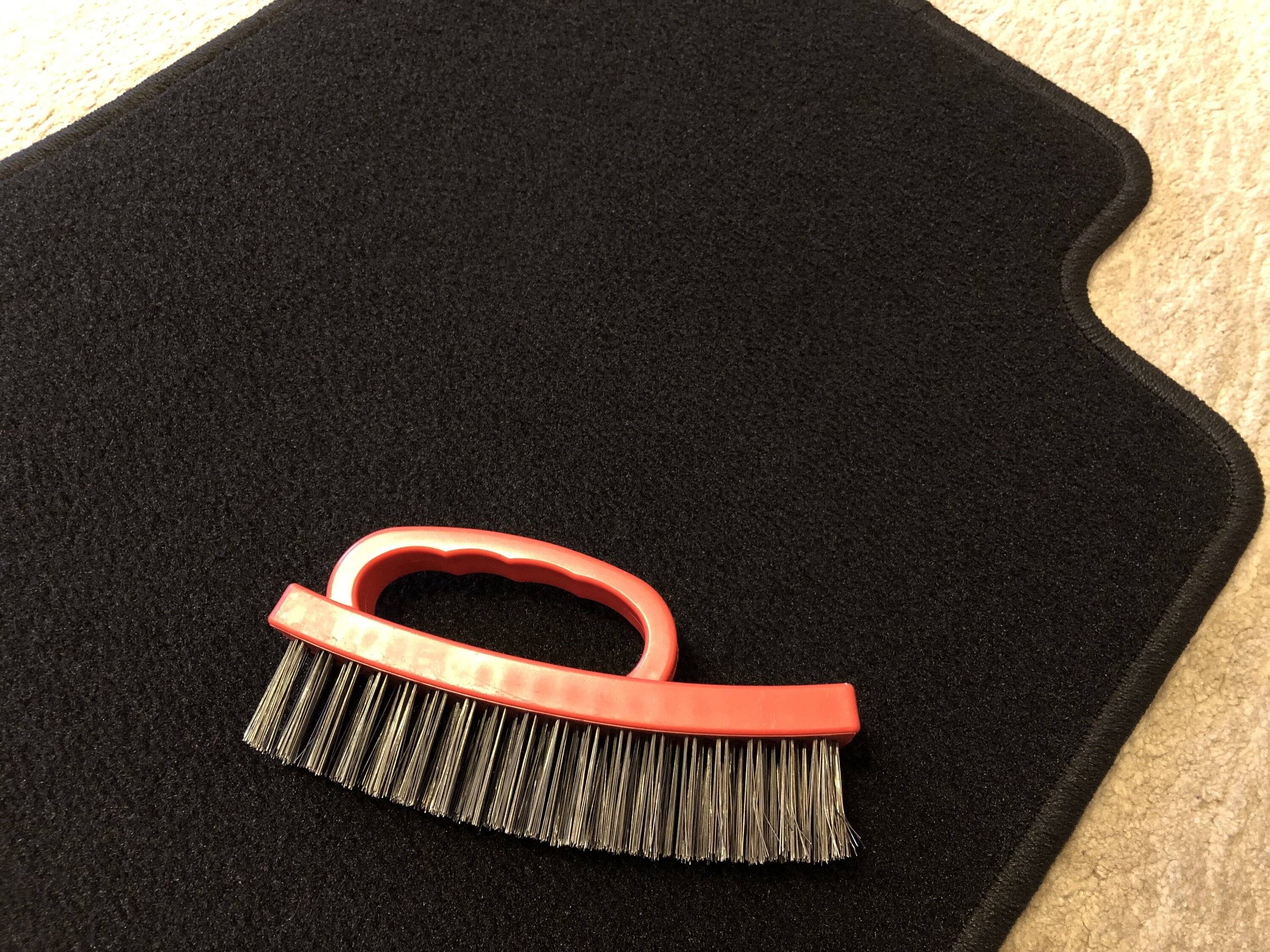

I bought @Alfa Male ‘s second hand mustang mats and although very good condition, they got treated to my normal wash method i.e. chuck them in the bathtub, sprinkle them in shampoo (normally Vosene lol) and hit them with the nail brush :
As expected, very little came out of these mats, they didn't even need a rinse.
I cringe to say this as I know someone will go all out extreme and scrub a hole in their mat, but careful use of a wire brush does wonders to lift flattened pile around the heel area etc :
Done and (hopefully) ready for some embroidery :wink:

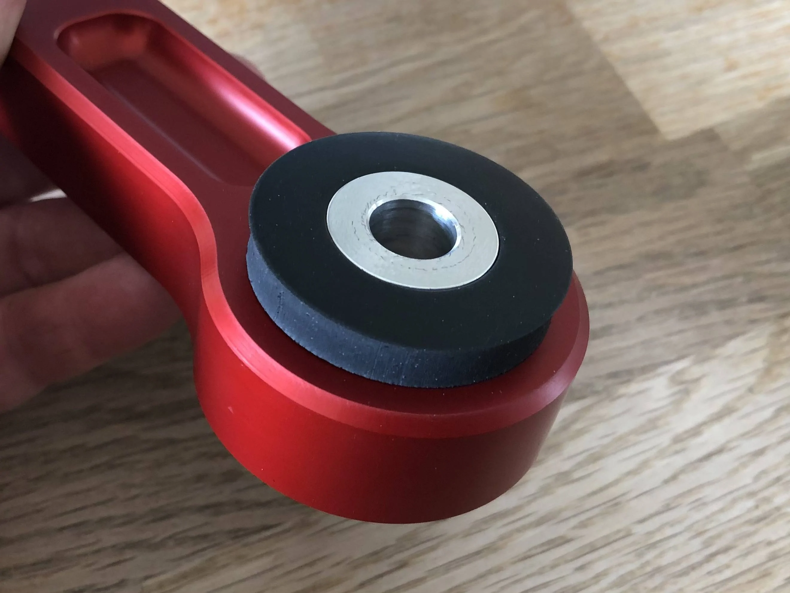

After messing around under the back end a bit lately, I thought some eye candy was in order :

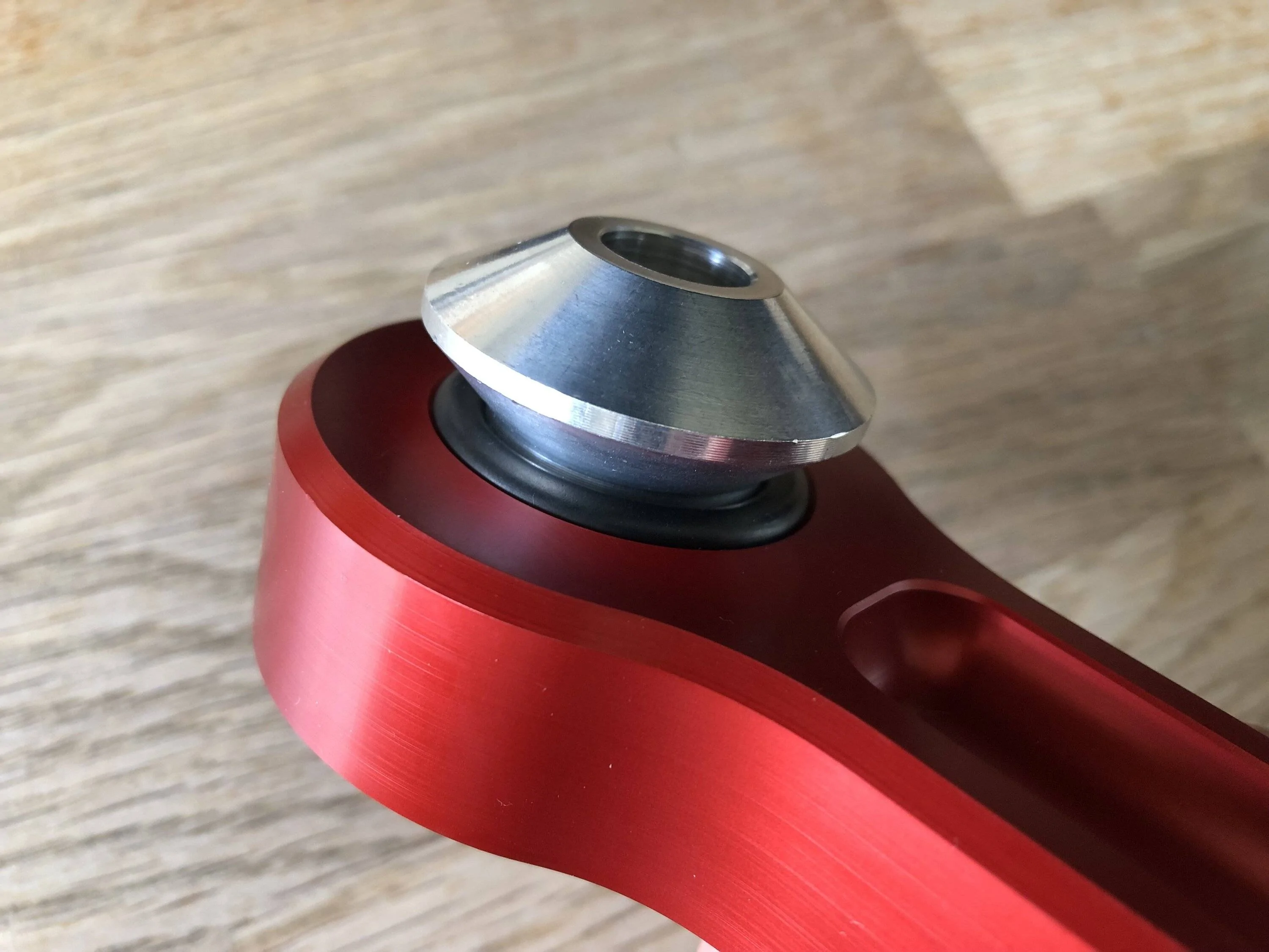

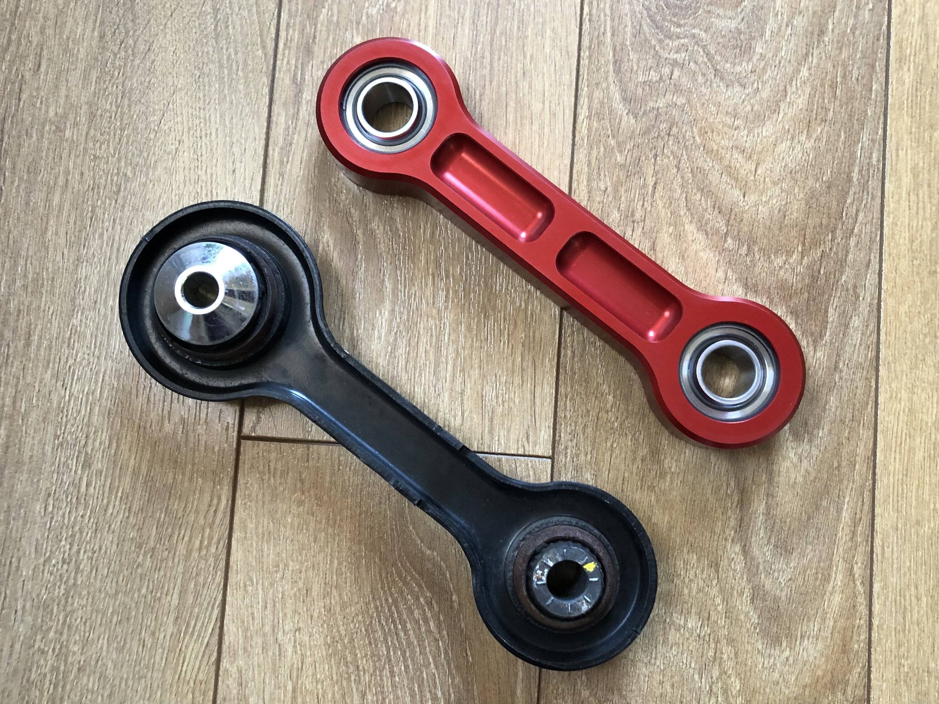

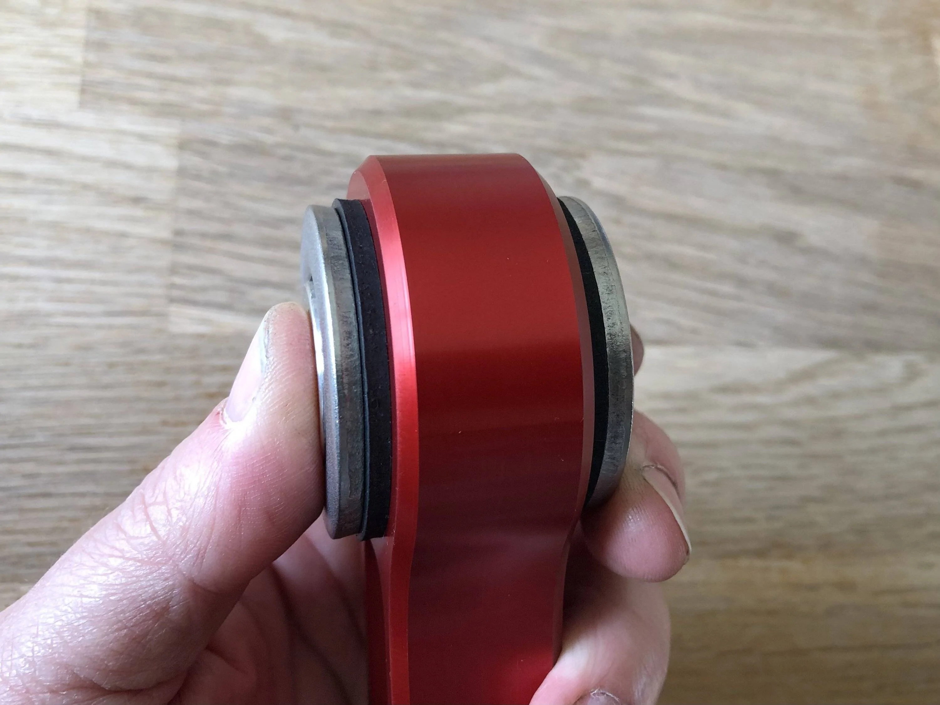

I had heard (no pun intended) that due to having a spherical bearing in both ends, the links can pivot over time and then foul / rub on the mating components potentially causing some noise, so …
Bottom mount both sides - rubber and stainless washers :
Top inwards facing - O ring sits nicely in the joint :
Top outwards facing - rubber washer behind the OE safety washer :
I will cover all mating faces in a waterproof grease and wipe off the excess after assembly.
Hopefully that will keep them quiet and add a bit of long term dust protection for the bearings.
These are currently being held to ransom though - I can’t fit them until my birthday … :facepalm: :giggle:

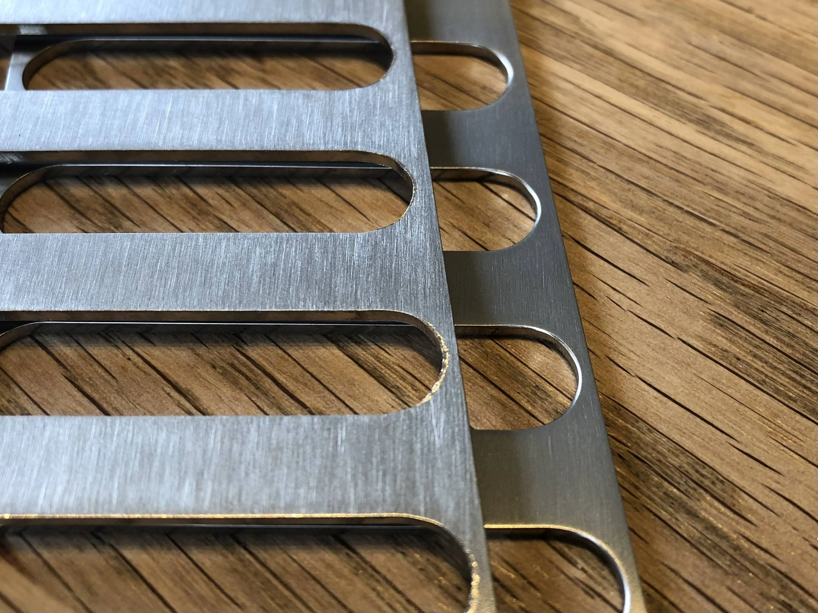

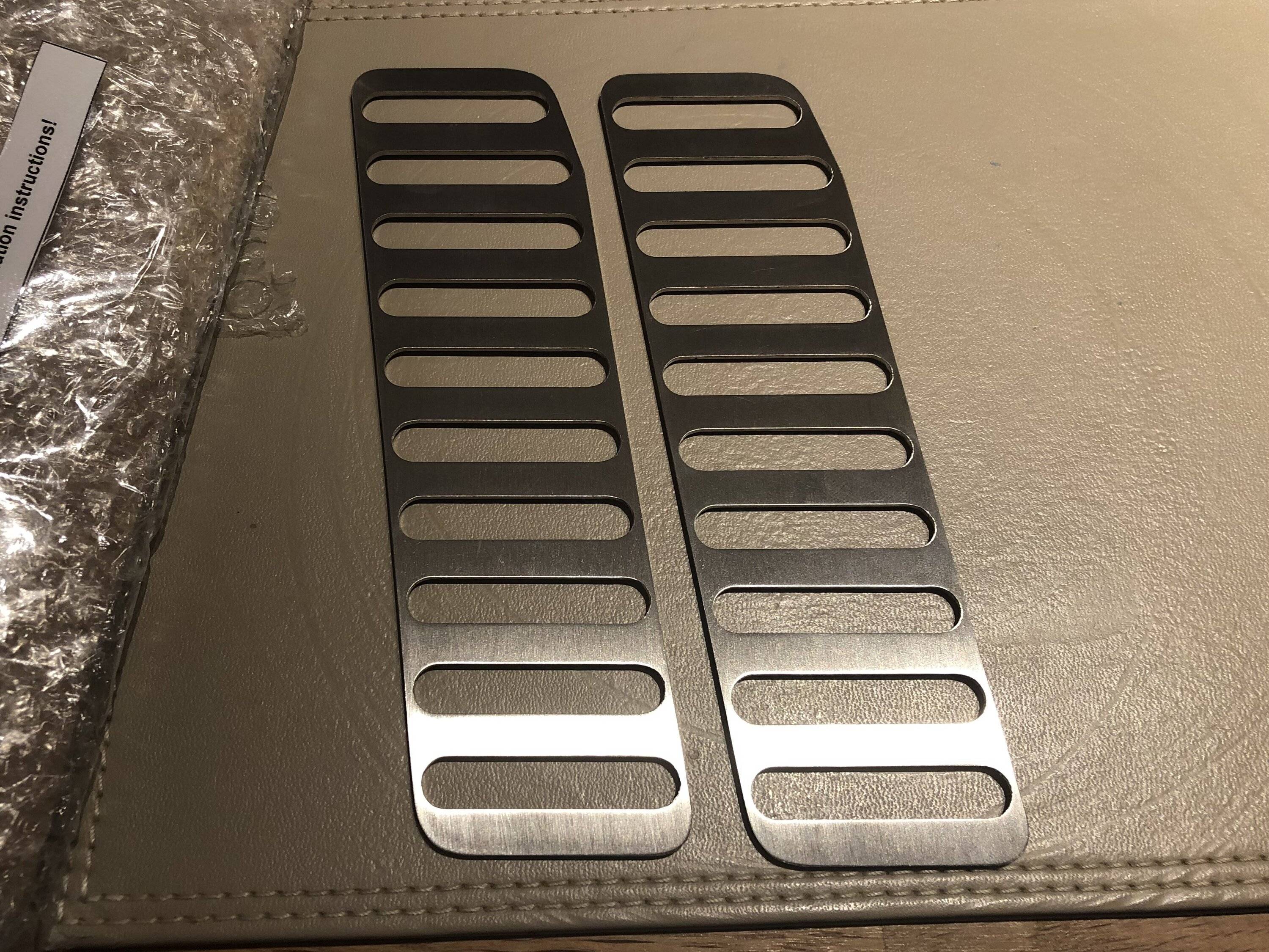

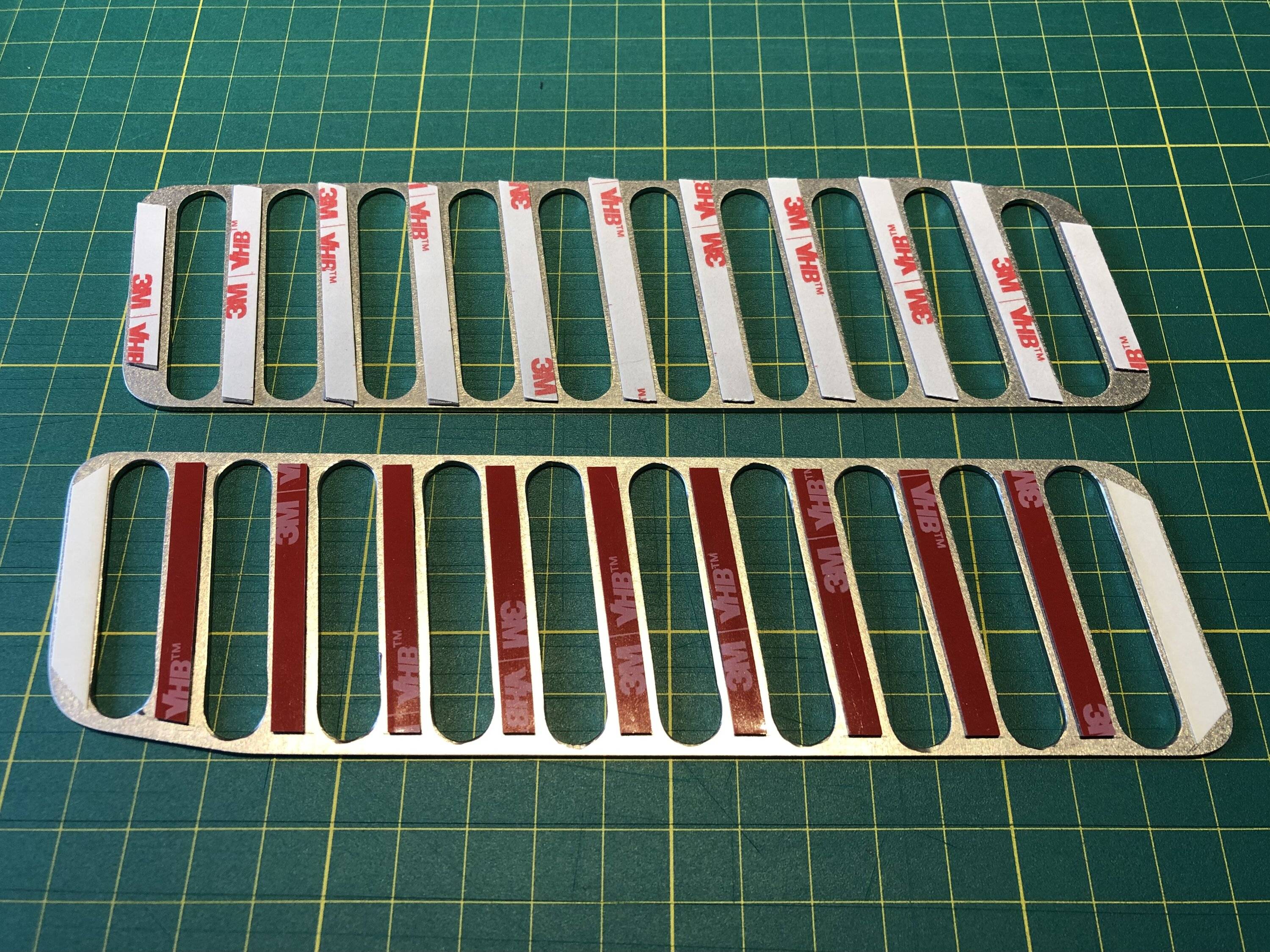

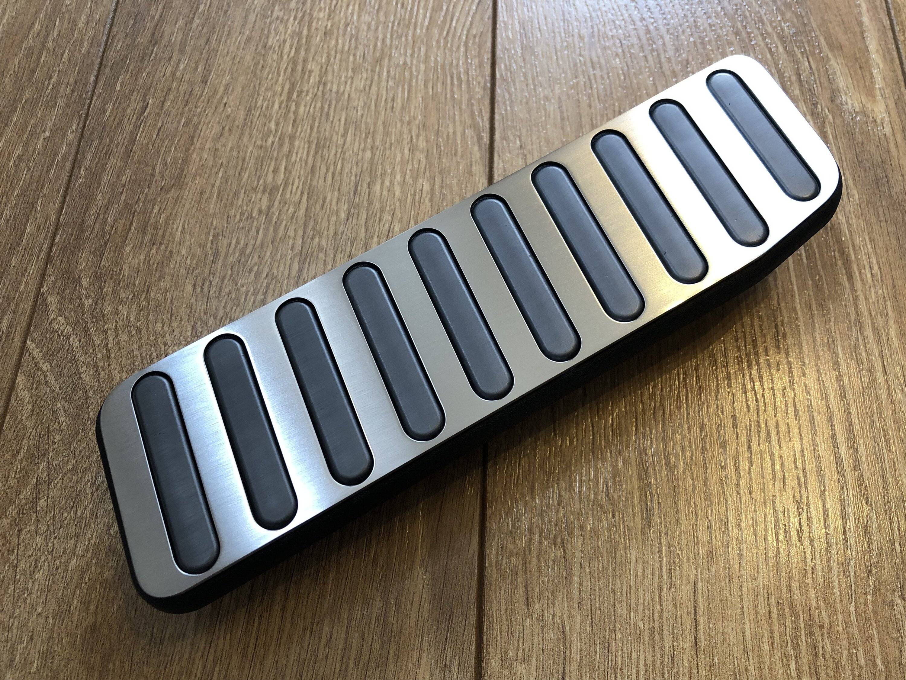

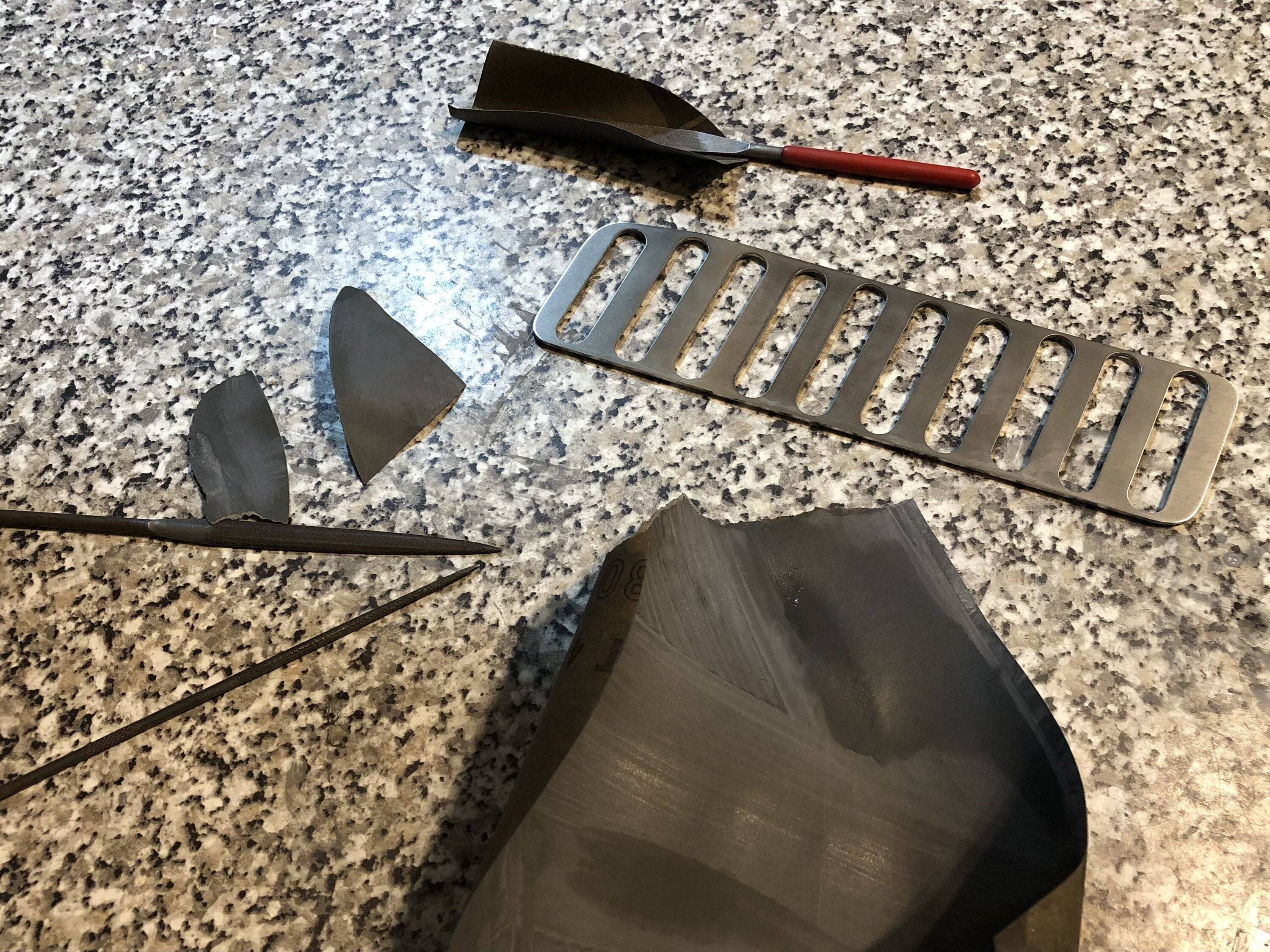

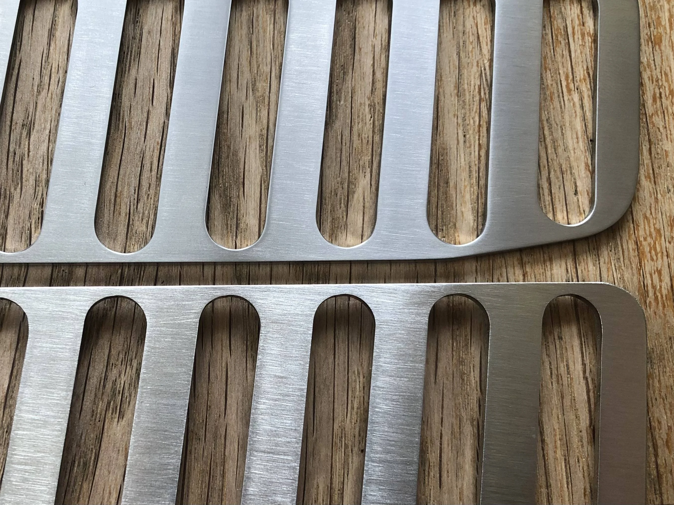

After a bit of a search, I finally managed to find RHD specific dead pedal covers, so we bought two and I split the costs with @Tinpot (they are from Germany 🇩🇪) :

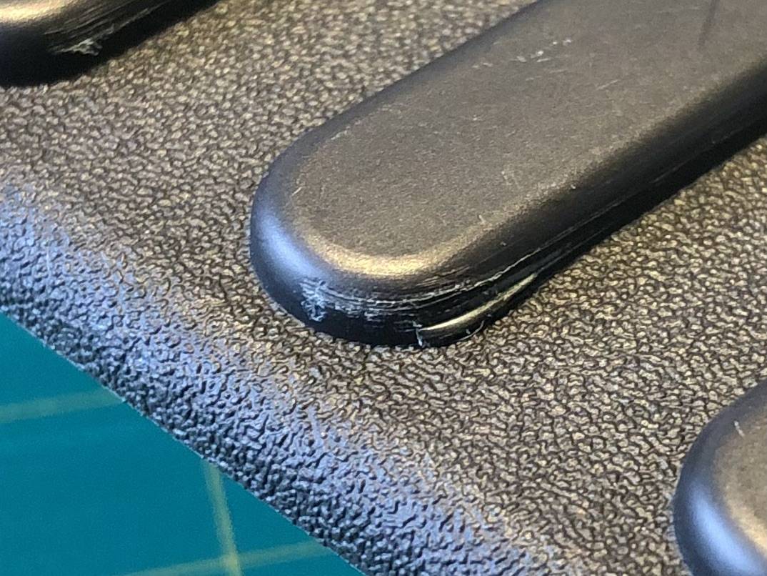

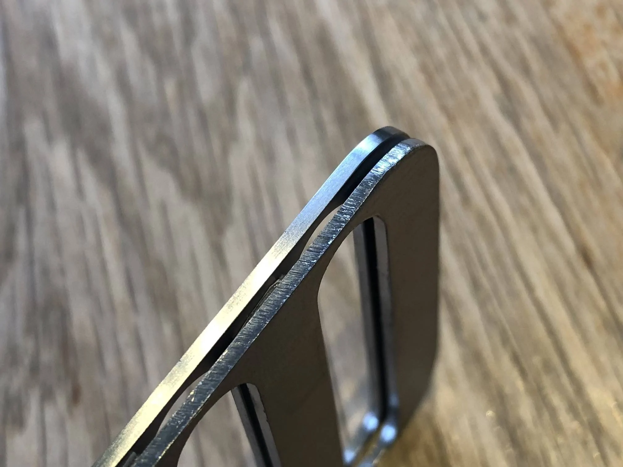

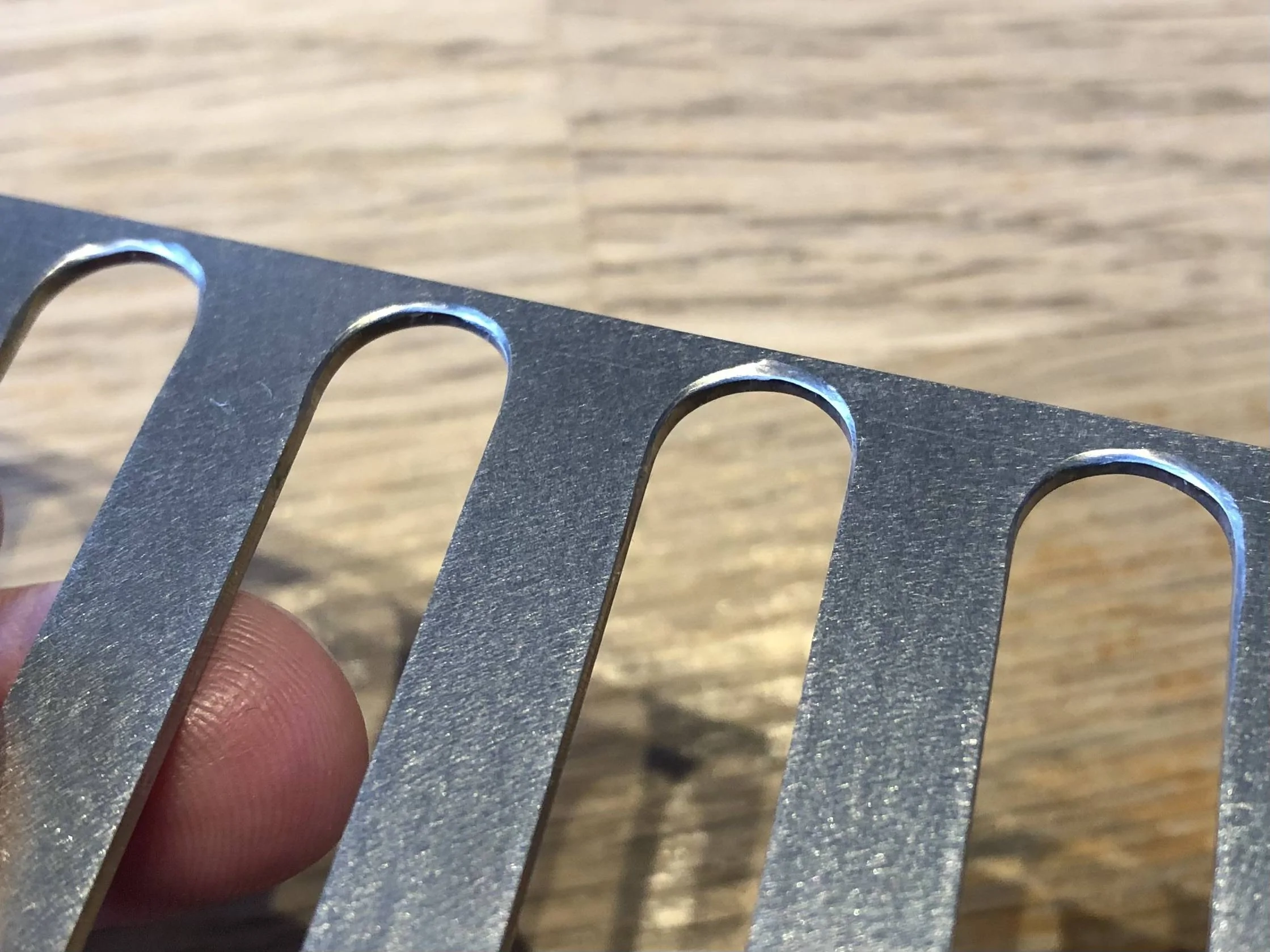

Me being me though, I had to fiddle with it - and ended up sending far to much time getting mine exactly as I wanted it … :facepalm:
Some needle files and a bit of wet n dry :
Allowed be to knock back the brushed finish a bit (top cover) :
Dress up the internal rads a little better :
Remove the laser marks from the perimeter :
And then to stop this :
Dremel the sharp edges / burrs off the back :
Then I re taped the back (bottom cover) and used thinner tape at the ends to allow for the shape of the Ford plastic piece (that wouldn’t flatten out fully, even with the heat gun) :
The cover is much easier to apply with the plastic piece off the car (it simply clips out) and keeping it in the house for a few days will give the 3M tape a better chance to bond :

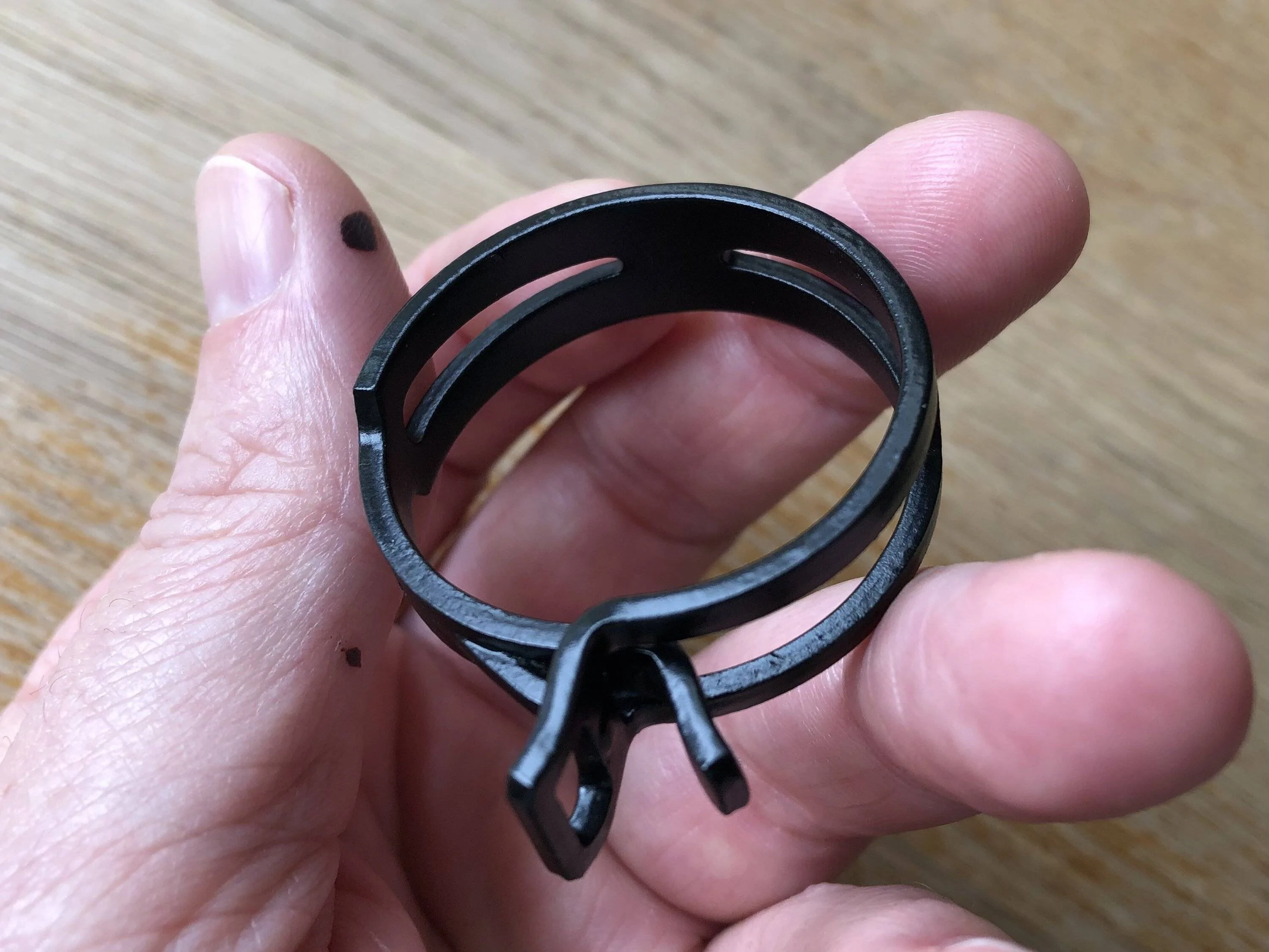

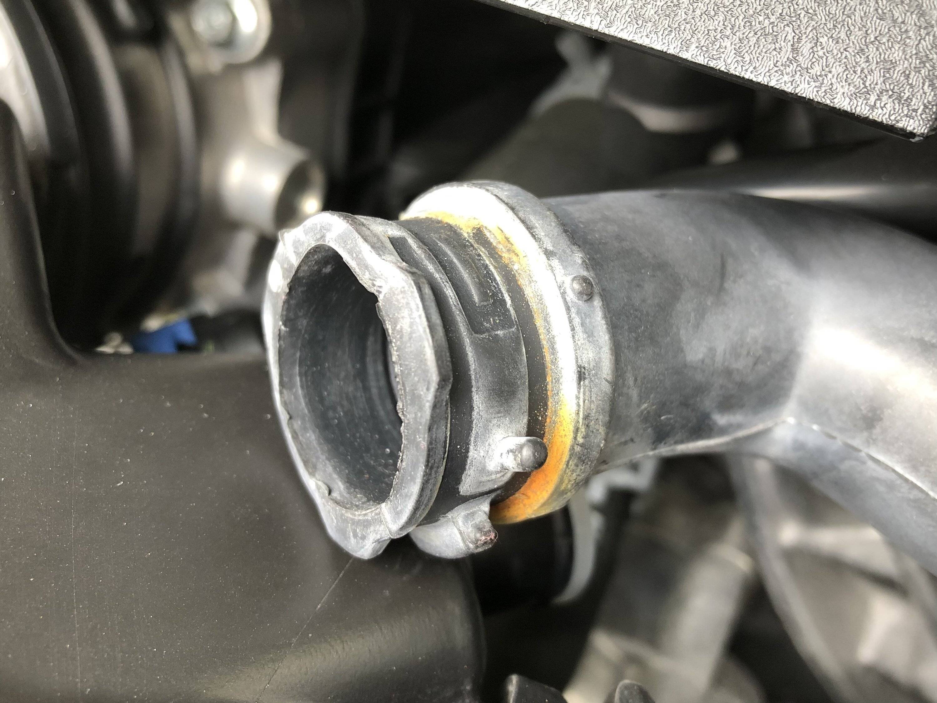

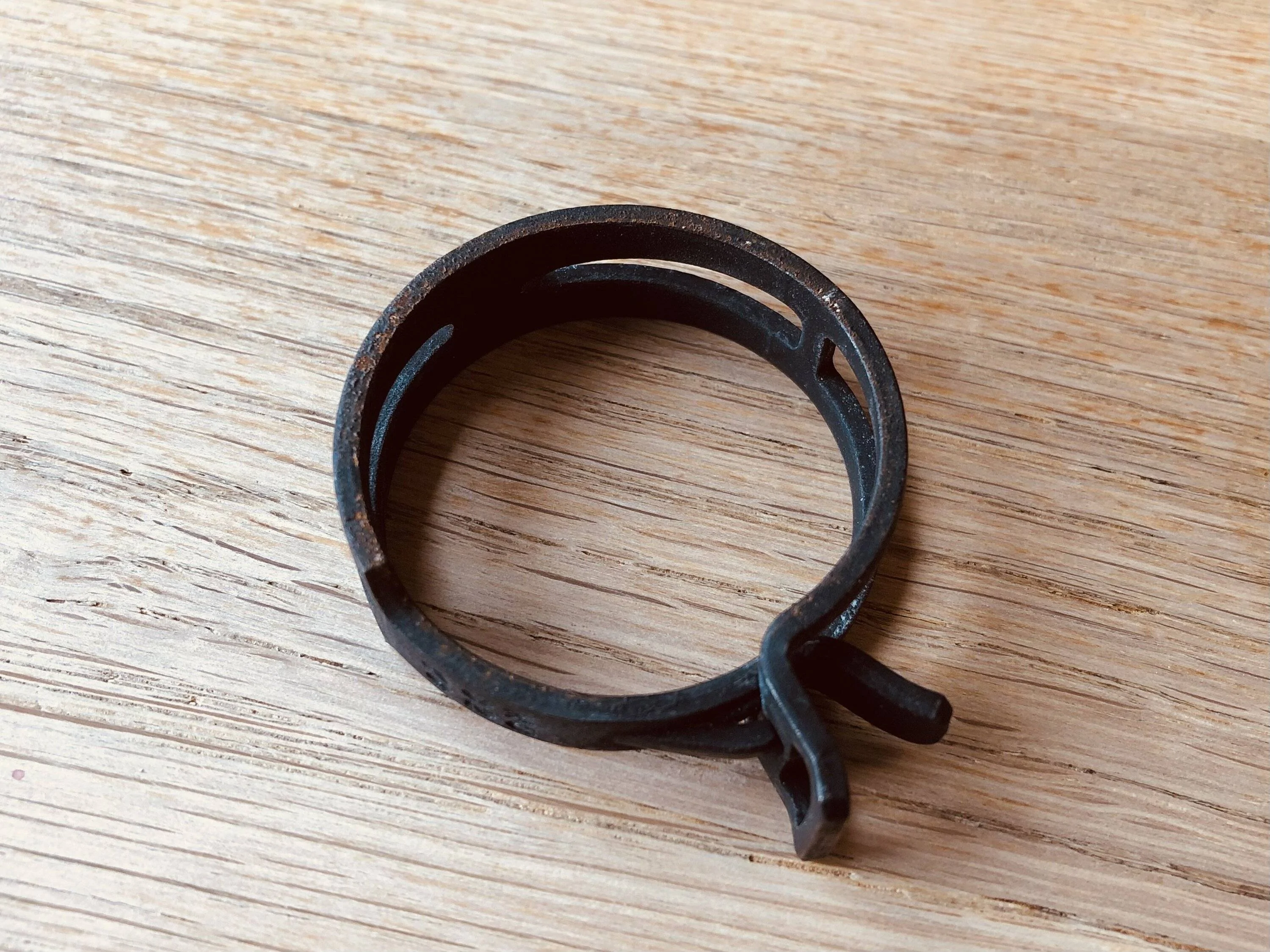

I stripped off, cleaned up and repainted the only rusty clip from under the hood (the one from the sound tube - that Ford U.K. only sell as part of the full sound tube assembly) :
I used iron remover to clean up the pipe before refitting it :

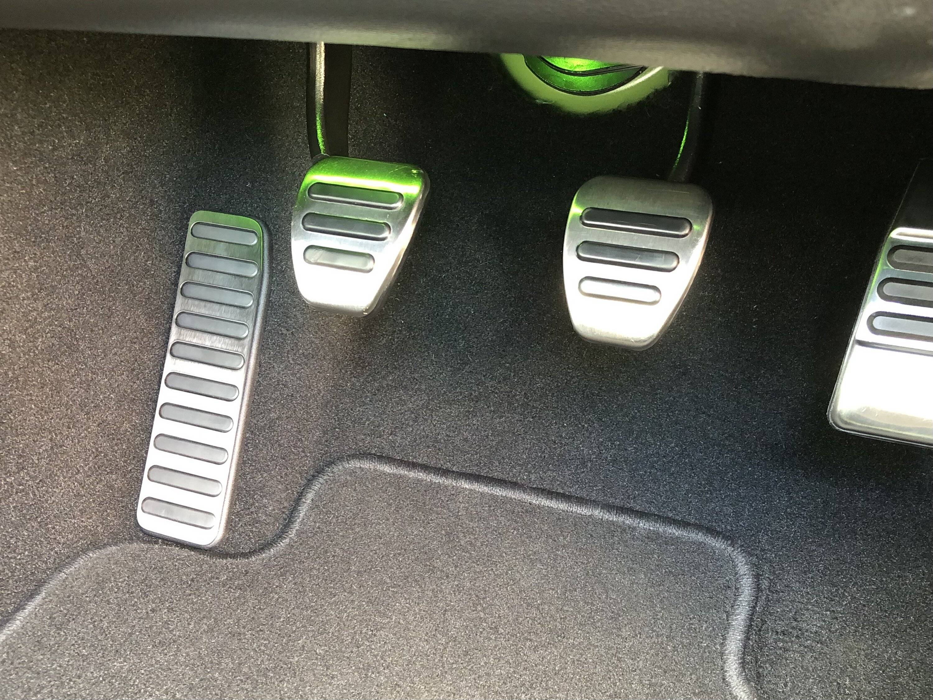

I finally got my dead pedal assembly (hard to find for RHD) clipped back in place :

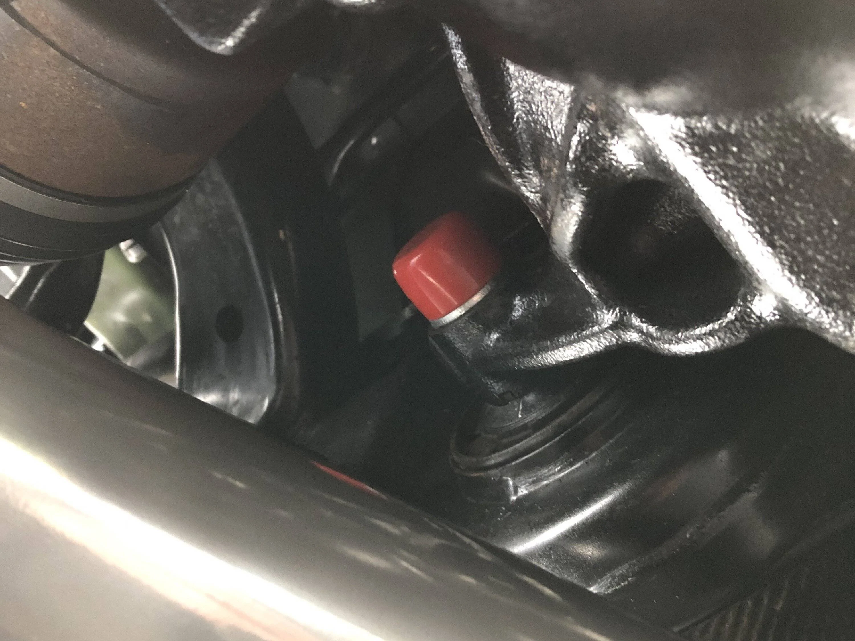

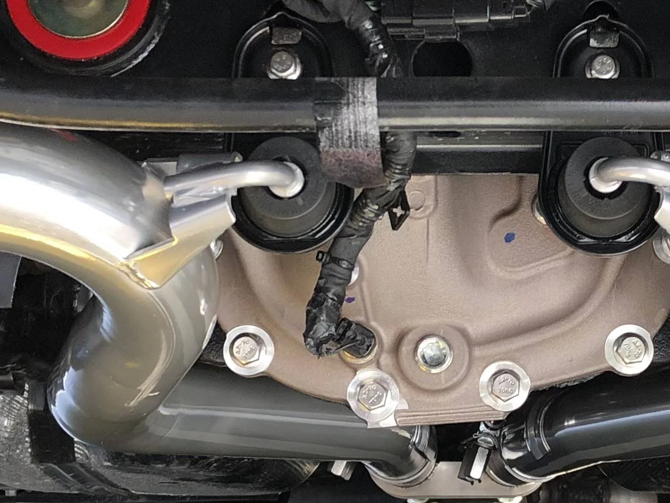

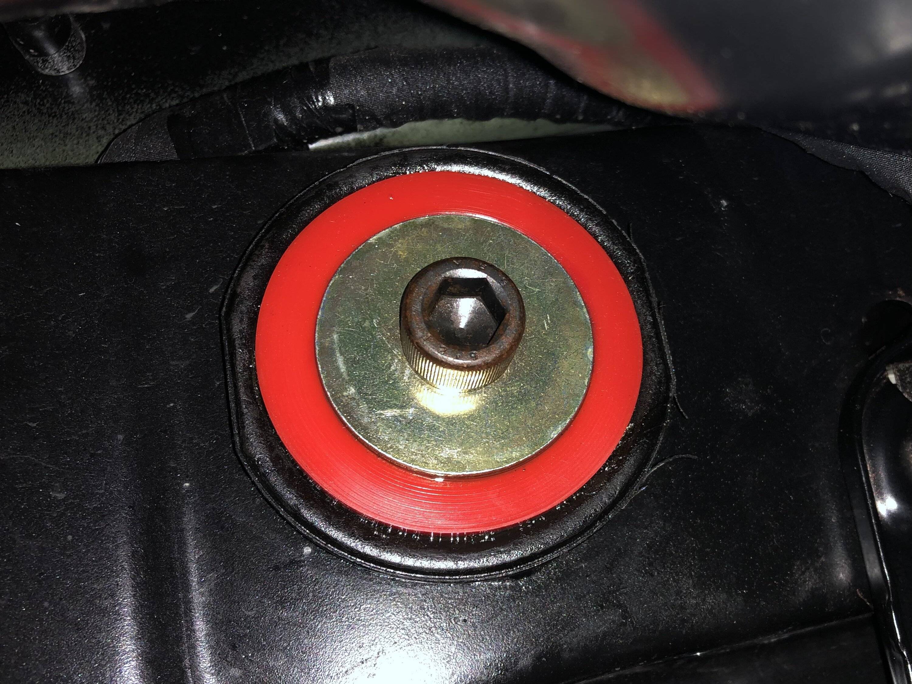

I managed to get to the front diff bolts to clean off the rust, apply waxoyl and then cover them to match the rears :
Not the easiest of things to get to lay on your back on the pavement lol.
Whilst I was under there, I clocked the outer toe link bushes which really surprised me :shock:
I knew it was sitting a little higher since the diff work was done and using the arch to the line in the tyre moulding, I dropped 5mm from the right side :
And 6mm from the left :
The vertical links still need clocking - but they will be replaced with the J&M spherical versions (once they have been released to me awaiting my birthday :giggle:).
The camber arms still need clocking - but they will get done with the alignment.
Can’t beat a bit of colour coding … :giggle:

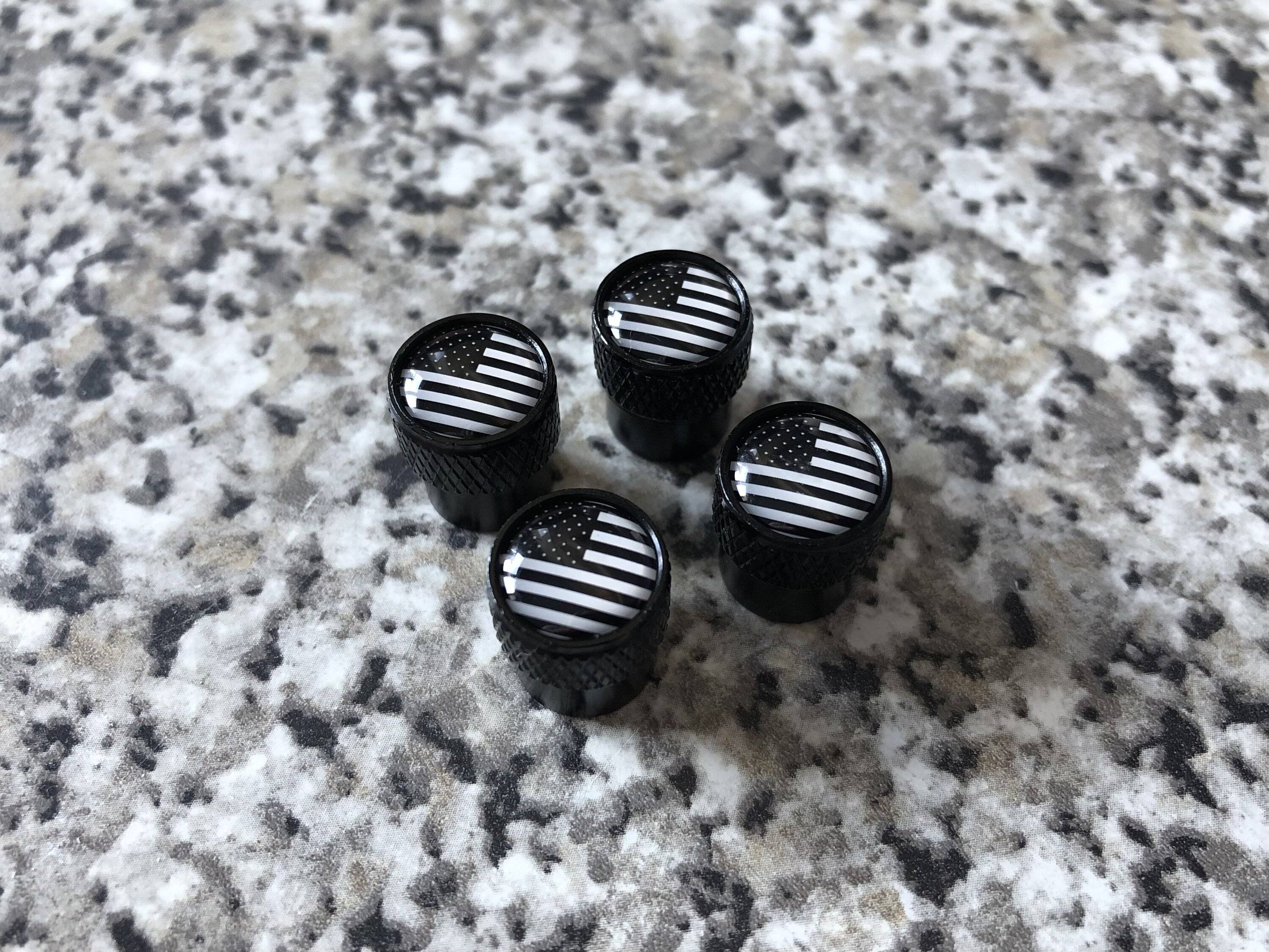

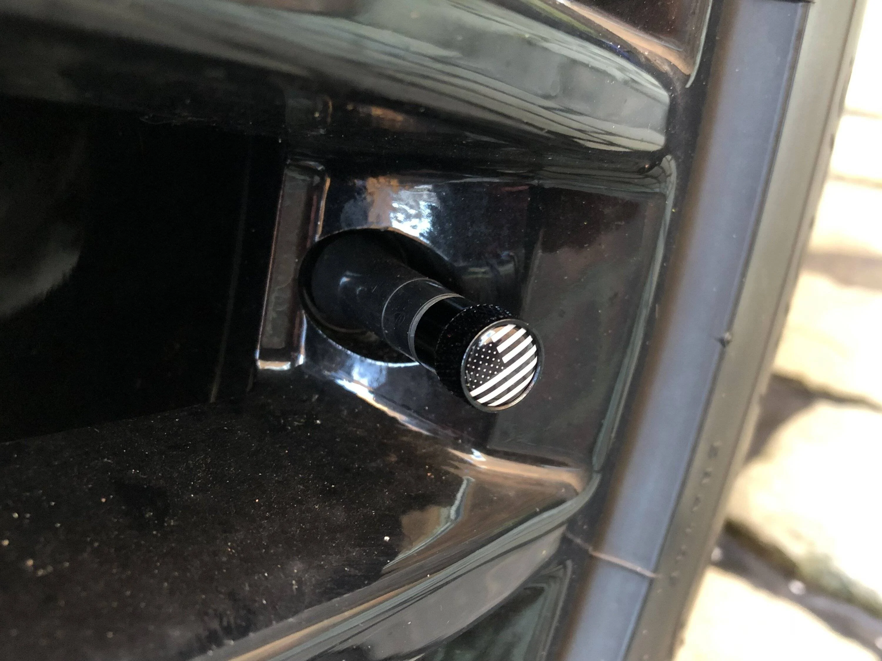

First set I’ve found with flags on that actually screw on properly and cover all the brass (excuse the dirty wheel) :

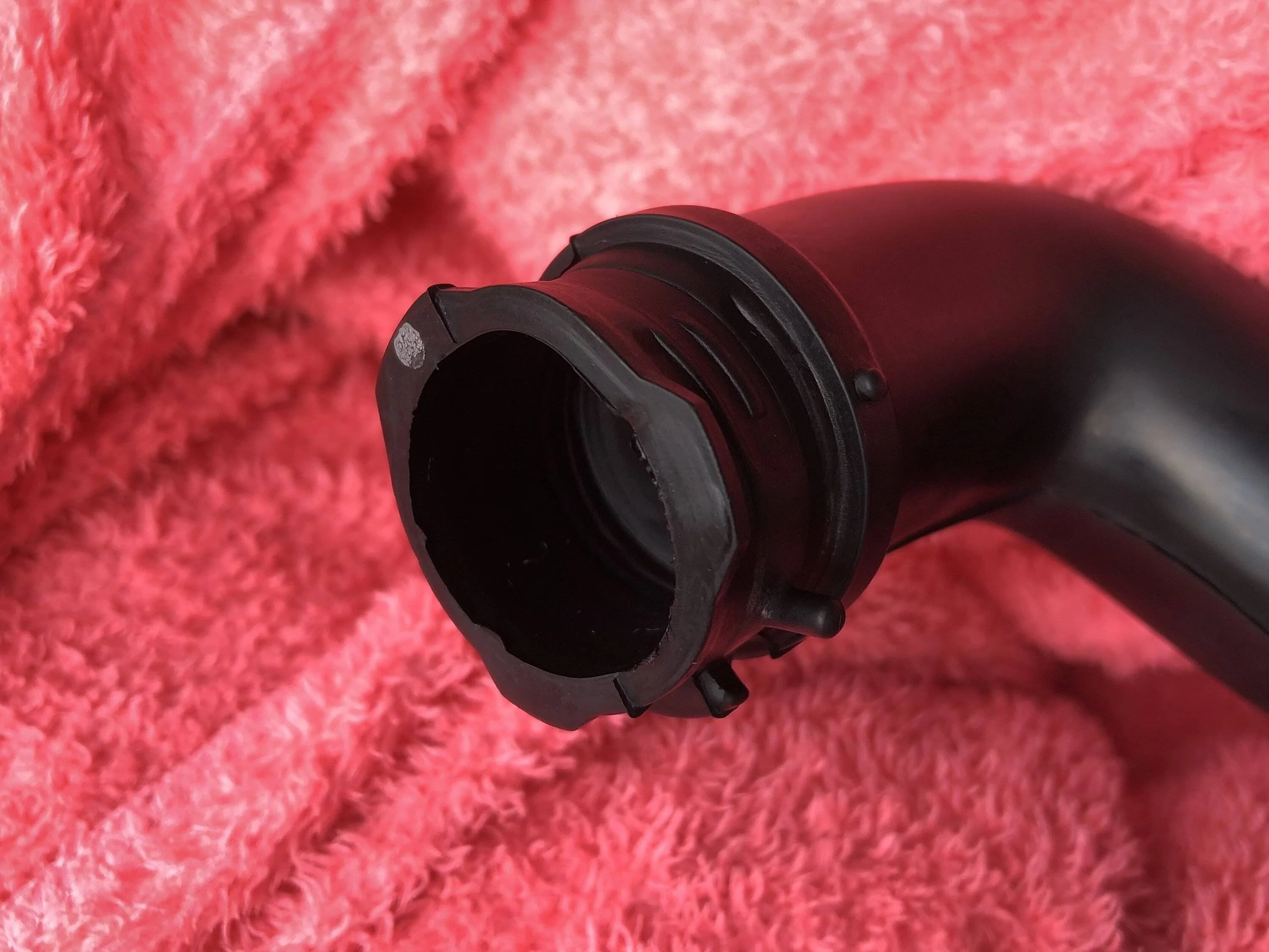

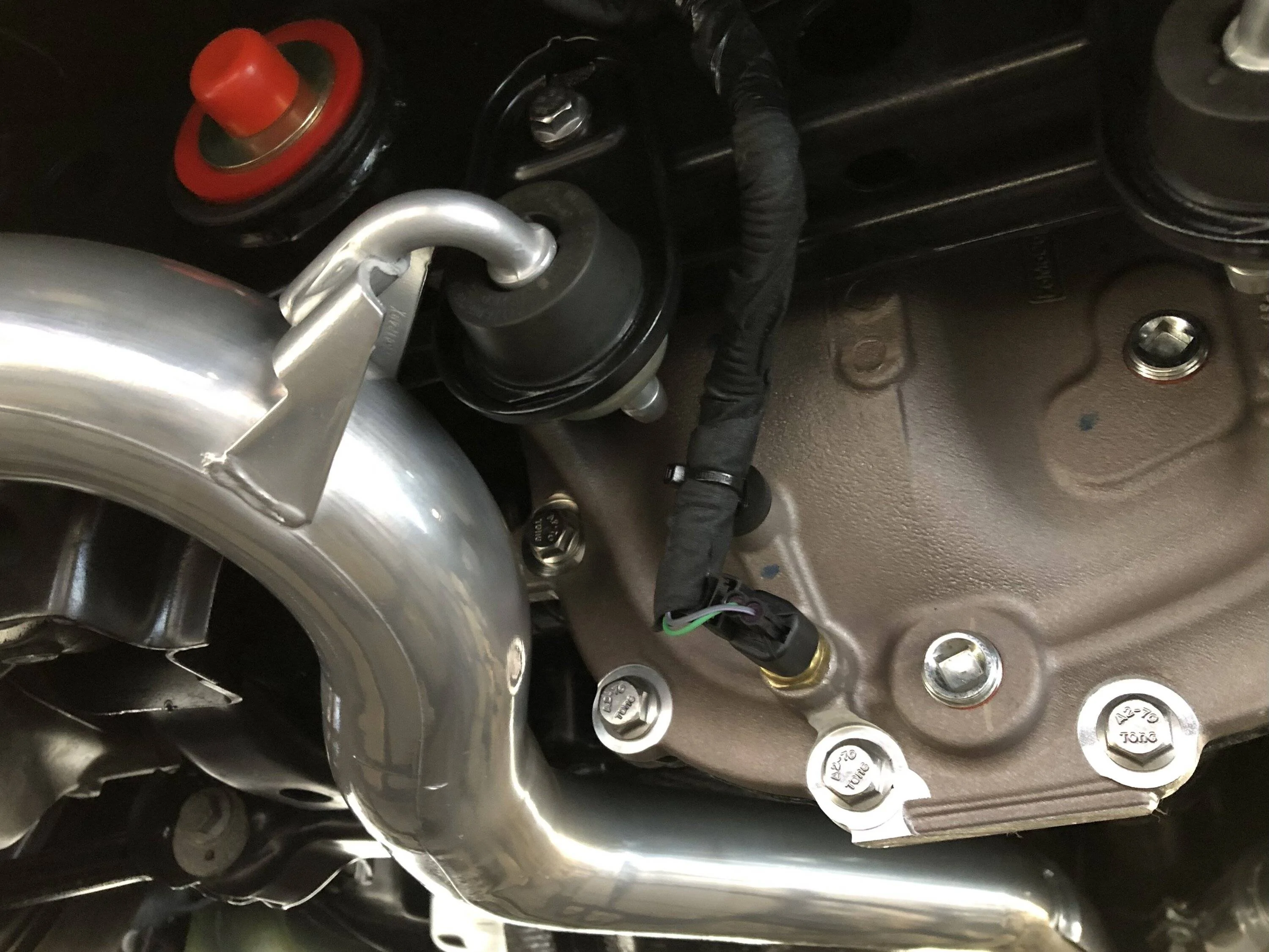

I’m not sure why we get our euro wiring looms undersealed, but after getting the new diff cover etc the temp sensor loom was letting things down :
So I neatened up the wrapping and cleaned the exposed wires back to their original colour :

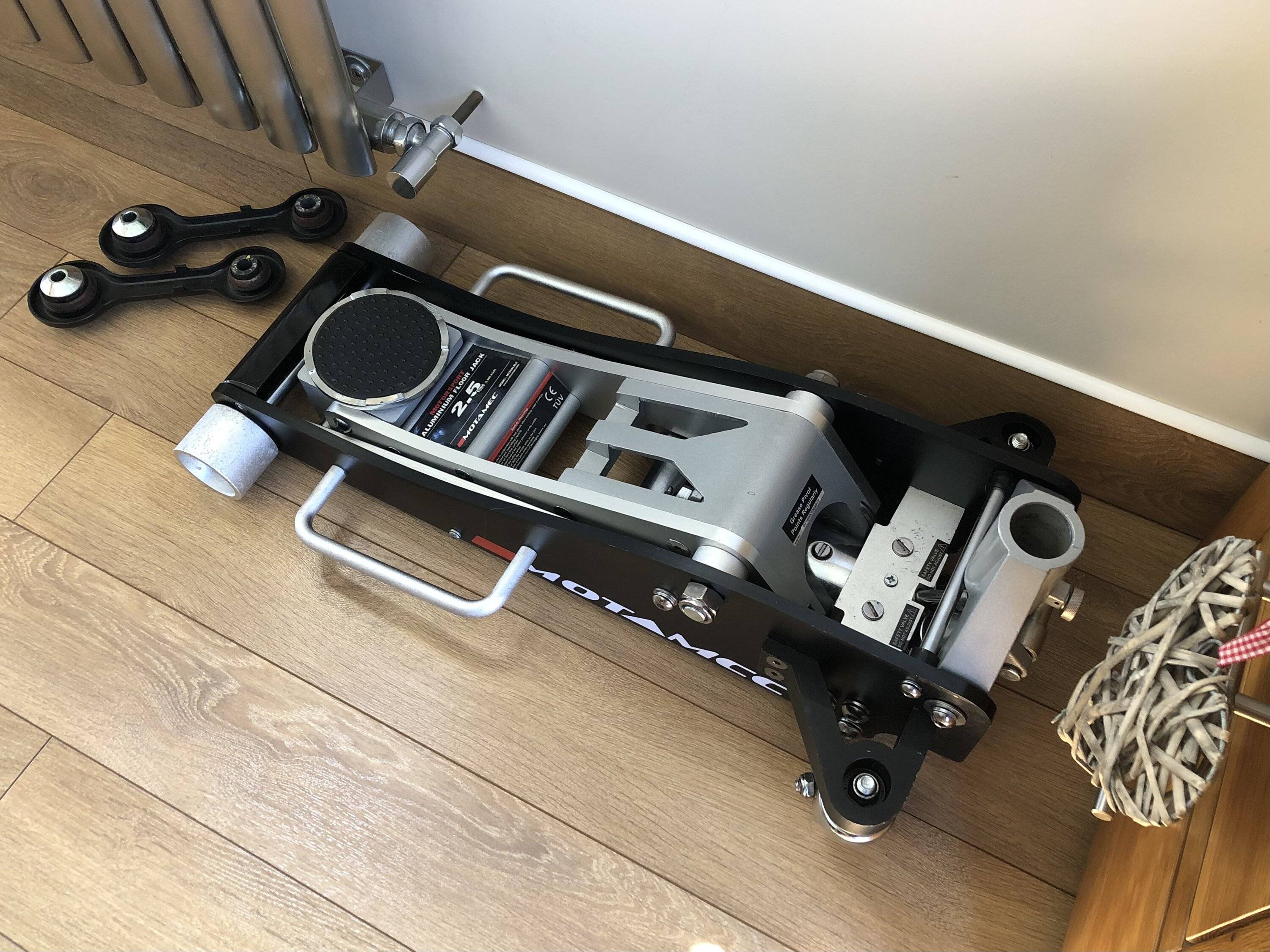

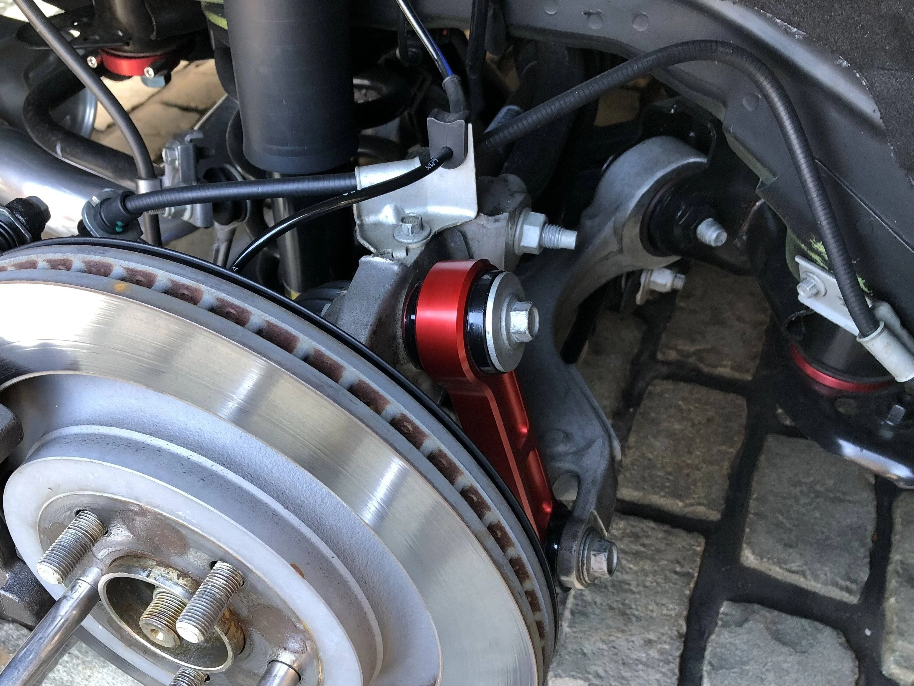

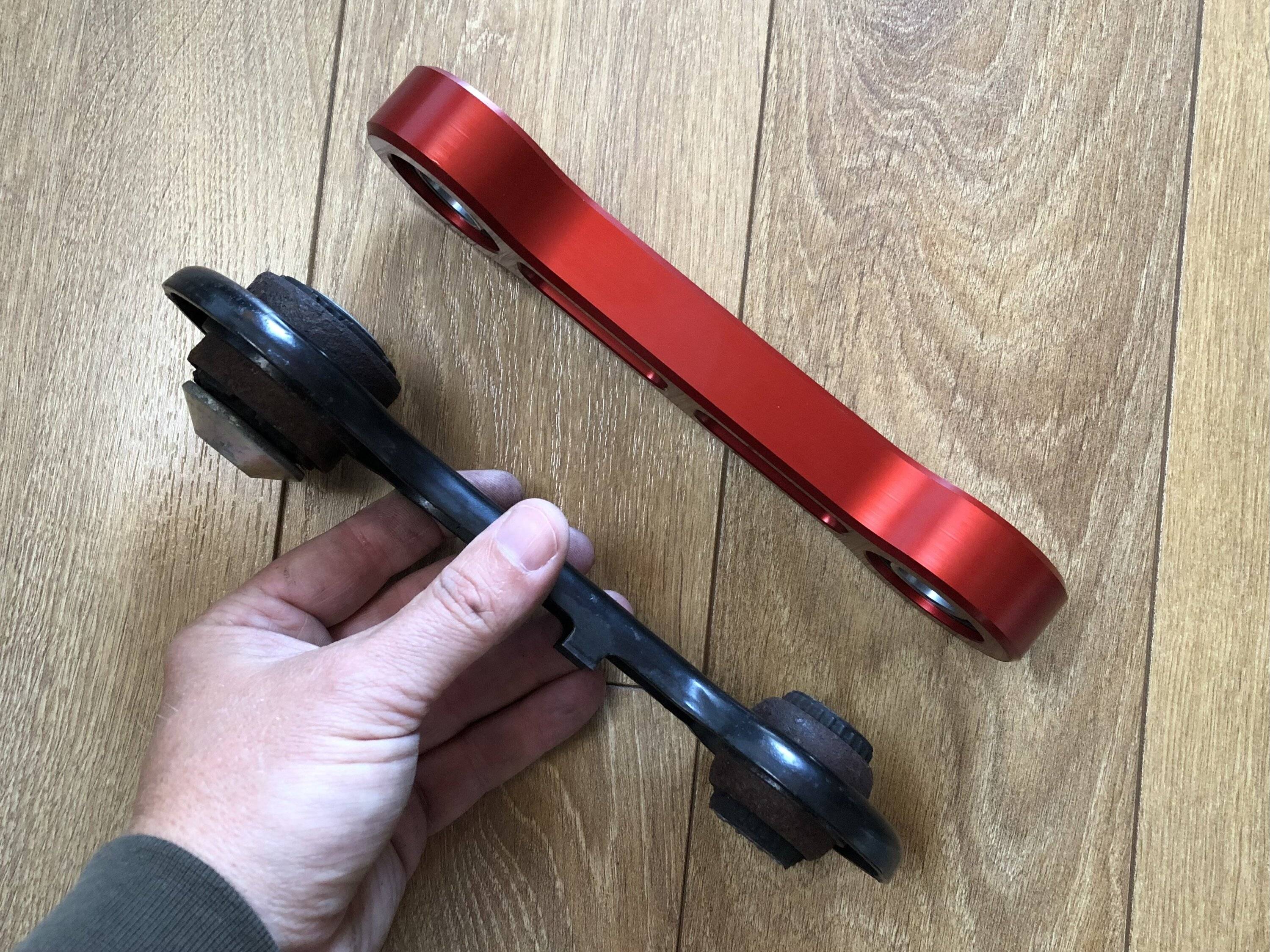

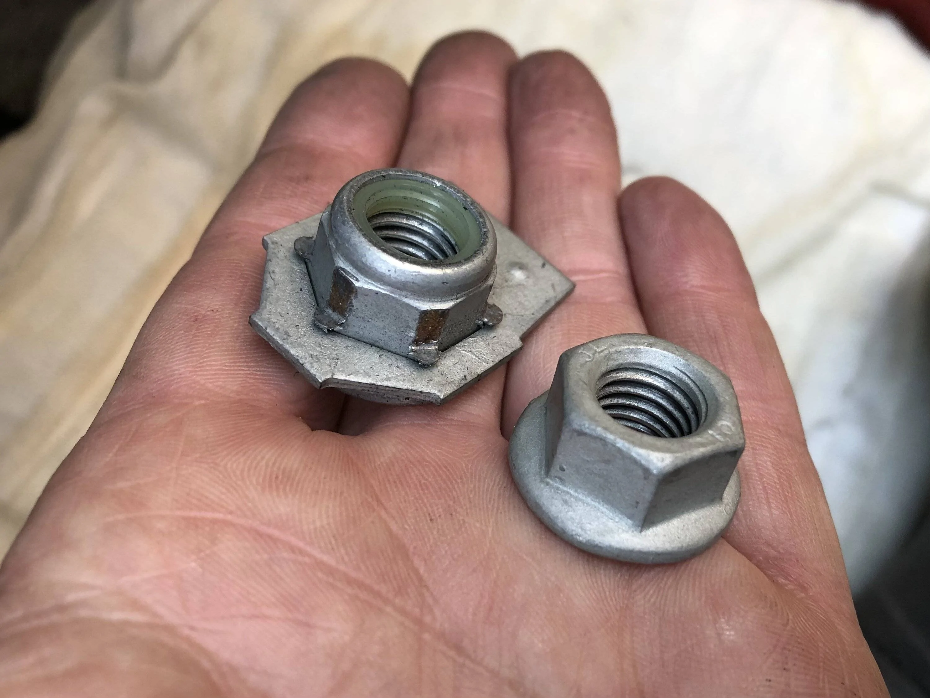

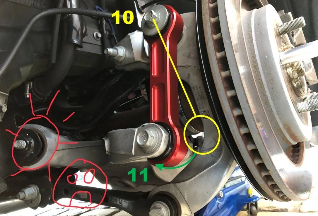

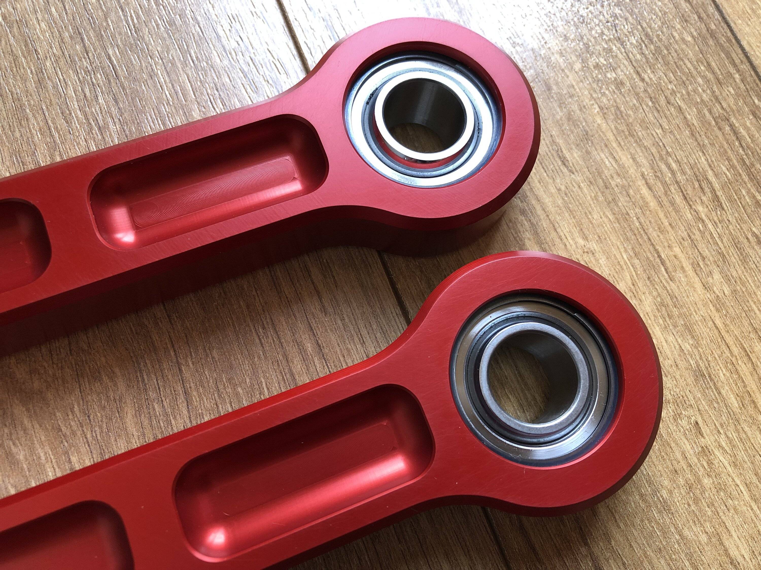

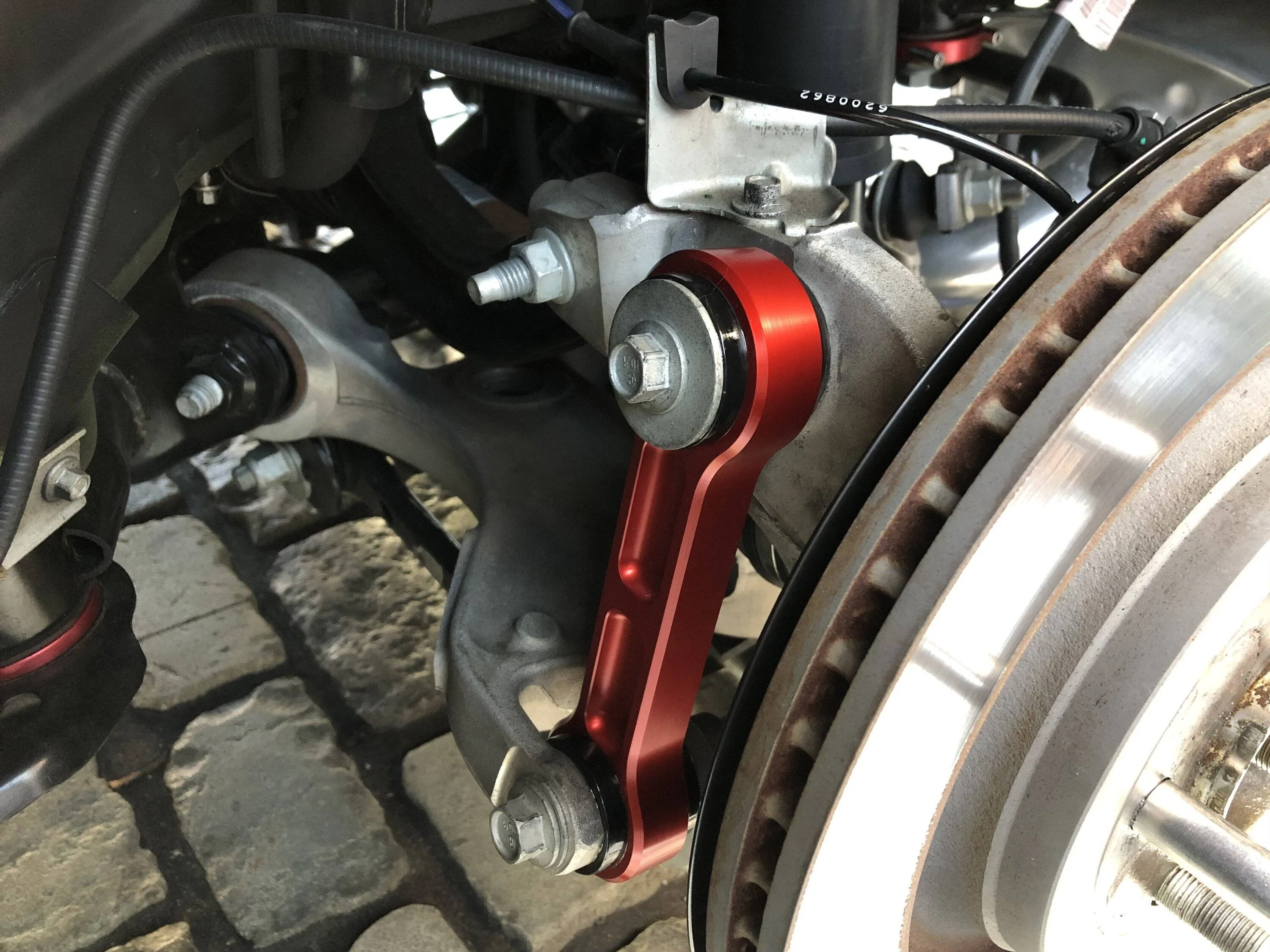

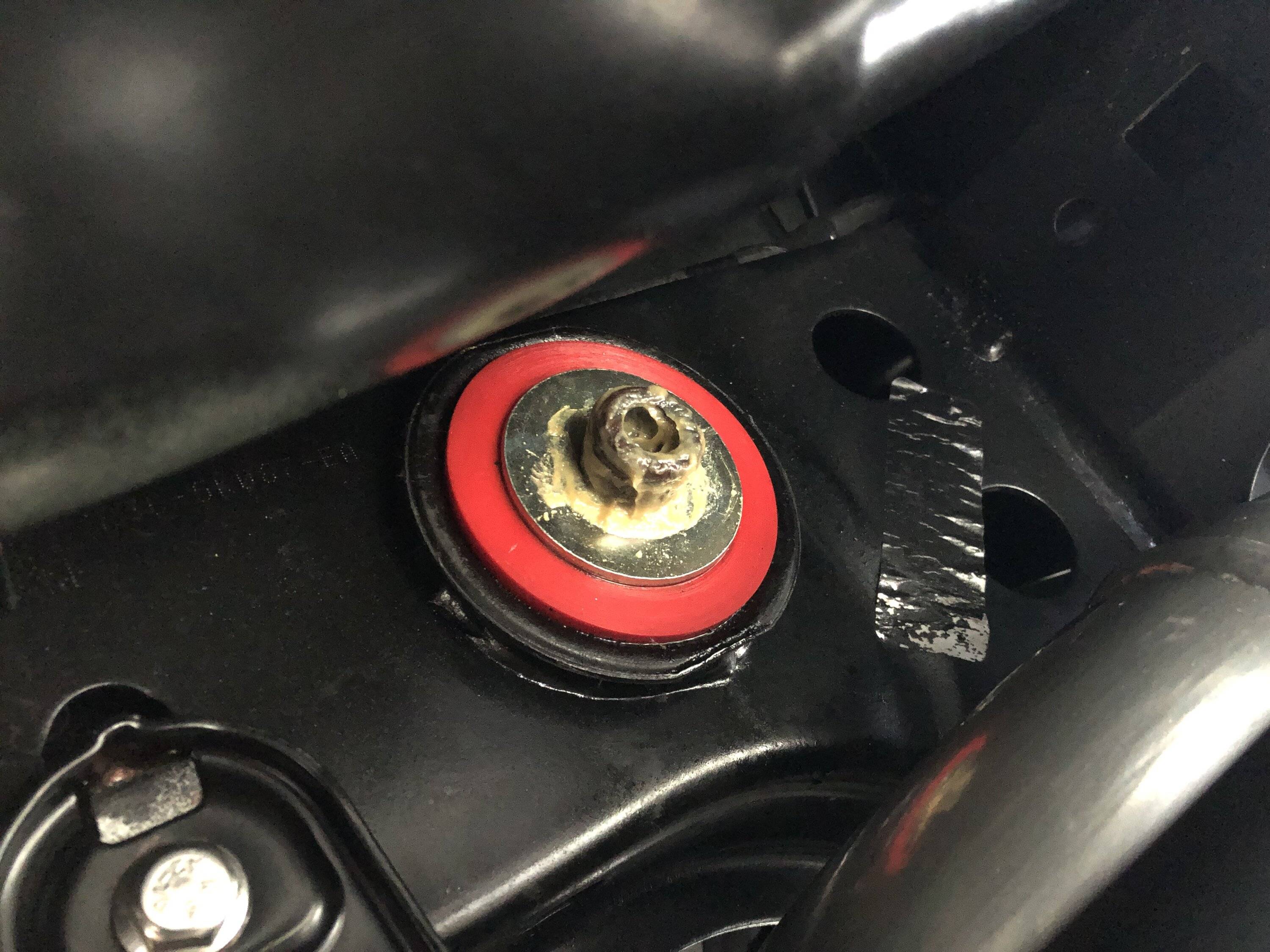

I finally fitted by birthday present (J&M vertical links)
It was quite nice to see that my little bit of seal / alignment development must have got spotted as J&M recently amended their kit to include something very similar - more details here :
https://www.mustang6g.com/forums/th...heir-rear-wheels-off-do-me-a-favour-….185422/
On with the pictures :

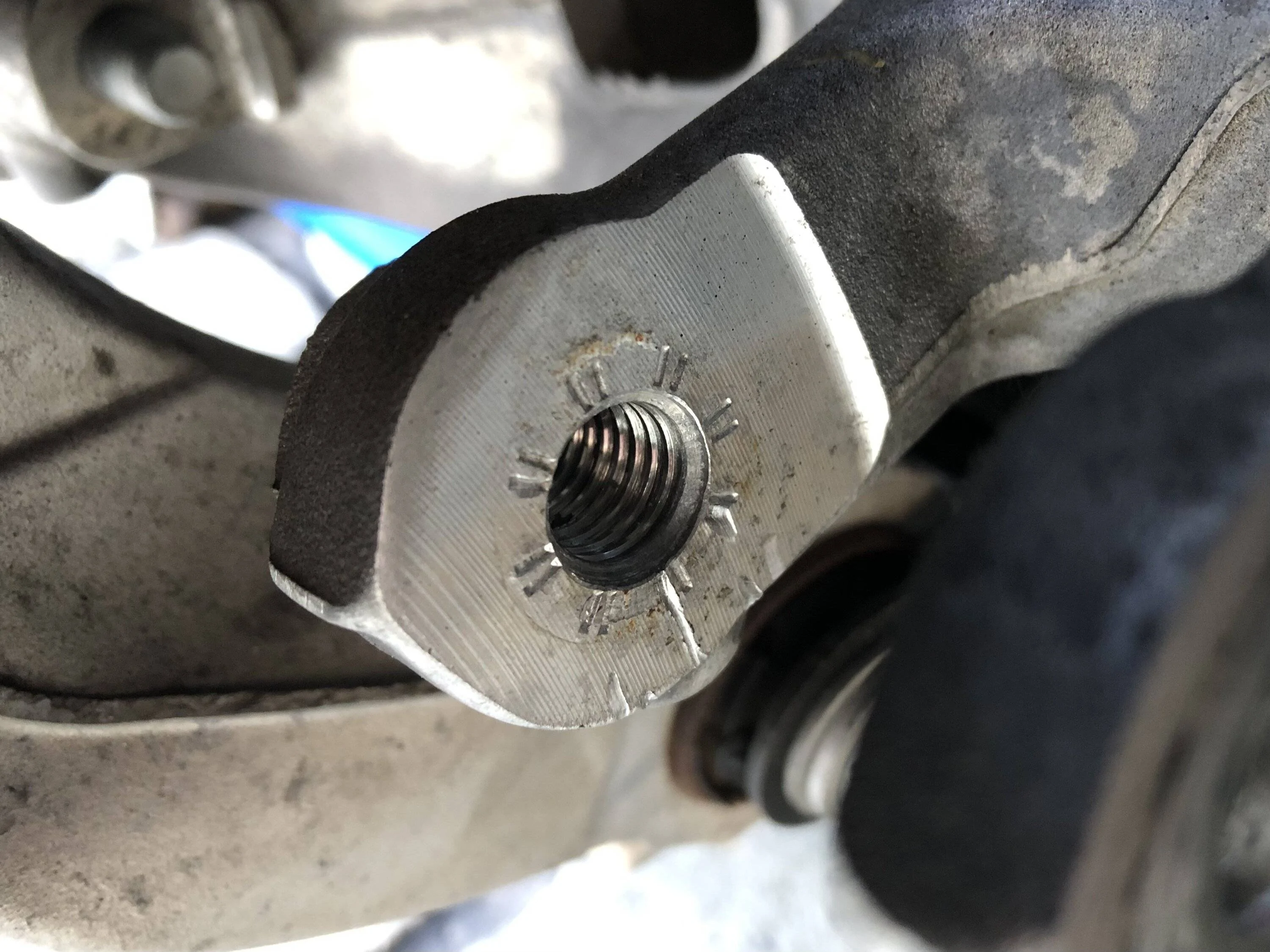

Dumbest nut design / usage in the world - they are already semi rounded, they get stuck in your spanner and the design is prone to rust :
Evidence that standard vertical links should be clocked :
Done :

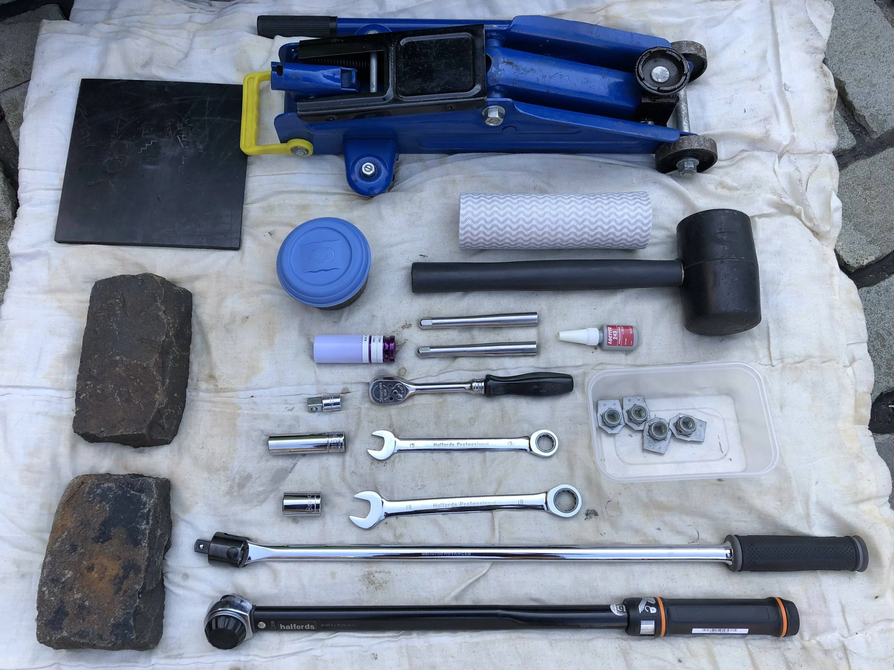

This turned out to be a very easy job, this is everything that was required :
The rubber mallet was only used to remove the original links (the bottom bush bites into the ally arm), NOT for fitting the new links !
The wheel change studs are a nice thing to have, but not a necessity.
The old duvet is just a bonus to make the cobbled drive a slightly nicer place to be :giggle:
I did have a second jack on standby (to move the lower arm independently to the body), but it just wasn’t needed :
I'm not going to put multiple topics on this one post as I suspect I might quote my fitting instructions in future (and quoting a post with multiple topics is a bit of a pain to edit on a mobile) :like:

After reading probably every vertical link fitting instructions I could find and viewing the same on youtube, it was clear that some people really struggled - I have even seen some guys resort to using a hammer to persuade the new links to fit ... :frown:
No way was I doing that to my pretty red links, so I was a little bit nervous about how this was going to go, how long it was going to take me and if I could do it without resorting to brute force and / or marking up the new links.
Turns out it was actually really (really) easy, with nothing more than basic tools and it took me a total of 2.5 hours to do both sides, including getting all the tools out, putting them all away, taking multiple photos and spending far too long procrastinating ... lol
So based on my car (Euro / PP1 / Magride), here is what I did. Yes the steps are abbreviated, but I am sure you can fill in the rest like 'remove wheel' or 'torque bolt using a impact gun until it breaks' etc etc :facepalm: :giggle:
  1. Ignore all instructions and videos that tell you to raise all the back end on a lift or jack stands. THE SUSPENSION NEEDS TO BE SUPPORTING THE WEIGHT OF THE CAR.
  2. Chock the front wheels.
  3. Lift one corner with a jack under the rear control arm, just enough to raise the tyre off the ground so it can be removed (approx 1/2"). The car should still be pretty much level - level enough not to trigger the alarm on the enhanced security package (i.e. don't assume your rear wheels are safe with that alarm system).
  4. If you feel safer, put something under the frame rail BUT DON'T TAKE ANY WEIGHT ON IT, it's a safety measure in the event of jack failure etc.
  5. Undo the vertical link top bolt. If (like mine) the bolt is under no stress, it will remove easily by hand and the link will stay pretty much in its home position.
  6. Undo the bottom bolt.
  7. Pull the top of the link towards the front of the car (enough to unseat the top conical bush) and tap the link downwards with a rubber mallet to remove it.
  8. If necessary, clean up the internal faces of the fork in the lower mount of the control arm.
  9. If using links with spherical bearings, ensure they are straight relative to the link.
  10. Loosely assemble the top bolt whilst keeping the bottom of the link rotated in the gap between the control arm fork and the brake disk (like it's a pendulum on the top bolt).
  11. Once the top bolt is in place (but not tight), swing the bottom of the link into the fork of the control arm - a little grease and a bit of wiggling might be needed, but it should go in with reasonable hand force.
  12. Look down the bore of the bottom bolt hole, wiggle around the knuckle / brake disk assembly so it looks good by eye.
  13. Bottom bolt should go in easy and start the thread without any force.
  14. Tighten everything up and you are good to go.
  15. Wheel back on, repeat on the other side.
This single picture should be good enough to suss out what I am describing in steps 10 and 11 :
My theory for the people that have struggled - I suspect that lifting the car by the frame and letting the suspension droop puts the link in a position that's slightly out of alignment and places stress on the bushes. That stress makes the new link difficult to align, especially in the case of a link design that resists movement in that direction i.e. (to some extent) poly and (especially) Delrin.
Whilst lifting the lower control arm with a second jack may help to bring the assembly back into alignment, it introduces another variable - and why bother when a single jack under the control arm only (in my experience) holds everything in a near perfect position ?
Hope that helps - I would be glad to hear feedback either way :like:
WD :like:

Inspired work. The problem is pros don't work crawling around on the floor. A trans support jack or doing the swap on alignment stand might be an alternative.
Either way @Hotpart.com got themselves another sale.

Nice job and glad it worked out mate. Re' "why bother when a single jack under the control arm only (in my experience) holds everything in a near perfect position ?" Well after doing it four or more times now for various reasons, sometimes it does not work like that, and a different (read additional) axis force is required to effect a better alignment for the bolts. It's not a big deal, but if its easier and can prevent stripped parts, why not.
OBTW, when are you going to be rid of the curse of OEM RLCA bushes. It's next level without them.

They are defo on the list, but only when that arm needs to come off for another reason ... :like:
