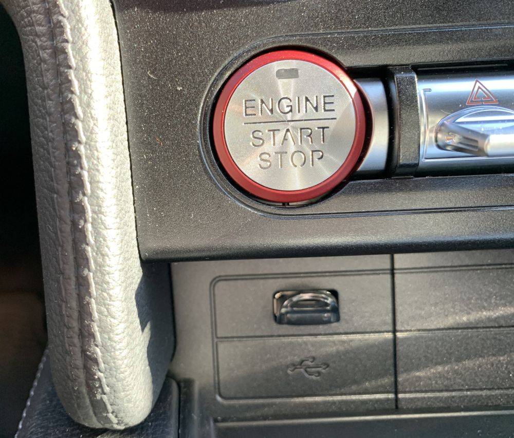

Dust plug for the USB, its the little things that make me happy ... :cwl:
:facepalm:
Wouldn't have noticed that if my life had depended on it. :crackup:
I solved that with a small USB stick. The upside is that unlike a cover, it's also functional.
Although most of the times I use my phone for music, I do sometimes prefer the USB stick. Both have their strengths and weaknesses.

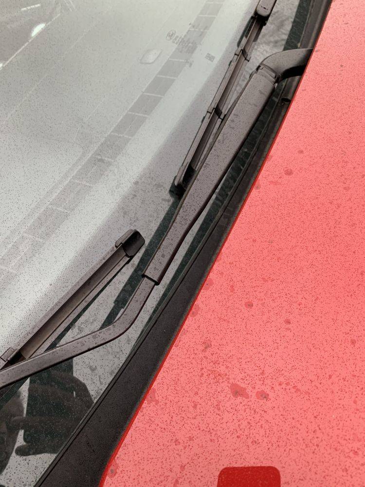

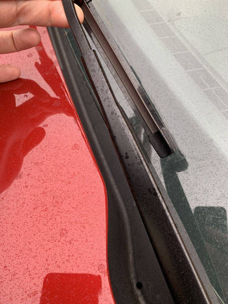

My main reason for the adjustment was I couldn’t lift them without them contacting the bonnet without twisting them a little first, that’s OK for me (but annoying) but you know it would have come back scratched after a service or MOT ...
This is the raised clearance for the passenger side which I didn’t need to adjust :
And this is the drivers side raised fully after the mod :
And where it did contact when half raised / lowered pre adjustment as it passed the hood profile :

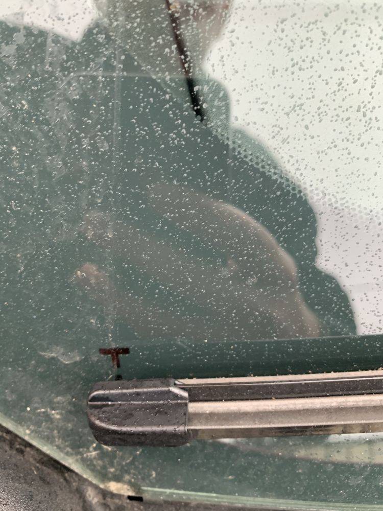

Final resting place after adjustment, note you can see the original adjustment mark on the screen for the drivers side in this photo :
The arm looks ‘right’ now where before I thought it looked over rotated and actually downwards pointing a little :
Now it’s level :

• My wiper arm was on ‘really’ tight. I couldn’t wind the tool any tighter and it wouldn’t budge. After three or four goes I left it tight whilst I went for the hairdryer to warm the arm, then I heard a crack as the arm released its grip on the splines and jumped up.
• Use lots of tape on the tool and wiper arm to stop marking the finish on the arm.
• I don’t think the ford arms are splined. I suspect they are a plain bore and the first assembly cuts the spline into the arm.
• Mine had witness of threadlock on the spline (can’t imagine it’s white ally corrosion after a few dryish months and no salt roads).
• As it’s splined, you don’t have infinite adjustment, it’s kind of one notch at a time and once the first set of notches have been cut by ford, the arm will follow them as you torque it down.
I’m happy with the little tweak, much easier for washing or applying rain x now (as I did this afternoon) without having to jam a microfibre between the arm and bonnet edge. It looks better. It sweeps more screen - not that I plan on driving it in the rain much ... :cwl:

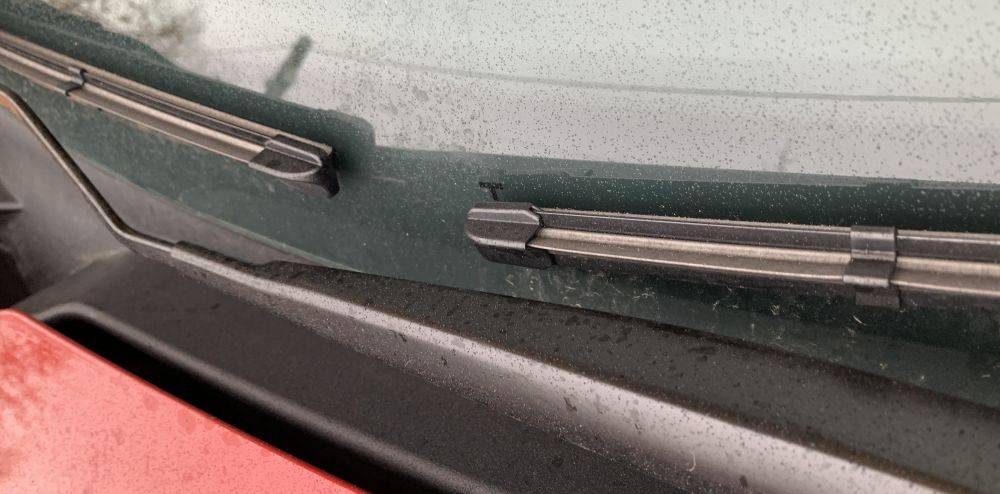

Yes, I think the RHD might be different, because mine clear the bonnet with room to spare.
Driver's side:
Passenger's side:
