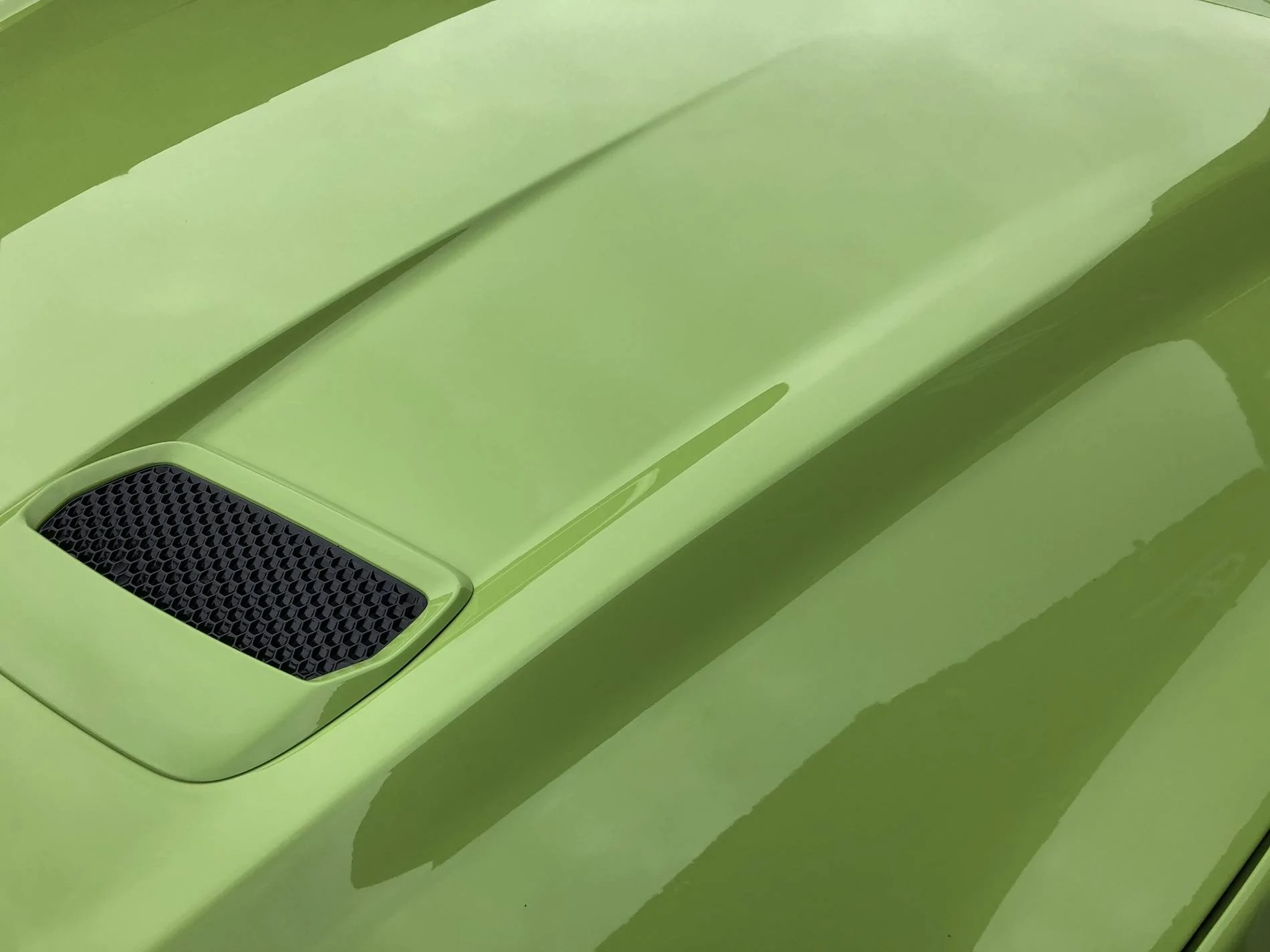

Well at least its got some protection on it now ... :whew:
I opted for Megs ultimate quick wax as A) I had a bottle in the garage and B) this stuff is so easy to use on wet panels / in damp conditions.
It beads really well and lasts quite well too, which is good considering the weather we have coming in this week.
In fact, I forgot how impressed I was with this stuff, how quick it is to use and the looks it provides - I'm now considering using it as a drying aid every few weeks to get me through the winter season :sunglasses:
I still found a few areas that needed a little more spot claying and I would still like to spend a bit more time on the rear lights. Other than that its just the front bumper that's not been touched - I want to leave that as long as possible due to the transport damage respray.
I think I've got about 12 hours invested in the paintwork now, but remember that I took this car from the ford dealer 'untouched'. Judging by what the dealers seem to turn out it's been well worth it, (IMHO) the paintwork is now to a much higher standard than I have seen on anything in the local showroom :like:

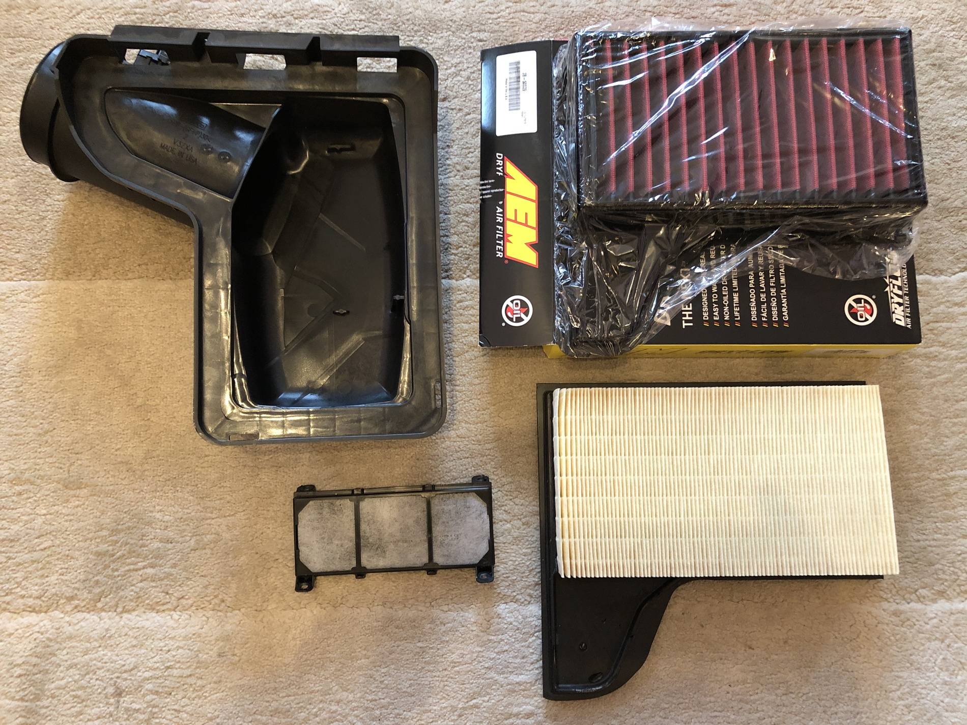

The sound tube got silenced today, but no test drive yet so don’t ask how much of a difference it made ... lol
I plugged mine in a slightly different way to the normal ‘rip it out’ method as I wanted to keep the OE look :
Everything went back together and it looks completely ‘normal’ :like:
I followed that up by fitting a AEM dry filter and I took the opportunity to remove the carbon trap at the same time :

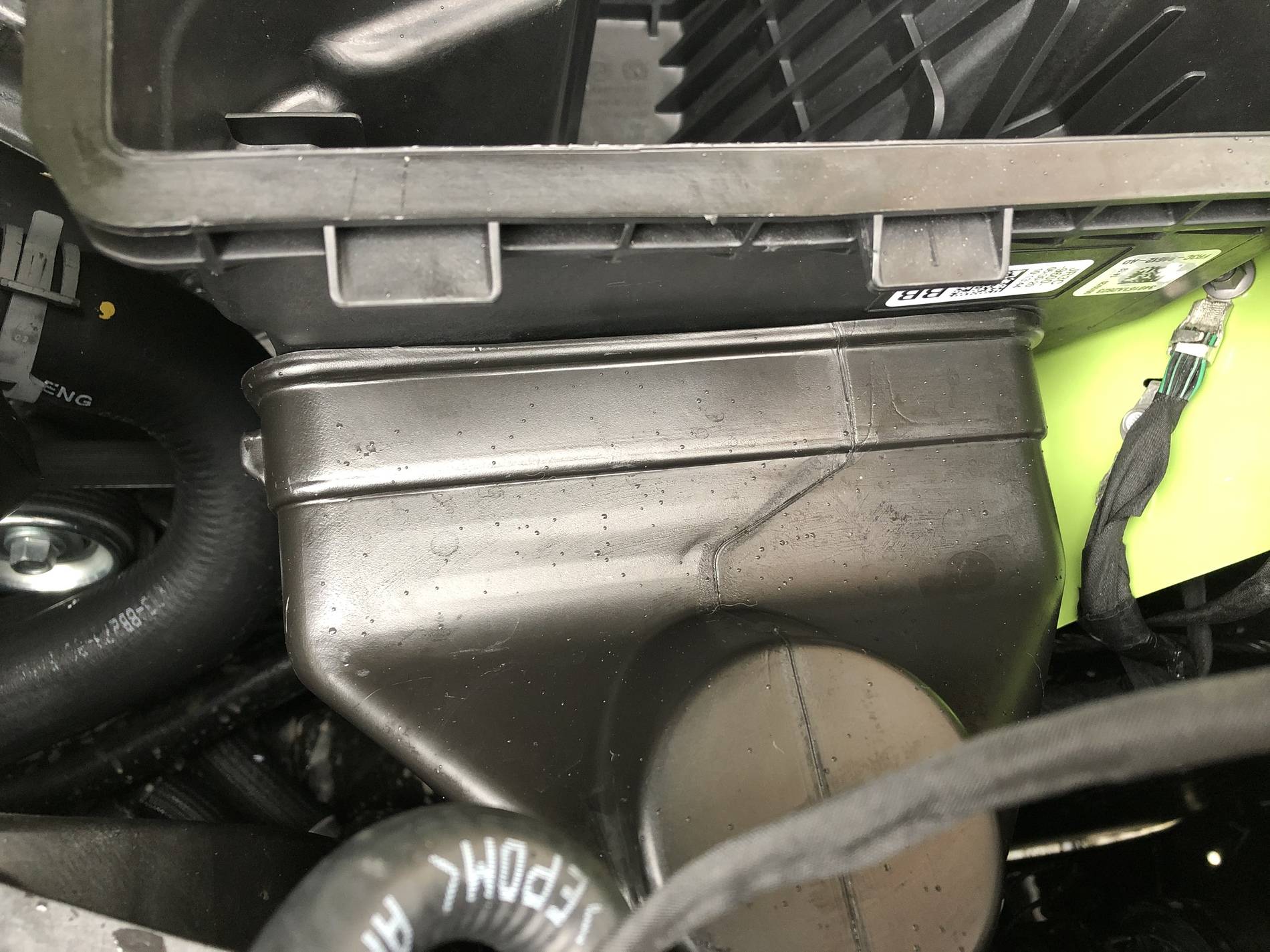

If you do any work in that area and whilst the parts are stripped out, check the duct fits flush to the air box as mine was virtually disconnected, it’s now back flush :
That barb on the left hand side where the duct meets the air box was completely disconnected and there was a gap on the left side of the duct.
To be fair, refitting the lid and the flexible hose opened the gap back up a little more than shown in the photo, but the parts still mate and aren’t open anymore :like:

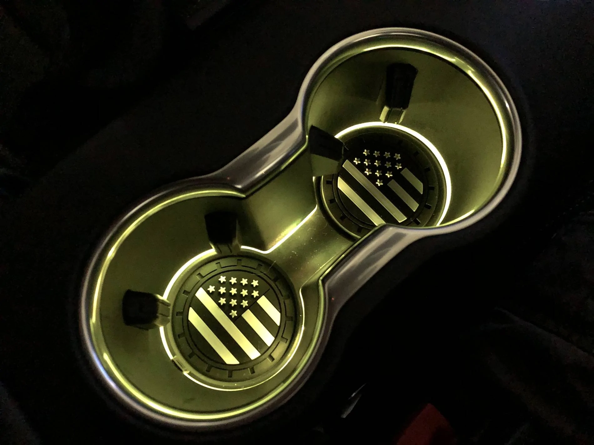

Glad I opted for the white flags rather than the coloured versions, I was hoping they would take on the ambient lighting colour at night and it looks like I was in luck :
But if I had a red, white or blue car I would have bought the coloured versions for sure ... :sunglasses:

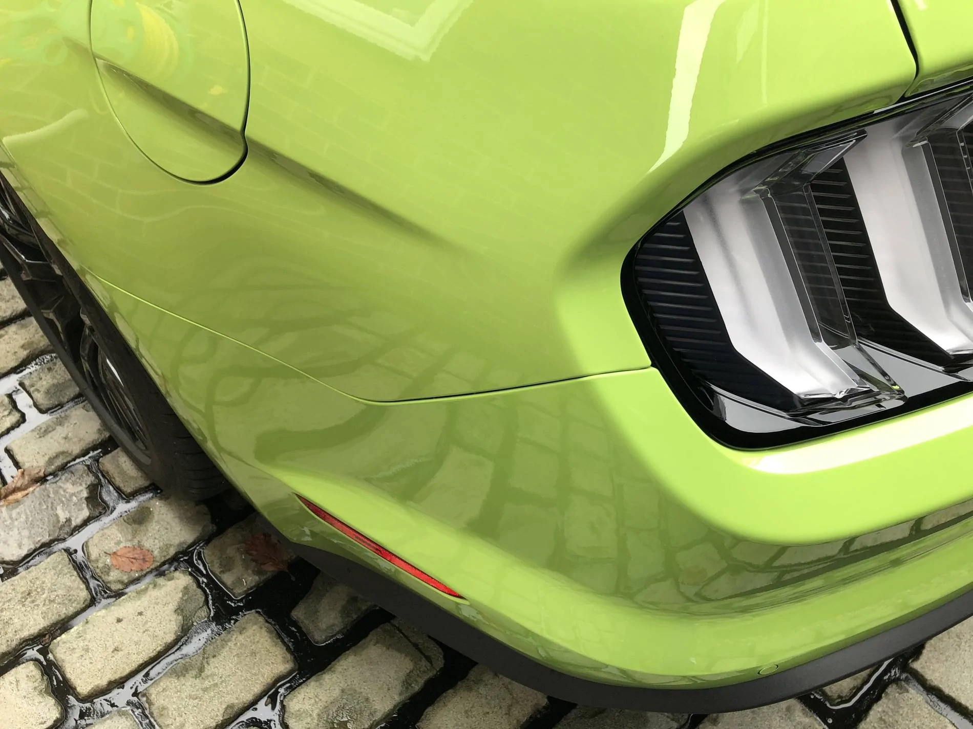

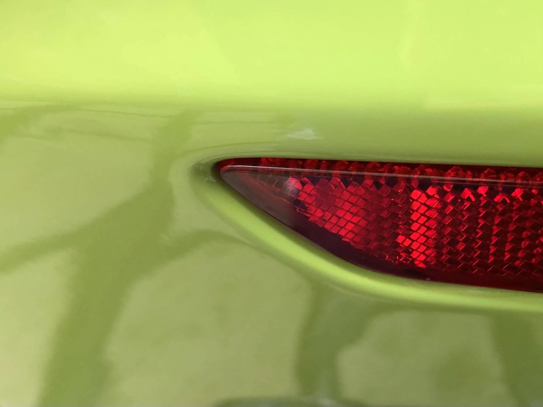

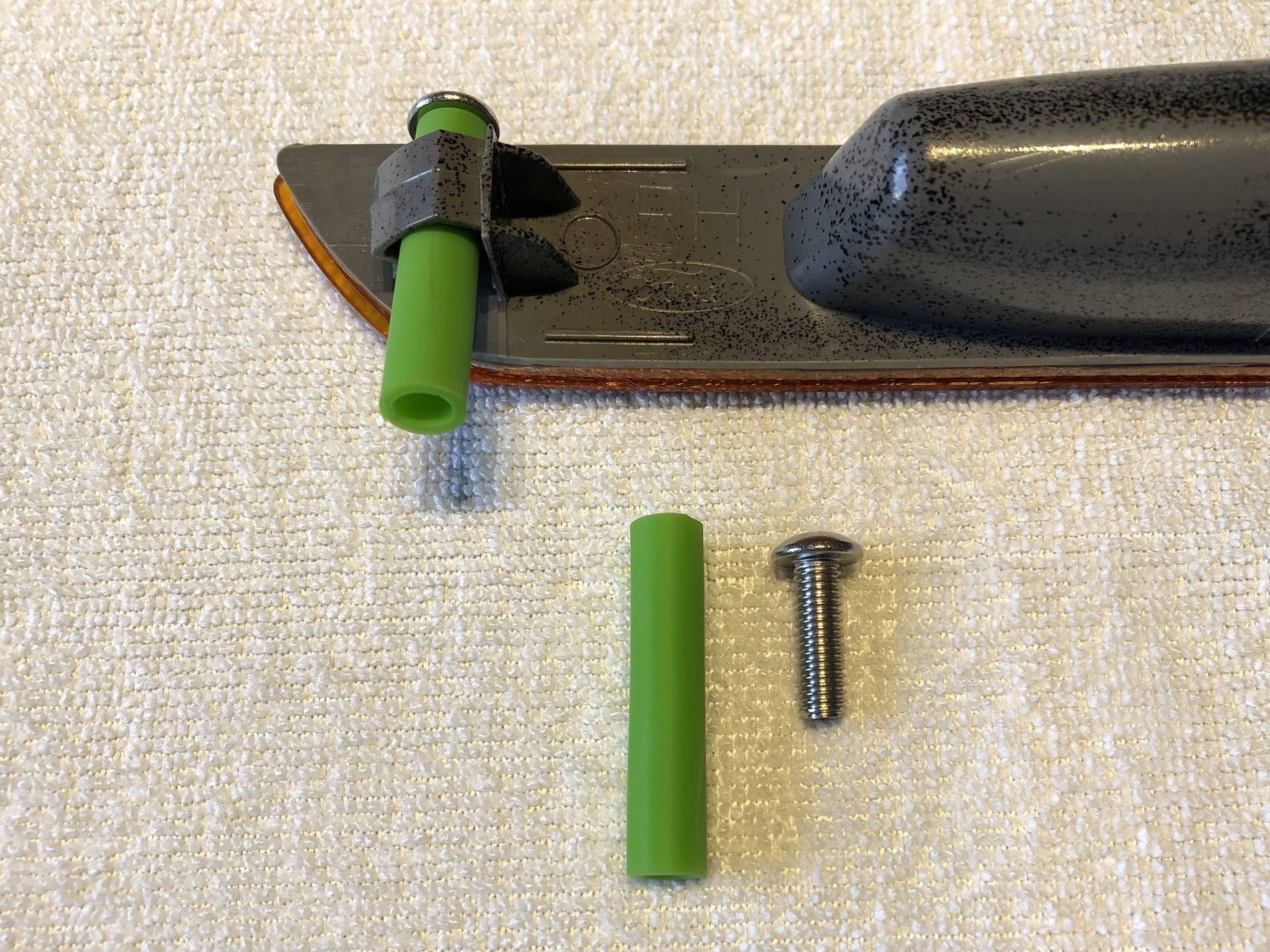

I noticed the rear markers appeared a little loose and rocked a bit, mostly at the front ‘clip’ end. Wondered if there were slight differences in the US and euro spec so popped one out to find they are 100% identical. Maybe they all do it or maybe I’ve just got an odd car ... lol ?
Anyhow, with a bit of fiddling, working blind behind the bumper and a bit of finding what would fit, I found the perfect combo was an M5 stainless bolt and some old silicon tubing :
Nothing to rot or vibrate, no undue stress on the clip and the bolt head catches on the back of the bumper moulding to stop the assembly working downwards with time and vibration.
Keeps the ends tucked in nice now and they sit firm with zero movement. A small mod but one that keeps me happy ... lol

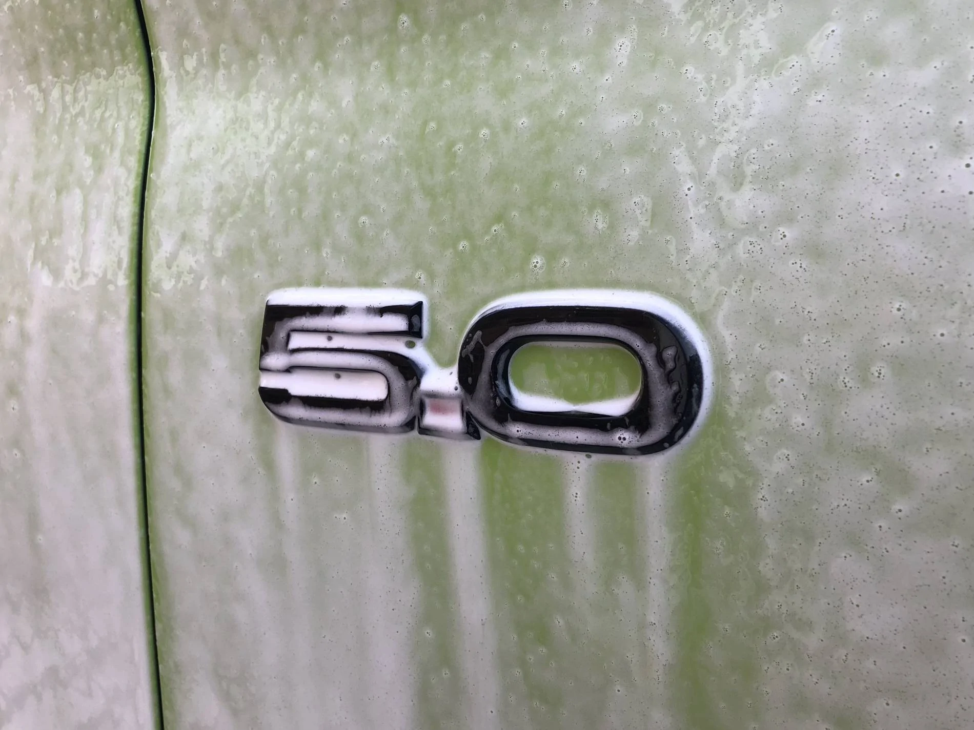

Wash day :
Still got cavity wax dripping out of the doors so I cleaned that up (again) and also cleaned lots of splash’s of it from the plastic arch liners.
Good news - The Megs ultimate quick wax still seems to dislike water as much as the day it was applied. Rinsing with an open hose pretty much made needing to dry the car off redundant :like:
Bad news - Revenge of the ford car cleaner (I will not say detailer ...) ? I do wonder if he took a dislike to the instruction not to touch the paint ... ?
I suspect this is an old school acidic wheel cleaner that has been sprayed and left to dry ?
‘Nice’ wheel cleaners won’t touch it. Paint cleaners will take it off but it takes ages. Mineral spirits etc won’t touch it.
Resorted to old school wheel cleaner (hydrochloric acid i.e. brick acid) which pretty much instantly removes it. I’ve been doing it in sections every time the car is moved / re parked as I only do about a three spoke section at the bottom to keep well away from wheel nuts and callipers etc. Slowly getting there :
There good enough for now, at least until the wheels come off to get all the underseal overspray off them ... (mostly the backs).

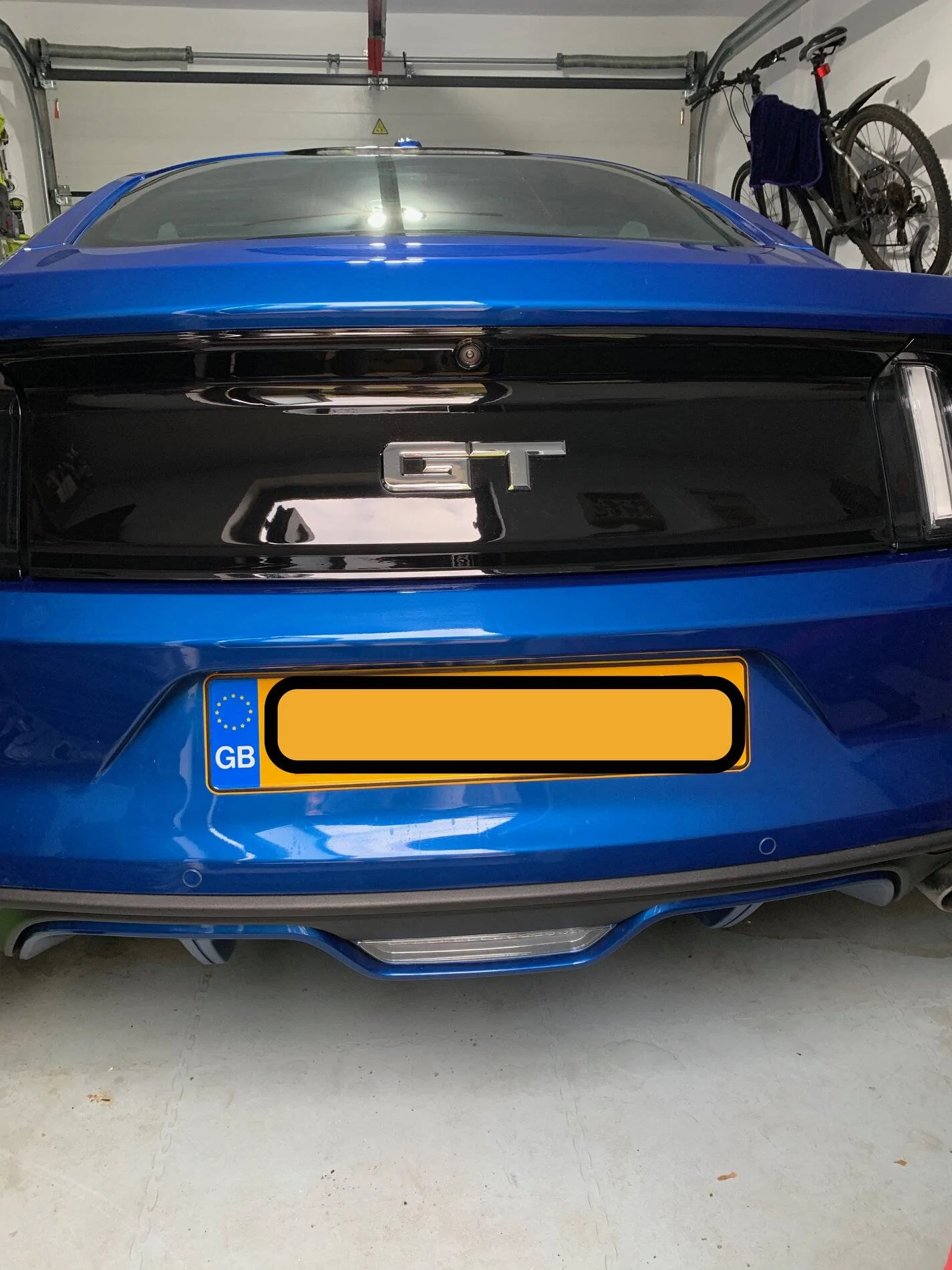

I see you replaced your side badges and grille pony with the black version. What did you do with the rear GT badge? Have you found a solution to blacken that as well?
WD Pro
WD Pro
Jan 18, 2018
132
6,807
13,649
United Kingdom
Lime GT
I've done nothing with it yet - and it bugs me every time I look at the back of the car ...
I've decided that I like the completely flat and de badged look best :sunglasses:
I asked about aftermarket blank deck lids here https://www.mustang6g.com/forums/threads/mp-concepts-deck-lid-panel.149525/ with mixed responses.
I'm pretty sure now that I want an OE Ford panel and if they start to make them again due to the Mach 1 rear panel, a completely flat one without the two lines moulded into it.
I have asked Ford Performance if they will start to stock that panel as a blank, but I haven't had a response yet ...
