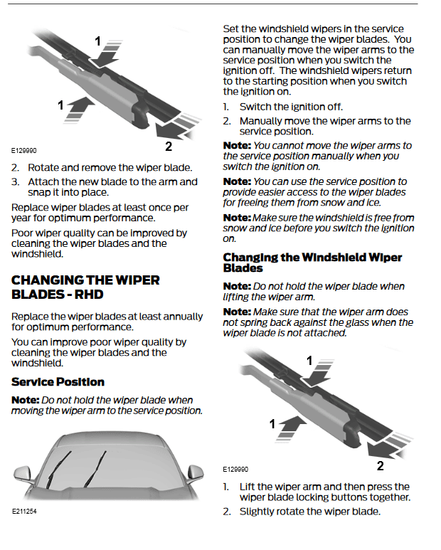

nothing clever, just grab the wiper arm and swing it along the windscreen til it's angled past hitting the bonnet but WD's idea is a much better future proof why didn't Ford think of this kinda idea.

I see. Then it must be a RHD thing, because mine cannot be moved by hand. I've just tried. They won't move.

@raptor17GT - I suspect 15’s and 18’s different bonnet profiles may influence what you can / can’t do with regards clearance and adjustment.
I think the 18’s are designed to clear (maybe more so on LHD’s) but I don’t know about the 15’s, maybe they won’t clear at all ? I’m sure I read the 350’s have an interference design with some accidental marking as a result of it and a mistake during maintenance / cleaning etc :frown:

Ime, the wipers are easy to back-drive & designed to be.
So one should manually move the wipers before lifting them away from the wind shield.
I chose to pop the wiper arms off & reposition them below the bonnet profile, tuck them away, out of sight & air flow.
Popping the wiper arms from their spigots was a pita.
But better that they are well secured than to have a wiper arm stop moving, while in the outside lane of the M1, during a down pour!...

I have a 2016 and the postion they are in is fine and whenever I clean they move an inch or so and then clear the bonnet if I need to lift them up - thought they were all the same as this ?

Well my passenger side does not sit horizontally but I can manually move the wipers through their full arc. RHD Aus spec.

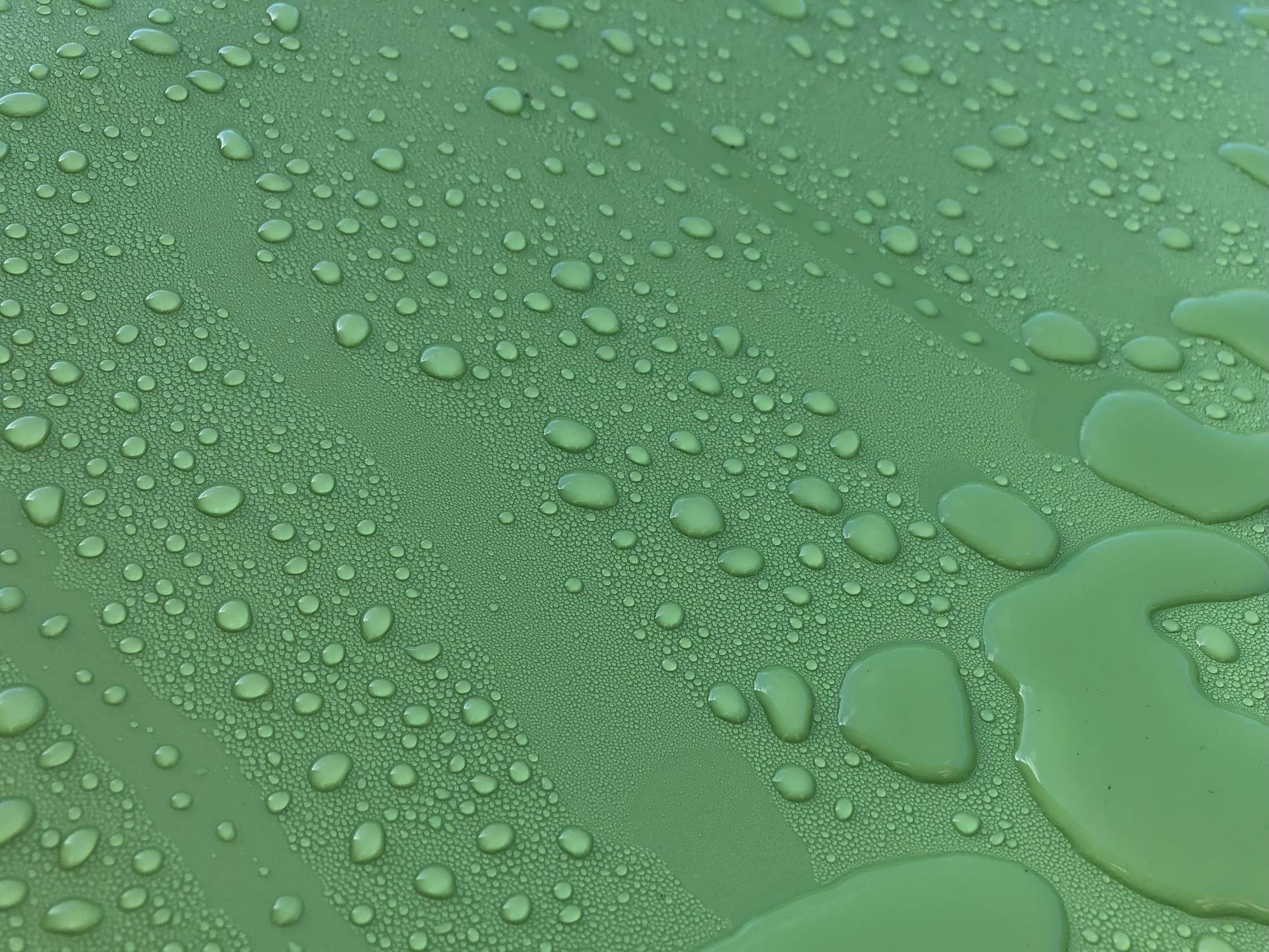

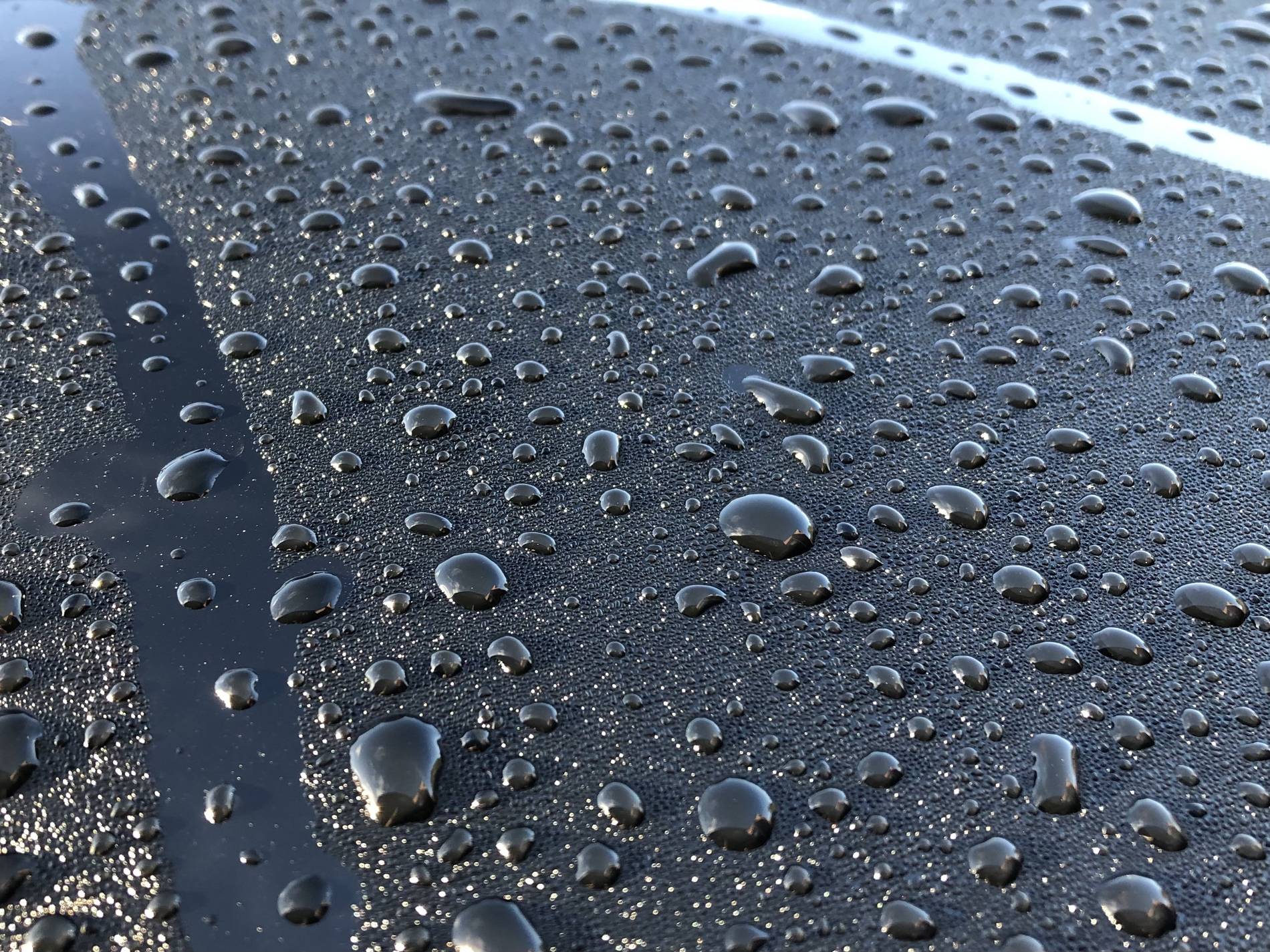

Not much to report, patiently waiting for Santa to arrive ... lol
Gave it a wash at weekend (photos taken today) and the Megs ultimate quick wax is still holding up really quite well, this is after 8 weeks and some particularly crap weather :
I will try and redo it over the Christmas break, weather permitting ...

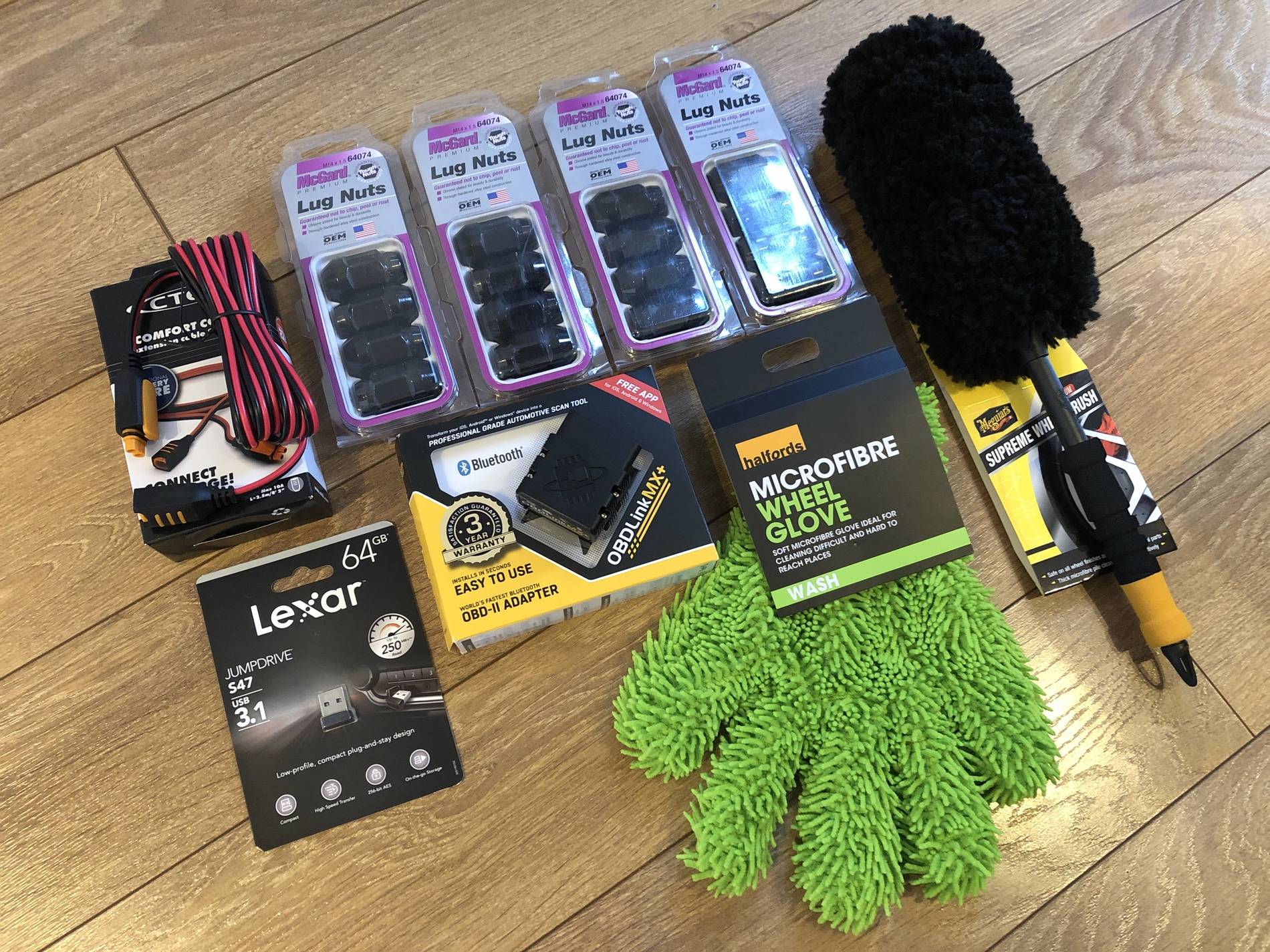

My Mustang specific Christmas pressies :
Got a bit of time to mess around with the OBD programmer and Forscan today, up to now I have changed :
  • Ford Performance start up splash screen.
  • Ford Performance shut down Splash screen.
  • Changed momentary indicator from 3 to 6 flashes (got to show off the sequencers ... lol)
  • Activated the axle oil temp gauge in the digital dash.
  • Activated Door lock in motion. I now have the option on the digital dash but I have yet to test it (snow on roads).
I couldn't get to work the :
  • Oil pressure gauge in the digital dash - I can turn on the gauge, but it wont actually work (seems to be common issue on exports).
  • I cant get Lincoln grey sync theme to work.
  • I want the car to beep on double lock - I know everyone stateside wants to turn this off, but I just like being different ... lol
I will pick the above points up on the Forscan thread and see if I can find some solutions :like:
