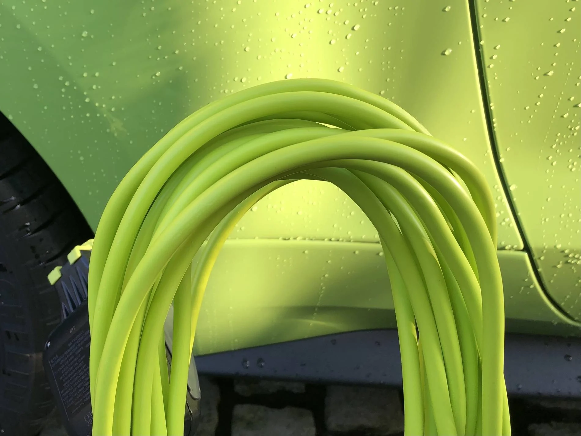

I wanted a waterproof extension lead for using the CTEK outdoors, I had a choice of blue, yellow, orange or ...
The choice was an easy one :sunglasses:

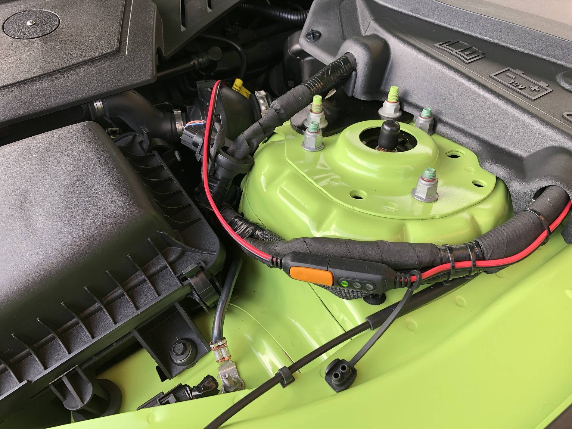

For those that spotted the CTEK extension lead with my Christmas presents, that was a replacement as I have been dropping it down the side of the engine so the charger can hide under the car with no wires coming out past the cowl or over the headlights / paintwork etc :
But when you drive off and forget about it you have to buy a new one ... :cwl:
Fortunately the charger wasn't connected and it did zero damage to the car - after 20 miles it had survived surprisingly well with only a partially melted section (no shorting) and a scuffed plug on the end of the lead that was trailing under the car, I was very lucky :like:

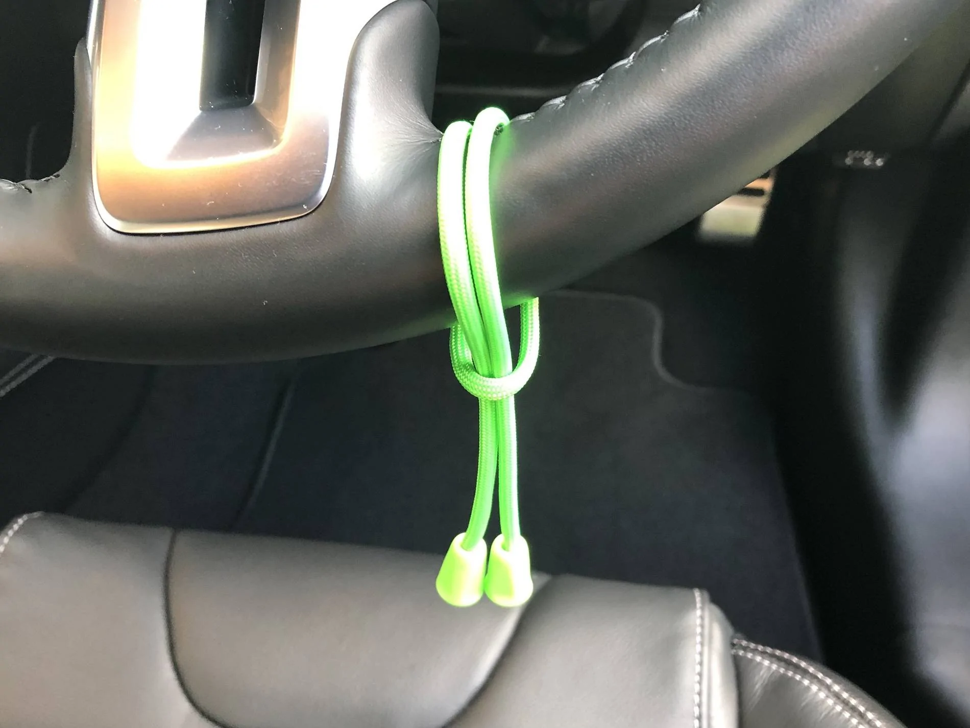

This is my idiot solution so it doesn't happen again :

like the clip on handerbar strap for a bikes disk lock :sunglasses:
That's what gave me the idea - even though I didn't initially think I would need it ... :blush:

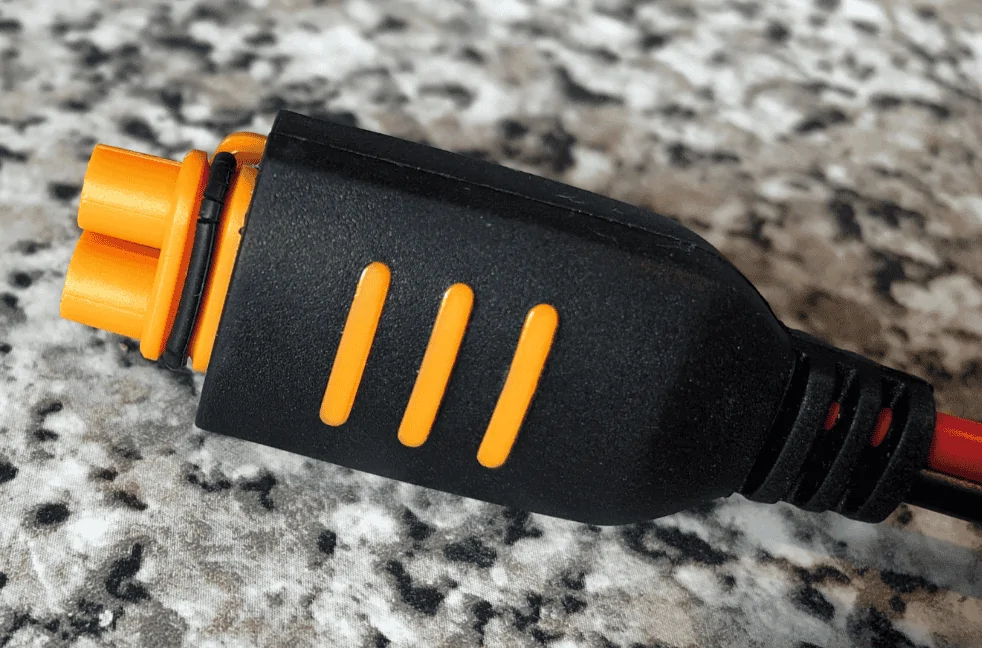

Edited to add the following info :
If anyone is using a CTEK in an outdoor or potentially damp / wet environment then check the o ring seal on the quick connects. They are in slight tension when fitted so they don't last as long as you might expect :
I have seen 'new' CTEK stuff come with seals that already show signs of perishing (I assume on older stock).
Replacement seals are available cheaply on eBay (example item number 293704106329 ... :wink:)

I have my Ctek connector mounted in the grill honeycomb and it is very unobtrusive. The one and only time that I forgot about disconnecting the charger when reversing out of my garage the leads just harmlessly separated. As long as the charger is screwed to the wall in front of the car I feel safe that if I forget again there should be no dramas.

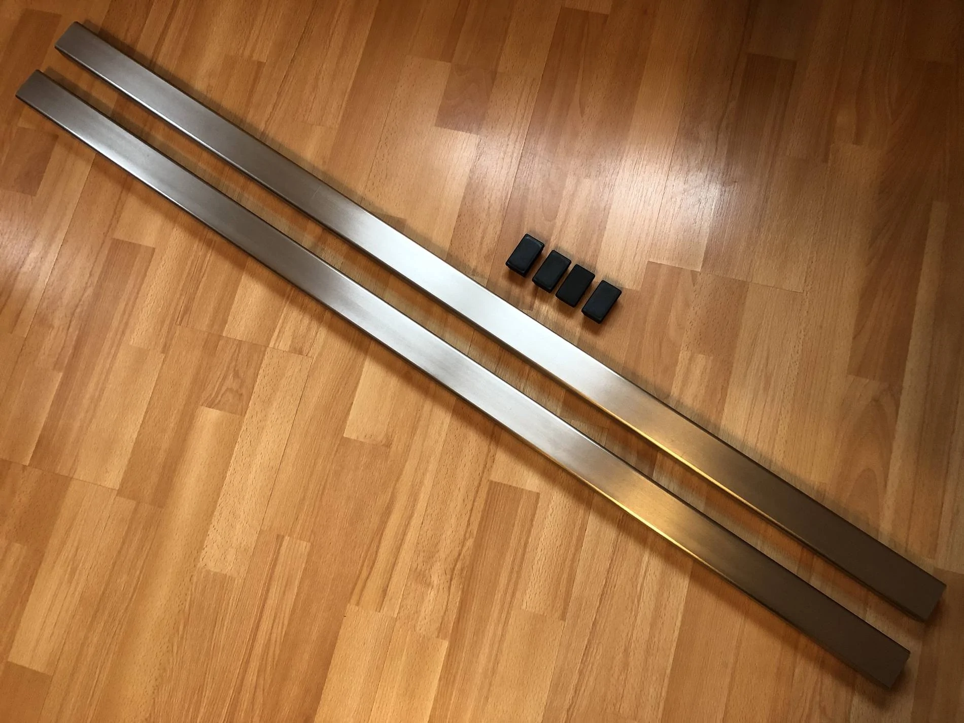

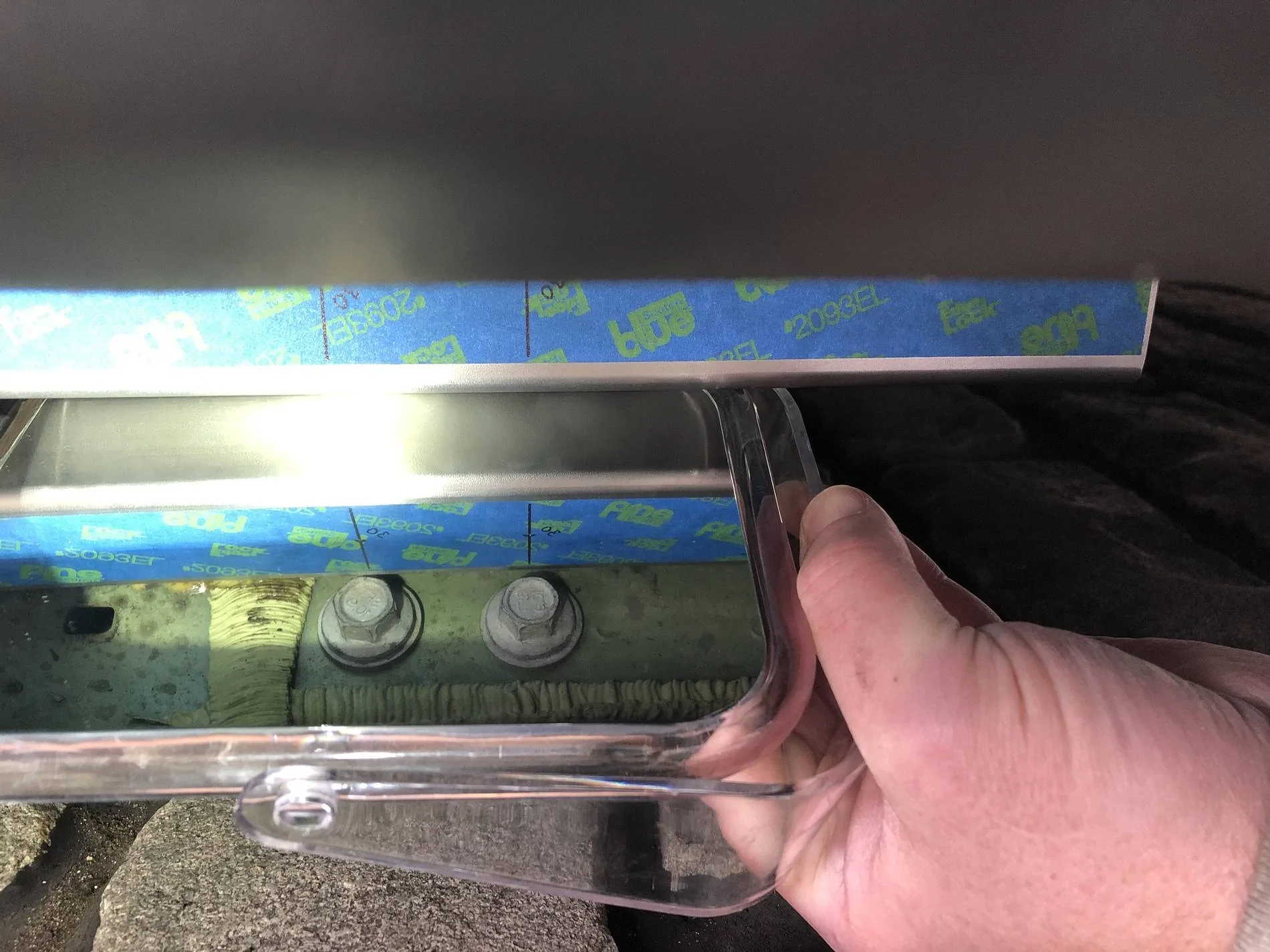

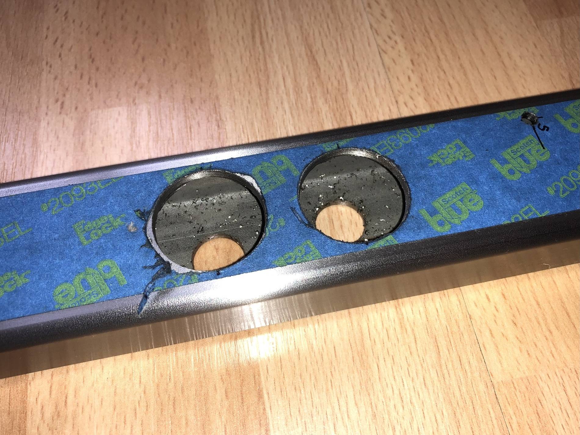

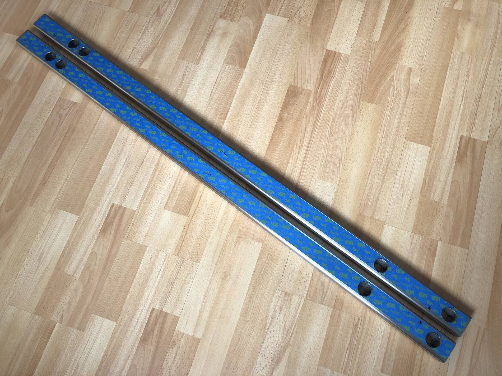

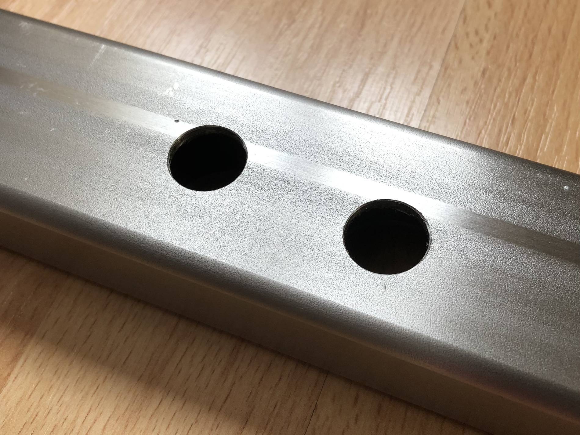

• Got to start making some stuff :
Thanks to @JohnVallo for sharing some dimensions, but that didn’t stop me measuring and checking about three times each ... lol
Front holes offset on topside only :
Lots of deburring to do :
Complete with drain holes on the lower outer edges :
WD :like:

loving the jacking bars - nice work fella, are you galvanising them?

Galvanising them would be pointless, they are stainless steel ... :wink:

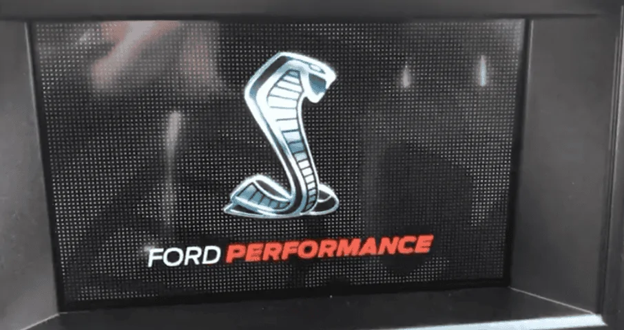

  • Ford Performance splash screen animation (not my photo) :
