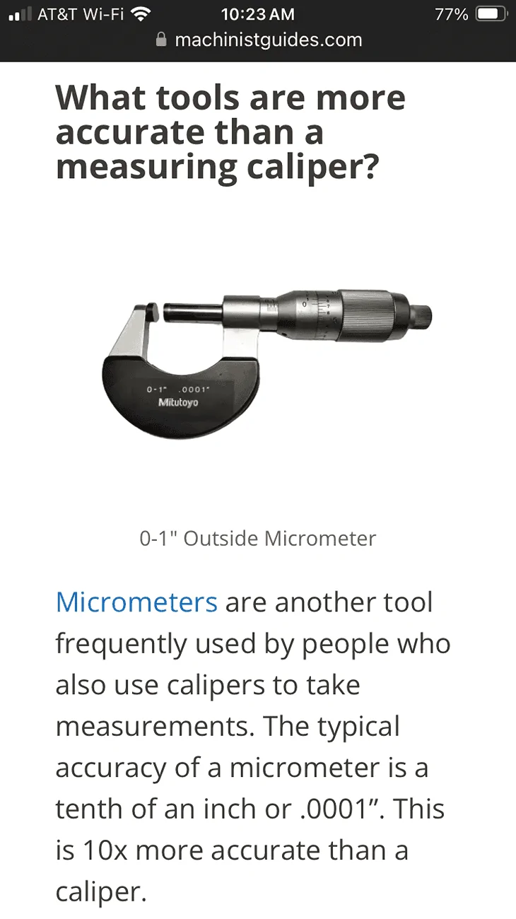

Modern Digital calipers are more accurate...
But the user can still impact the reading by holding them crooked or applying too much or too little force, for example. Calipers are good to about 0.001", depending on what you are trying to measure. They aren't good enough for checking engine components.

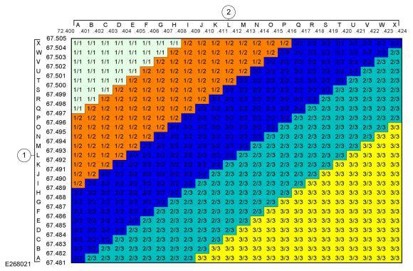

Not the way Ford assigned bearing sets.
Really? Why don't you pull the tolerances and post them then. I can for you if you'd like.
also I did not realize we were comparing completely different tools rather than comparing digital to analog. In that case why don't we use lasers, after all they can be much more accurate
This thread might help explain where I’m coming from in reference to Ford OEM bearing selection.
https://www.mustang6g.com/forums/threads/5-2-build-main-bearing-size-code-identification.177932/

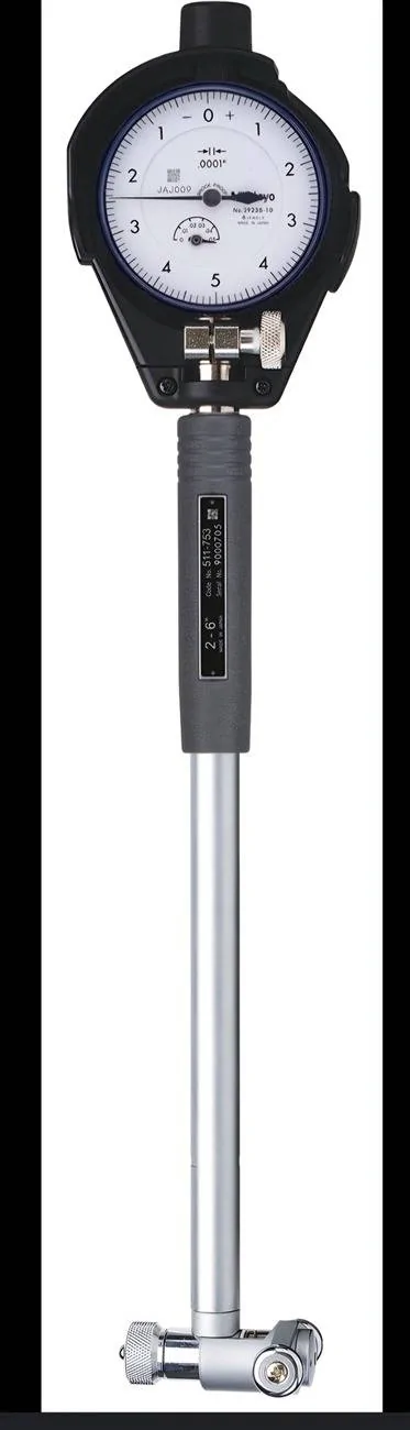

I'm not disagreeing at all. Im just stating a digital caliper is not as accurate as a bore gauge for checking bearing clearances.

Stop it, everybody just knock it off. Nobody uses calipers for that level of precision. Or, if you do, you only try it once. Digital or not. Everybody else is just trolling you.

There’s nothing arbitrary about the Ford bearing grading system or its precision.
