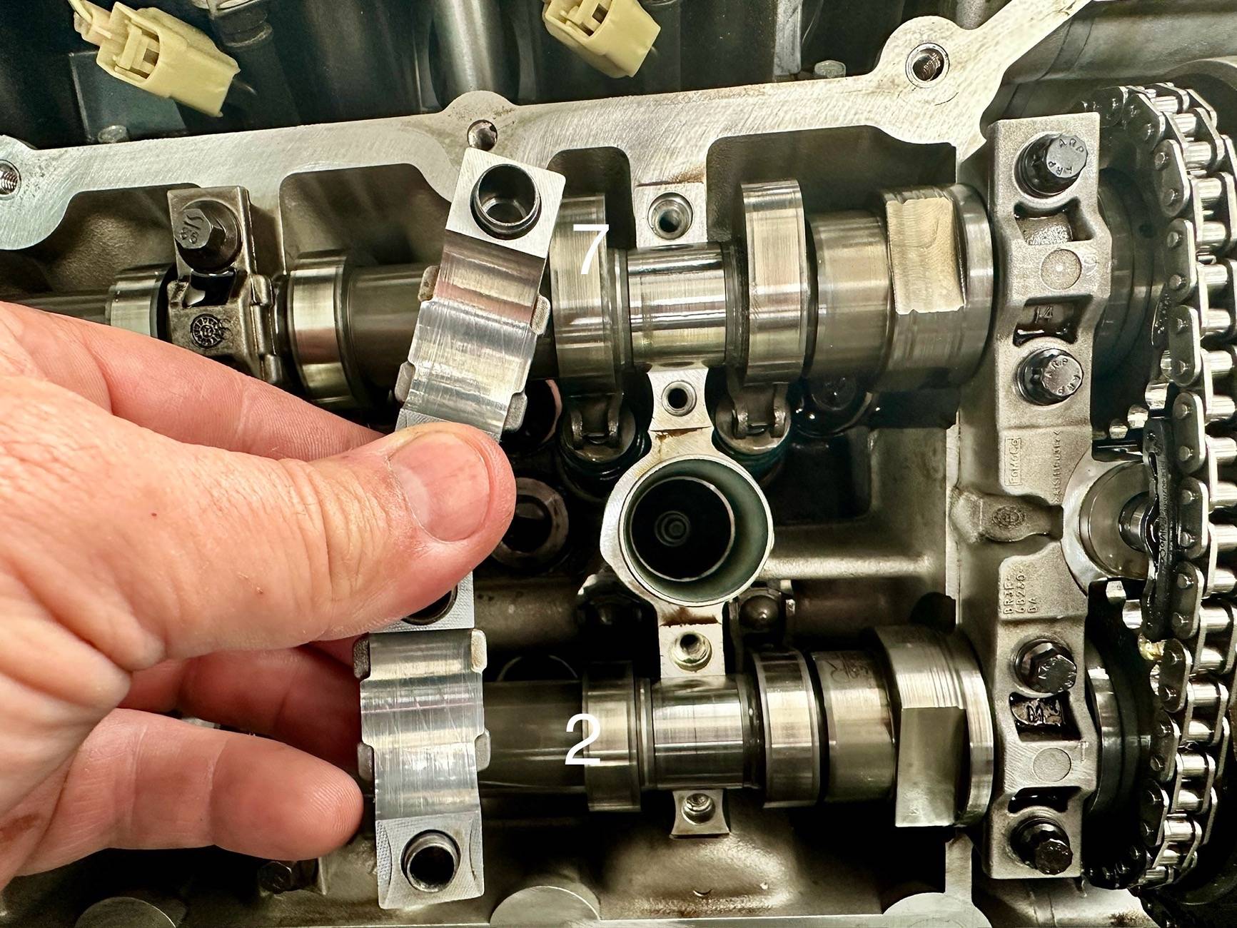

Hello; Cams and caps show some lite scoring at least. Can you feel the surface or catch a fingernail on the slight marks?
Post #135 with pictures of a main cap is the more disturbing of all. A suspicion is the glitter is from the sides of that bearing and that material has been circulating for a while. Take these conjectures with many grains of salt to use an old saying.
The crank looks good in the pictures if I recall correctly. Nice and smooth with no scoring, I think.
I think an oil analysis is yet to come. Perhaps ponder the situation until that comes.
I am a few hundred miles from you and only looking at pictures so at best cannot have a good feel for the situation. Perhaps someone with actual experience on these engines might chime in. The look of the cams and cam caps may not be very unusual. May be acceptable wear for what I know, but I am suspicious. I do not have experience directly with these engines.
I do think you could button the engine back up and run it again. No idea how long it may go.
I can see the bearings in the caps being replaced but have never tried to push out a bearing from between the crank and the block. I have red-necked replacing connecting rod bearings after my first engine rebuild. I made an error when assembling the engine and got grit in one connecting rod cap. After 800 miles I had a knock. It was a straight six Chevy and i could get the oil pan off & out. For a few times I put in new bearings to get another few hundred miles down the road. Finally sapped a used small block V8 in.
Again good luck.
Again good luck.

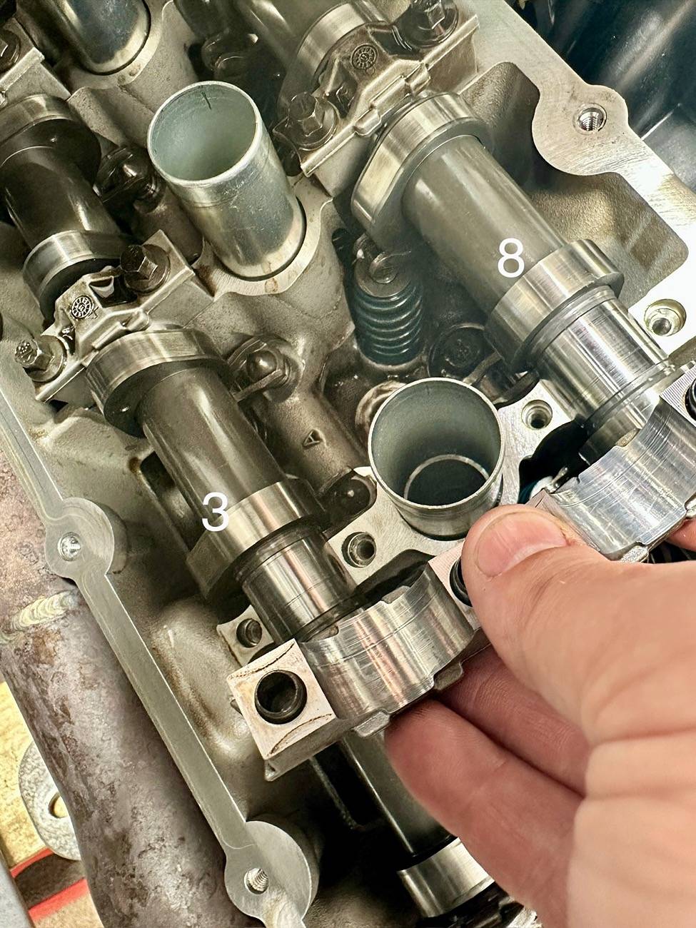

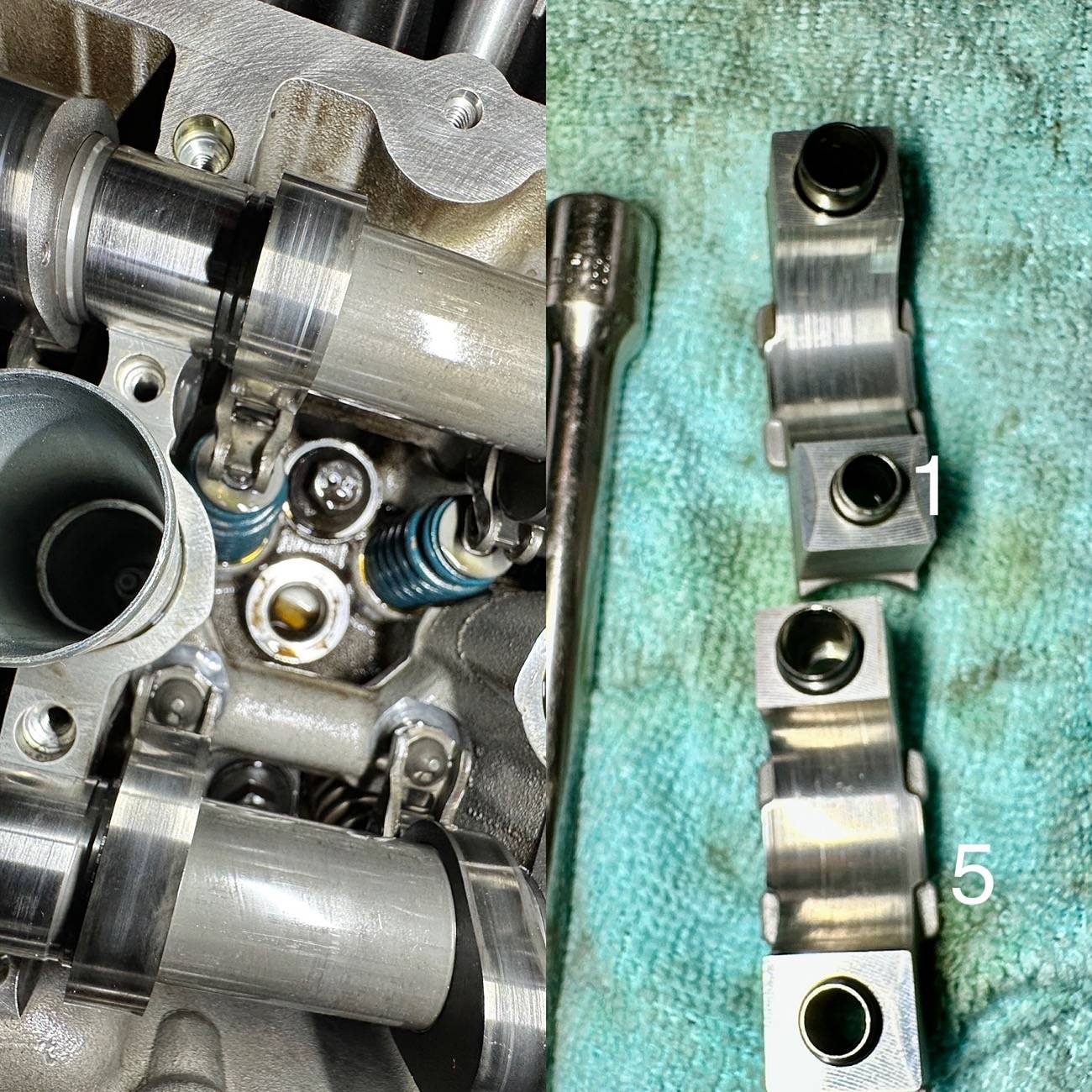

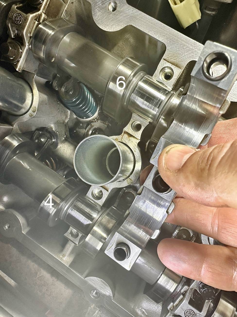

Cam caps #3, and # 8catch my finger nail the others do not.

Hello; That the scoring catches a fingernail is not good. Since my take is the cams, caps and the head itself do not have replaceable bearings, then it appears you are looking at new heads. I do hope this is not the final word on this particular bit of your troubles.
Another problem will be cleaning out all the debris which will be thru-out the engine.
Take a few days to get as much information as you can. Do not put too much faith in such as me on a forum.

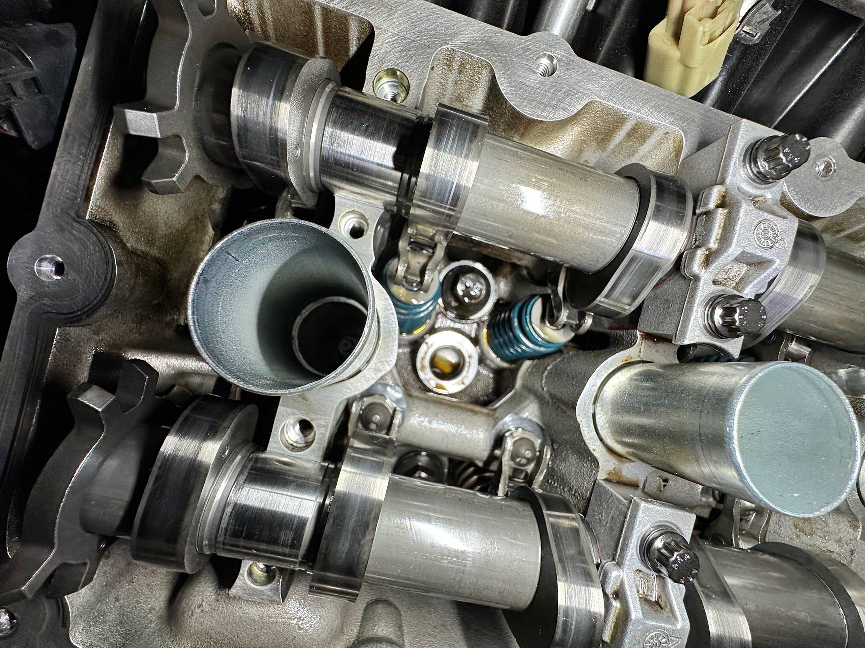

Only had time to go thru the passenger side cams
Thoughts?
There are not supposed to be particles going through the bearing journals. They look toast to me based on engine teardowns I've seen on YouTube. The cam lobes even look bad to me with the scratches going around them. But I've never had an overhead cam engine apart myself. Whether it would be fine to run after the source of the contamination is cleaned up? I wouldn't, but maybe?
I do think there is merit in taking consideration to what modern digital cameras highlight and the uploading of those images. It’s a crap shoot looking at online pix vs inspecting with the naked eye and proper inspection lighting. I know LED lighting can and does create illusion and shadows that can trick the human eye. I’ve seen this with quality medical grade borescopes for inspection purposes especially on reflective surfaces.
