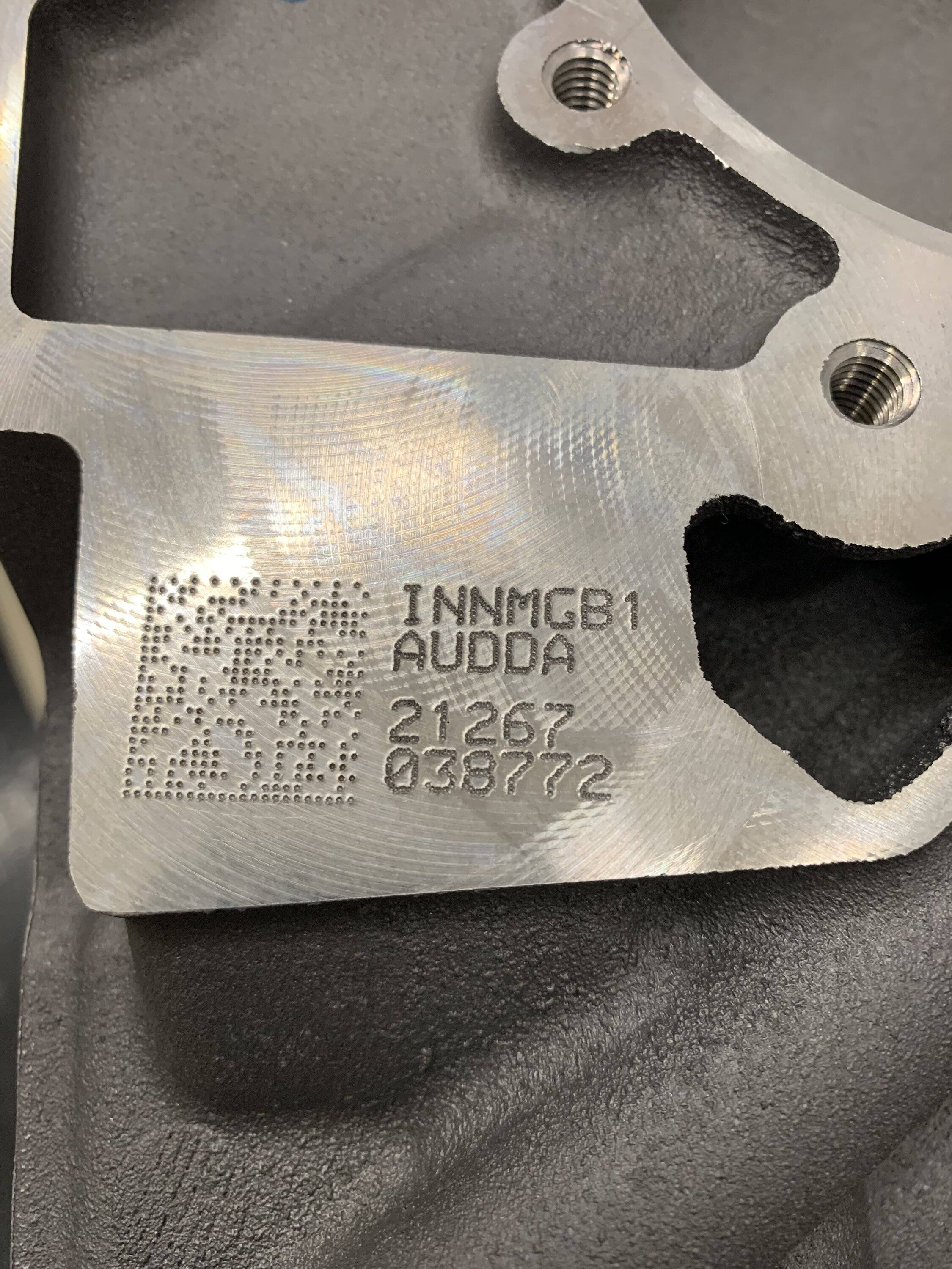

I’m currently building a basically stock Predator short block. The ford procedure for selecting the main bearing thickness, or “grade”, is described here:
https://www.mustang6g.com/forums/threads/bbq-tick-test-request.117273/page-2#post-2467476
However, the code on the block is:
I have reason to believe the main bearing code is the first string of characters, but I also have reason to believe it’s the second string of characters. So which is it?
And before anyone suggests it….yes I’m dead-set on using oem bearings not aftermarket.
6,302
6,630

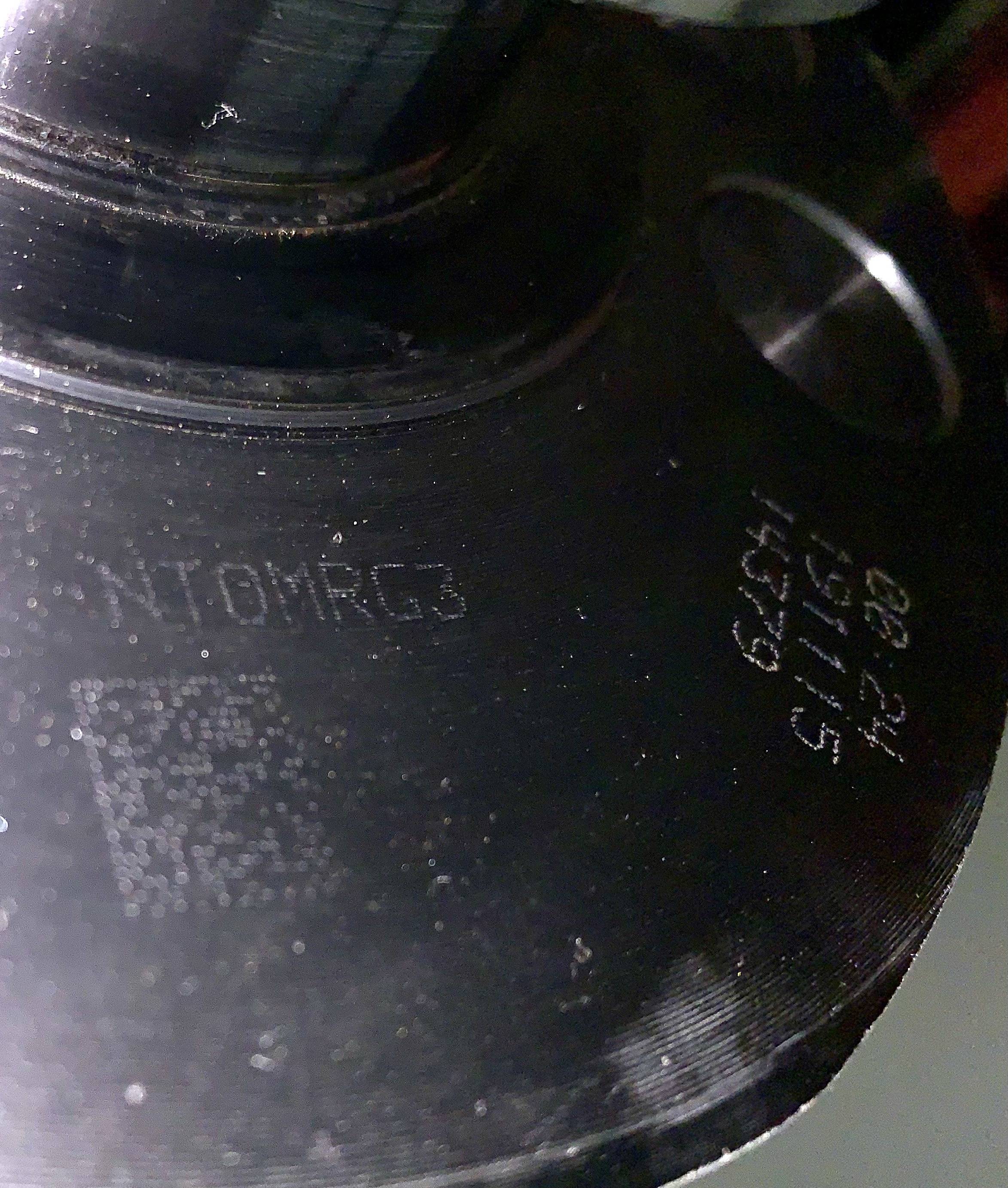

Thanks @bauern that’s my initial thought as well, But I’ll show you why I’m doubting it. This attached pic is my predator crankshaft. It just has the 6 letter, 1 number code like the first string on the block, not a 5 letter code.
If I was in your place I'd ignore the OEM pin stamped letters.
I'd map out each crank journal and main bearing bores 1 thru 5 then use the Ford bearing chart numeric diameter range assigned to the lettering system.
Painfully time consuming but this leaves no chance of misinterpreting an obscure factory lettering system.
My guess is the seven character nomenclature first 5 letters will probably fall inline with the Ford bearing chart size and what you end up mapping out with micrometers and bore gauges.
I used to hate this crap from Ford when I was working on them for a living. When we called for parts we needed to tell them the model, engine, trans, color of car, month, day and time it was built. With all that info getting the correct part was still a coin flip.
Wondering if you should get the block decked and line bored.

One issue I’m having is that the difference between G and K is .0002”…it’s pretty difficult to measure to this accuracy with an ordinary starrett mic, especially the main bores.

Measure enough to know which string to use then trust the stamped code for that journal.
That’s the plan. And the absolute value isn’t as important as the relative value. E.g. if the difference between main 1 and 2 is about a mil, then it’s probably AUDDA.

Here are the conversions using both strings, just to show the accuracy level we're talking about:

It’s nerve wracking but I measured each main in 3 locations and averaged them:
1. 2.8512
2. 2.8515
3. 2.8516
4. 2.8515
5. 2.8510
