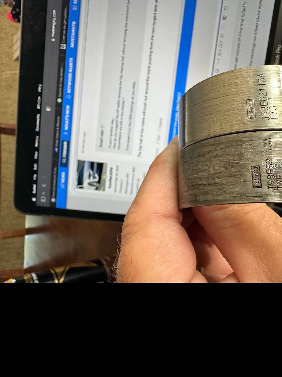

Sourcing the OEM bearings requires decoding the block and crank nomenclature to arrive at the correct matched sets.
You will not find STD. on the OEM bearing. Ford uses a unique identification system.

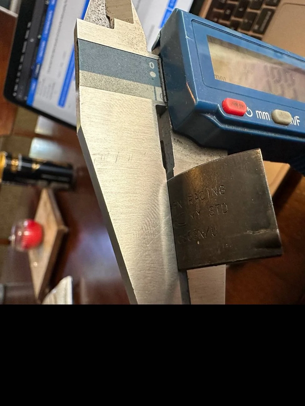

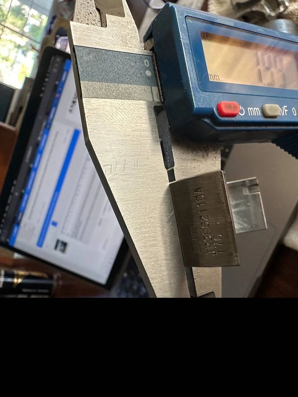

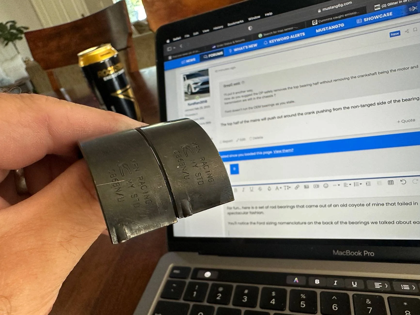

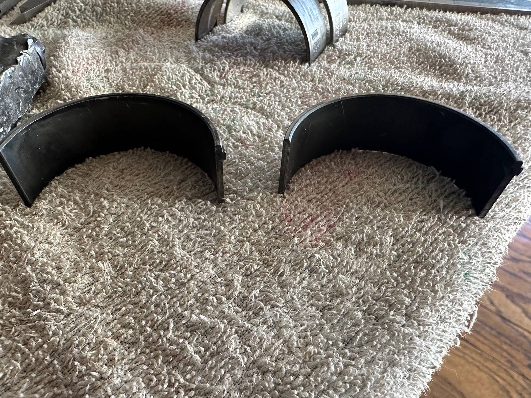

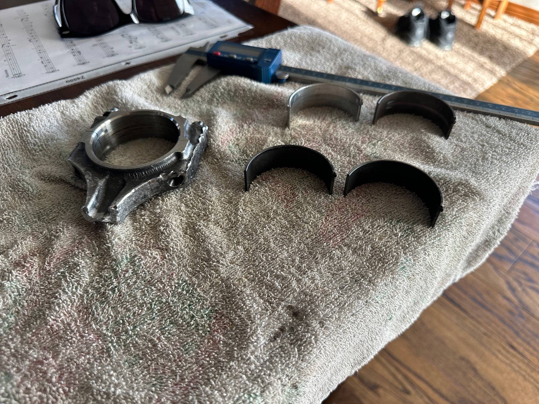

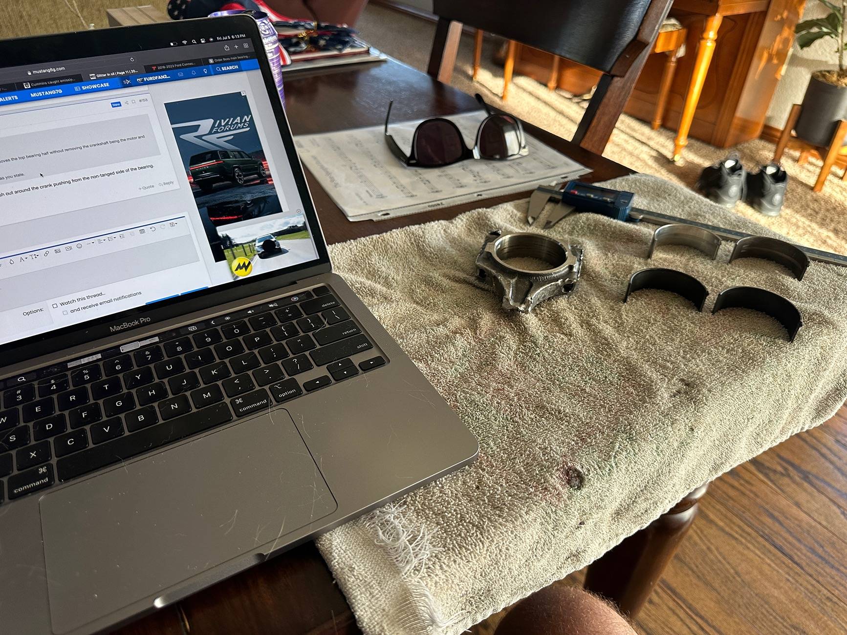

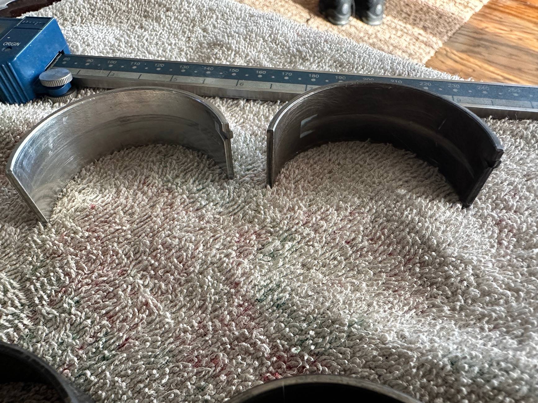

For fun... here is a set of rod bearings that came out of an old coyote of mine that failed in spectacular fashion.
You'll notice the Ford sizing nomenclature on the back of the bearings we talked about earlier.
You'll also notice they measure 1.99mm. These were taken out of a 2018 blown up Coyote gen 3 with only 4k miles.
Then here we have the brand new King "STD" sized bearings. They measure exactly the same as the Ford blueprinted bearings.
Measured “exactly”, with a digital caliper ?
Not my first rodeo.

Hello; Been following this thread a while. I feel for the OP in that his new to him car seems to have a potentially serious problem. The glitter in the oil is a red flag. The bearings pictured all show some marks with a couple showing more suspicious marks.
