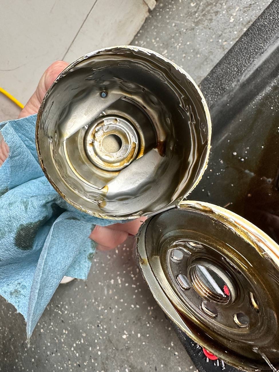

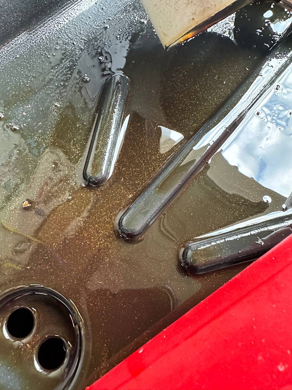

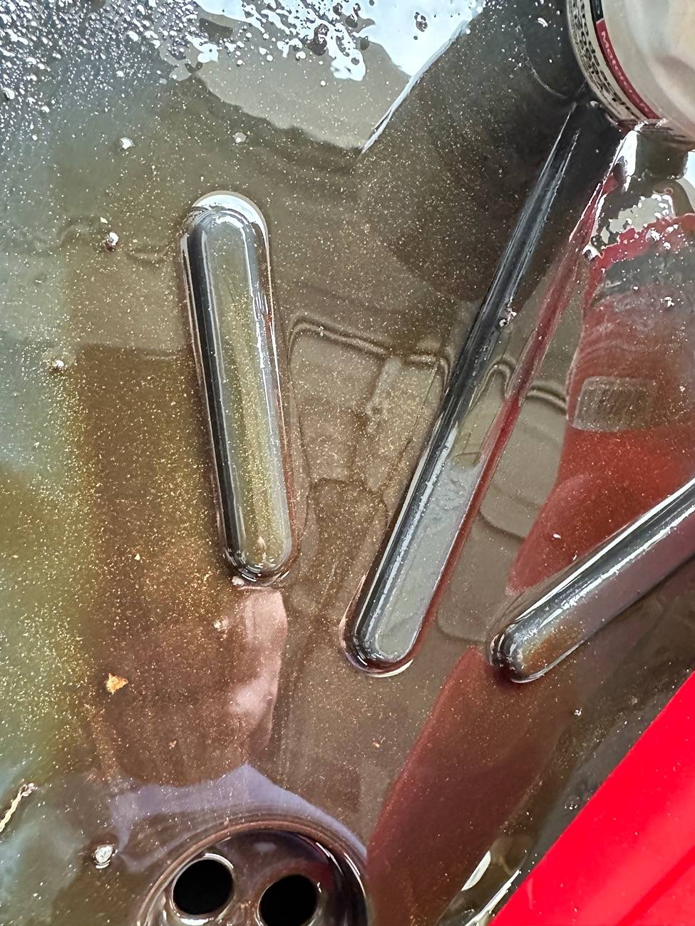

What’s up, is it normal for these voodoo engines to have some glitter in oil?
Was doing some maintenance while I am waiting on the title for this new to me 2016 GT350 with 59k mi.

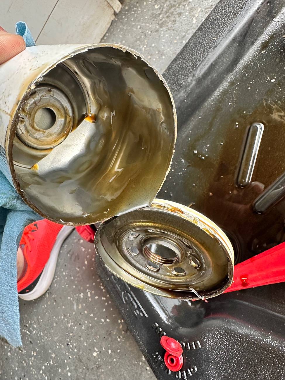

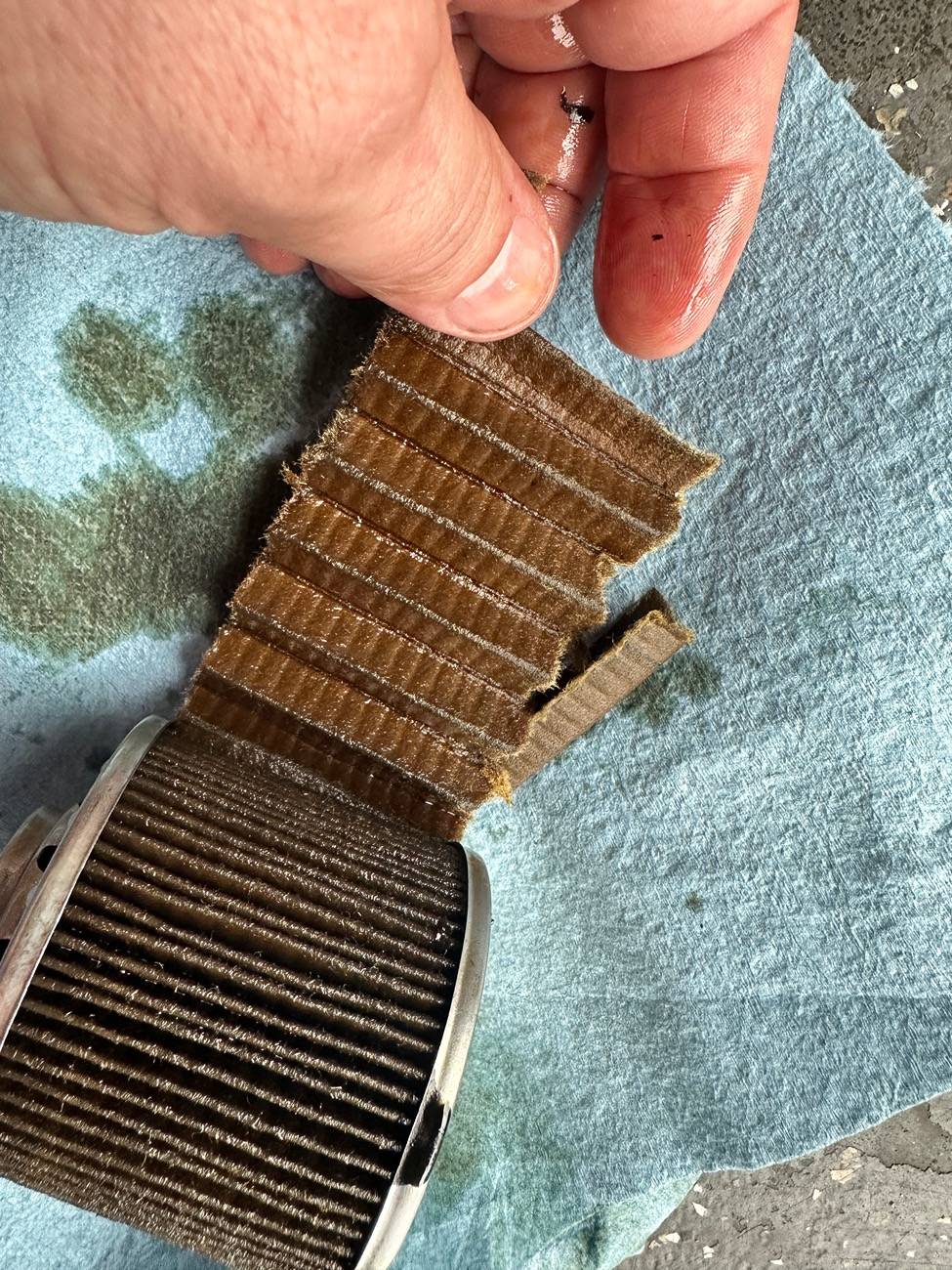

I’m freaking out because this looks like metal to me. Cut the filter open and I don’t see any flakes in the paper filter element anywhere or the top of the can. There was some glitter in the oil in the filter but maybe that was from the cut off wheel I used to cut the filter open? Idk I didn’t have anything else to cut it open.
Let me know your thoughts.
probably doesn’t matter that the car passed a pre-purchase inspection where I also wanted a leak down test but upon the initial compression test there was zero percent lost across all cylinders so the tech at ford said a leak down would be pointless.
but if glitter is bearing material I guess that doesn’t matter huh.
Thanks in advance.
anything else I can check?

Also no glitter in the catch can

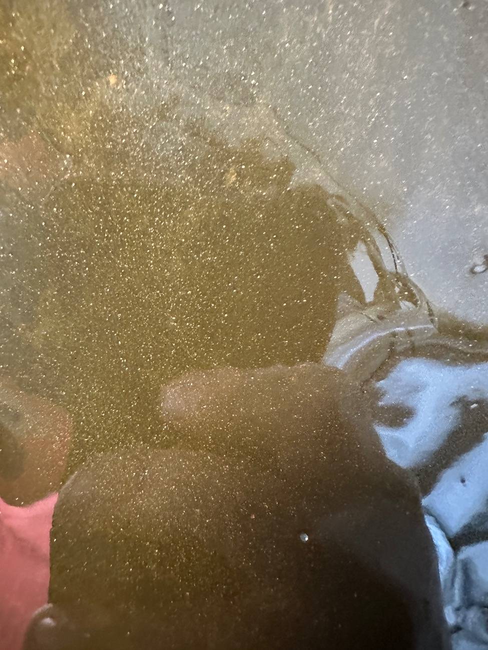

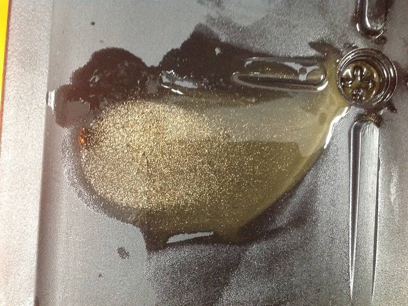

Looks like your motor has spun a bearing. I’ve seen that twice before on motorcycle engines. That’s a lot of bronze or copper in the oil. Here’s a pic of the oil from my Harley Sportster engine which spun cam cover bushing.

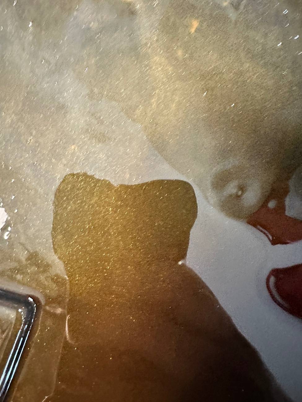

Here are some videos

How could it be suspended in the oil but none be trapped in the filter element? Every single spun bearing I’ve ever seen had plenty of glitter in the paper filter element.
I don’t know, but that sure is a lot of flakes.
