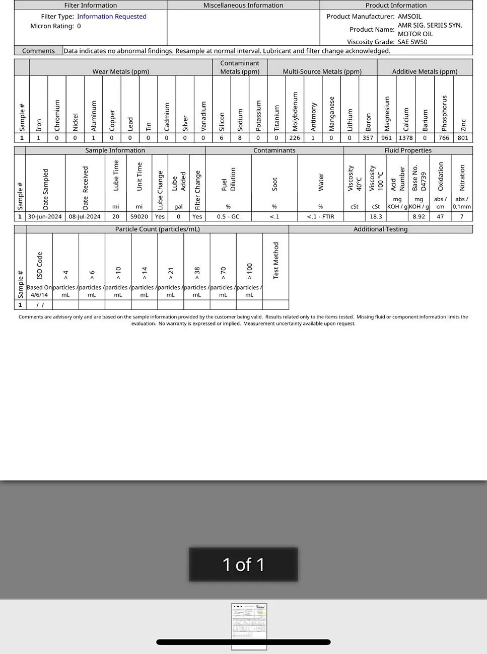

Here is the UOA for the oil that was in the car when i bought it.
Really the only concerning thing is the water but after to speaking to the company these levels are about 2ml in the whole 100ml sample I sent in.
its very plausible that the water is cleaner from cleaning the surface of my drain pan.
Next time I will try and grab a sample directly from the oil pan.

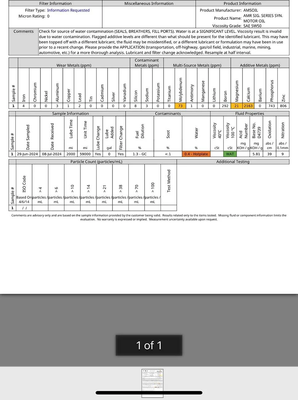

Here is the UOA of the amsoil I put in. It was only in the car a few hours before I went ahead and dropped the pan to do my investigation.
I’ll send another sample in to be analyzed in at minimum 500 mi.

I m sticking with additive is all your seeing.

I've never had an oil analysis, but I assume metal from bearing wear would show up no?
Kinda sounds like you are buttoning it up and getting ready to drive it. 😎
Yes there is a section on the report labeled wear metals where they show anything that would be breaking down.
