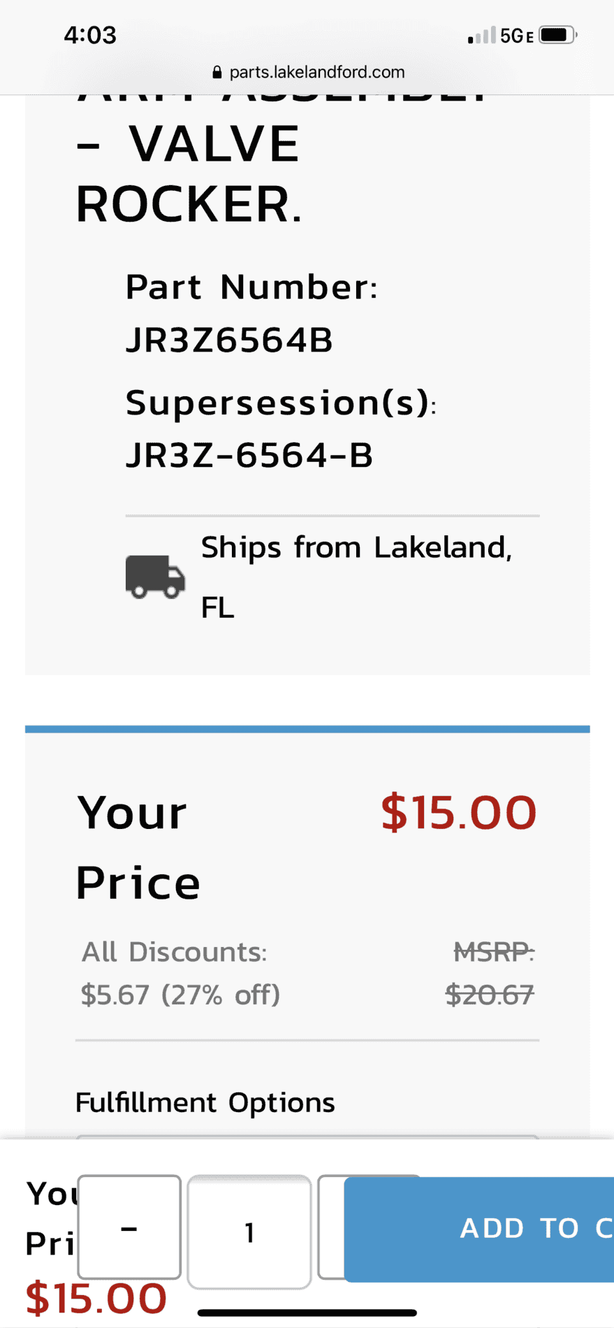

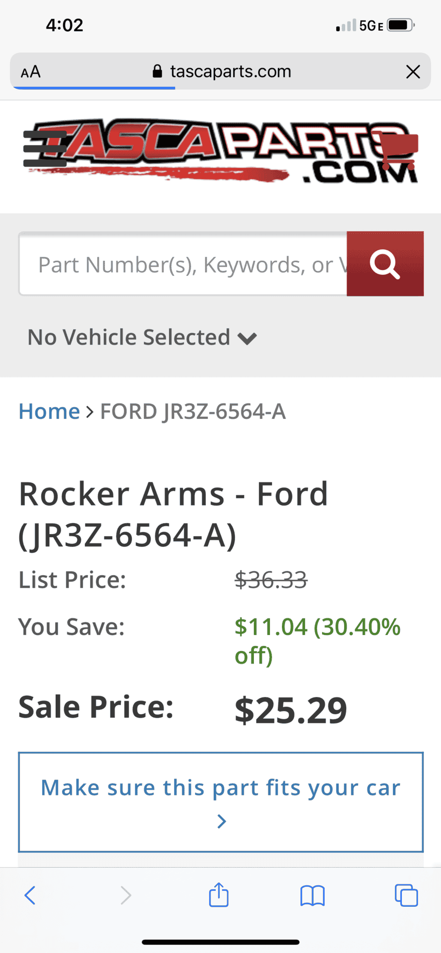

Funny thing is the revision (B) can be found cheaper at $15 vs $25
but x 32= $480
so you are better off buying the GT 500 part from Ford performance

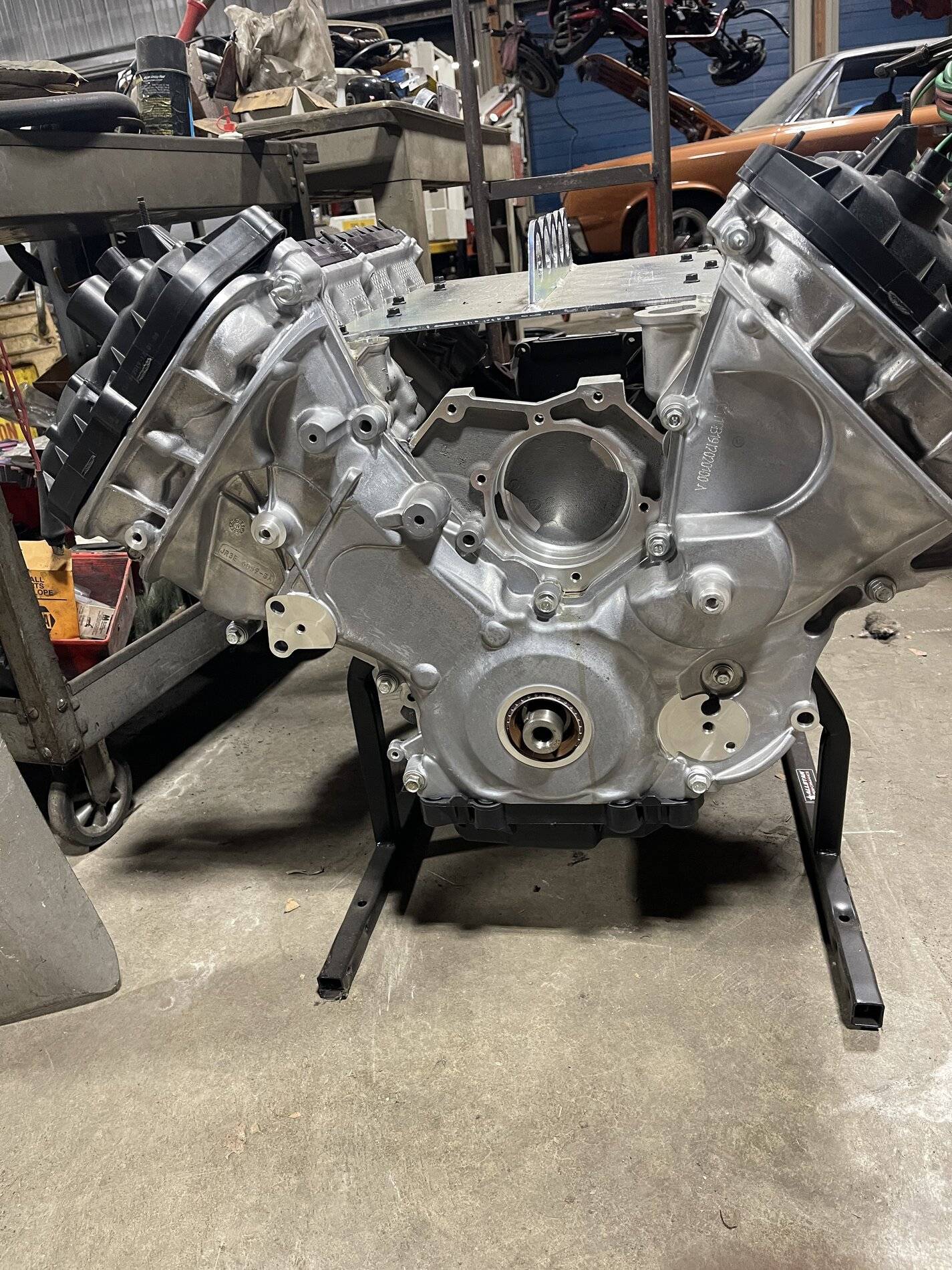

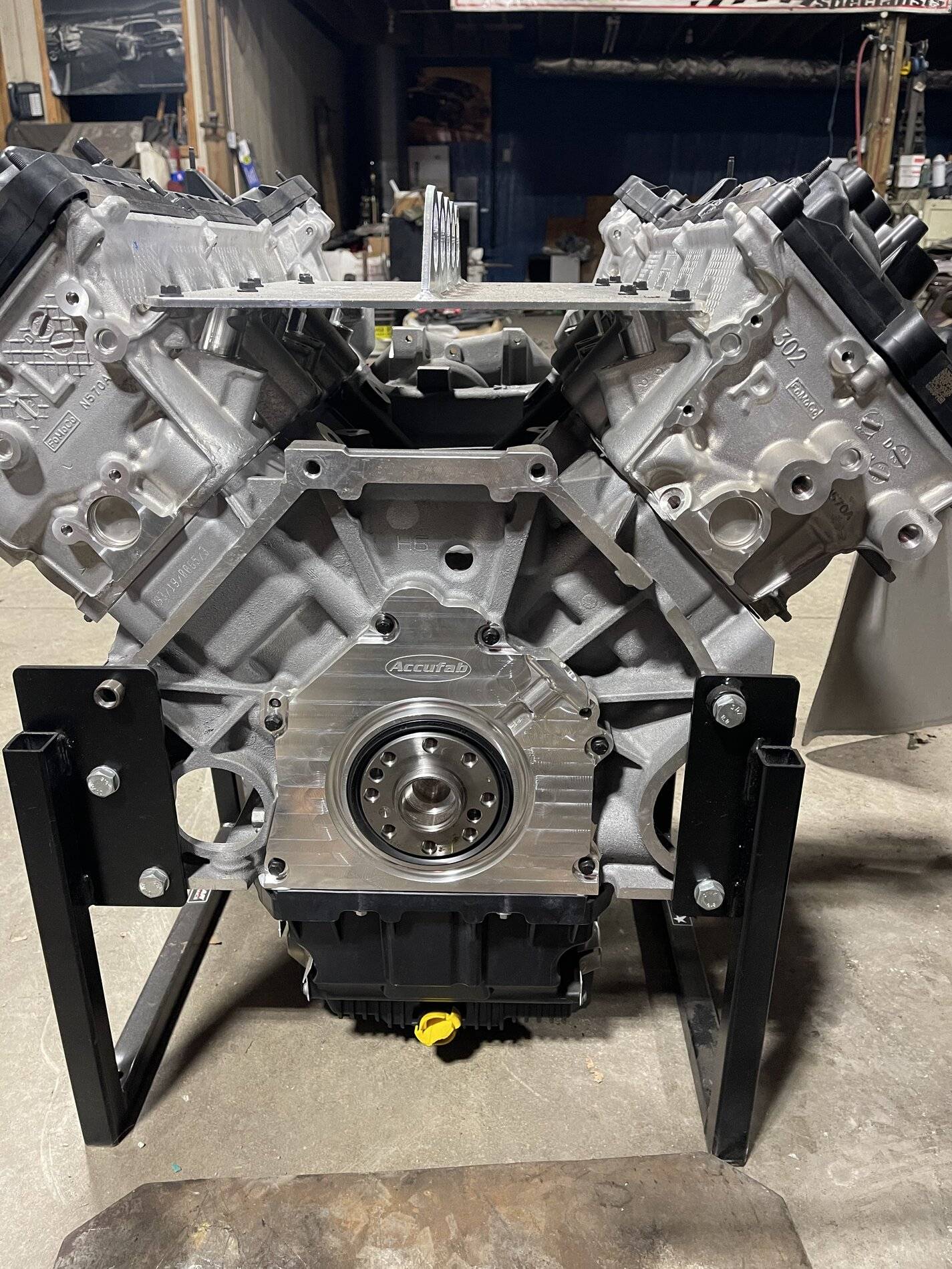

Plenty of people have "used" the GT350 block in their builds .
I know of several builds with Gen 2 coyote heads that are running and making 1100-1200 whp.
I have a completed build using the block and Gen 3 heads but its still sitting on a cradle.
Not that you can tell from the pic but I thought I would show it off anyway šŸ˜Ž
