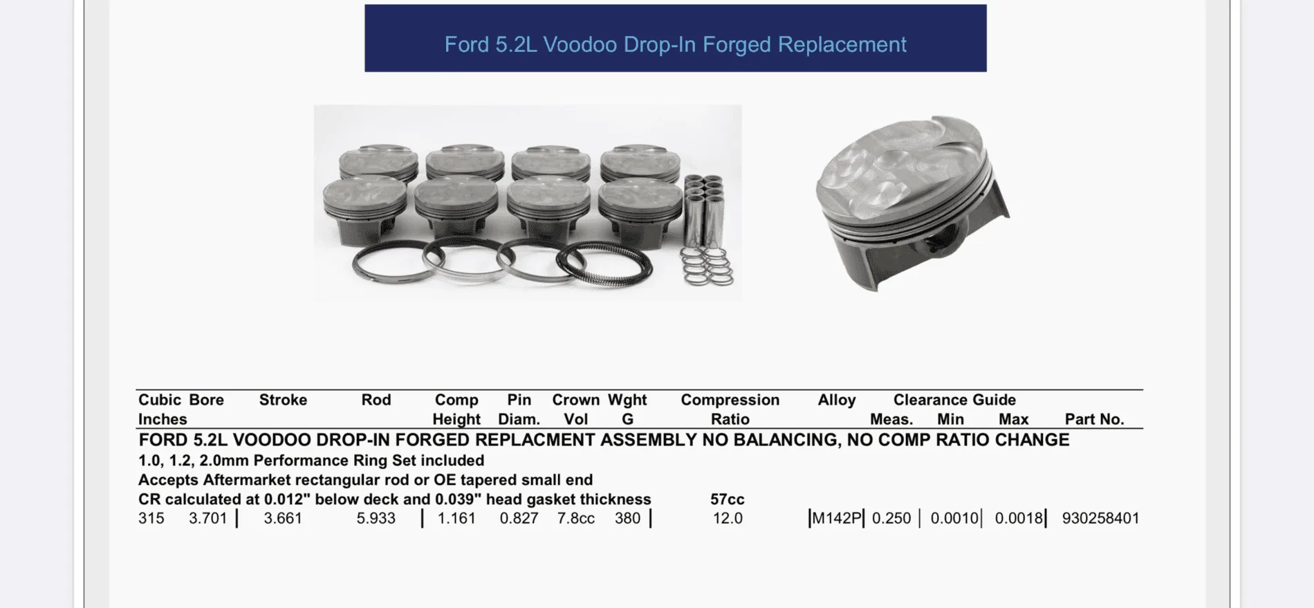

Have you guys noticed that all the pistons for the 3.7 bore are 2618 and there do not seem to be any 4032 pistons? I wonder why the difference. Does it have something to do with the spray bore vs sleeved engine? I am also trying to decide if the 12.3:1 pistons are overkill in boosted application

Not sure what the M142P are but it looks like those pistons are a stock replacement (same).
May be they are 4032 ?
