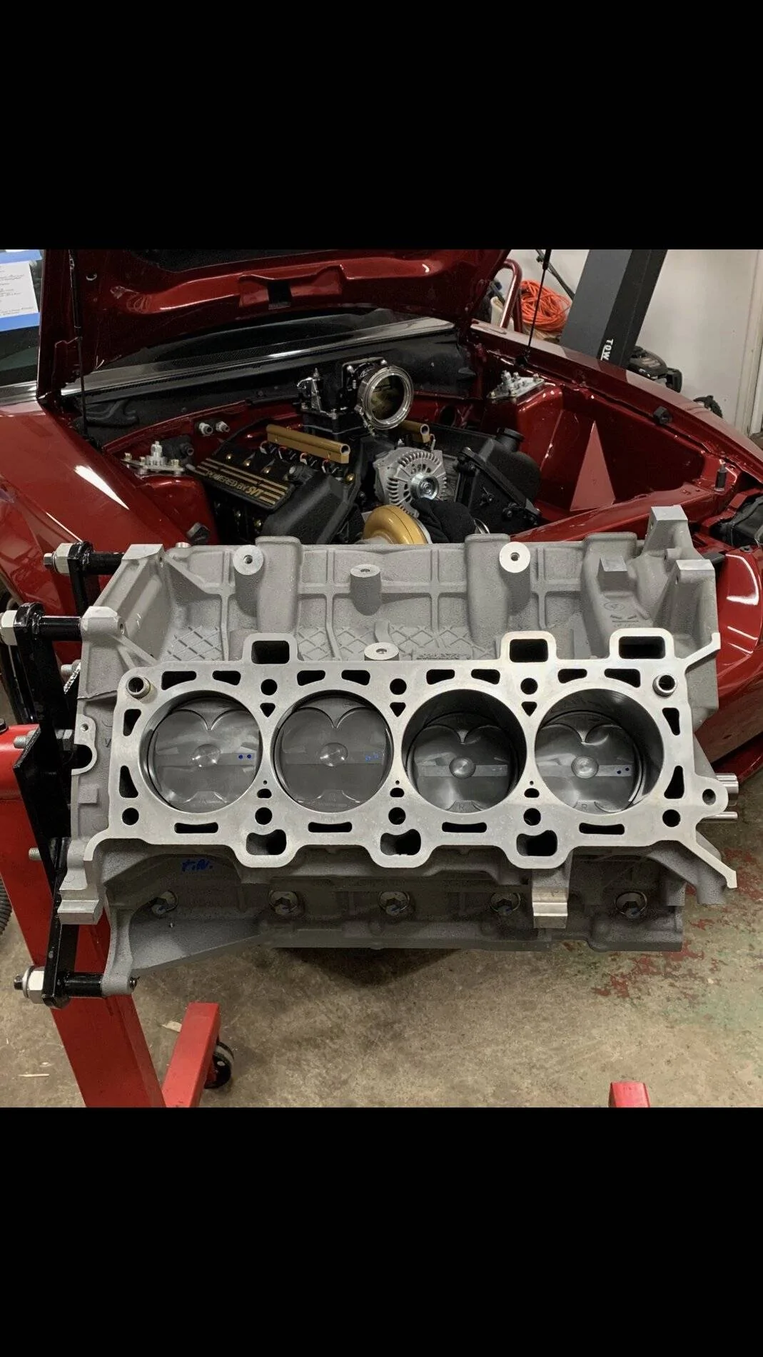

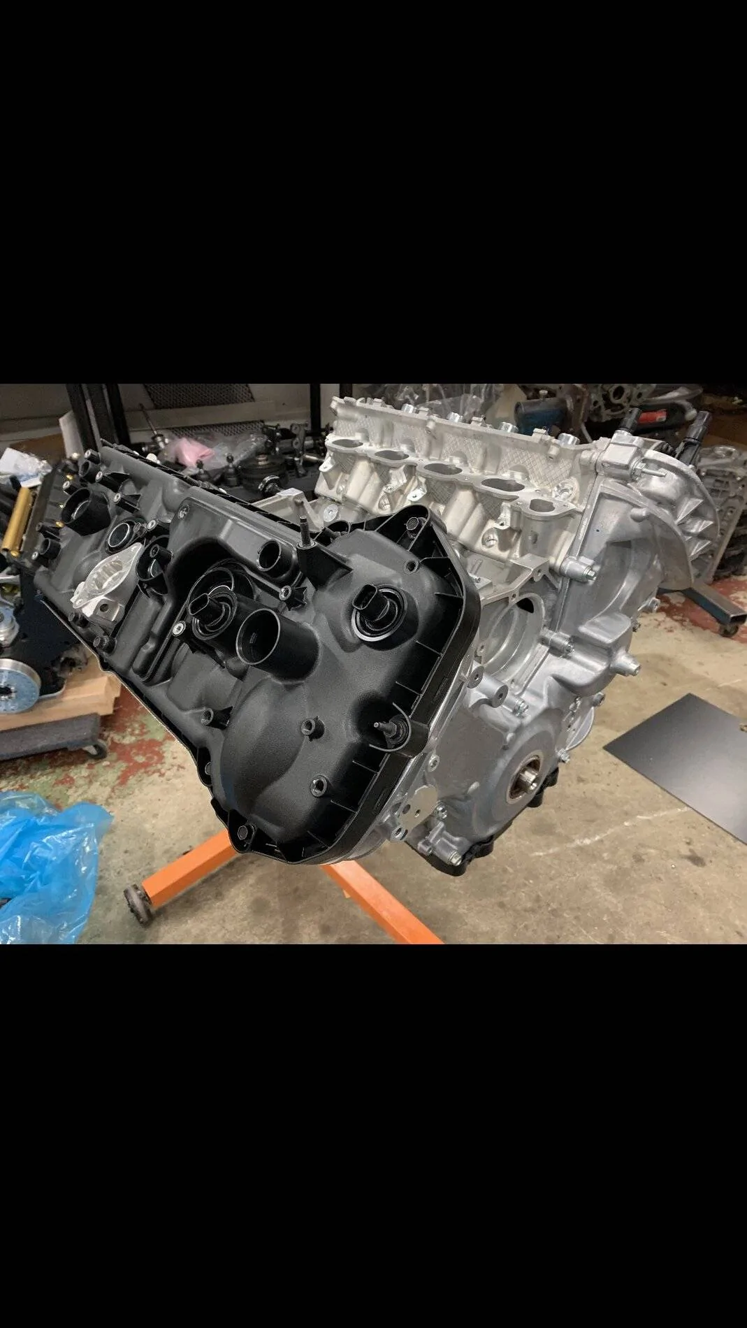

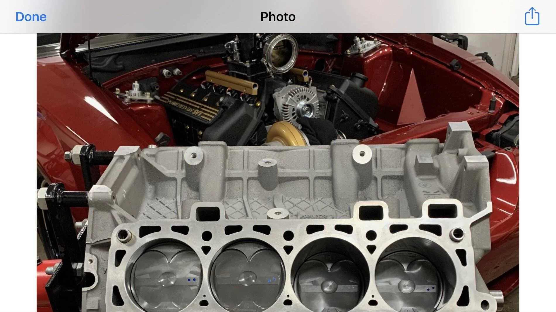

I have the set up (Gen 2 voodoo block / voodoo pistons /Gen 3 coyote heads ) waiting to swap in my 18 /GT whipple . I used a boss crank which has a smaller stroke
than the 5.2 CP/voodoo crank so compression ratio will be down to 11.9 and you will lose a little bit of quench

Any Gen heads (1-3) will work.
@80FoxCoupe has Gen 2 heads on his .
(sleeved ).
I am building another one(with Gen 3 heads ) but this time with Gen 3 coyote specific pistols /Boss crank so I keep the 12.1 compression and don’t lose the quench

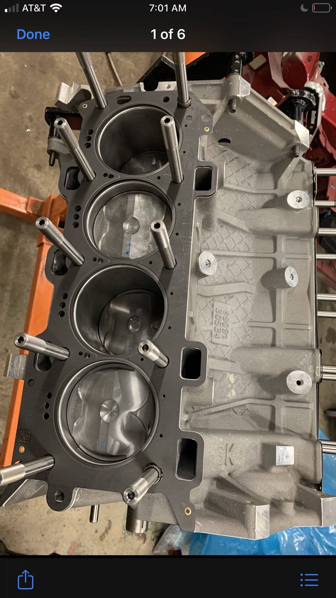

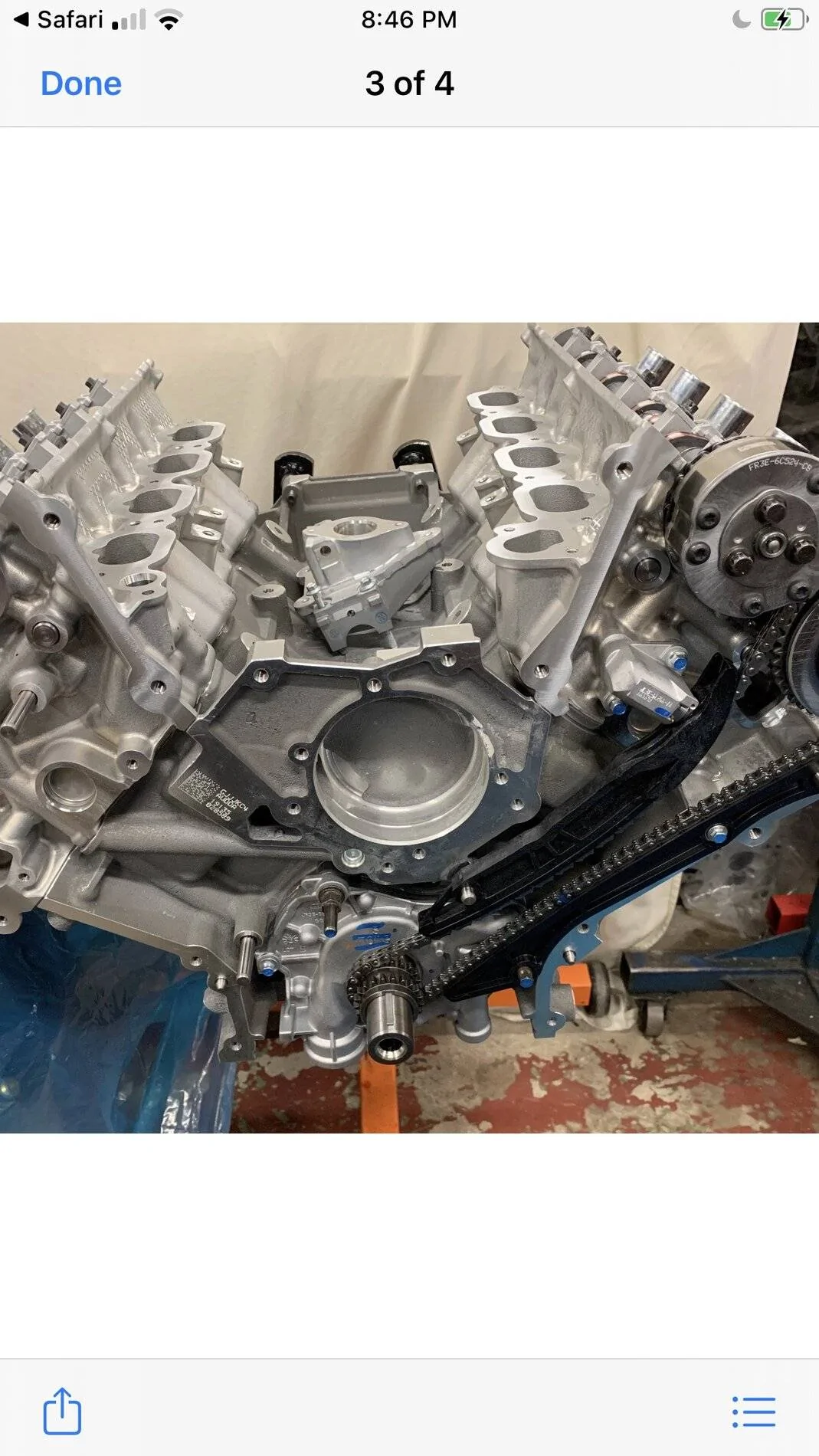

i also have another SB with the predator block (slightly different from the Gen 2 voodoo), Gen 2 voodoo pistons/Mahle drop ins, and the predator/5.2 crank so i get to keep the 12.1 CR and don’t lose any quench.
I am keeping it as a ”spare“ that I could use with Gen 3 heads (for my 18 ) or Gen 2 heads (for my 2 15’s) but I will most likely put a set of GT 350 heads on them./Ford racing /predator cams/GT 500 cam covers /oil pump /pan —- and voila - high compression predator motor .
