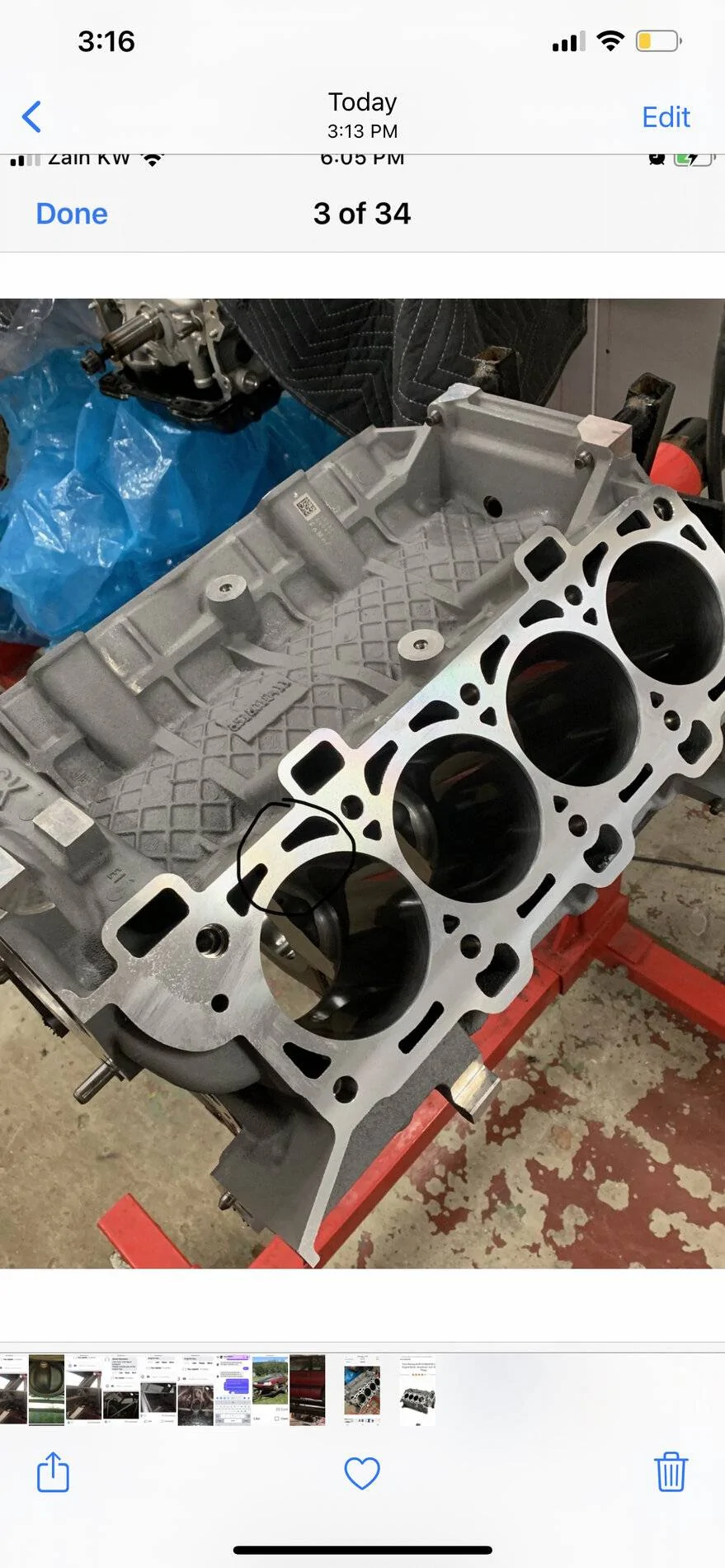

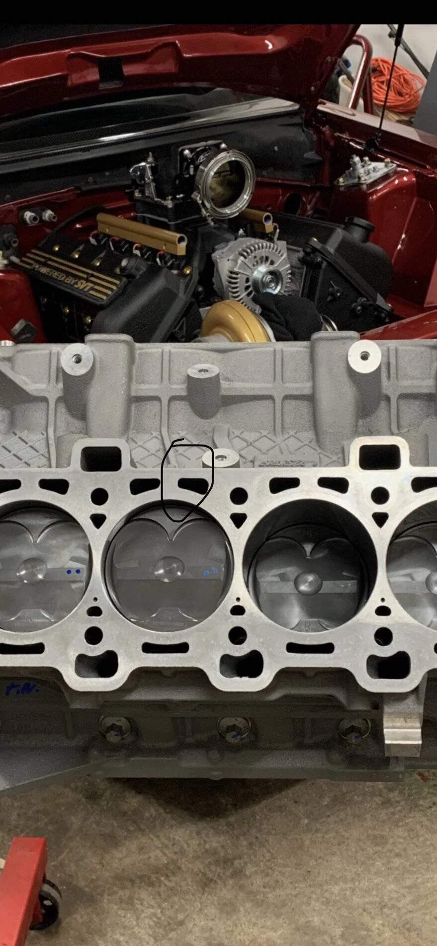

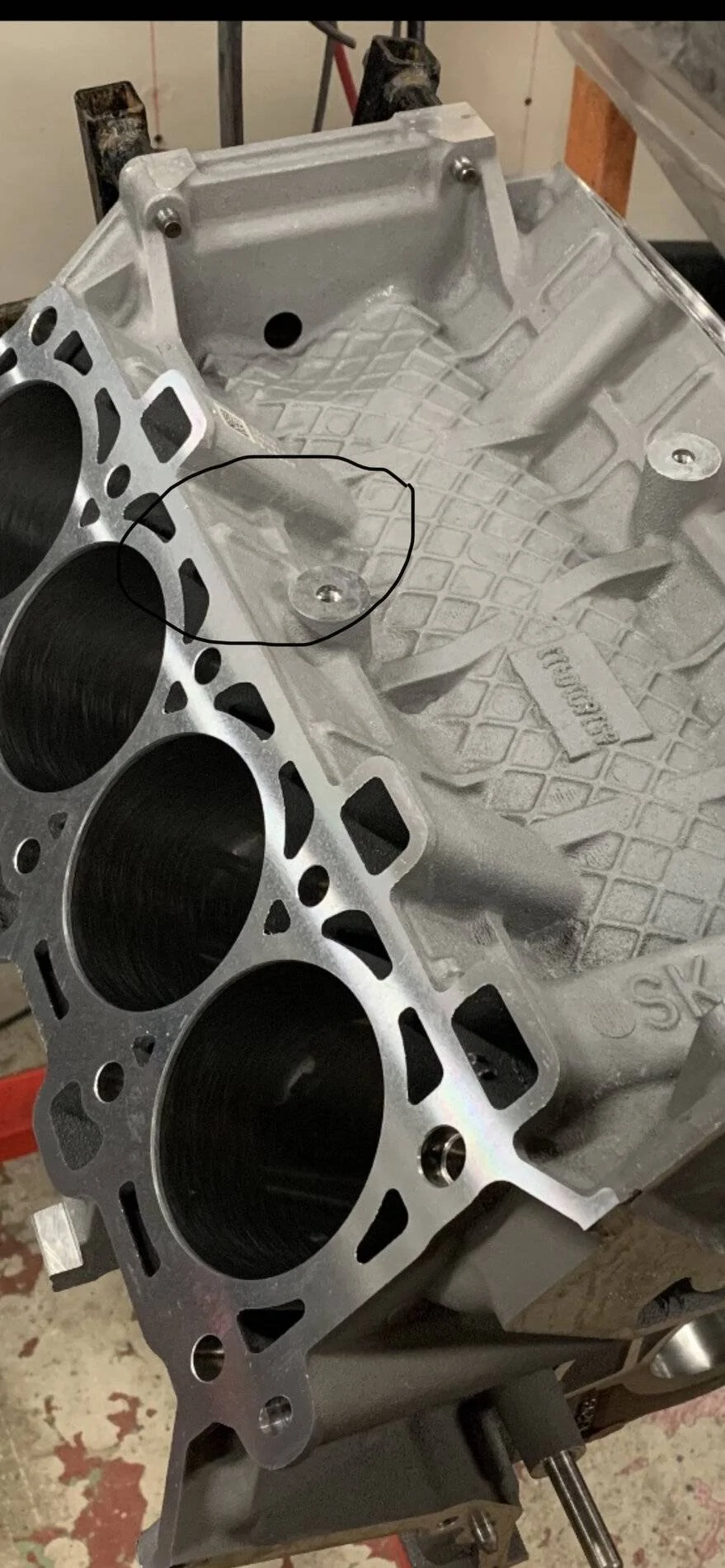

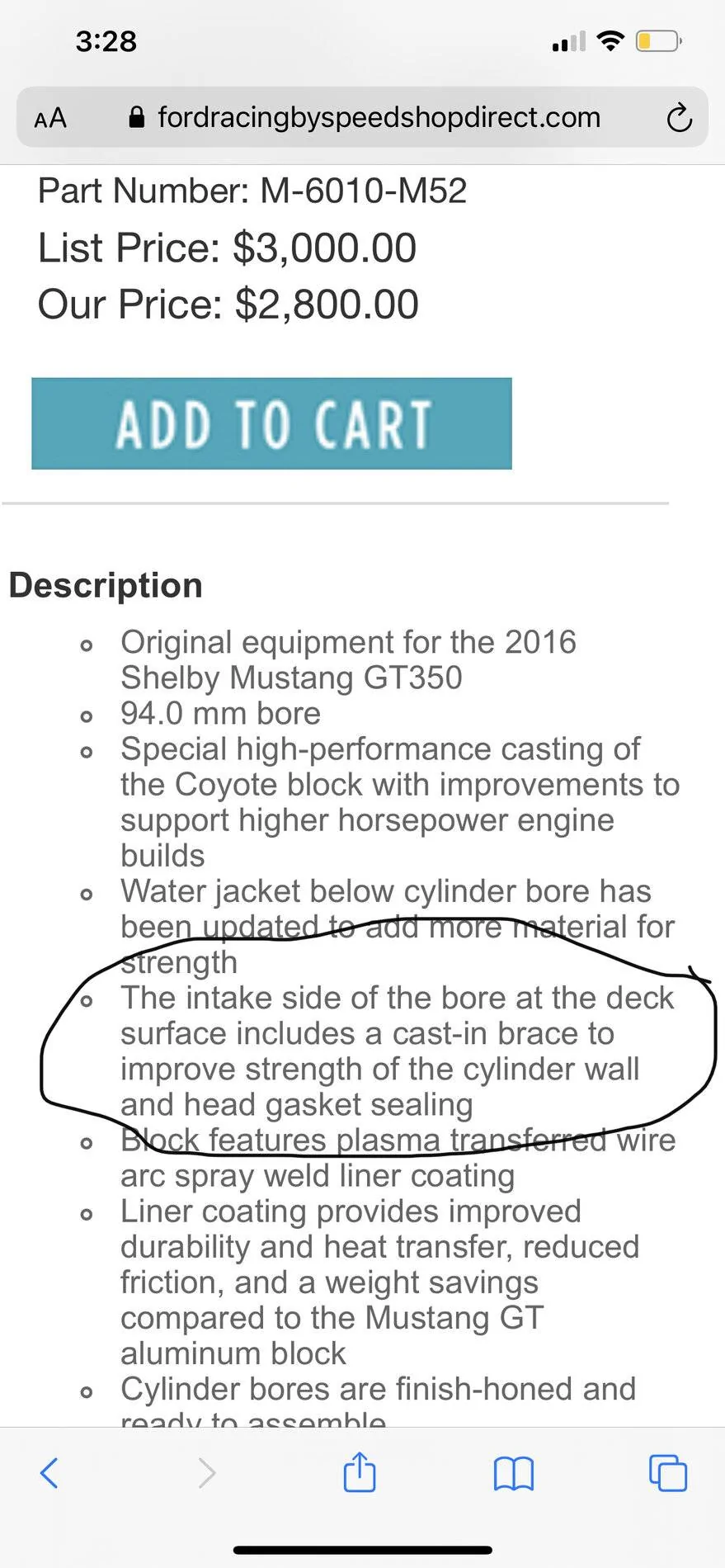

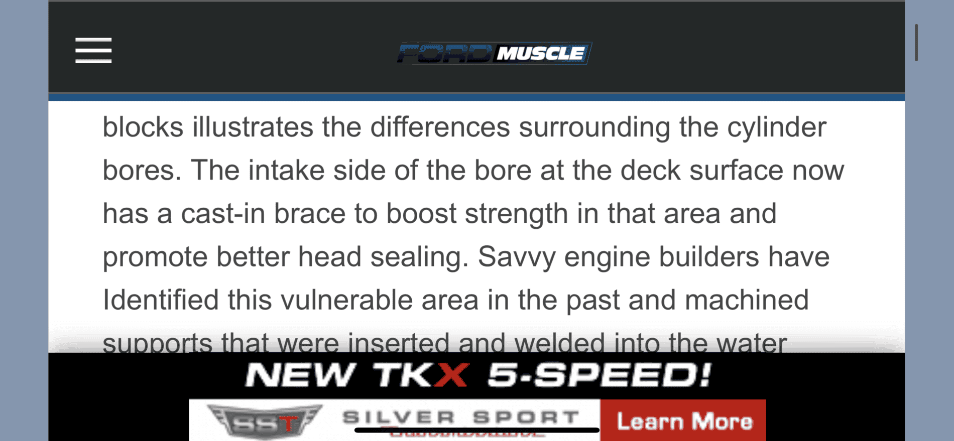

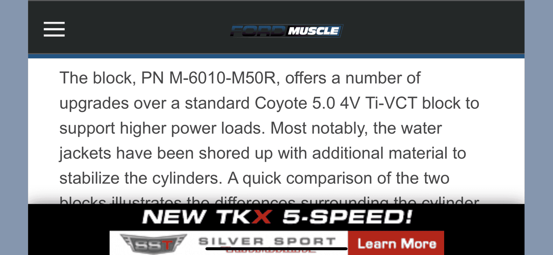

So it looks like Ford first added the supports in the sportmans block and then the Gen 1 voodoo
below is a picture comparing the Gen2 coyote - without it and a Gen 1 voodoo block and “Gen 3 voodoo”

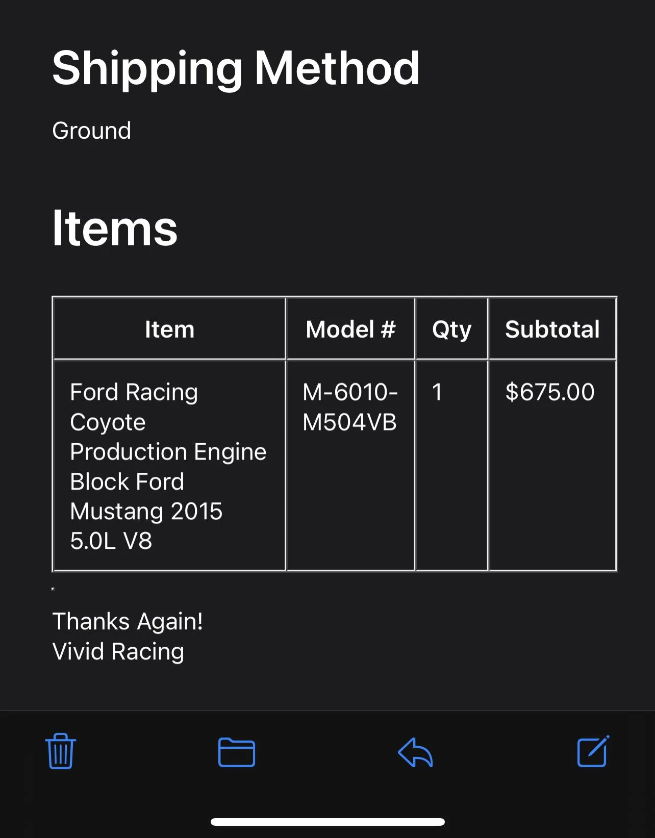

The Gen 2 coyote ?
i Picked one up for $750 at Vivid Racing
