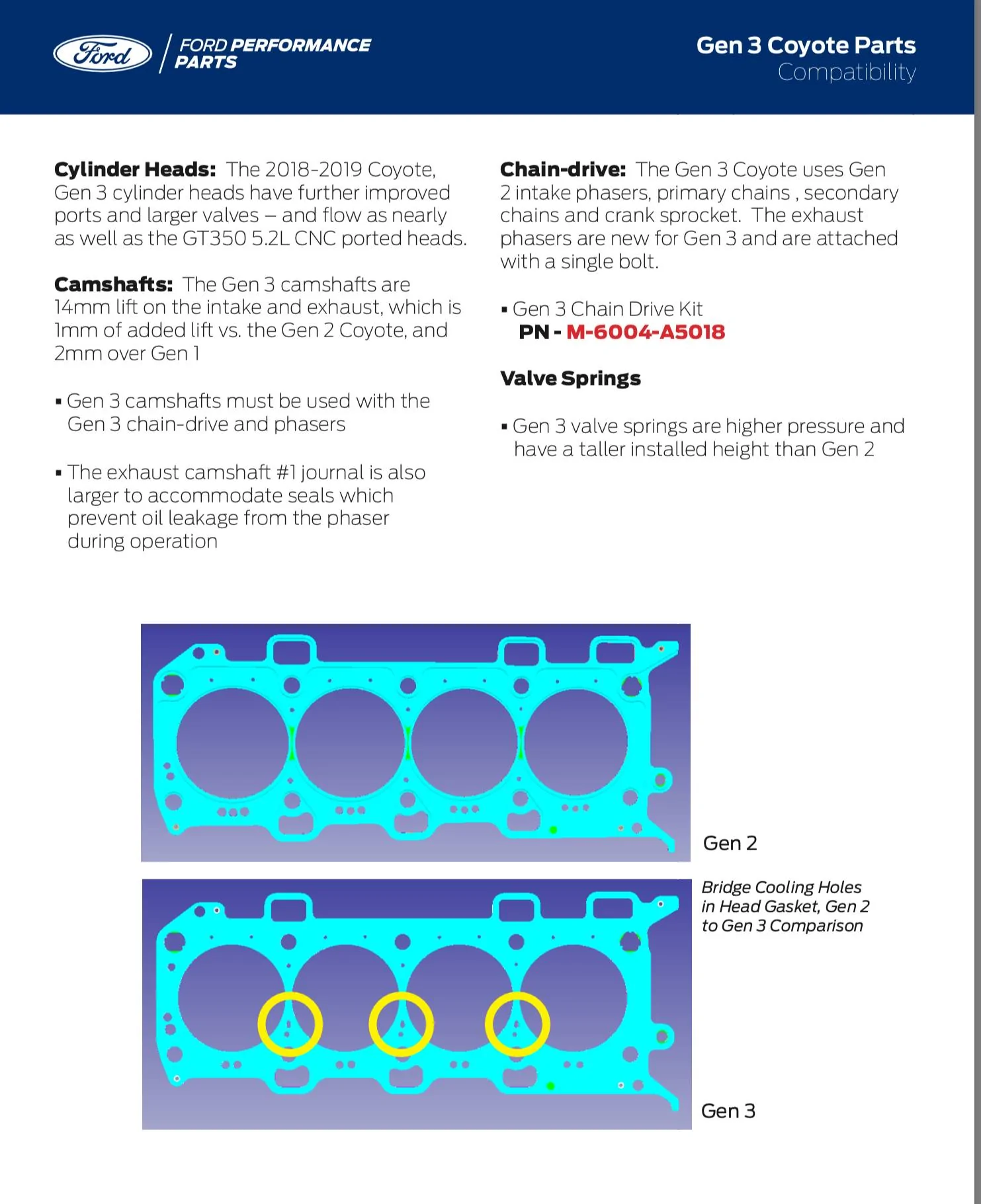

I’m positive the correct head gasket will allow them to work.
the cam position sensors are relocated also.
Base circle is changed with the 2018 also. And as you have stated the knock sensors are in a different spot with the direct injection.

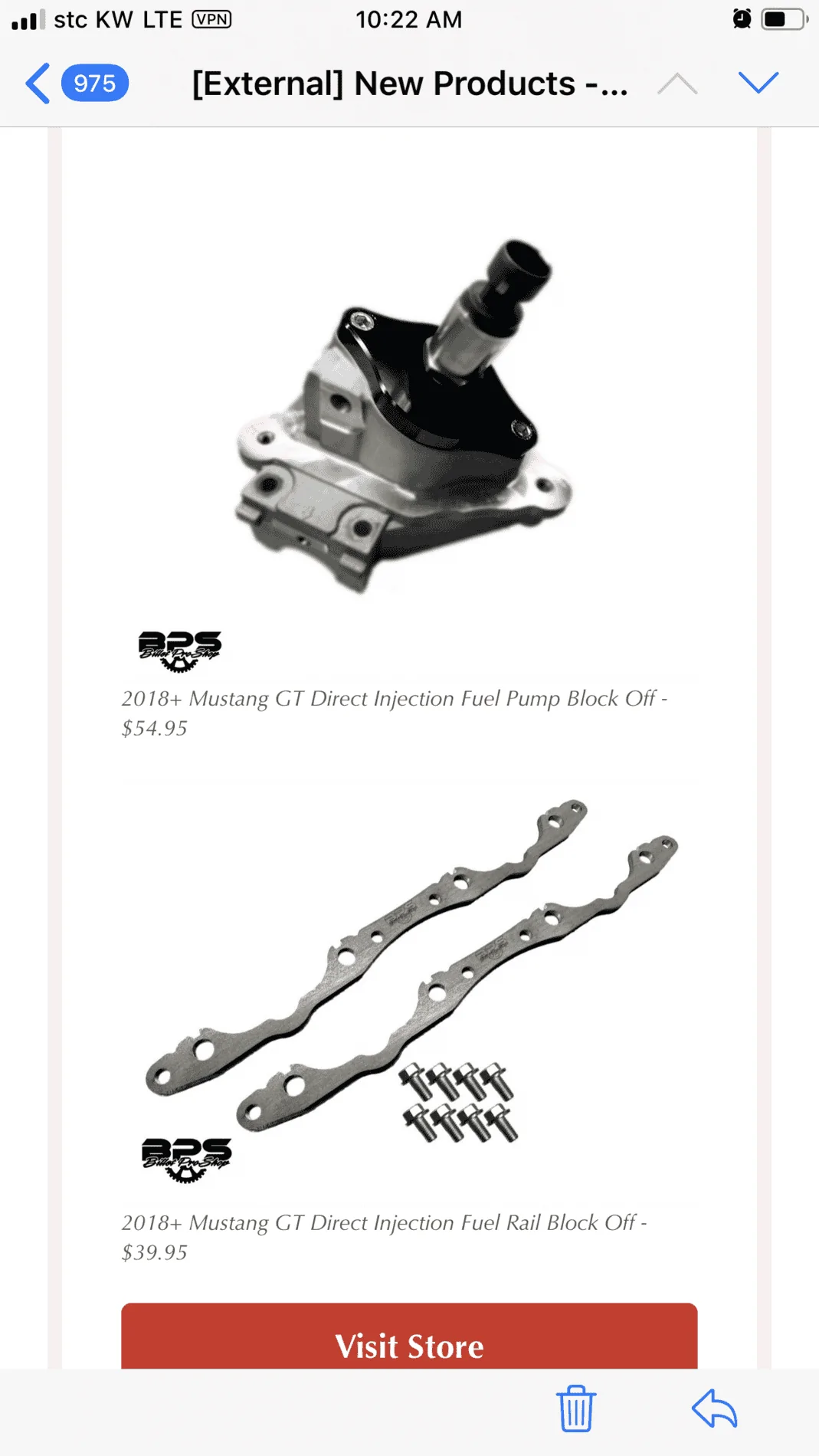

also you would have to have a block off place made for the direct injection pump. As well as plugs made for the injectors. They could be welded in or just keep the stock injectors in held in place.
they would flow better than the gen 2 but it ended up not being worth the hassle for me.

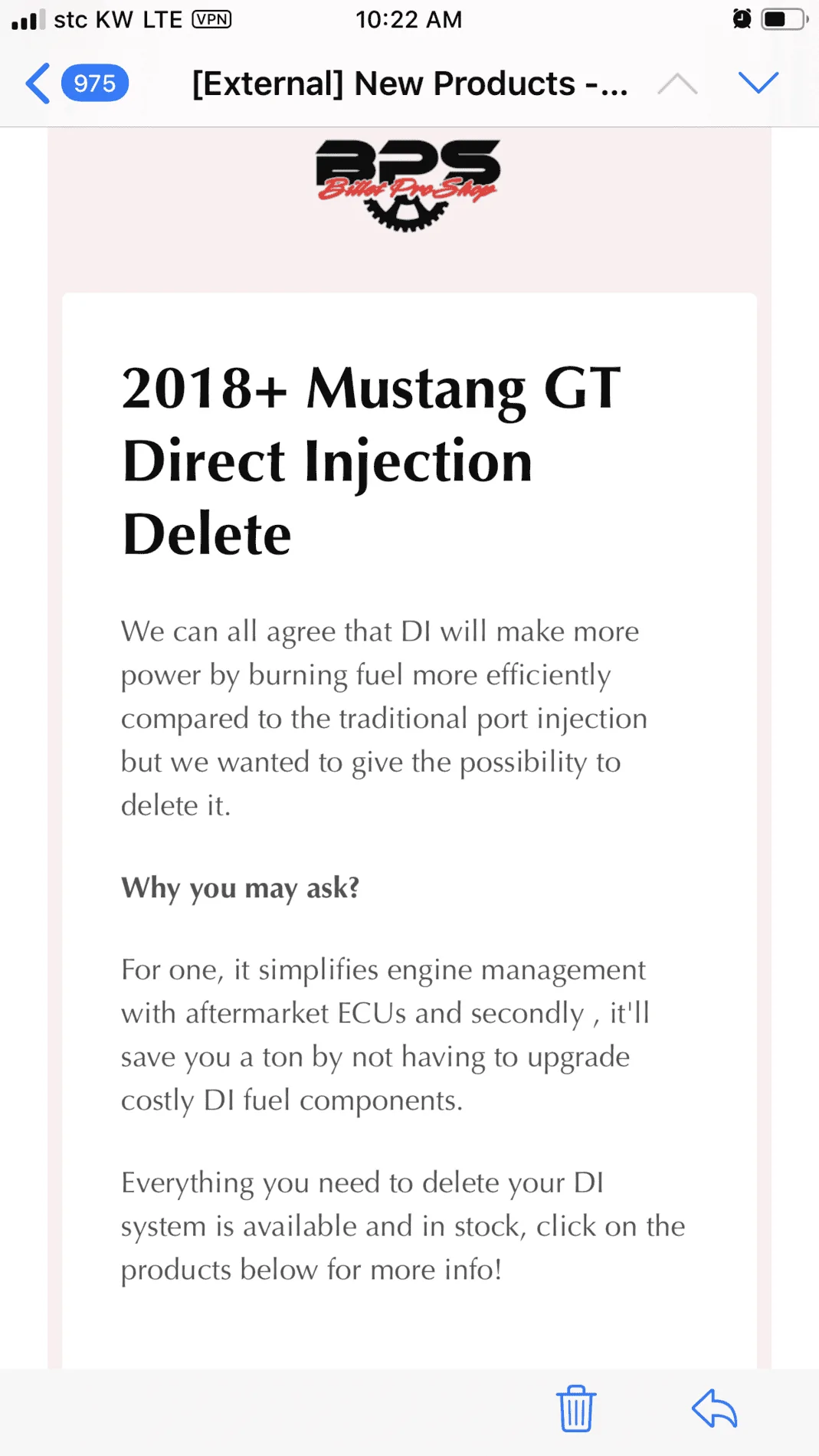

Billet pro shop now sells a kit to delete DI on the Gen 3 heads .

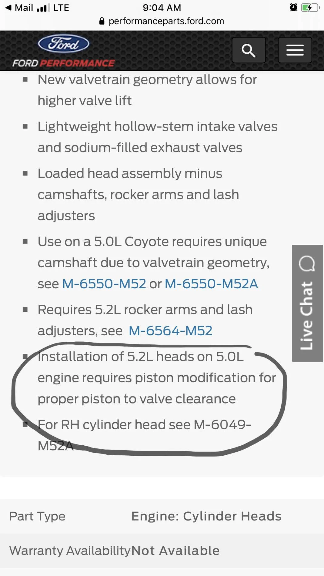

GT 350 heads have even bigger valves and they will work on the Gen 2 block .The valves will be shrouded and Ford racing says PTV clearance could be an issue.
The valve shrouding would not be an issue for me since the Gen 2 short blocks I have in mind are 5.2’s anyway.
Gen 1 voodoo block and sleeved Gen 2 (coyote) 5.2 .
I don’t want to be the guinea pig and I don’t have to build ANOTHER long block but with the scarcity of Gen 2 heads I was just wondering if it was an option if I did .

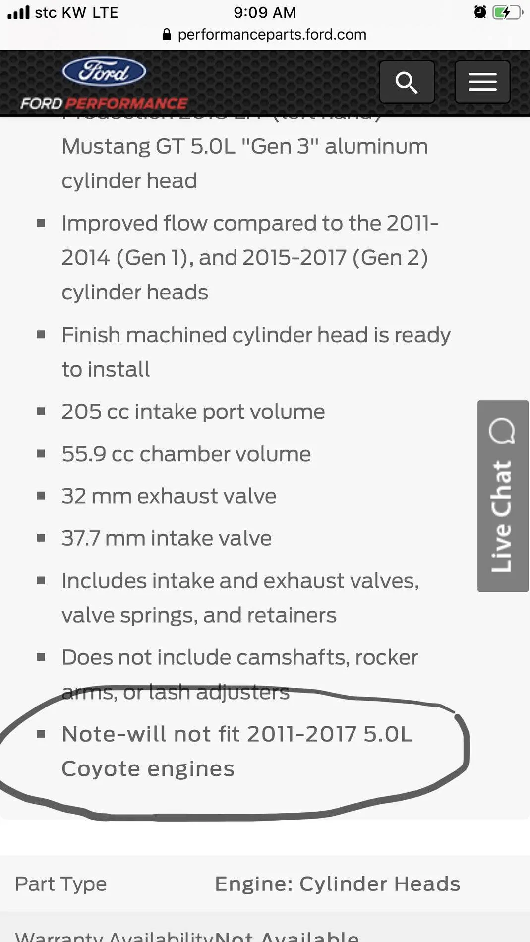

I am assuming that the Gen 3 heads would have the same PTV issues Ford racing talks about with GT 350 heads .
Of course they also say they will NOT work 15-17 blocks . I was just wondering if the experts can school me why , if the DI is no longer an issue.

If you could get gen 2 cam profiles it might work without new pistons.
And if you used Gen 3 cams you would have to use the Gen 3 chain drive and phasers (only the exhaust is different )

Is that because the exhaust cam ?
Yes and the reluctor wheel at the back of both I & E cams is different from Gen2 so I imagine that the signal is different as well.

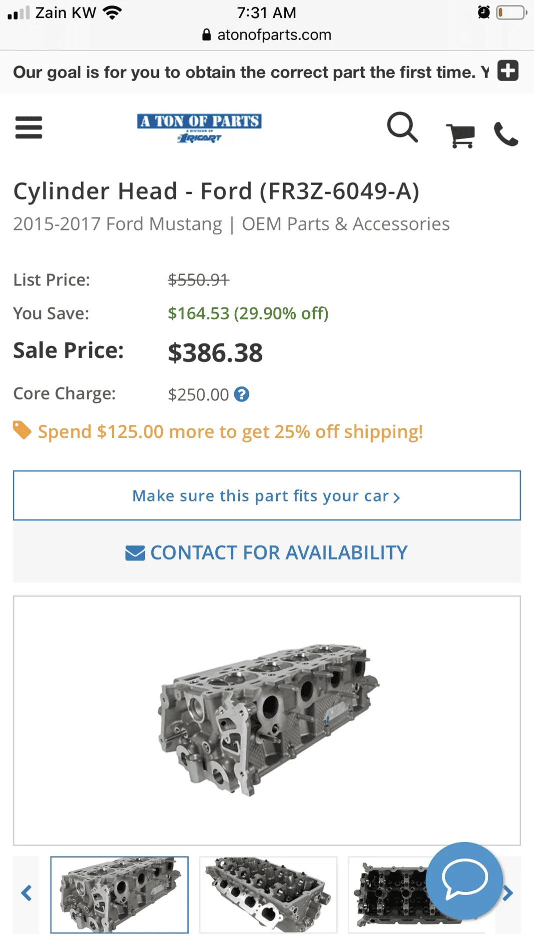

Well , my local dealer just got in the Gen 2 heads I asked them to order so looks like they are iff back order .
I just need to get them now to match on line prices which is as low as $386 and I am golden . Lol
