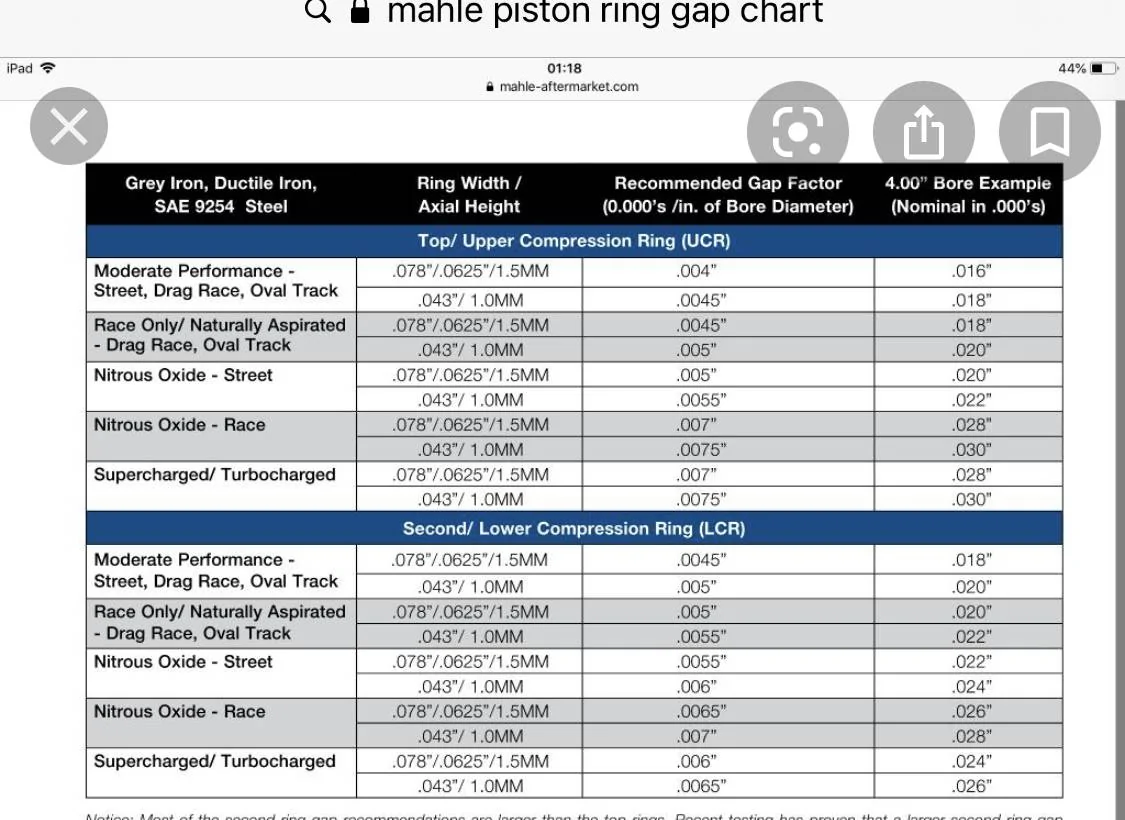

That's a really wide ring end gap, but depends on the amount of boost. Mahle says .005" x bore size = .018".
That's what I'm setting my gen3 engine build at.

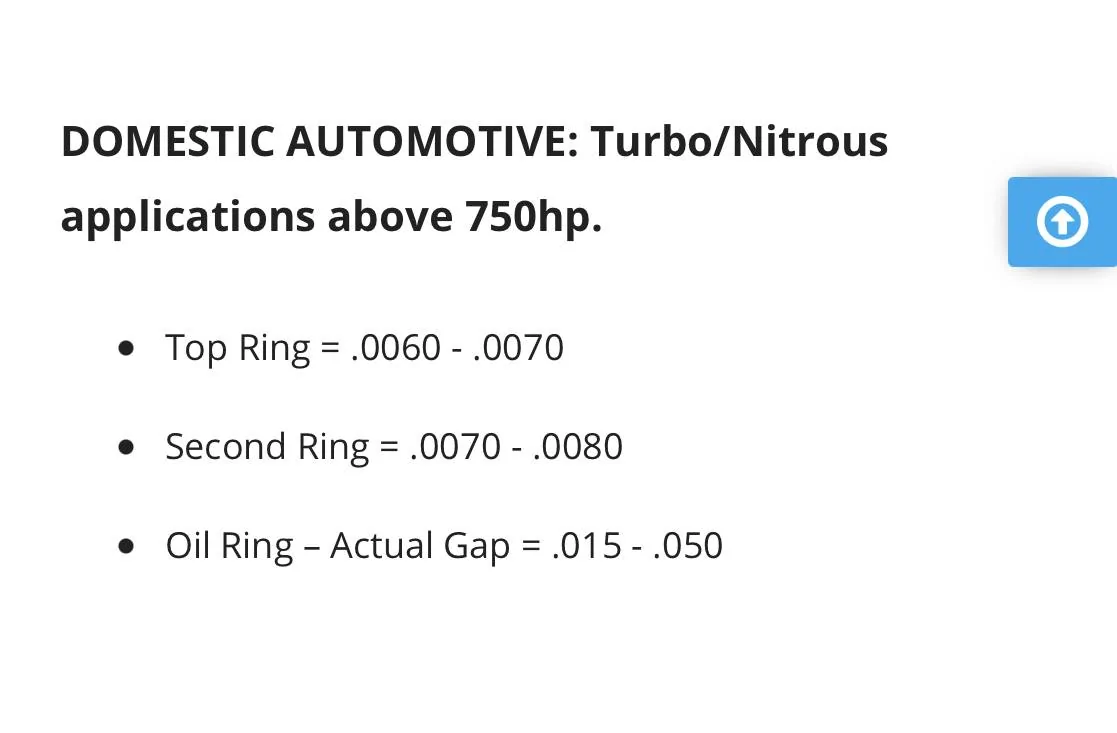

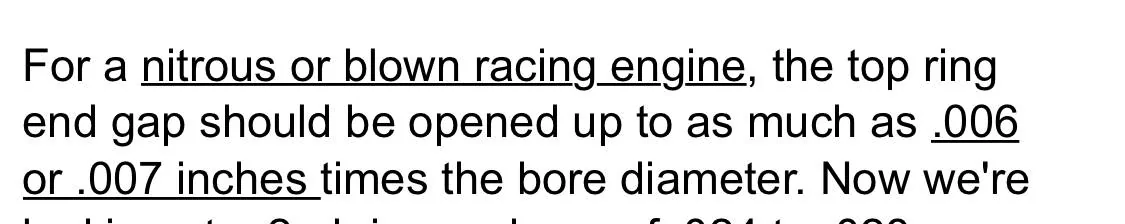

No Mahle says.007 for boost.005 for N/A high performance

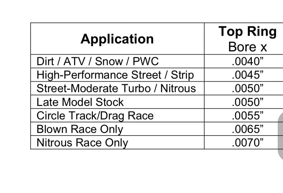

This is Mahle Aries and cp pistons recommendations

Street/moderate turbo = .005"
