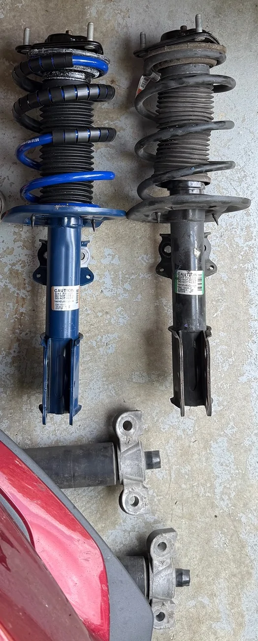

FYI, make sure your springs come with the rubber sleeves (noise isolators) on the spring, and you push them all the way up the spring so they get squeezed by the top hat and don’t slide down or else your front suspension is going to clank and make a ton of noise.
You can see what I mean on my photo. I didn’t do it correctly so I had to remove and redo it. They aren’t up high enough. If it’s listed in the documentation Steeda provides I didn’t see it at the time.
Interesting, these didn't come on the eibach springs in my B12 kit and i haven't had issues. Is this a steeda only thing?
I’m pretty sure it’s a Steeda thing. Going back in the forums there were a ton of complaints on noise and the minimum drop springs got these isolators sometime in 2024. They aren’t compressed in the picture, but with the car weight on the springs the top two coils touch, and then clang when you hit a bump in the road.
For what it’s worth, I’d never pair Steeda min drop springs again with these shocks. Maybe it’s different on the stock shocks. I’ll probably bag the car next time.

It's not specific to Steeda; other springs include them, but we do provide it to eliminate the chatter that the springs touching can cause.
Let me know if I can assist further!
Didn't come with my BMR springs either, no issues with noise.

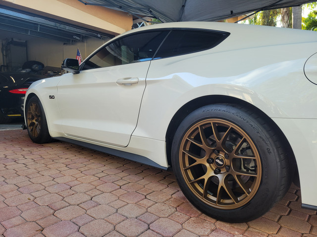

I am not experiencing any harsh sounds when going over bumps but the ride is definitely stiffer than the base GT suspension. It is NOT harsh at all considering I am running 18x10 with 275/40 all around and the roads here in south Florida are generally pretty smooth. I am extremely happy with how it turned out considering this is literally the first time I have altered my suspension on any of my previous cars.
