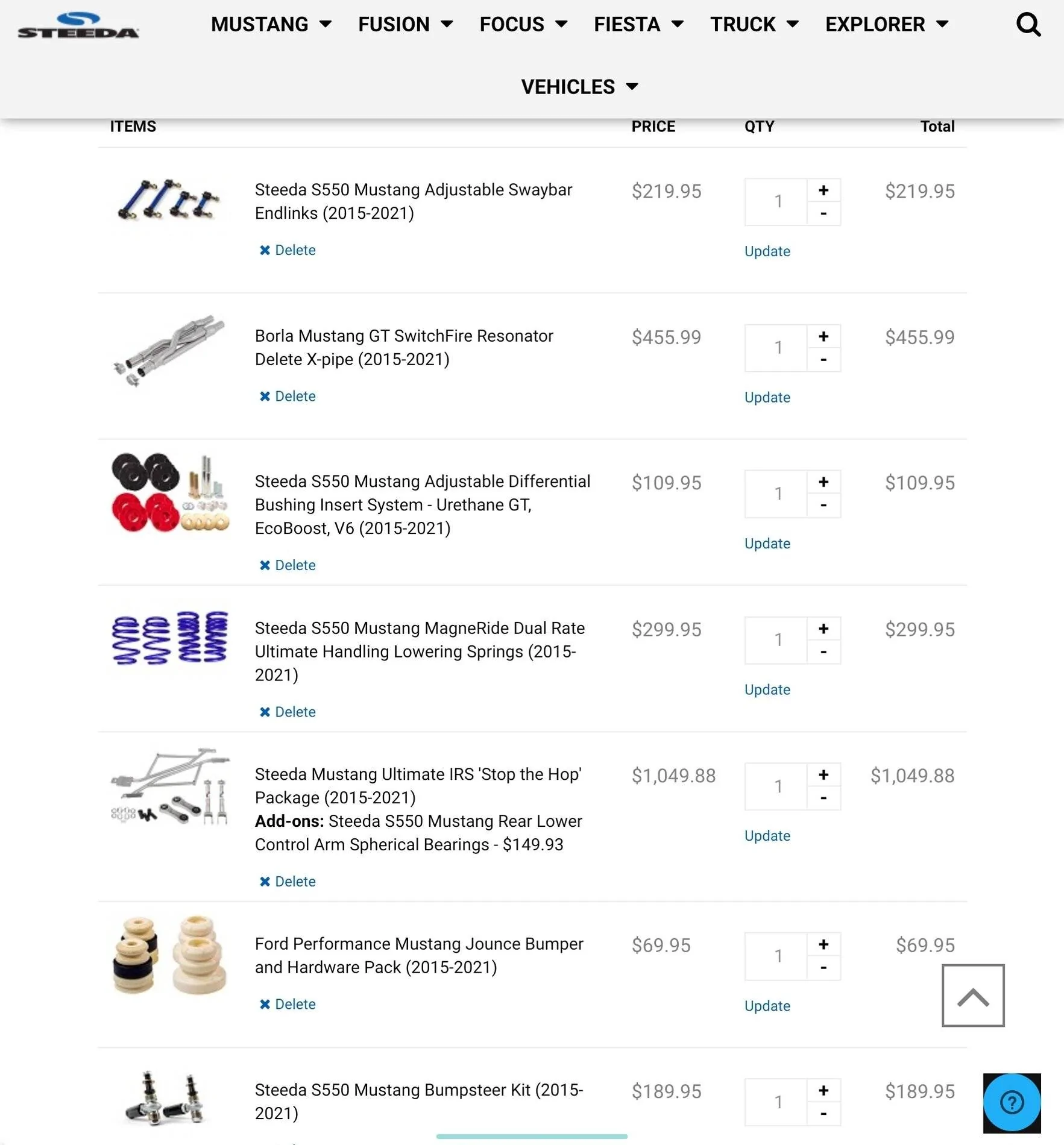

My plan is to make my car stay on the ground when I gun it. I plan on Tracking it at VIR and I go to back country deserted roads and stomp it.
This is what I'm looking at.

do NOT!! get the dual-rate springs unless you want a 'race car' experience. And anyway you need adjustable dampers to handle those spring rates. (edit: overlooked you had MR)
The bar end-links are gratuitous without actual bars. I would source a GT350 set or a front from BMR and leave the rear alone.
Use eibach bump stops instead of Ford.
the 'basic' stop-the-hop kit is sufficient you can always add more parts later if you really, really need to. Get the camber plates though.
since you don't have a PP1/2 car get the PP1 toe links or press out the bushings and replace with the FP/PP1 bearing.
Those diff bushings are gonna make things loud and 'grindy'. Otherwise for 'stomp the gas' safety you want to minimally get the $40 replacement bolt kit for the shims if nothing else. Beyond that I recommend the WhiteLine bushings instead.
bump steer kit without roll-correcting arms is kinda silly. Steeda has front arms that come with bearings which you might like over the bushing-equipped ones.
The bar end-links are gratuitous without actual bars. I would source a GT350 set or the front from BMR and leave the rear alone.

I have the Magneride so I think I need those dual rate springs?
unless it's a 80/20 track vs street car I would not. I updated my post with links to the products. You can not use non-MR springs on a MR setup. If you're not quite so serious about track time but want to improve matters I would buy the FP MR package. What you're really after is the VDM software maps but the hardware is still useful.

Ok, now, I looked at this. But I dismissed it as I have aarger sway bar already. Am I wrong?
Doesn't having non MR springs defeat the entire purpose of having MR?
If the kit's bars are applicable to the PP2 trim, then I think it's safe to say your PP1 bars are softer and thus the upgrade applies. If you can figure out how to buy just the updated VDM software, be my guest.

no. Differential != IRS
The Steeda and BMR differential bushing 'insert' kits use a high durometer material to 'sandwich' the Ford soft/flexi-rubber. The Whiteline uses a softer material and thus less vibration pass-thru. Unfortunately Whiteline appears to have discontinued their kit that totally replaces the Ford bushings. That's the one I put on 2 cars and it's lovely. The next closest thing is one from Energy Solutions but I can't speak to durometer of the materials.
The Steeda IRS support/lockout you referenced is akin to this Whiteline kit.
