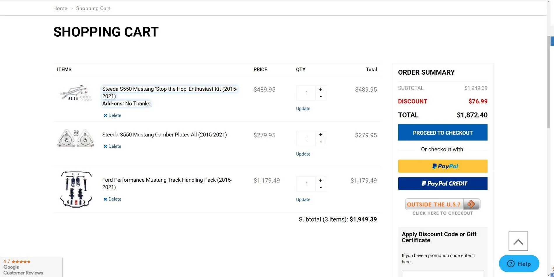

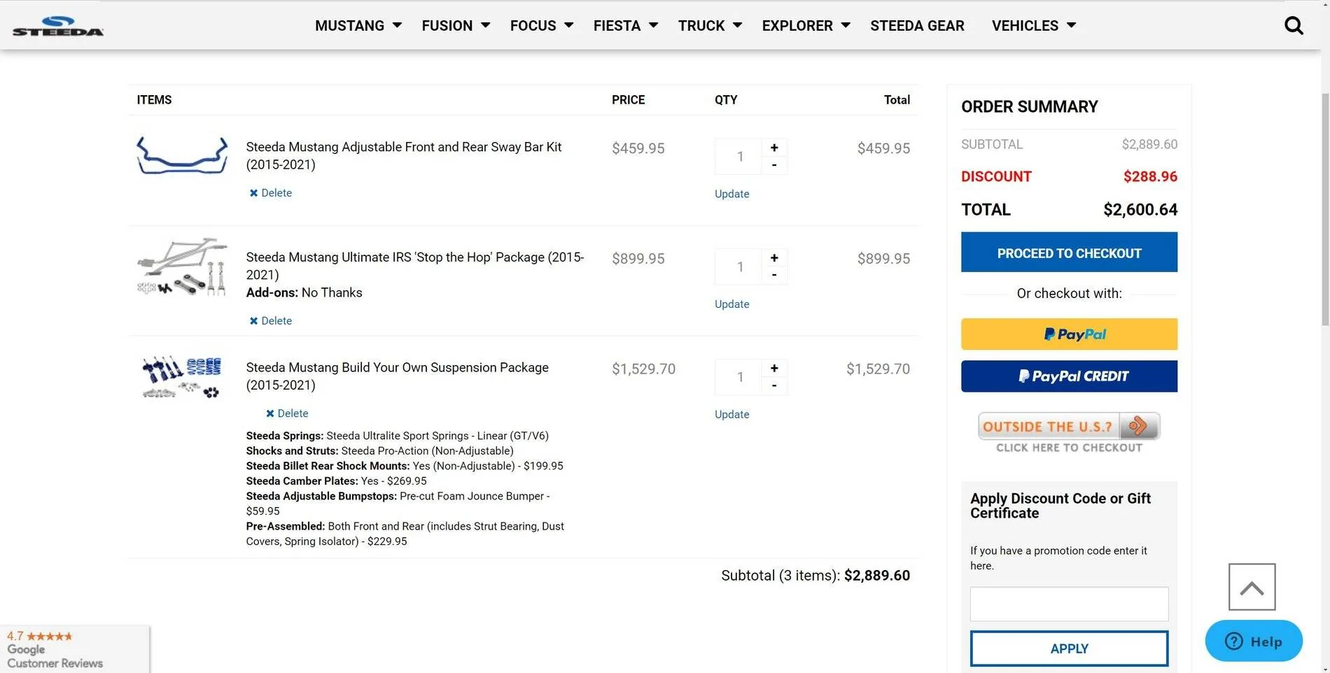

Hi everyone! I'm looking to upgrade my suspension on my 20 mustang gt non-pp. It's pretty stock now but I do plan on doing a supercharger build in the future. This is mainly a dd with a lot of spirited back road driving and the car will see a few trips a year to the track/strip. In my research so far it seems like I'm better off doing a solid set of shocks and struts than a cheaper set of coil-overs.
I have narrowed it down to two separate builds to start but I can not decide between them. From my research steeda would be the first option but the value out of the ford performance track pack seems too good to pass up. The FP kit includes the sway bars and toe links while I would have to purchase those separately going with the steeda build. Either way, I want to include the "stop the hop kit".
It's a $700 difference between the two builds, I don't mind spending the money if it's going to perform better. But I don't want to spend the extra money on a very similar performance.
Does anyone have similar builds that can share some insight?
Any help or feedback is greatly appreciated.
Thank You

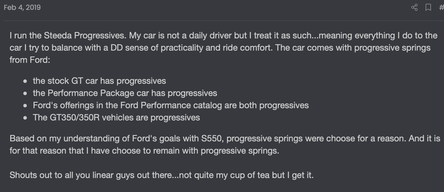

why aren't you considering progressive springs and going linear they are great for DD with occasional track stuff. I personally love them, but thats what they are sold as, DD with sport stuff. linear is more track oriented. atleast thats what ive gathered.
all id change out if its truly a DD with track stuff, is springs to progressive.
but imo steeda>ford in this question, if car came with PP stuff I wouldn't of upgraded, but if I was upgrading from a base, id go Steeda.
found a post that shows that the following cars run progressives.
here's a thread on difference between linear/progressive
https://www.mustang6g.com/forums/threads/mustang-progressive-vs-linear-springs.138095/
they also offer military discount I believe, mention mustang6g if not, see if they can work a little better deal to get within your budget. for DD id gt progressive everyday.

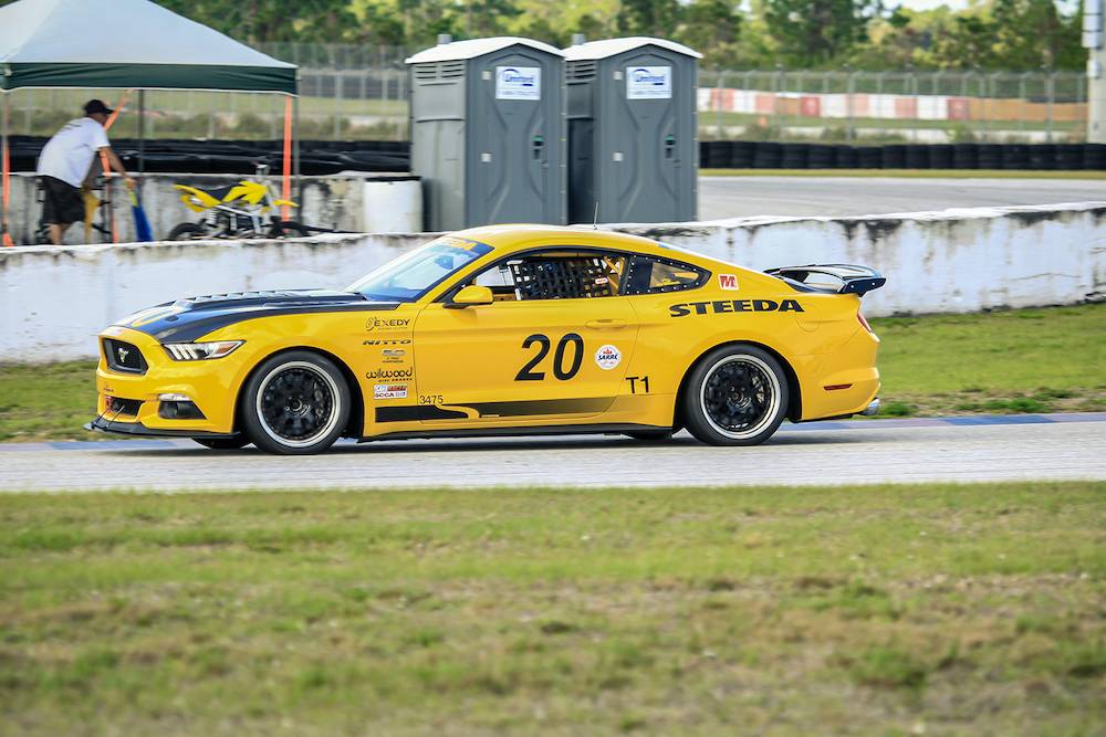

I can't speak for the Ford Team but I can tell you we are at the race track almost every weekend - adjusting, changing, tweaking to continue to refine our set-ups & design. We have several cars we push to the limits :)
Here is our track car -we throw everything at this car.
