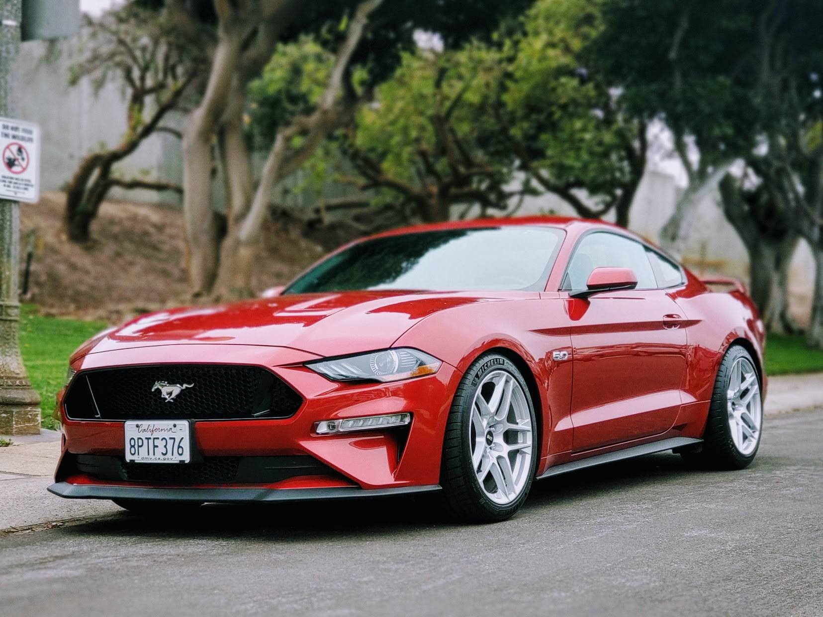

The Ford Performance Track Kit should be the OEM suspension from Ford to begin with. What's nice is it doesn't lower it excessively. Ford advertises a 1" drop, for me it was .875" front and .75" rear. Giving the car a little rake which I love. Keep in mind the Street kit is basically the Performance Package with lowering springs. Go for the Track Kit, even with the PP, the PP dampers are way to soft even for the street. The Track Kit is a different animal. My car
Very clean looking car, love the red with silver wheels!
