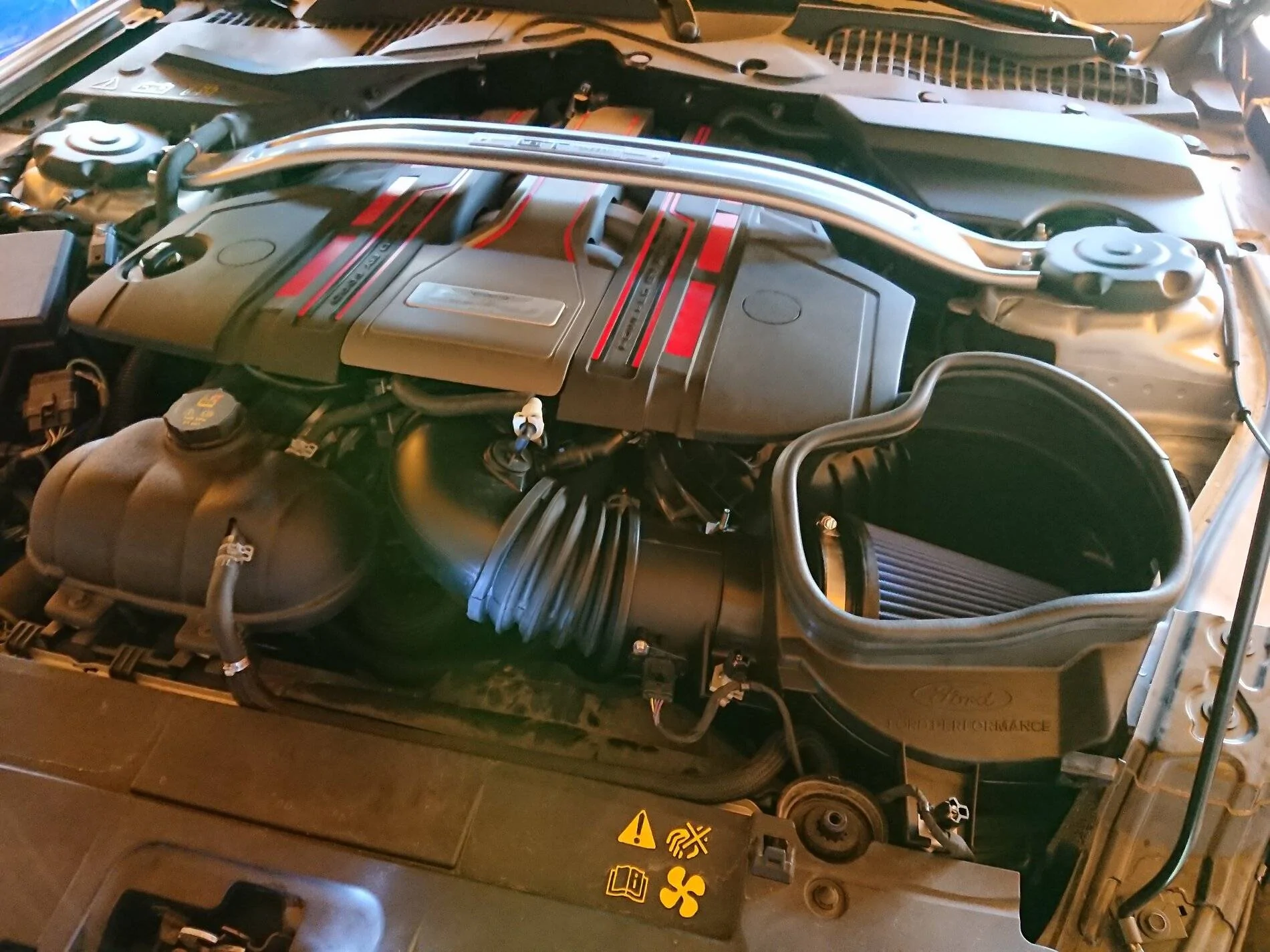

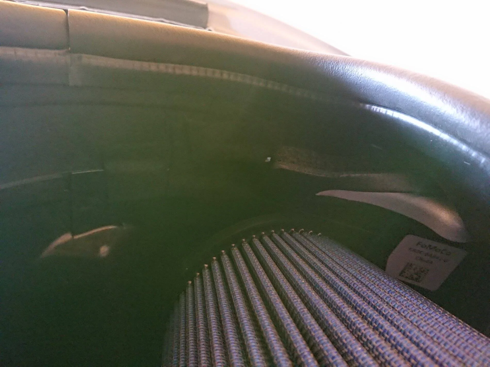

All set and installed, they did a nice clean cut on my cover and also I removed the plastic screws on the wire retainers so they could properly lock on the CAI screws.
I also had some sheets of adhesive black felt laying around so I just cut a few pieces to cover up the slightly open areas where the CAI housing faces the fender.

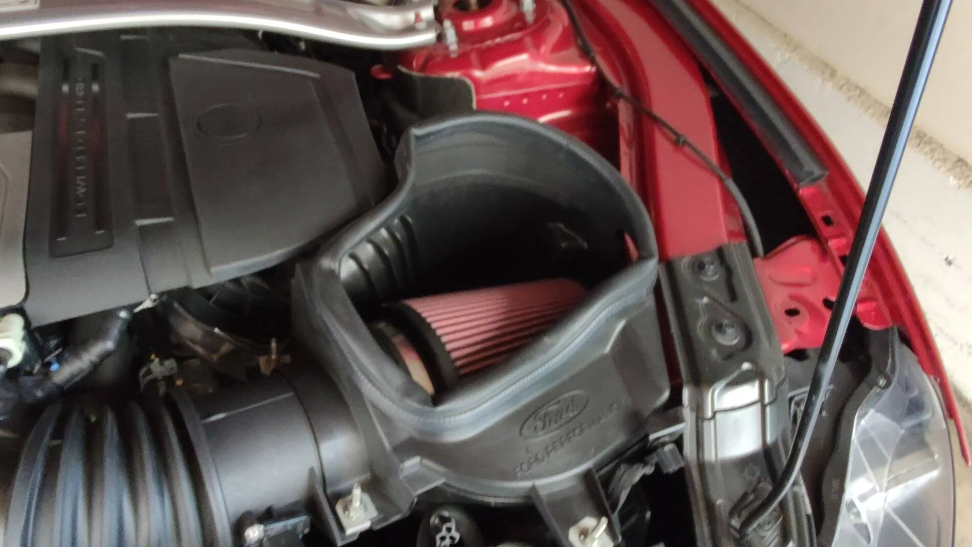

So what is the trick to lower intake temps while stopped? Cruising temps are ok ~4F above ambient but man while stopped they shoot up to 40F or 50F above ambient. That has got to be causing some power loss at takeoff. Its not even summertime yet, I wanted to get this fixed before I start using the a/c and getting some real heat soak.
I have the side foam installed and took my time with the filter snorkel to make sure it was mated up with the grill snorkel.
I still have not drilled out the extra honeycomb holes does that make a big difference?

What were your intake temperatures sitting still when you were using the stock airbox? It doesn't sound terribly high to me. I know my stock air intake temps go up sitting still. It's simply thermal dynamics at work.
Looking at the drivers side hood vent, this now becomes a second air intake source when sitting still correct? I would think having a black car in the sun, with this vent now drawing hot air off the hood can add to the intake temperature. Another thing is how well does that weather stripping seal to the hood liner? Is it allowing hot air into the box from under the hood? Just some theories.

I mean the temps always went up when sitting still with stock intake but I don't remember them going up 50 degrees ever. On the way home yesterday it was 74 out and at the red light I hit 122. That was without a/c. I can't imagine when it starts to really warm up soon.
I'm not sure the hood vent lines up to act like an intake. I also don't think the filter box seals good against the hood liner. I'm going to play around with it over the weekend and see if I can improve some things.

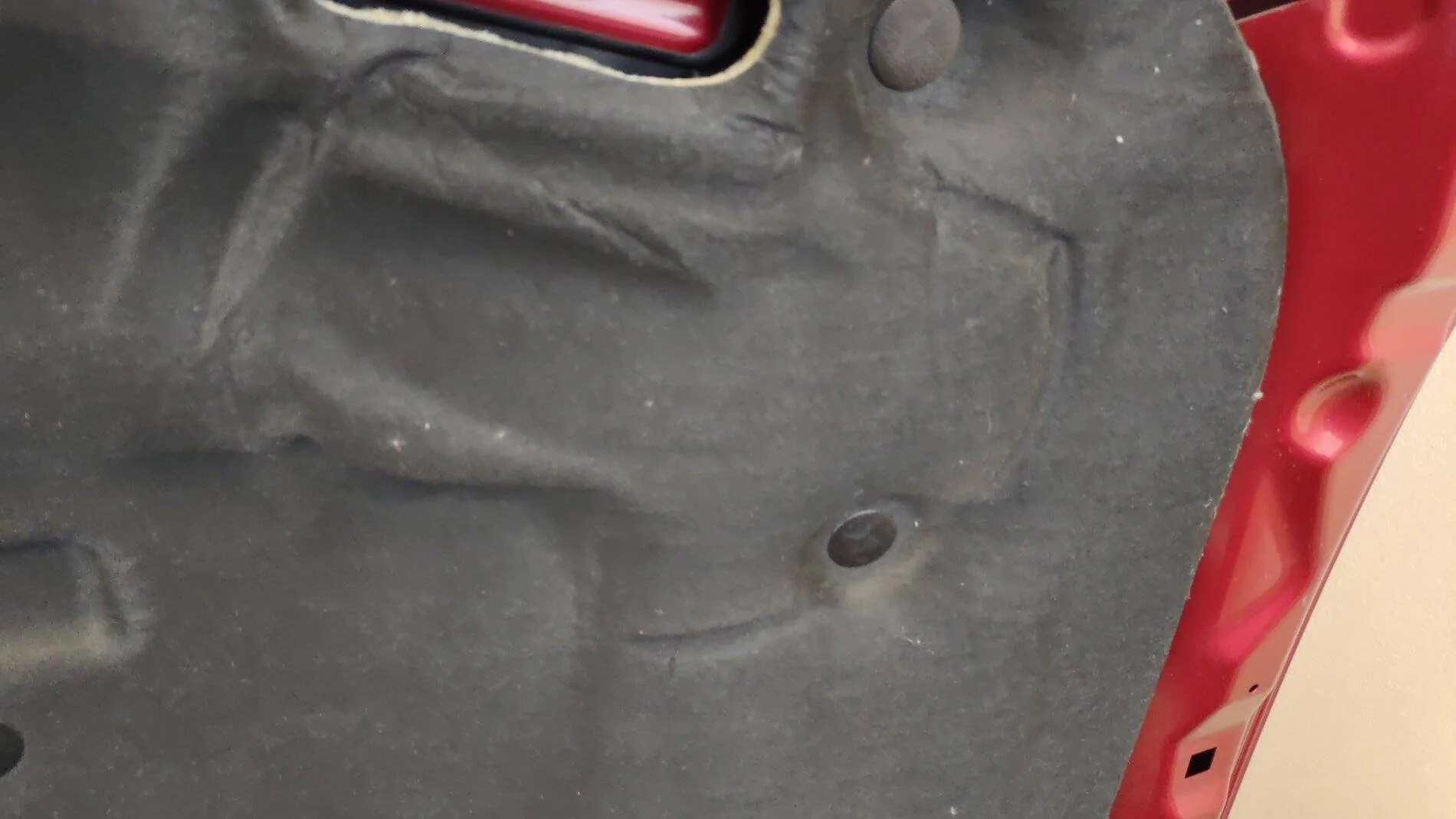

The OEM box heats up as well. When I got my car last summer IATs would hit 120+ when outside temps were in the low 80s as well with the stock airbox. Also my box seals real good against the hood liner. Look at the outline formed on the liner, seals real good.
