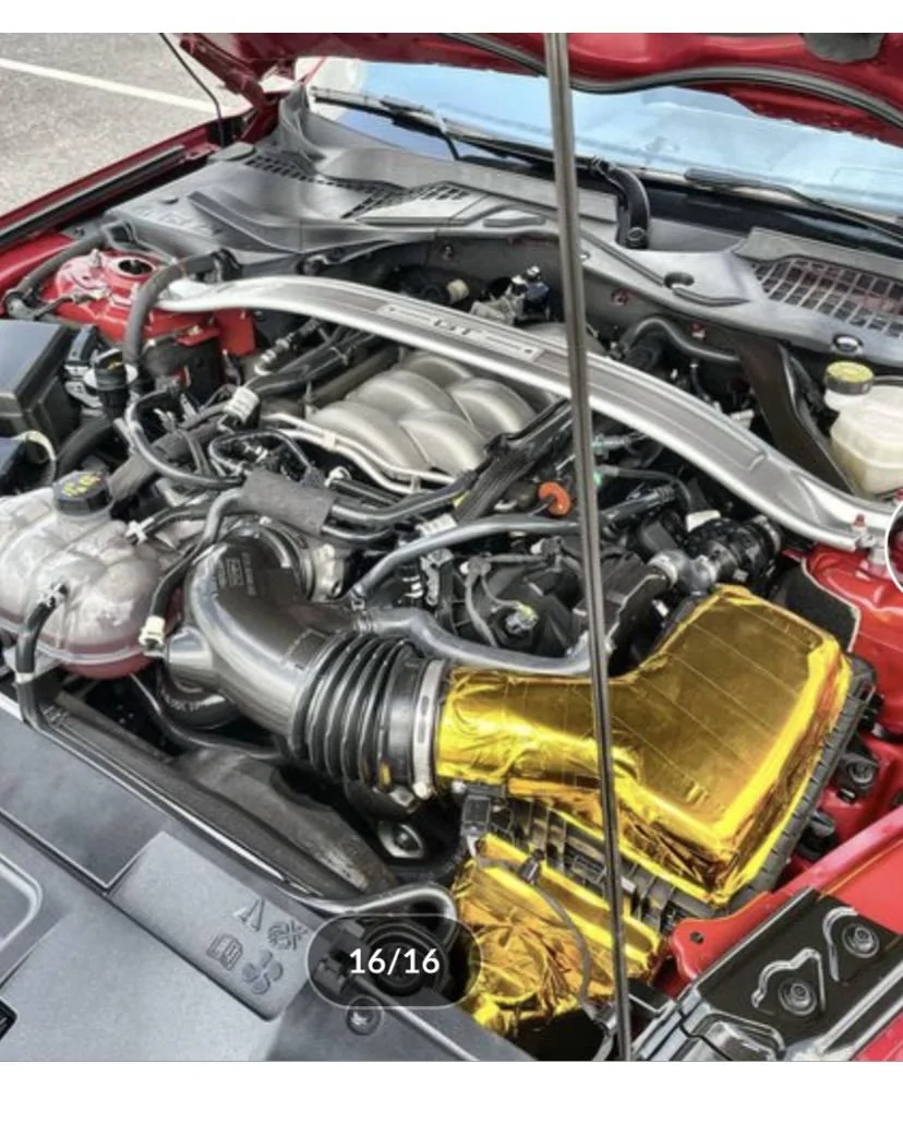

So looking to trade in my eco for a 2020 GT in Rapid Red. 8k miles but it has ford performance badges & exhaust ! Meaning it could possibly still have the tune ? Will ford be able to remove the tune or would I be stuck with it ? Wanting to possibly get Lund tune instead or can I just tune over existing one ? Thanks

What kind of air box does it have and what is the orientation of the throttle body?
This will determine whether or not it has the FP tune.
Maybe a pic of the engine bay?
Thoughts ?

Definitely not a Ford Performance tune.

Yes, stock, dressed up like Apollo 11.

I am not an expert, but I would bet money that these Ford Performance badges are added on by the previous owner, and that air box looks like my stock air box with some space foil added.

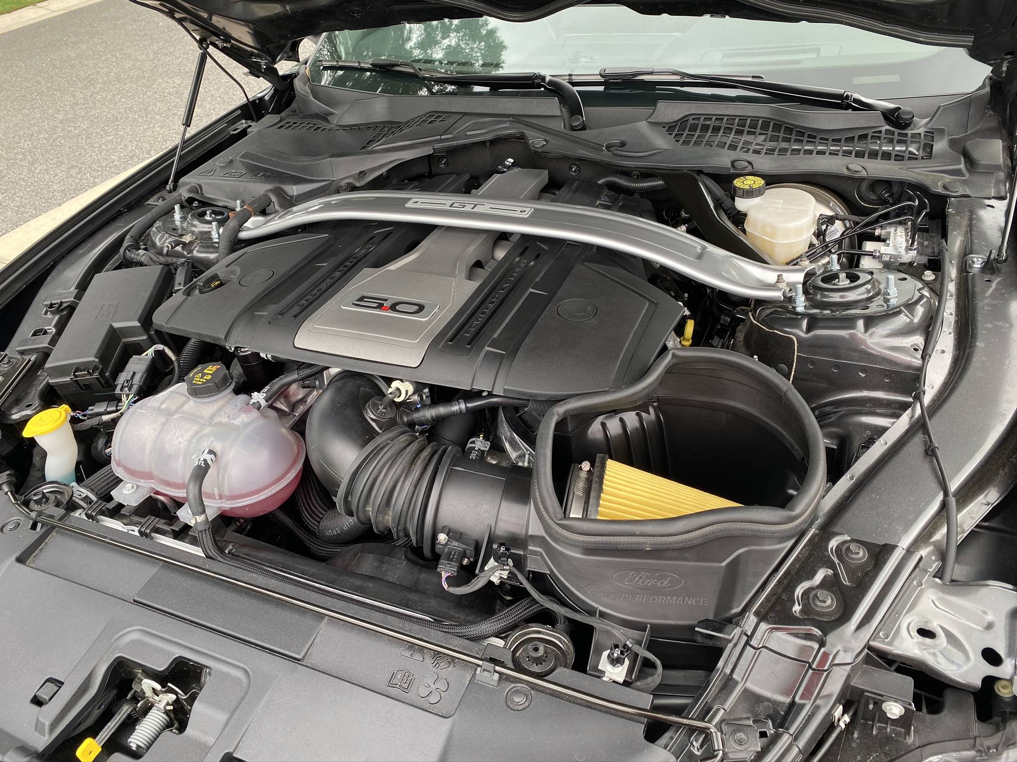

I have the Ford Performance tune kit, and the air box looks like a GT350's - open on the top and showing the filter.

If it had a Ford Performance tune, it would look like this…
