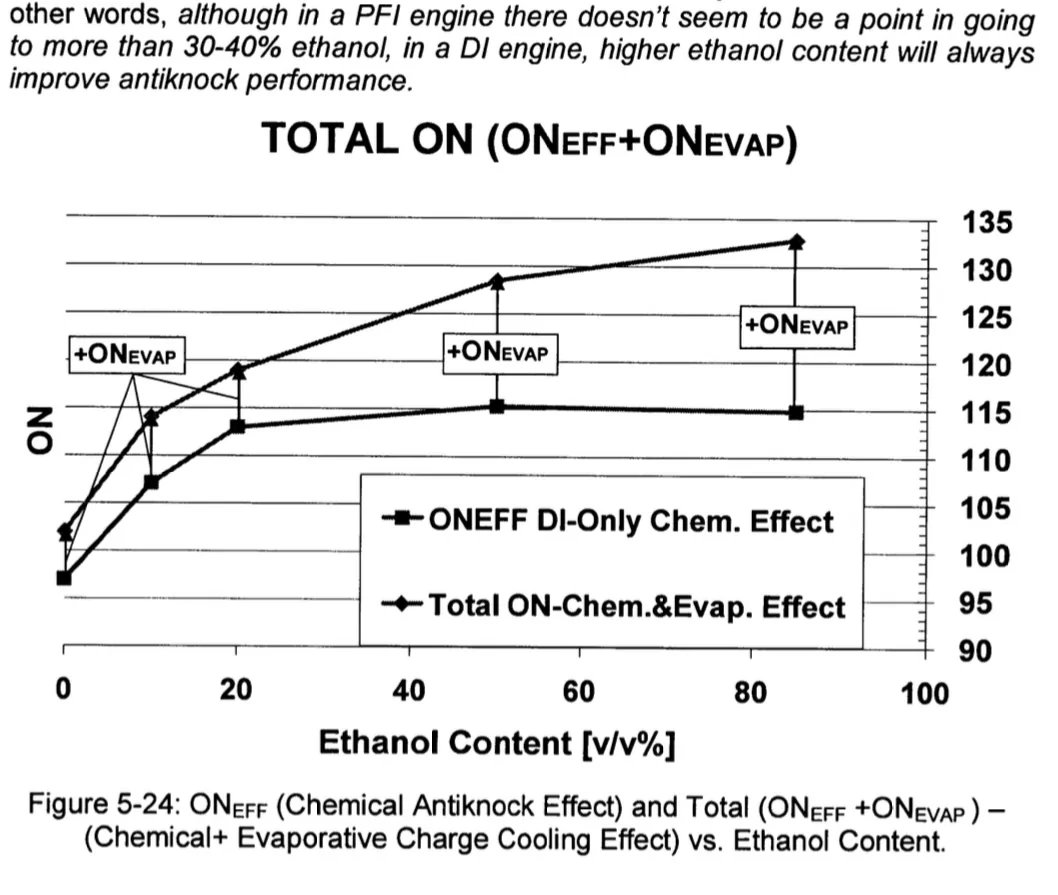

There’s a funny thing about ethanol and its effects on knock. Ethanol by itself doesn’t have a huge improvement in octane, at least how we measure it. The issue is that at least one, maybe both RON and MON, atomize the fuel and then reheat the mixture to a standard, controlled temperature before it enters the knock test engine. This made a lot of sense back when the mixing happened in the carburetor and it heated in the manifold before reaching the cylinder. Well, this offsets the vast majority of the ethanol magic, which is knock resistance due to temperature drop. So, most of what you see regarding ethanol and octane number understates the benefit. The attached graph shows the real use case effects, which are drastic. It also shows that ethanol and gdi work particularly well together since more of the evaporative cooling can work directly on the air rather than spraying on metal surfaces and cooling them instead.
I heard this before as well, I don't know why I didn't mention it. Its the AKI that is really affected by the ethanol.
