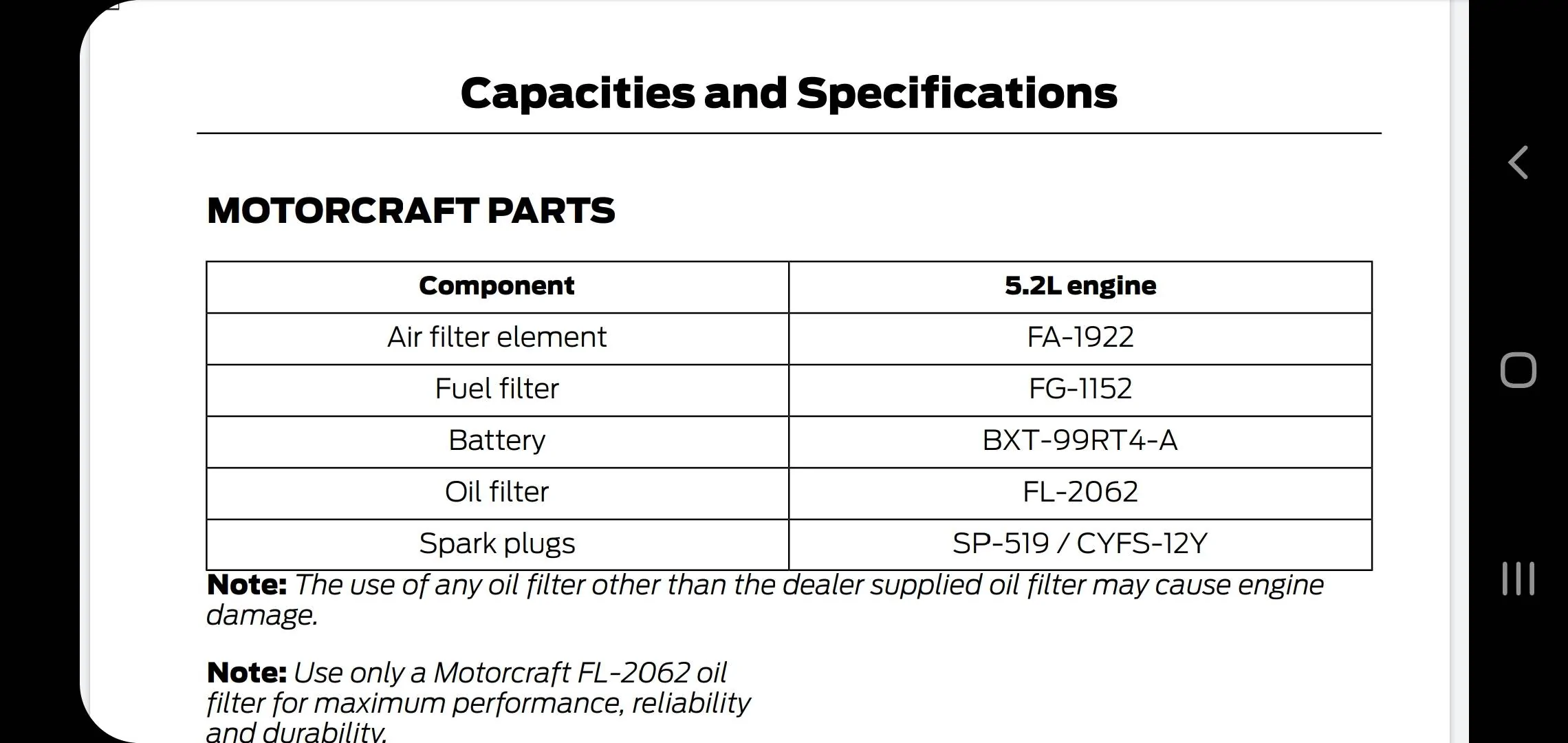

My 2018 350R came from Ford with the 2062. I would use either filter you mentioned,
if you can't get the FL-2087. Plus, whatever "The Chairman" is saying has a lot of
credibility as far as I'm concerned.
Yes, it came with a 2062, but the latest version of the manual specifies the 2087. The 2017 350 still specifies the 2062 on the latest manual version.
Edit:
Rex, I stand corrected. The latest supplement for the 2018 GT350R specifies the FL2062.

As I mentioned in another post, I inquired about this at my dealership. What I was told was that if the engine should grenade itself and an aftermarket filter was discovered, then the warranty would be voided.
Edit:
Here is what I found. MY2018 and below the FL2062 is specified in the GT350 owners supplement.
2019 and 2020 both specify the 2087 filter.
Both charts for each respective model year have a note at the bottom stating that use of any other filter as specified could lead to engine damage.
I dont think I'd roll the dice on an aftermarket filter.
