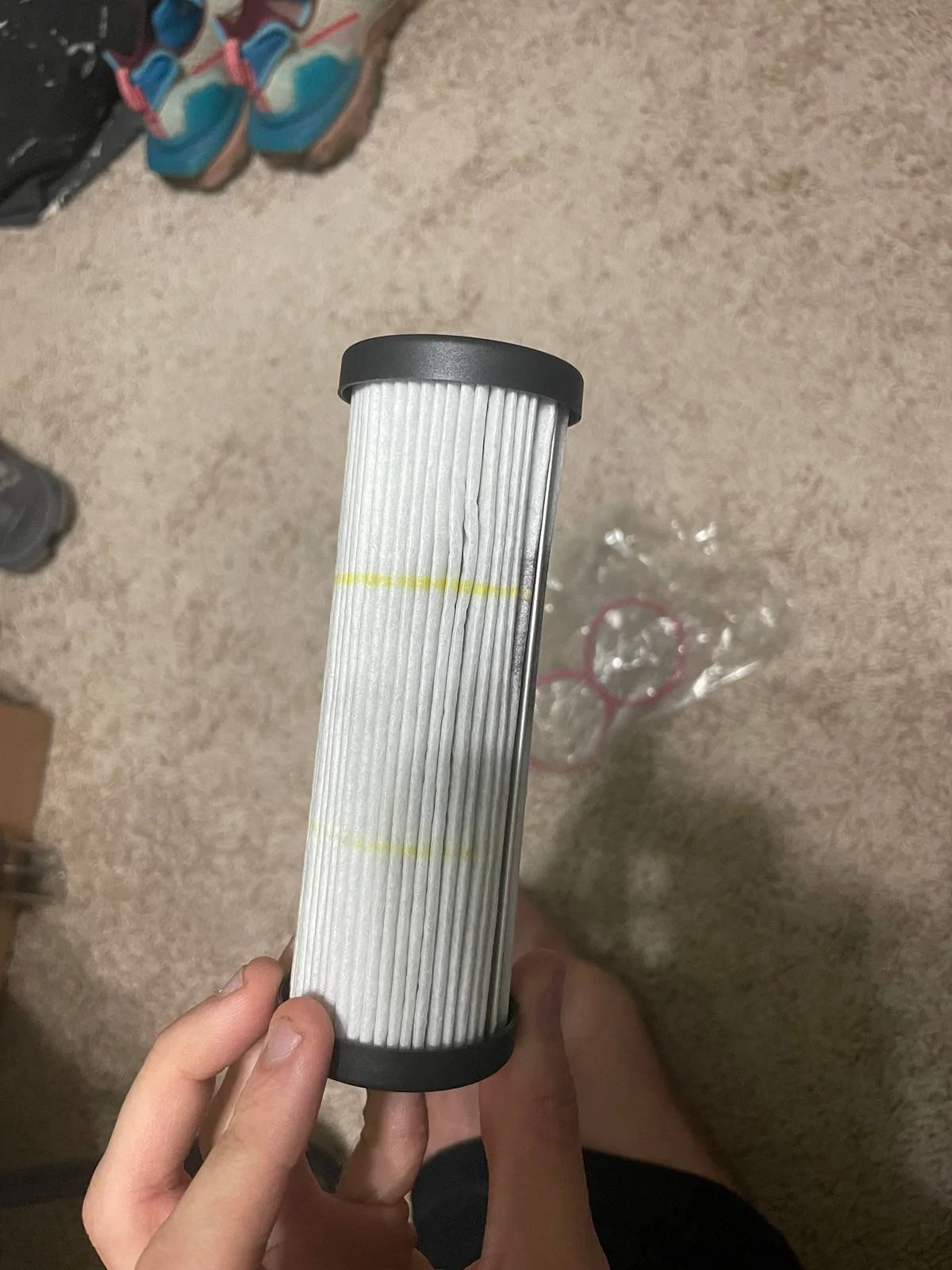

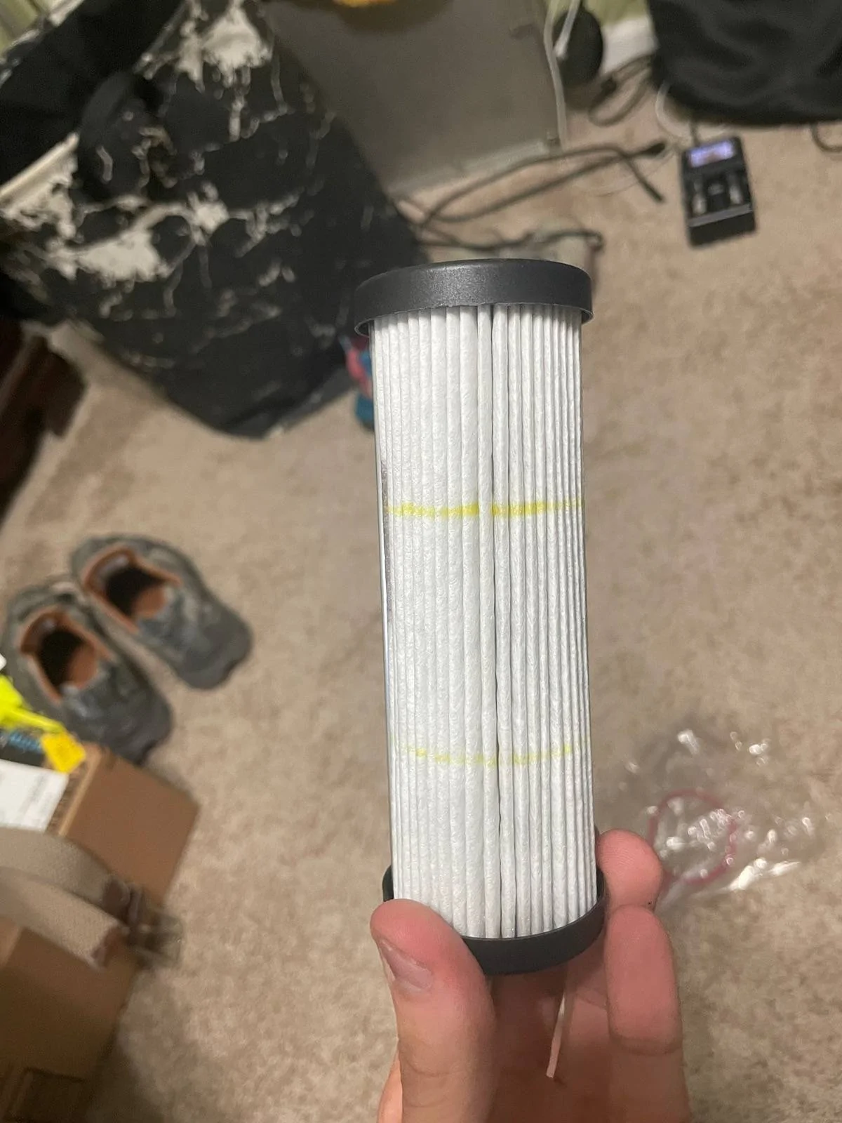

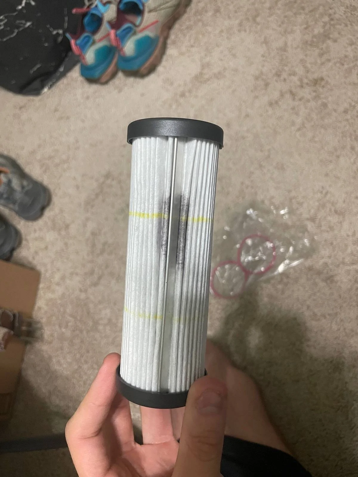

Hi all, ordered a fl 2087 from lmr and received this.
Looks possibly damaged with a stain too.
Do you think it’s still usable?
Thanks

Looks 100% fine to me. Almost looks like someone grabbed the filter and their finger had a bit of dye on it.
I wouldn’t hesitate to use it, but that’s just me.
