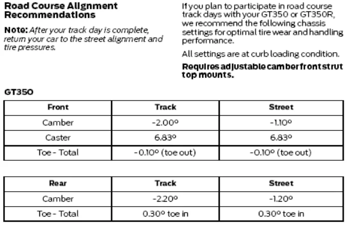

The numbers in your post are trash. I don't know where they come from, but they don't match the FP specs.
Here's what FP says in the Owner's Supplement for the 2020 GT350/R:

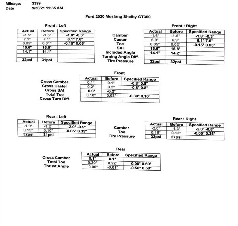

Think what you will but the proof's in the pudding...car handles WAY better than factory settings. At least on the street, no track yet.
Are you talking about handling or tramlining? The settings in the table are somewhere between FP's street and track settings. If you're not tracking, the car will drive okay. That said, just don't confuse them with the right settings for the chassis. They aren't. Presumably some alignment machine manufacturer pulled them out of thin air and the tech doing the work has scrupulously set the car up with them. The tech did a good job, the manufacturer not so much.

I'm only talking about tramlining on the street and how to get rid of 95% of it so you can happily cruise along with your fingers loosely pinching the leather section of the steering wheel in the relaxed 5 o'clock position and not worry at all about the car turning abruptly on its own 30 degrees to the right and straight into the parked car like it did with the factory settings and the Cup 2 tires. Thank goodness for my incredible lightning fast reflexes or that crash would've happened.
I'll say again, I immediately noticed improvement(read: a decrease) in tramlining intensity when driving off from getting that alignment and that was still with the cup 2 tires. After replacing with PSS the tramlining all but disappeared. Do with this information what you will!

Much earlier in this thread, I said that a "precision alignment" would help a lot with tramlining. By precision, I meant that the settings had to be the same - down to the third digit - on both sides. The actual settings don't matter as much as the precision with which they are implemented. As I said, the tech did a good job and that's what reduced tramlining.

Like @Booboo I'd like to be able to drive my car on the street with my OEM PSS and not have to keep two hands, white-knuckle tight on the steering wheel to avoid an accident! With that being said, what alignment numbers am I looking for? The numbers Booboo posted do seem to fall into the Street range of the owners manual.
Am I telling the tech to shoot for a total toe of .10? What about each individual reading up front? And what about rears? Which adjustment will reduce tramlining.
