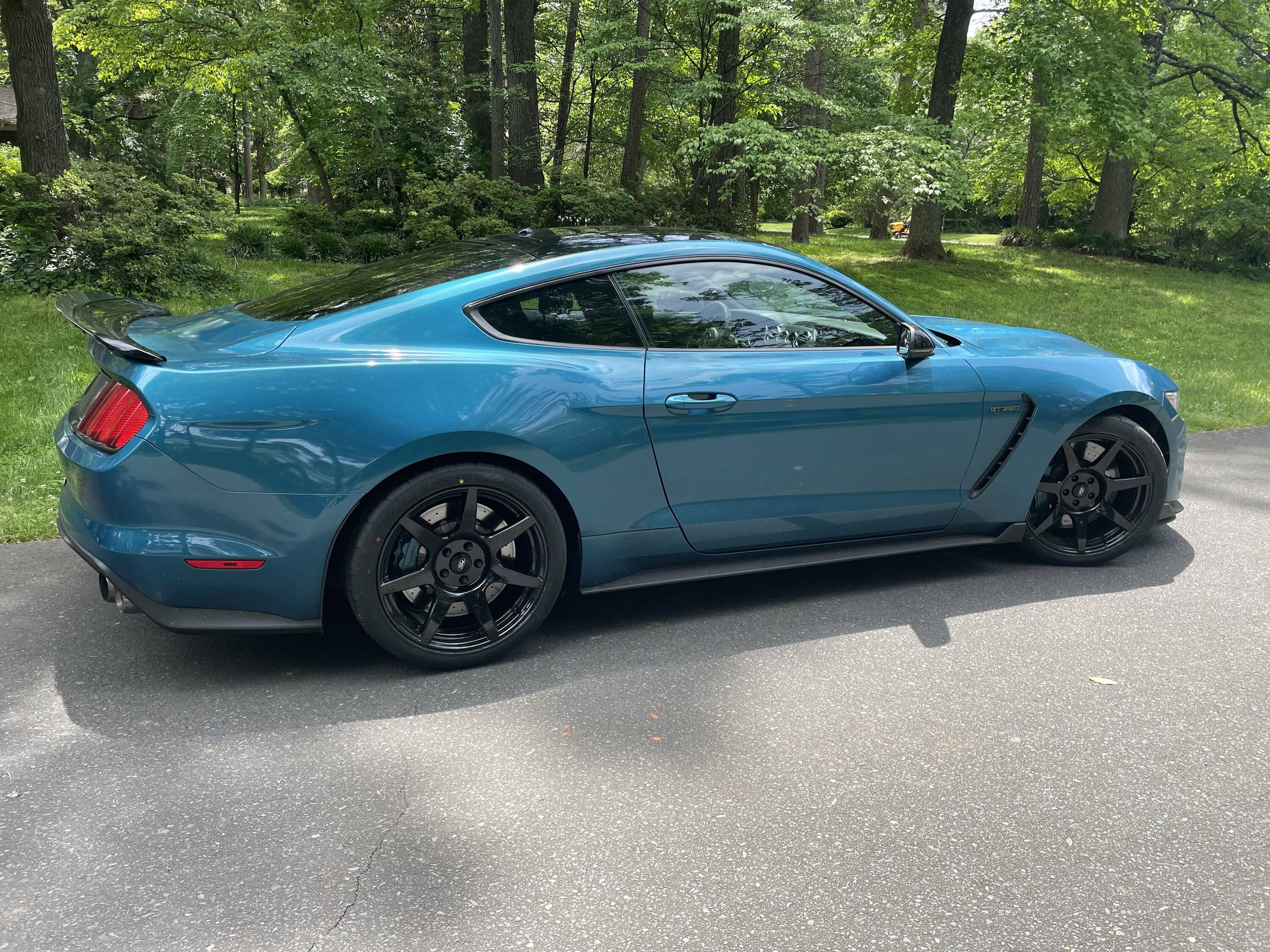

It has been a long battle but I finally have a car that doesn’t want to kill me. I started with the steeda 2-point brace…..did nothing. Installed caster/camber plates; lowering springs: irs bars; got a proper GT350 spec alignment with camber and toe…..all nothing. Finally purchased a new set of rims and tires. Went with the SVE GT350 seven spokes. Due to availability issues with Conti’s, and not wanting to spend $500/tire for another set of Michelin, put a set of Yokohama Apex V601’s on. 285/35/19(again, 295 or 305 weren’t available) front and 325/30/19 back. Tramlining is completely gone.

@Crossi what availability issues with Conti? I just got a set no issues. Discount tire had plenty. Or maybe a size thing.
While all your mods are great mods, and I hope you were doing those mods anyways, I sure hope you didn’t do them to rid the tramline. Plenty of articles floating around how tires are mainly the issue.
