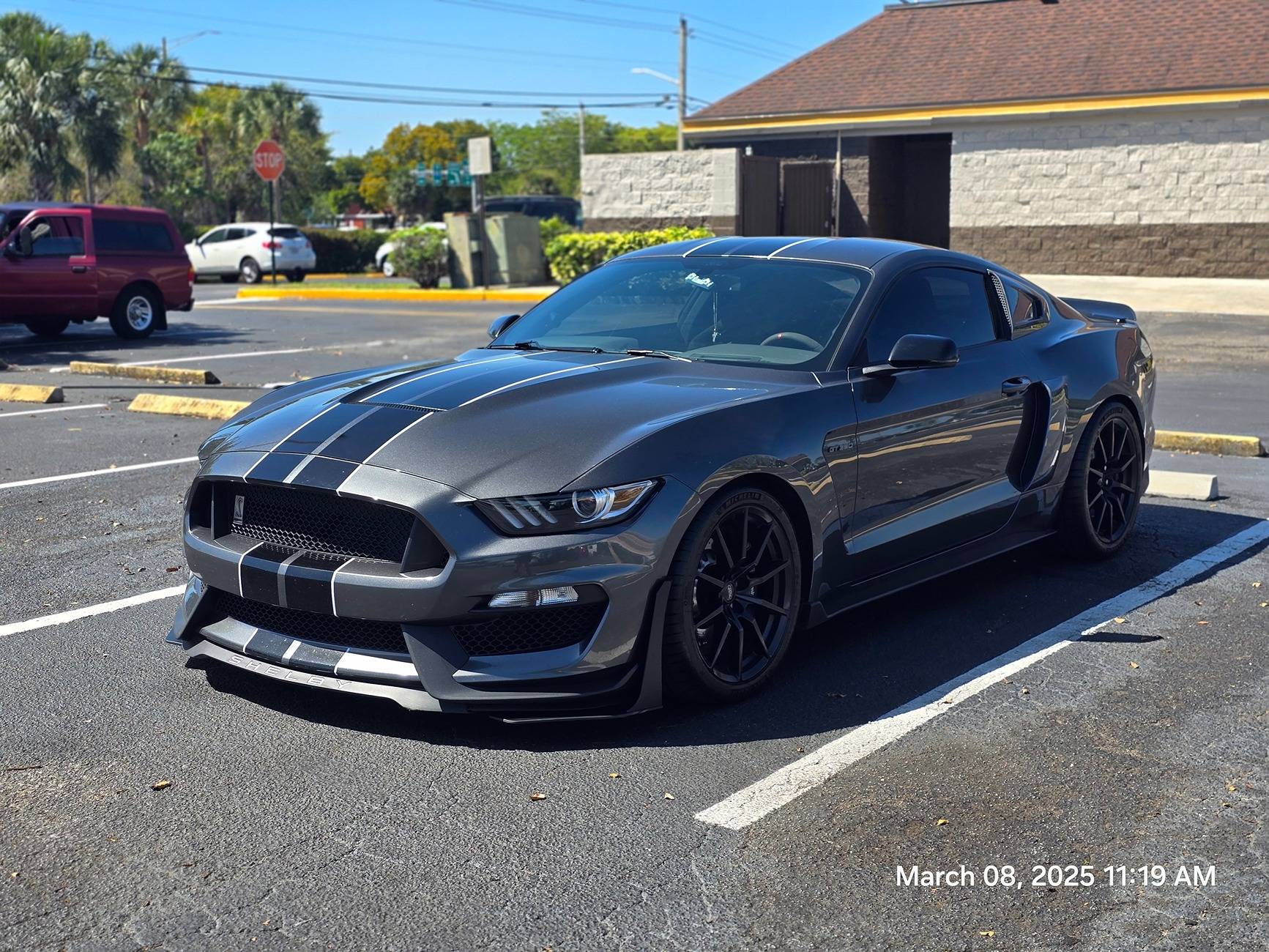

Update. Just installed MPS4's WOW! What a difference... No more Tramming all around Great ride.. 305/30/19 front & 325/30/19 rear. Thanks for the info!
Did you have to change the alignment?
Doesnt look like it, but any poke from the rear wheel at the fender? Or still tucked in a bit?
