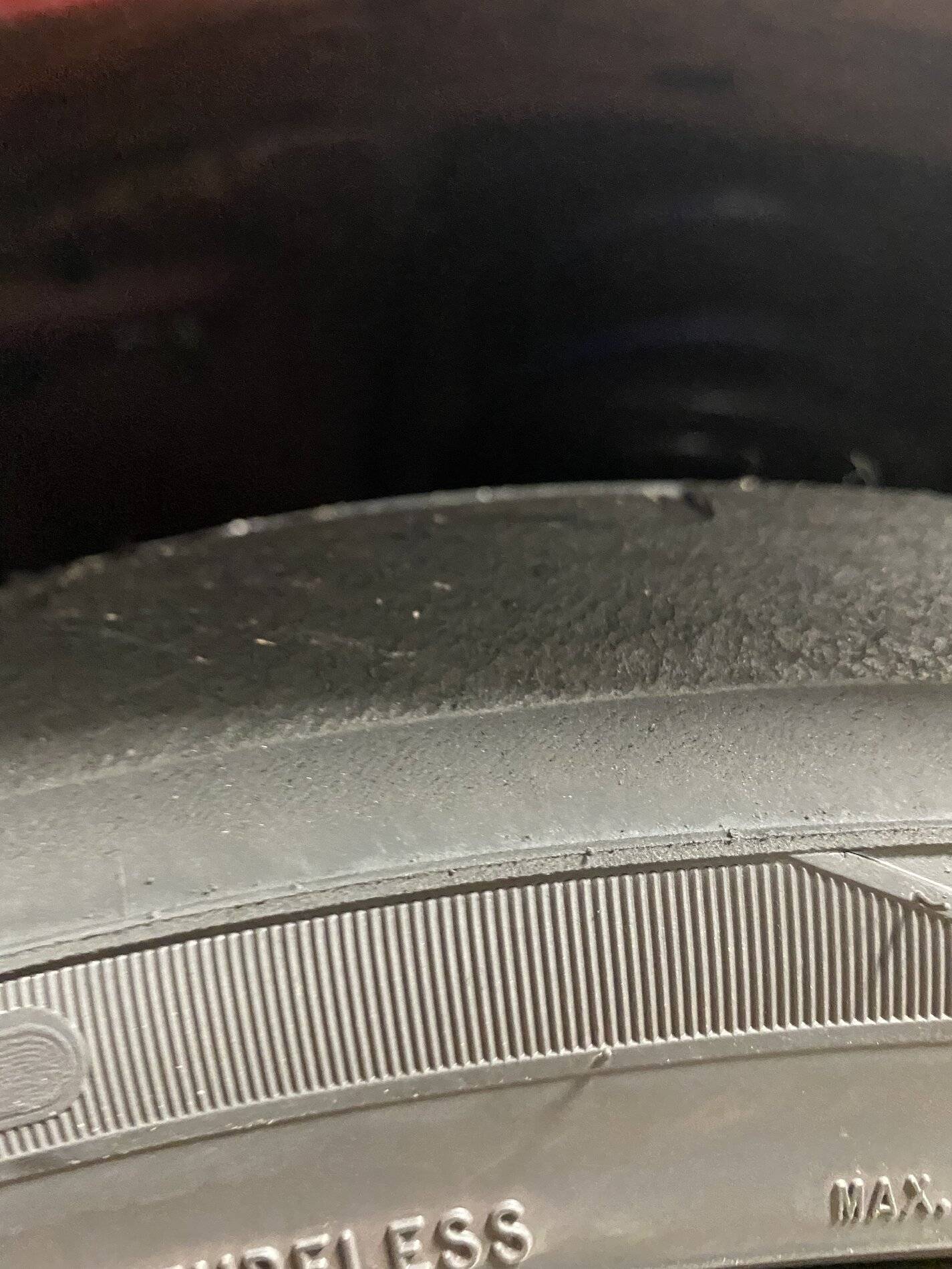

By the way, here’s the outside front (driver front). Roll over looks okay to me...but maybe you see something
I wasn't thinking user error, just adjust the technique a bit to keep the tires cooler. It sounds like the front tires are losing grip in that particular set of corners, and that could be a heat problem that's unique to that tire on your car. I have had my front GY3R's go away in a corner in the middle of a session (four weeks ago). I got them back by switching the suspension magride setting to "Sport" (with the chassis still in "Track") but the next session out they were dead - 19 heat cycles and they were pretty much grip-free.
