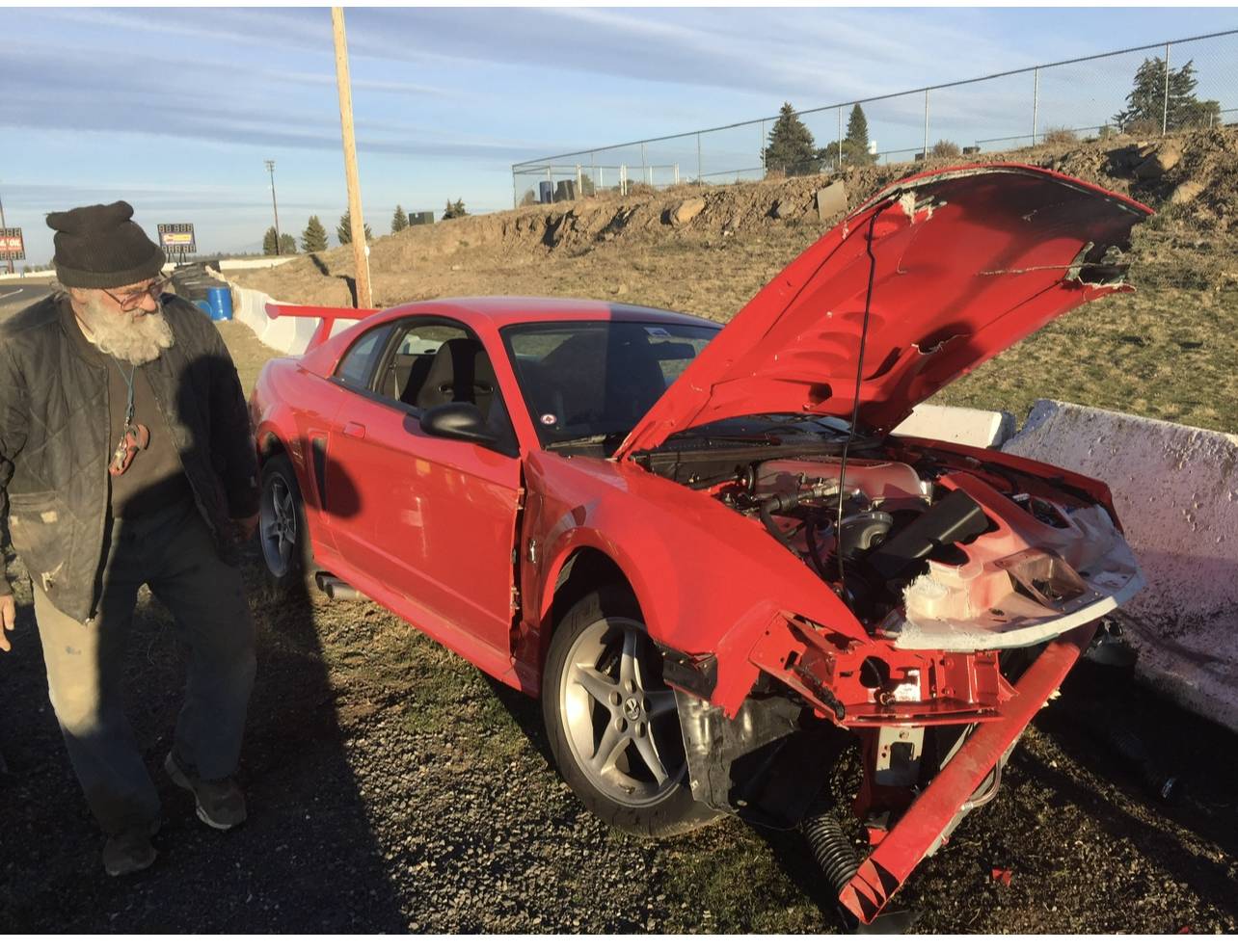

What was the ambient temperature? Curious as I tracked my 2000 R below 50 degrees and it broke and hit a cement barrier and totaled it unfortunately.

Just peeked at your video. My trans Am buddy told me that they never go out below 50 degrees, our tires are not designed for 45 or lower, sticker inside our door. Low enough temp I read can break apart our tires internally. My R didn’t have enough heat in the trans, through the rear/axles and snapped, something. leaving me spinning at 80 mph with no power train, . Curious if you’ve damaged your tires internally and survived a blow out with that vibration I saw ?

Started with 32-34 degrees clear sunshine day. That’s the tow guy checking out how w hook it up

Sorry to hear about that failure. That's absolutely terrible. Smashing into a wall, hope you're ok. Terrible loss of the car but you're alive to tell the tale.

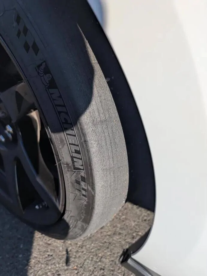

I was honestly feeling it everywhere. Even up to my head in the seat. It wasnt uncontrollable, but pretty intense. Im going to get the car up on the jacks tonight and start inspecting the tires. From there will be taking them to Discount Tire to rebalance. Though I think the tires are done for after only 1 day :(

Need to see the middle/inside. Outside tread disappears after the first day regardless
