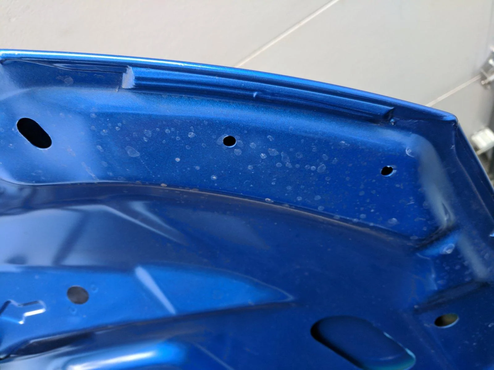

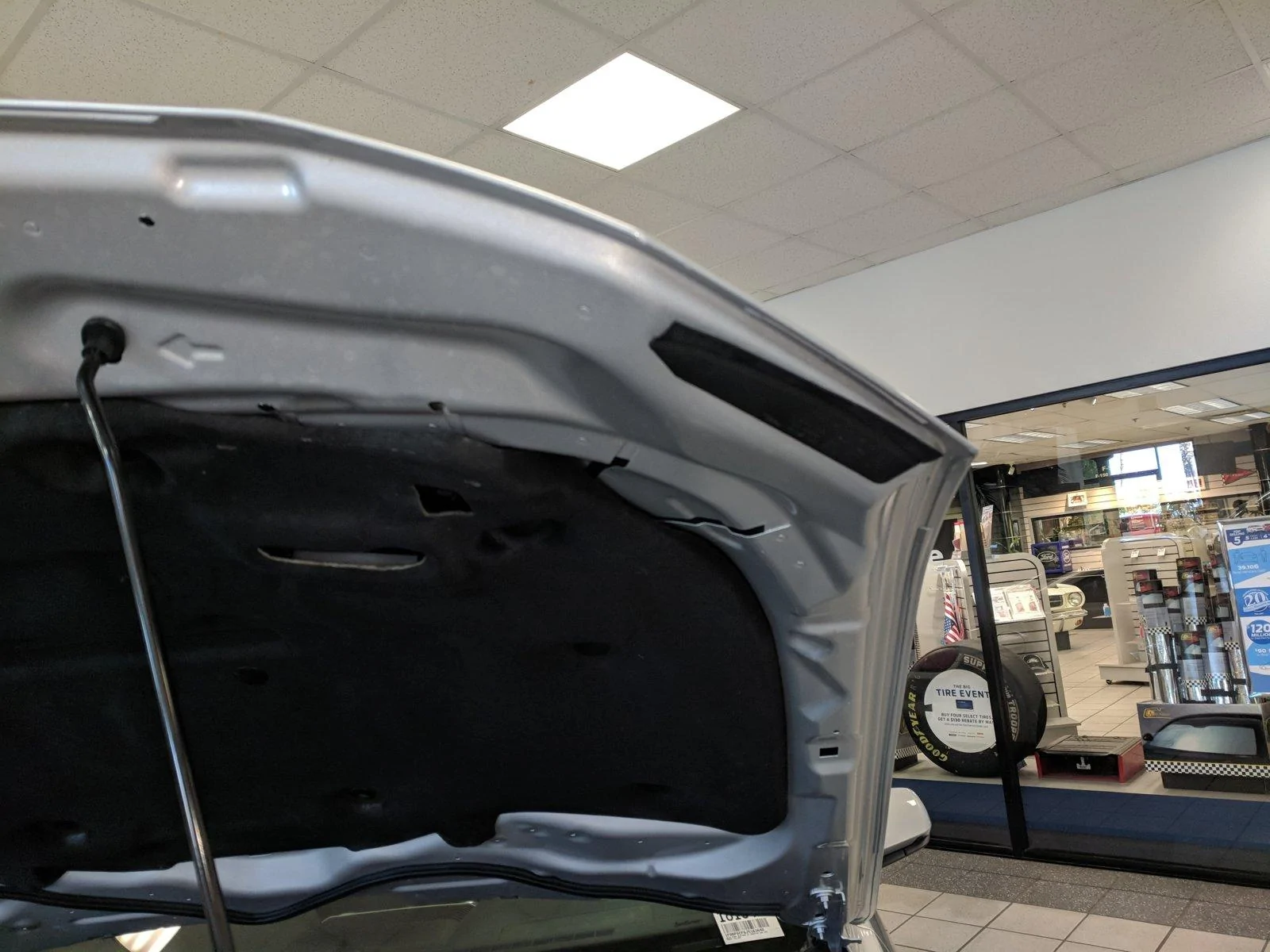

So this is a common problem on all the 15-18 gt350 and 15-17 mustangs.
I was at the dealer buying some parts and I noticed the new 18+ mustang have these rubber pieces that the older models do not have.
I looked at my hood and we do have the holes so maybe this will solve our issue with the lifting. I am going to buy it and try it and see if it works .
2018 mustang
My GT350 2017 hood
2018 mustang
My GT350 2017 hood
Curious how that would help. Wouldn't it raise the hood slightly, making it more likely to catch air and bounce around?

Did you notice how thick that part was? You may be on to something, I've read about others who have added weatherstripping on top of the headlight with little sucess.

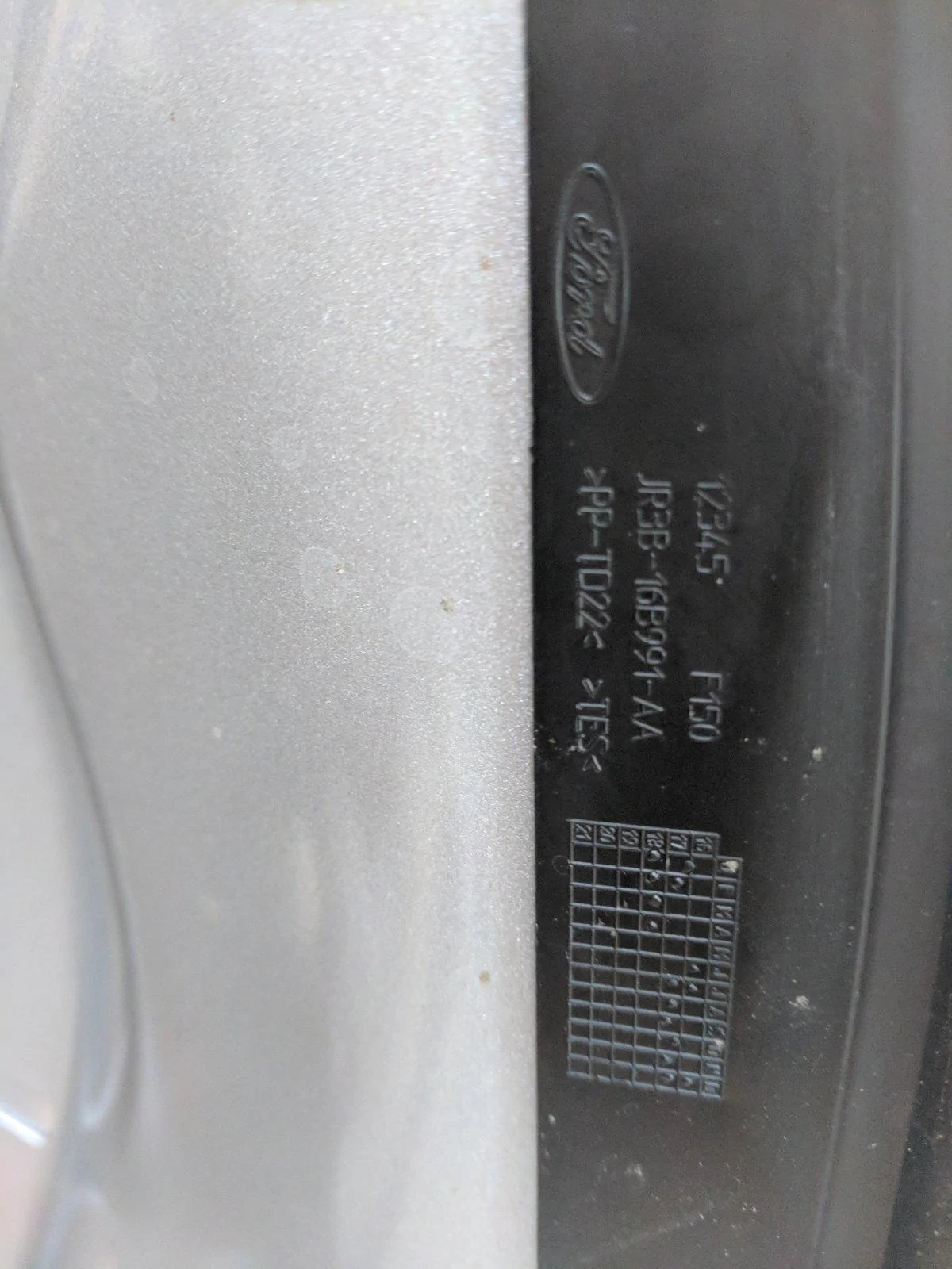

The part is around 2-3mm thick. Did not measure it but only looking at it

Also, the hood prop is much nicer on the 18+. It doesn't curve like ours that sits metal to metal and scratches the bottom of the hood.
It does have a plastic piece at the end that fits nicely inside of the square opening .

Dang $20 each and $10 shipping is $50 total.
