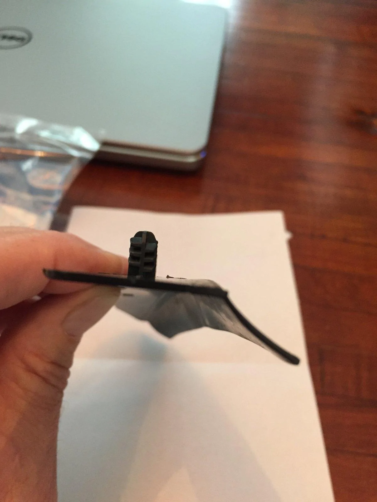

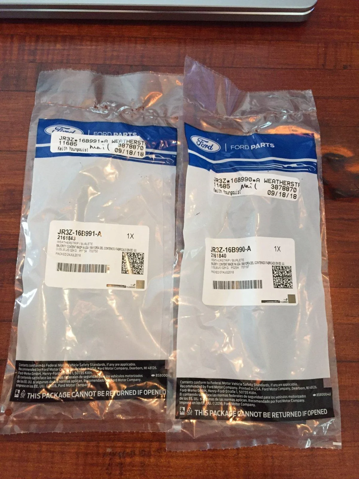

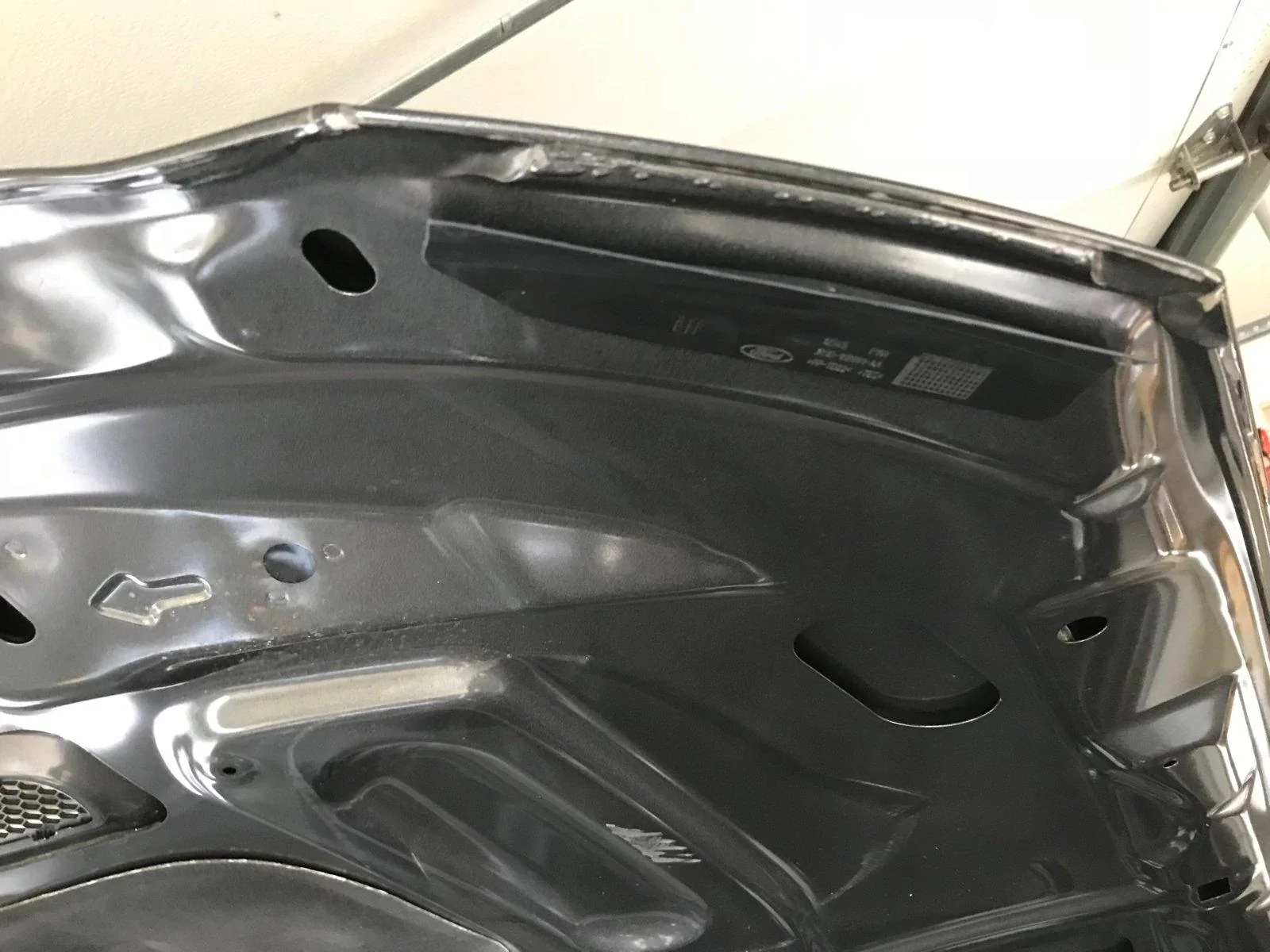

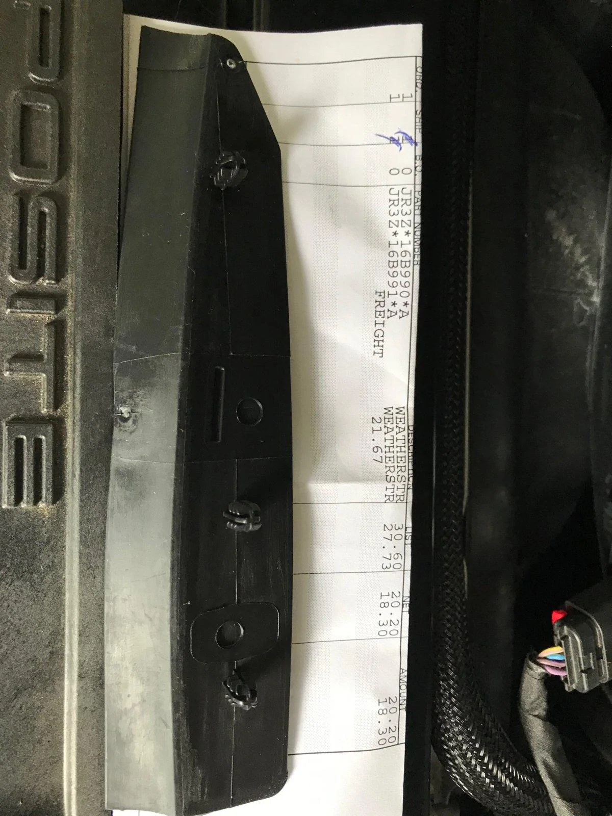

This part is very thin. Hard plastic on the mount side and soft rubber on the weatherstrip. It has three push anchors and they do not line up at all with the two holes in that area. None of the holes will work to align it properly and without anything then to guide the installation it will take some effort to locate it properly. I will save this for a rainy day.

You should cut of the 3 plastic pins and drill holes and install push pins to align it on your hood.

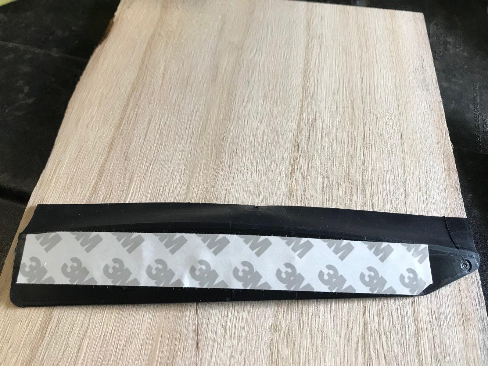

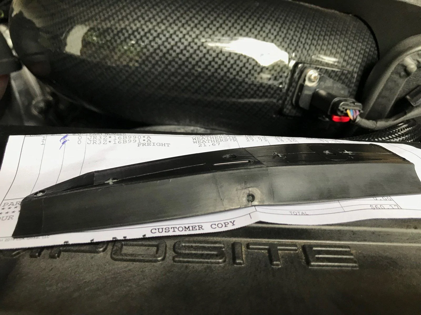

I went ahead and cut off the three pins and then used Scotch high strength red tape across the entire surface. I used the GT photo and my own eye to align it. Seems like it wants to be closer to the fender as you can imagine how air is being distributed off of the nose. We shall see how she goes. Thanks again for spying these little guys!

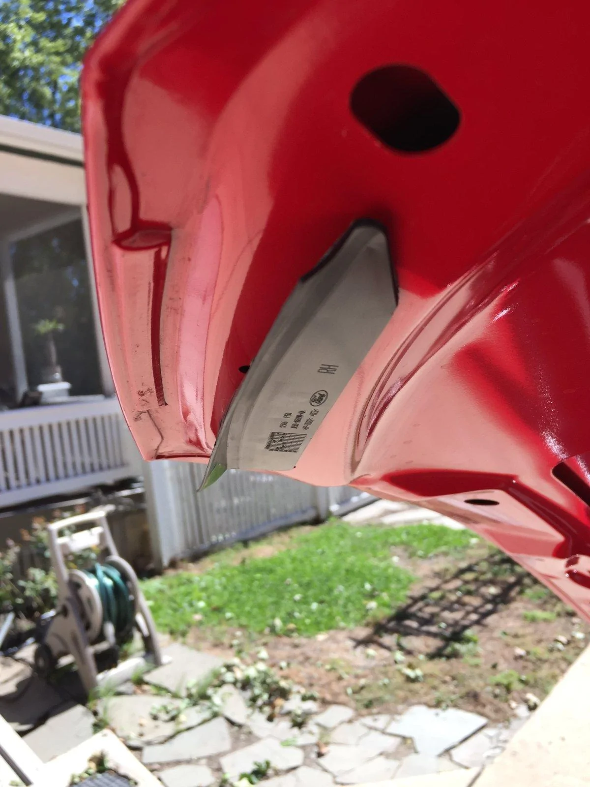

I just did the same hehe. Only thing different, I aligned it to cover the holes and make sure it covers the end of the hood. I will provide more feedback after the Oct track day.
