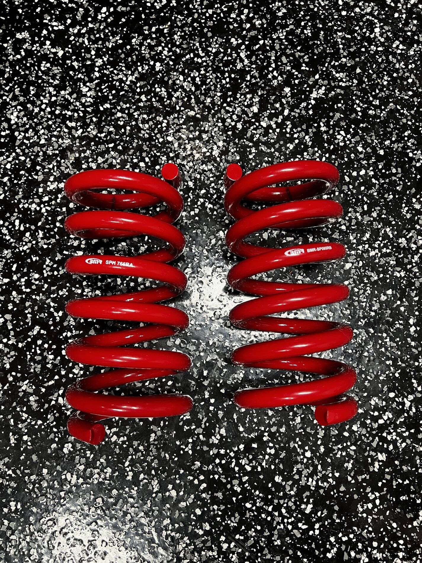

We'll see if these can help in Dec. Picked up for $143 shipped to the house. ow back to figuring out my starter issues. ha
Rates?? I do like eibach since their published rates are the rates IRL.
