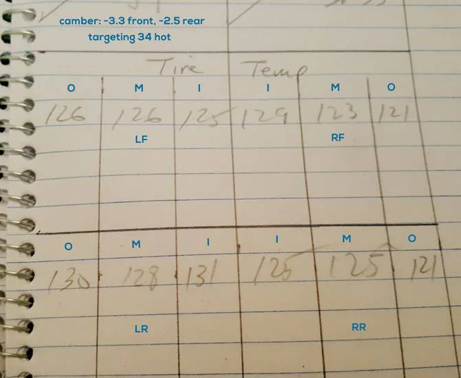

Kevin, do you have record of tire temps when it didn't want to turn?

Normal temps 185-195 or there around.
I know you've already got a solution at hand, so I don't mean to bother as it's just satisfying my curiosity, but I'm wondering what it was looking like like this especially the front to back if it's not too much trouble.
Those numbers are way too low. If you aren't using a PROBE type tire pyrometer, you need to. Make sure to NOT do a cooldown lap and come in as 'hot' as possible, QUICKLY check the temps (a minute will make a big difference in results) and make sure to measure in the proper procedure:
Stick the needle ALL the way in
Stick it in at a 45* angle
Stay away from the edges of tread blocks, measure in the middle of tread blocks
**Stab the tire 3X to 'heat up the needle' before taking your first measurement.
ALWAYS go: OUTSIDE - MIDDLE - INSIDE
(the outside *should* be cooler and the needle should increase in temp with each measurement.
