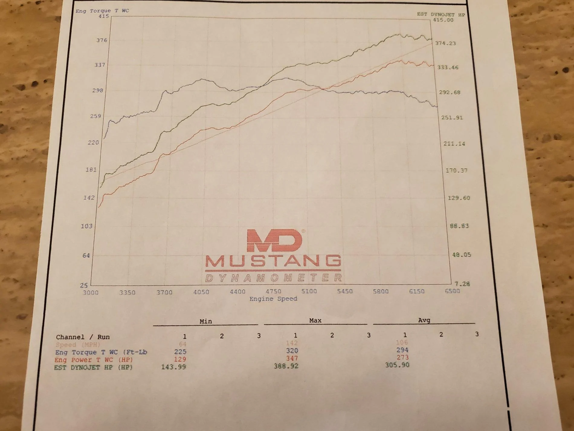

Just dynoed my car. Only mods are F150 IM, Mishimoto intake tube, AFE dry air filter, and Roush axleback exhaust. No tune yet. It was about 95* here in FL. Based on the corrected dynojet #, it comes out to about 463hp at the crank correct? Thoughts?
Not sure I get this graph, and please let me know if it's just me.
But I only see 3 lines (usually there are 4 in comparison tests) as one of the torque curves is missing.
Also, max torque is around ~320 or so? That's considerably worse than stock.
Schwerin
Jan 31, 2018
192
4,155
2,751
Home
2019 Mustang
There is a TQ curve missing, but hes on a very low reading Mustang Dyno, and hes an auto, Also not sure what gear it was done in.

I'm assuming you had a tune when you ran these numbers...if so, what tune are you using?
Guys on a Mustang FB page were going to town on the numbers...saying that they're awful and that the F150 manifold was killing my performance. Not sure if that's true or if I just need it tuned to see the full benefit.
It does kill your performance, at least in any full out WOT or racing situation. Probably not in a stoplight to stoplight situation where the low end torque gets you going. But yeah, basically the F150 intake will run out of air at high RPM and will hurt power under the curve in extended WOT situations. Your car will ultimately be faster with a stock, 18 mani, GT350 mani or CJ mani because they let the Coyote rev it out to higher RPM which will give you a higher avg. power.
Dr.Pat
May 31, 2016
139
Fort Myers, FL
2017 Mustang GT
Thanks...makes sense why it didnt dyno well. It definitely pulls harder from stoplight to stoplight, which is 99% of my driving amd which is why i wemt with this manufold...hell I've only had it on highway 2 or 3 times in over 2 yrs.
