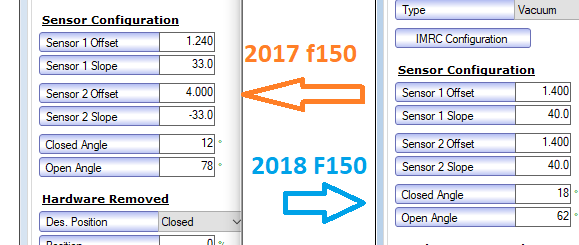

You can change the imrc voltage settings from the 15-17 to my18 models. Very simple. Imrc stay active and engine functions as intended. Lot less headache than redoing or trying to trim the mapped points and distance tables etc.
Ford actually swaps the settings back on the bullitts because the gt350 still uses older style imrc actuators. Did I mention how simple it was to keep the imrc? Literally 4 data points.:wink:

So what are these 4 data points?
Looks like 6. I'll try it but every working tune I have seen went into the mapped points tables

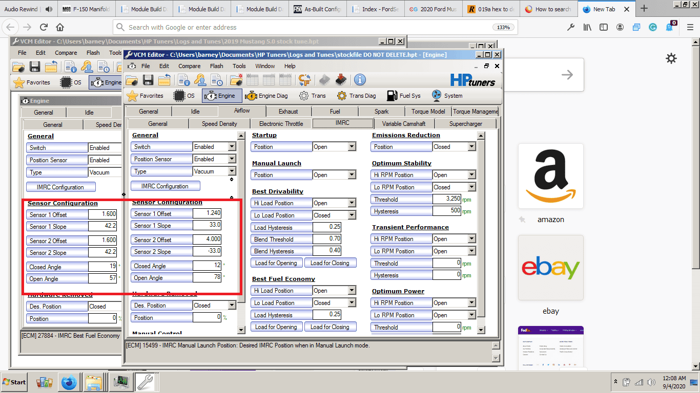

that is correct, its 6 i forgot about the angles.
im using VMP pnp harnes for the wiring and made the changes to the imrc sensor tables only using a my18 GT mani on my my17. zero issues, no codes, runs exactly as it did with the stock manifold just different top end.
i dont know why some tuners cant make the voltage changes. i suspect more of the issue is the hard wiring people try and do to save a buck and poor connections/incorrect connections crop up.
here is what i see as the differences in the settings for a my17 to my18 f150 manifold.
