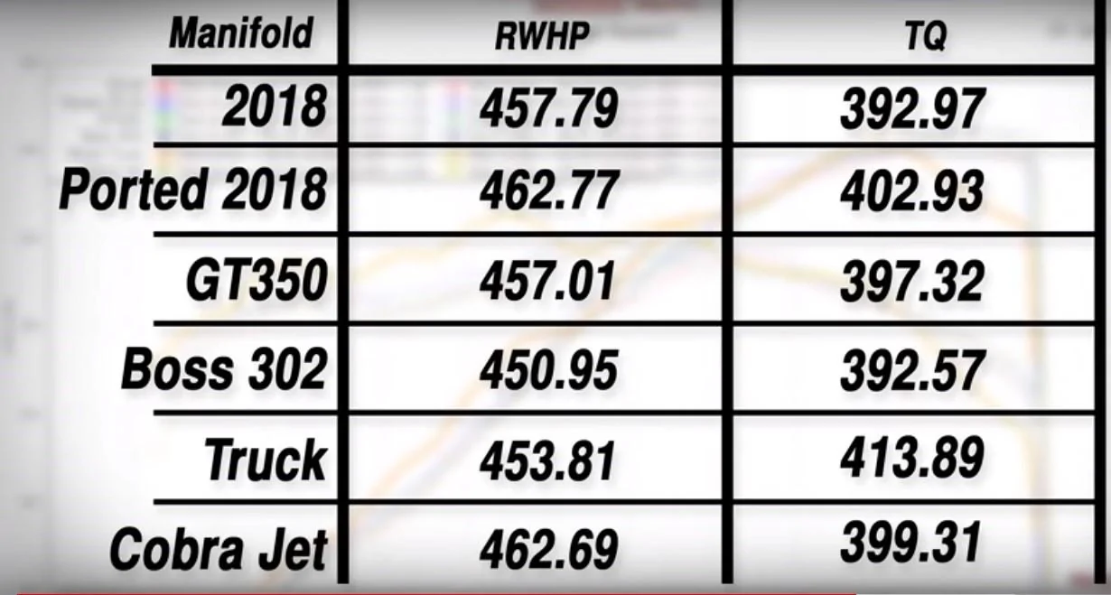

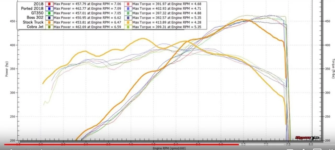

Sorry, but you are completely ignoring the torque curve. I'll gladly give up some hp at high (unrealistic rpm for a street car) for a gain of 25-40 ft/lbs across the board on my STREET car.

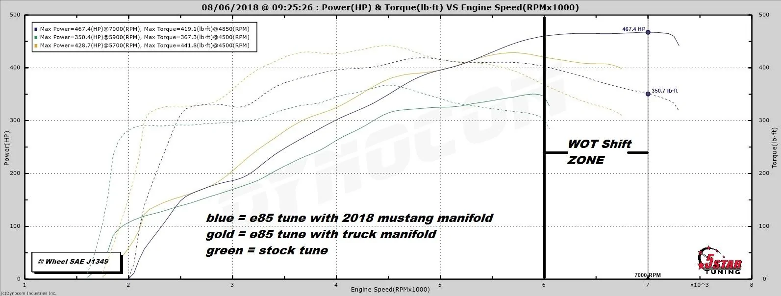

Not quite an apples to apples as the dyno below is a 2018 F150, but swapping to the 2018 GT manifold is fairly common on F150s. Every before and after dyno graph I’ve seen of an owner who goes from the 2018 F150 manifold to the 2018 GT manifold looks like the graph below. Keep in mind the 2018 F150 manifold has improvements over the 2015-2017 F150 manifold.
The F150 will make more power upto 5,500rpms but what it gives up from 5,500-7,500rpms is just too much for me to overlook. The graph you provided is by far the most generous I’ve seen between a F150 manifold and 2018 GT manifold. Still would be very interested in seeing someone swap over to the 2018 F150 manifold and see the gains it has over the 2015-2017 F150 manifold.
The VMP mani shootout was a joke. If you cant figure that put then happy trails with an F150 mani.
Its really this simple.
The higher you can rev the bigger wider rpm window you have thus a higher AVERAGE HP and TQ numbers.
