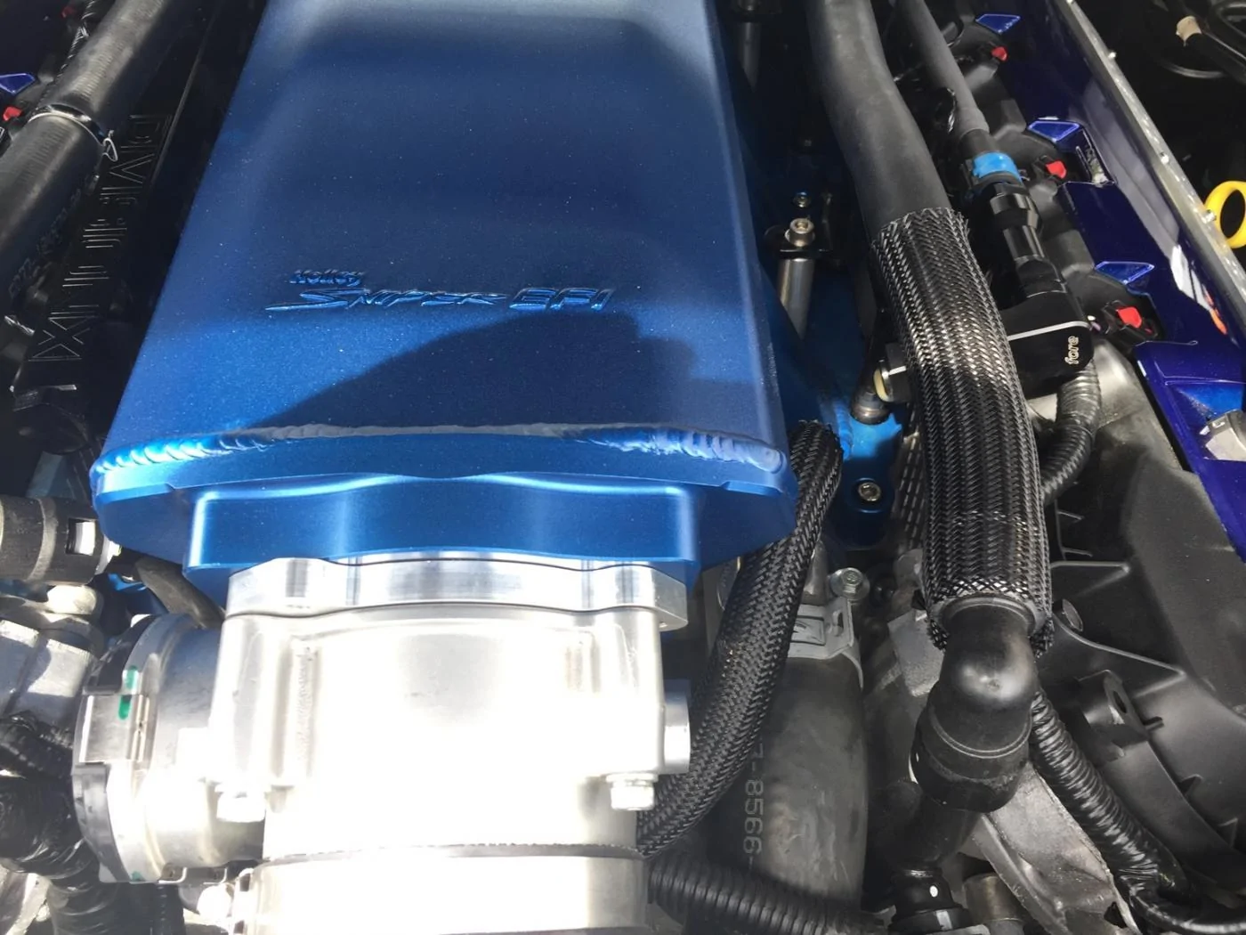

The 829032 intake are in house and should be shipping out on current orders. If not from the 8 we have on hand then a shipment of 40 are on the way as well for shipping. For your stock fuel system you can use part# AT991986ERL this is a 3/8"s Quick connect with a -8 an male end to thread with the fittings that come with your intake and rails.

I still do not get why the fitting I listed would not work.
If it converts the returnless fuel system from quick disconnect 3/8" to 8AN everything else is hoses and fittings unless Holley went and did something dumb but they list the rails as
"EFI Intakes include 3/8" Fuel rail kits (Sniper logo laser engraved)"
which would also work with a 3/8" to 8AN adaptor on the rails.
I am failing to see how adapting the stock fuel system into the rails is so mysterious or wrong as I am thinking it would be.
The pipe thread rails they provide will not work with anything as it was tried to by me. HINT

The problem is... they use pipe thread rails. And to work with the stock lines, their placement does not work. I spent nearly 2 weeks going back and forth on this with them.

PS... theirs a thread on here i started showing better pictures of it installed... :thumbsup:
Well between the adapter to the stock lines and the availability of both NPT and AN fittings I will try to put something together. Even if the crossover line has to go into the rear. I will figure something out.
Your doing what I tried. It's not going to work. Your going to have a bunch of fittings trying to make something work. Just wait and see the easiest route will be with the article. Take my word on this.
