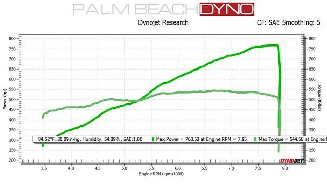

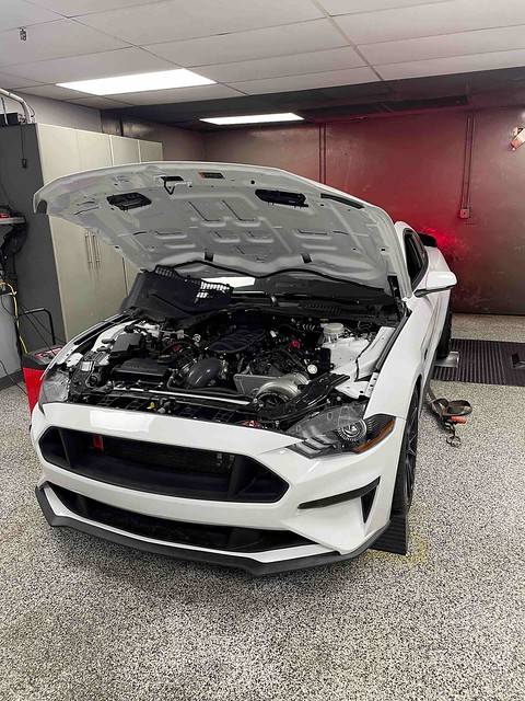

Here are my Centri dyno numbers. Centri blowers make peak power up high, mine was 7850. My car shifts every gear at 8000 and doesn't drop much between shifts. Just stays in the powerband.
Procharger D-1X with a 120MM Pulley (11 psi), Big Red BOV, Largest Intercooler, Fore Innovations fuel system on E85. The pump E85 was tested and it was right around 72% Ethanol. We did put E90 after the dyno tune session and the car picked up in power but no numbers.
*Note - the D-1X is designed to make less torque compared to the other P and D series head units. It's also designed for roll style racing, less torque for traction. Rated for a max 1100hp.
*Note 2 - Ken at PBD strapped the car down before changing to radials. This was dynoed with a 305 Mickey ET which is not ideal for dyno runs. Figure a 20HP loss. Car was really making around 790ish.

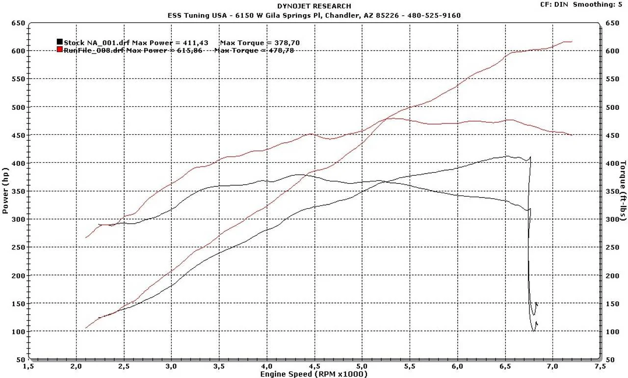

I can hook from a 40 roll in 2nd with a Whipple. If you have a centrifugal car, you're going to downshift to get into the powerband and you'll be making plenty of power, the dyno sheet from this ESS car for example is making 475 lb/ft at 5500rpm and will definitely hit the tires hard.
Sure the Whipple will make more torque lower in the powerband, and maybe a little more torque overall, but when you get on it, either car is going to be at the same RPM and the centrifugal is going to a lot closer in torque at those higher RPMs than some people think. If anything you want the extra power down low for when you aren't quite in the powerband yet because of gearing etc.
