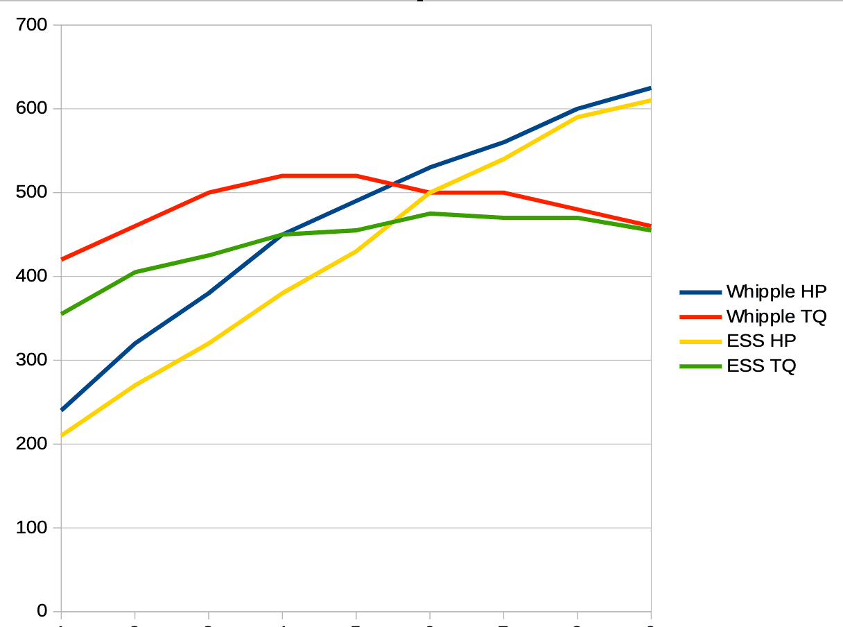

I overlaid an ESS and Whipple car that made similar peak HP just for an example
Remember when you are RACING you don't care about anything under 5k

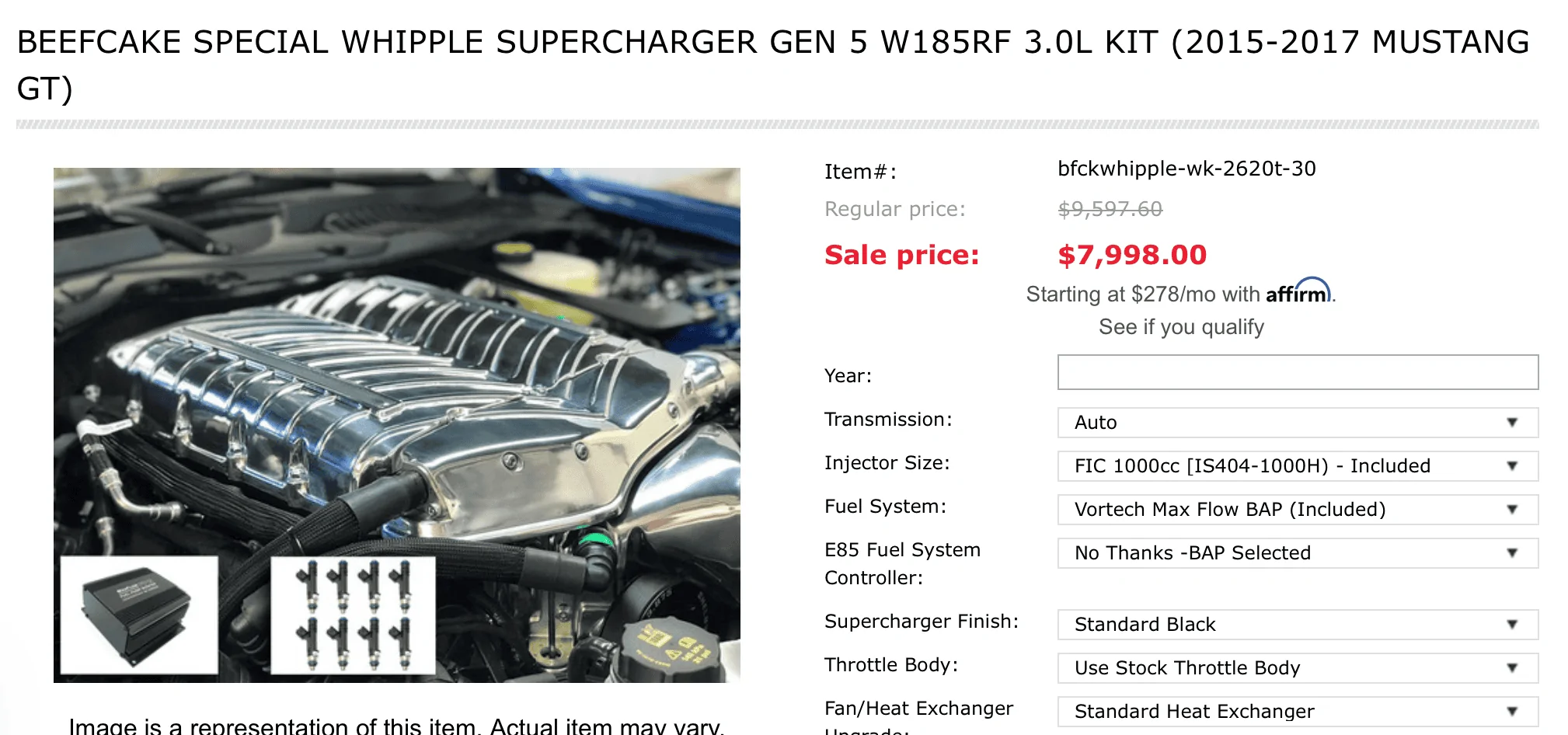

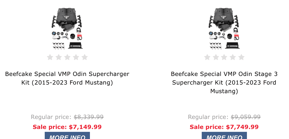

Where are you getting 12-15k? A complete stage 2 whipple kit is like $9,500, and VMP was recently on sale for $8k

Yeah, you comparing a G2 on pump 91 with the biggest pulley to a whipple, no kidding the whipple will be faster for twice the cost. Now use an actual comparable supercharger at the same boost level to account for the efficiency of a centrifugal and you'll see vastly different results
I'm comparing two base kits on pump gas that made similar peak HP
This is just to compare the power curves
There is only about 25 ft-lb difference in the RPM ranges that matter

I have to wonder which model of each brand? The Whipple definitely shows a stronger curve
