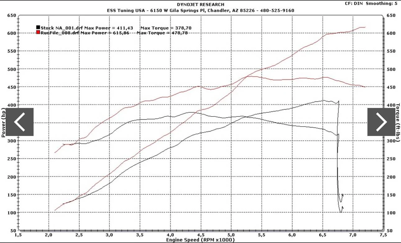

Before and after directly from the ESS website
Correction. I meant before full hp/tq and more like 4k> My bad, but two totally different power adders.

I've owned both. I prefer the ESS because it feels like I'm driving a stockish car around town but if I need the power it's there. Some people have it in their heads it doesn't make power until 5500 rpms or so. Which is a lie. Having aggressive cam overlap mid range aids the centrifugal blower alot in spinning up. I also like the IATs since I live in one of the hottest states in the country. Also prefer the sound, install, and price over a PD blower.
Another factor is not needing to drive around town on drag radials. I don't daily the car but I like the look of a "street" car not a drag car. My cheapo street tires handle the traction well. There is tire spin but it doesn't show itself in second gear until around 6k. Higher gears it's virtually non existent. I personally like the idea of not having a massive oven on the top of my engine but that's just me.
Edit a centrifugal is also much nicer to all your stock parts you'll still have. PDs have brutal torque that stock parts like axles, don't like.
