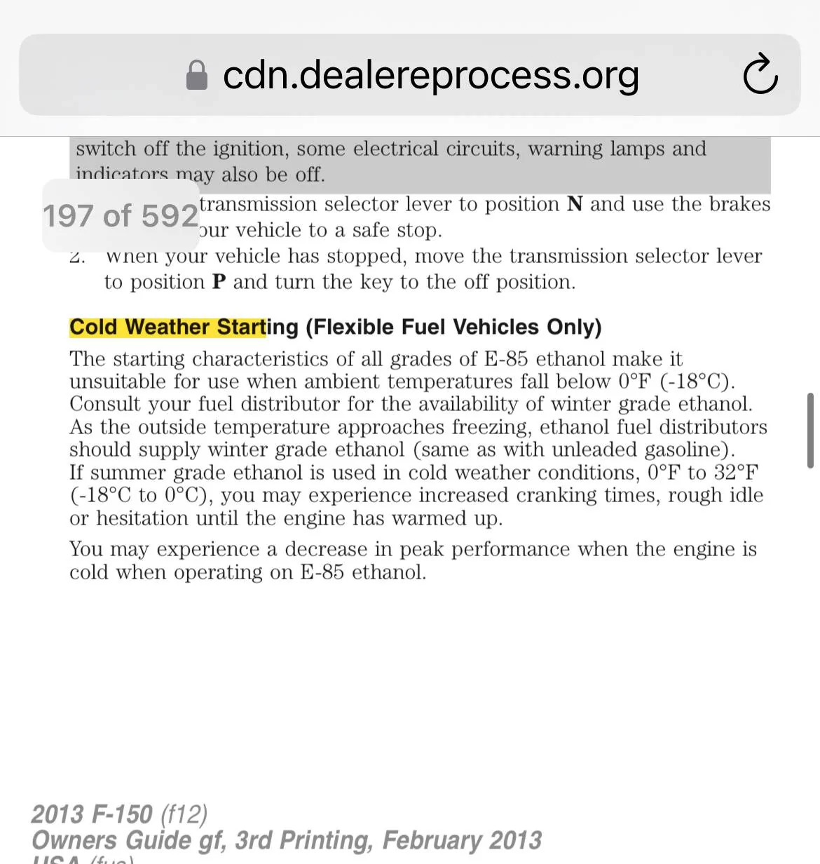

Ford makes the f-150 start perfectly fine in cold weather on e85. It can be done. Part of the problem is that hptuners doesn’t give you access to all the “lost fuel ffv” parameters, so they have to “rig” it using what they do have access to. Another part is that some tuners just haven’t figured out how to make it work.
robvas
Nov 18, 2023
3,816
3,607
MI
2011 GT
They used to have a section about it in the owners manual
