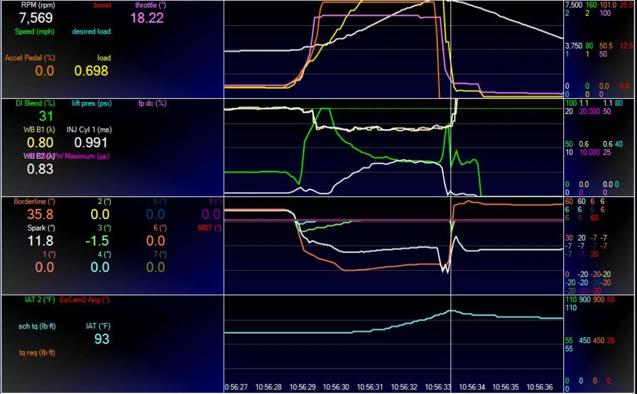

Just for fun at higher boost levels, and these are cars I've tuned:
For transparency, this is very over-spun VMP Odin, running literally off the compressor map at around 23 psi boost and 60% efficiency, with the single-pass non-counter-flow intercooler (better than Roush but not as good as Whipple). This is what happens when you push a PD too far. Temp rise during the pull was about 23 deg.

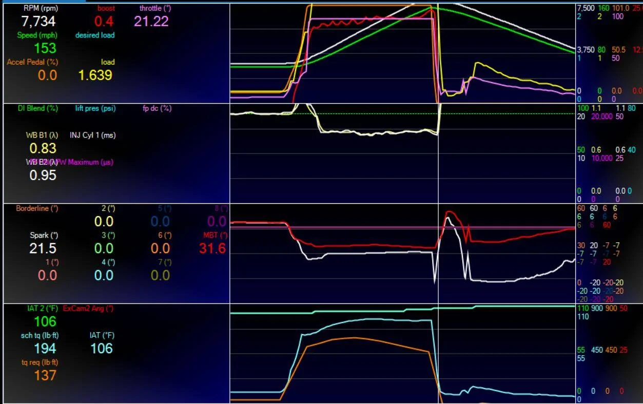

This is a Hellion running 21-22 psi boost, 25 deg rise during the pull:

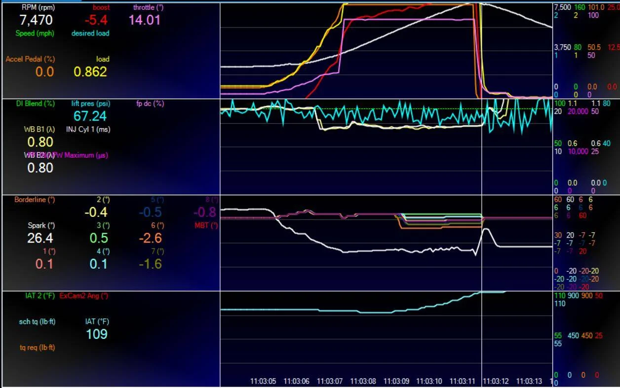

And this is a Whipple 3.8, dual-pass counter-flow intercooler, also around 22 psi boost. Temp rise was about 6 deg.
The ambient temp was the coldest for the Hellion (winter dyno), warmer for the VMP (spring), and hottest for the Whipple 3.8 (early summer).
Lots of people stuck in the old mind-set of yesteryear. I see it all the time. And I don't discount the centrif. It has its advantages...just not the ones you think.
Yes you are right about noticing the patterns, they are different. The whipple does have an almost minute rise, you didn't believe this yourself when you saw it and that led you to investigate by testing the Mapt accuracy. However, that convinced you to believe something untrustworthy.
Like if I put my iat sensor hidden at the back of my manifold, surrounded by a heatsink and cooled by the water cooler, it would also make it numb and skew the readings. It will give a higher reading off boost but also a lower reading in a wot pull. It's working like a capacitor in electronics or an accumulator in hydraulics and smoothing out the signal, which you are reading wrong and believing the data from it to be truthful of what's happening.
That location will make it rise and fall slower compared to the Maf which is reacting much faster. We are talking about a few seconds of heating, the Mapt and it's location is buffered by the aluminium all around it.
You also have to remember that the more the air flow increases through the pull, the less time the boost is sat in contact with the cooler and the more heat is being generated by the supercharger, so you get less and less cooling effect. The speed at which the cooler can conduct heat from the charge is determined by the temperature difference between the boost and coolant (delta T) and the time it's in contact with the cooling fins, which is why you have killer chillers to increase the delta T and make the energy transfer faster, increasing cooling effect.
Heat will only lose energy to something colder. Once you move towards temperature parity, there's no more transfer of heat, no matter how long the boost touches the cooler and at wot 4krpm+ we are talking milliseconds. I know your data says otherwise but you are being fooled by it. It's impossible to cool the boost that fast with such a small cooler and so little delta T. It defies physics. I know your data says different but it's wrong because of how it's being collected.
The only way to have reliable data from the whipple setup is to have a sensor in the intake runner, but noone will want that so if it was me I'd put a coolant temp sensor at the hot side of the whipple coolant pipe (exactly like a boiler or the engines own coolant sensor). It's impossible to have a boost temperature lower than the temperature of the hottest water leaving to cooler.
(think coolant temp Vs cylinder head temp, the coolant is always cooler than the cylinder head it's cooling, to be the other way around defies physics as you go above 100% efficiency and Einstein won't let that happen.)
I know it won't show in real time the temperature rise from a wot pull, but it will give you a better idea of what's happening.
It was a few days ago but there was a thread on here about insulating the whipple from the cylinder heads with a thermal gasket, and another thread about the whipples slow reacting Mapt not giving reliable data, all backing up what's going on here.
There's no doubt Whipple have made great advancements with the gen 5 and the counter flow cooler and the rotor design against the competition but it still has to behave in the realms of physics, it's still working on the principle of a spur gear pump and they can never be 100% efficient because they leak from high side to low. That's why they get worse with higher and higher pressures, the leak gets more and more. It's not an attack on you or the brand, it's physics.

The iat sensor is in the intake manifold of the whipple. There is no water cooling around it. The sensor probe is insulated from the aluminum case. The iat sensor is functionally the same as the iat sensor in the maf its just rerouted to the intake manifold of the whipple.
I think that the whipple doesnt have a good way of reading boost temps one way or another, the centri gets a true reading post intercooler, the whipple is packaged too closely to the heads of the motor and causes a very tough time getting a comparable reading
