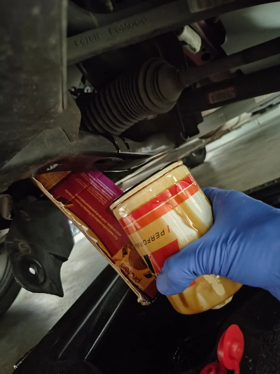

I just cut up a piece of cardboard and create a V channel which I wedge under the filter so the oil runs down the cardboard and into my drain pan. It is pretty messy. Oil changes are pretty easy on this car though, I recommend doing your own if you can.

If you are changing your filter from that access hole, you are doing it wrong. Pull the wheel off, go from there, way less mess. Still need to pull the cover on the hole, but it's definitely less bad.
Nice! Thank you for this, will try next time.

A sheet of aluminum foil also works well for the filter removal. Just fold up a long piece, and then mold it up under the filter but make it long enough that it reaches down below the splash guard, basically a long ramp that channels the oil down past the wring and sub-frame
Yessir, driver front wheel off, its on jack stands anyway. Can reach in thru the wheel well, a lot more room to reach the filter. And a cardboard "ramp" to deflect it down to the pan. Still makes a mess best you can do. And the fill plug can drip on to the belly pan as well at the very edge.
